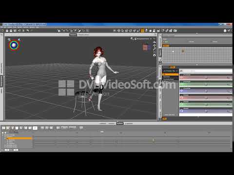

Here I have a good tutorial video for that: https://www.youtube.com/watch?v=exjHJXAB8nA&feature=youtu.be
Edit_2: To get the animation right you have to take care of the right curve shape - the tutorial video 1st shows a custom animation curve with adding more keyframes and 2nd the problem with unwanted default interpolation settings and how to fix that by changing the keyframe(s) to Linear interpolation mode.

"Ok, in case anybody is interested...I throw the white flag on this. "
I'm sorry to hear it didn't work out for you! As I said it was not an easy task to take on but you at least solved the biggest issue with the flying around so well done:) Hope to see you back in the future and good luck with your project!
Thank you Sven! You've been the greatest help since the very beginning of this ordeal.
GETTING THERE! Since my last post I decided to have another go at this and something had started working out. What I did was:
1. I deleted the keyframes where the problem started occurring
2. Animated a straight walk without turns carefully watching all the body and hip axis
3. Set the end point for the Y rotations and xyz translations.
It started taking some shape. Please see
I am struggling with the sliding feet now but it's a different story and I know volumes have been writtin in the forum about it. Any ideas how I can improve this? Thank you all again!
Wow that made me happy
! Very well done mate! I'm afraid there are no shortcuts though, only hard work lol. You need to adjust the leg rotations to sync with the figure/hip translations, zoom in on her feet and jump back and forth between keyframes and adjust legs until the foot she is standing on stays in the same place. You're halfway there my friend!
Thank you Sven! Halfway, though...:) Ok, I'll keep on working. I see the light in the end of the tunnel
Hi everyone, thanks again for support. Please see the outcome of my deliberations. I couldn't ahieve the grainless quality but it's the first one so...
Thank you so much for sharing!
Thank you! My major issue was the movement, rememeber? I ended up buying the sexy walk ^) but still had trouble with sliding feet. The issue with smooting modifer could have been caused by the fact that the outfit is for V4 and it's a G2 figure. I've done a ton of reading about lighting but couldn't get to a better result trying to balance time vs quality. Overall rendering took 16 hrs for the figure animaiton only. I set the Max Time/Iteration values to very low. Otherwise it woud take me days to render. Any suggestions? Also I couldn't figure out body morphs on the hard surface (chair) other than just dipping it lower.
