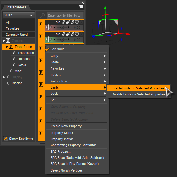

    Oh as I read this - suddenly I understand what you want to do - you dont want to change the joint limits of the selected figure bone joints as I first thougth - but you want to change the Property limits of multible selected sliders / parameters / morphs / maybe Aliases also.
    I always start to think of this where can I find the options in the DazStudio Interface - if you want to do it manualy - you would start like this: switch to edit mode in the Parameters pane - then select multible Properties at once - and then right-click choose "Enable Limits of Selected". See the attached screenshot.
    You have to deal with the current Scene Selection with maybe props and figures and other nodes selected by iterating over them to fill the nodes[n] array.
    Next you need to search and find the properties you would like to change on the current Scene Selection in node[i] with a second for loop.
    Not an easy task but good luck.
    With my test object Null 1 I had Shift+selected all Properties under Transforms to change the limits on them.
    I checked the Parameters Settings for my selection and I saw they are all "ofType: Modifier/Pose".
    I think you would need to tell the script what sliders to pick from the selection and where to change the limits on them.
    ParametersPane_EditMode_MultiblePropertiesSelected_LimitsOnOff_1.png 584 x 584 - 67K
    584 x 584 - 67K
