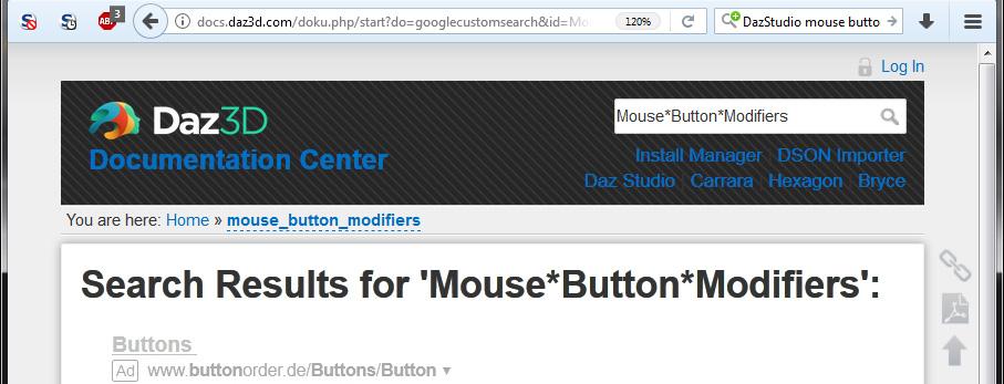

    • This is what I've found as I used the Documentaton Center Search:
    Greetings
    Syrus
