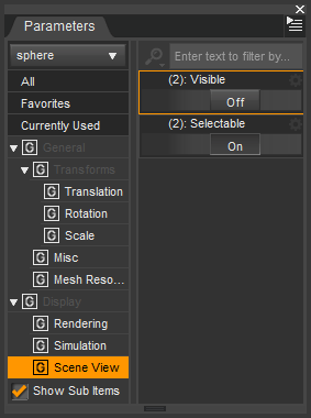

sorry my fail - it should have read like this:
PropertyGroup: Display>Scene View
just expand the tree with the [G] symbols in front.
Parameters_PropertyGroup_DisplaySceneView_1.png 283 x 380 - 30K
My idea of these screenshots is once we have a bunch of them we can share them for different things to explain - feel free to use them for your own posts.

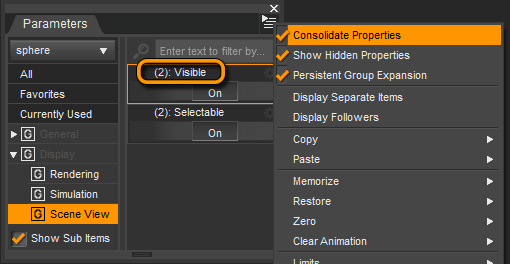

It looks like the Scene View is still refering to the clothing and not to everything else, so when I select Visible OFF, only the clothing disappears.
So the question is how do I get the "Scene View" to refer to the selected items and not the one unselected item (the clothing)?
By making everything except the clothing invisible I can export the clothing only. So, the trick will be to make everything in a scene invisible except the selected item....
OK? I thought this is the easiest step by step instruction I can give...I've Edit my 1st post to make it clear what should happen after the steps.

The instruction is clear, no problem there. The problem is that although the clothing is the only thing not selected in the Scene Pane, in the Parameters Pane, the "Display>Scene View" refers to the clothing and not the other items in the scene. I cannot see one "Display>Scene View" option for all the selected items.
Oh sorry - I just checked what caused this issue you had.
I didnt thought of the "Consolidate Properties" option switch that you can find in the Options Menu of the Parameters pane.
I have it on / checked by default. Now you should see the number of items you have selected in the brackets () in front of your Property to manipulate them all by one click (works also with morph sliders) for all selected Items. See the screenshot for details.
Parameters_ConsolidateProperties_1.png 510 x 264 - 42K
[PS] I've Edited my 1st Post to make this a clear instruction:
3. check if "Consolidate Properties" is enabled / checked in the Parameters pane Options Menu - then go to Parameters pane PropertyGroup: Display>Scene View and switch the "(number) Visible" Property to OFF for all selected Items at once - Now only the clothing Item should be visible
