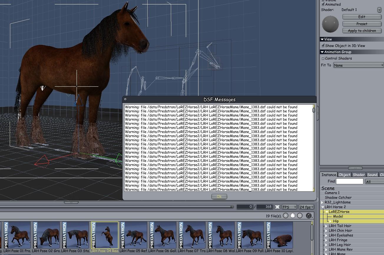

    so I thought I'd support @Predatron and get the horse bundle...
    looks like his newer stuff will only half work in Carrara which is a shame... lots of morphs don't work and the poses don't work [sigh] crying
    loading the cart & conforming to the horse crashes Carrara as well.. frown
    usual things that need doing manually are the textures/normal maps ect, alpha maps and UV
    but will persevere wink

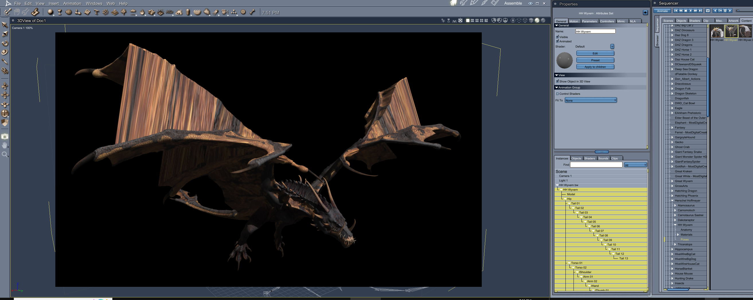

    I have noticed new items by a number of PA's are having problems in Carrara.
    Bought a lovely model of a Wyvern, converted to Blended Weight, tried adding a pose in after I had opened the model in Carrara and EEEKS.......  https://www.daz3d.com/hh-wyvern
    With the problem models I use to export them from DAZ Studio as an obj after I had posed the model to how I wanted it. Wendy suggested saving them in DAZ Studio as a Properties Preset which is a good idea as it should save the maps associated with the model, will try it next time I need to do it.

  • WendyLuvsCatzWendyLuvsCatz Posts: 41,954
    edited September 2022
    shame about the wagon
    Predatons stuff used to work well but is another who has dropped Poser support relatively  recently
    a lot of things turning off limits can also help
    Herashel Hoffmeyer's poses on his critters I own don't work from the library but they will in a saved DAZ studio blended weight duf subscene, I don't have the wyvern
    try that with the Predatron horse and  Wagon too
  • StezzaStezza Posts: 9,329
    thanks wendy but unfortunately not sad
    the old 'could not be found' error
    1304 x 865 - 338K
    Post edited by Stezza on
    For the LowRez horse2 poses..
    I found loading the model into DazS and applying a pose then saving as a pose preset is working fine... just the tail that needs to be manually adjusted

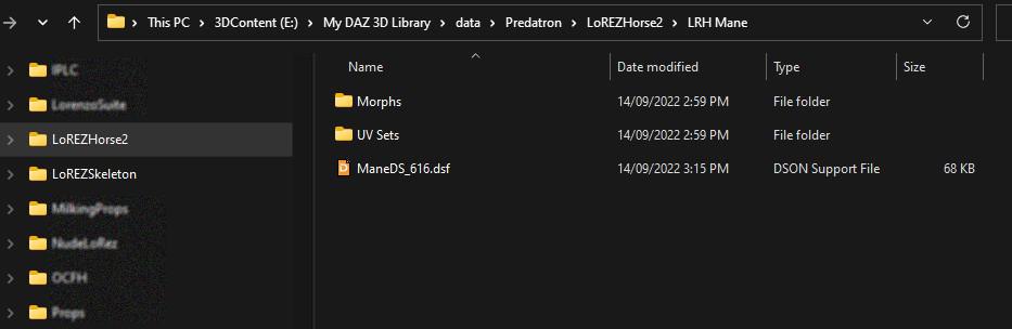

    @Stezza Are those .DSF files really missing or are the reference links in the .DUF files incorrect?
    in the duf file it references that .dsf file but it's not there.. in the subset save of the duf file the reference isn't in the duf file to that .dsf file is not there cool

  • RuudLRuudL Posts: 230
    That's a bummer. But there is a .dsf file ManeDS_616  Just out of curiosity did you try to use it in place of the missing one?
