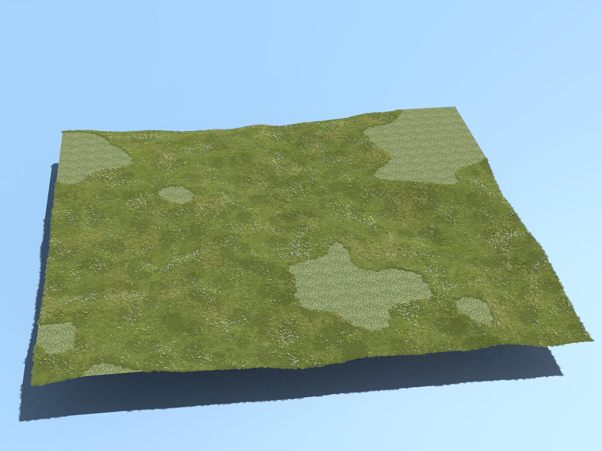

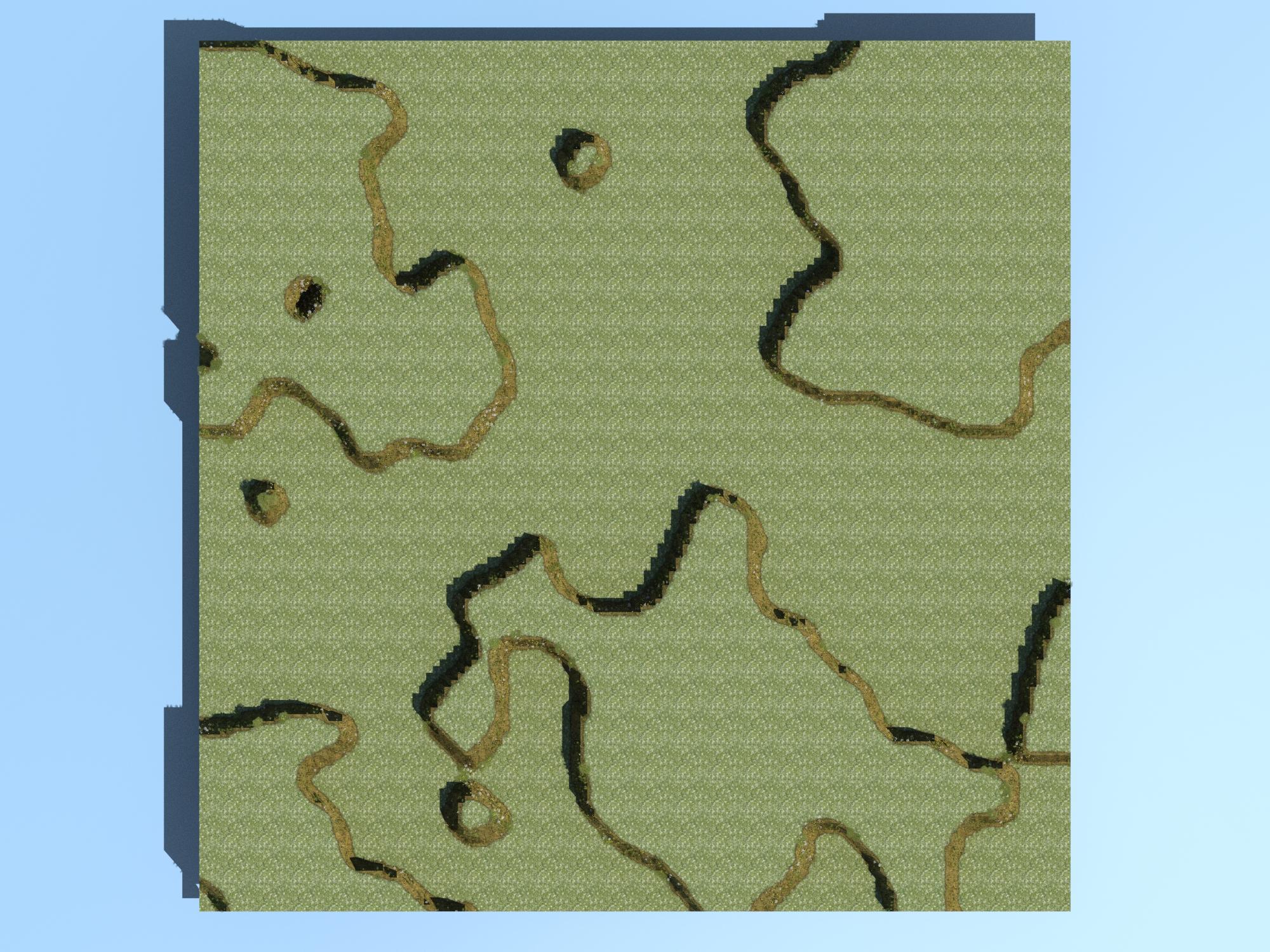

    Experiment: High Contrast Terrain
    Today I stumbled upon a surprise. When the terrain has high contrast areas, UltraScenery did not place any instances in that area. It left bare terrain spots.
    The question is: Why are these areas left bare? Is if by design, or is it a bug? UPDATE: HowieFarkes has confirmed this as a script bug in version 1.0.2 and he will fix it in a future update. UPDATE: This has been corrected in UltraScenery 1.1.0.
    Let's see what is going on:

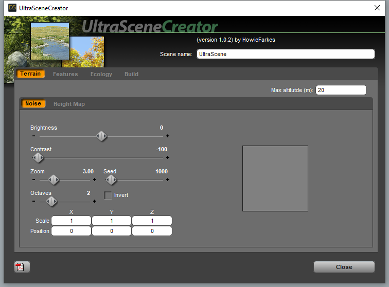

    1) Use high contrast Noise Terrain settings (no Height Map used)
    1.  Set the Terrain settings as shown in the image. Notice that there are white areas in the terrain. White is high, and black is low. Solid white would be a high flat area, like a mesa. In this test case, the maximun height is only 5, so the whole terrain is not very "high".
    2. Set the Features tab to No Feature.
    3. Set the Ecology tab to Grassland 1.
    4. Build the scenery.
    5. Render a top down view of the whole UltraScene.
    6. Render an angled view of the whole UltraScene to get an idea of the terrain contours.
    7. Observe that areas corresponding to the white areas on the Terrain Noise did not get any plant instances. Bare terrain texture is vsisble.

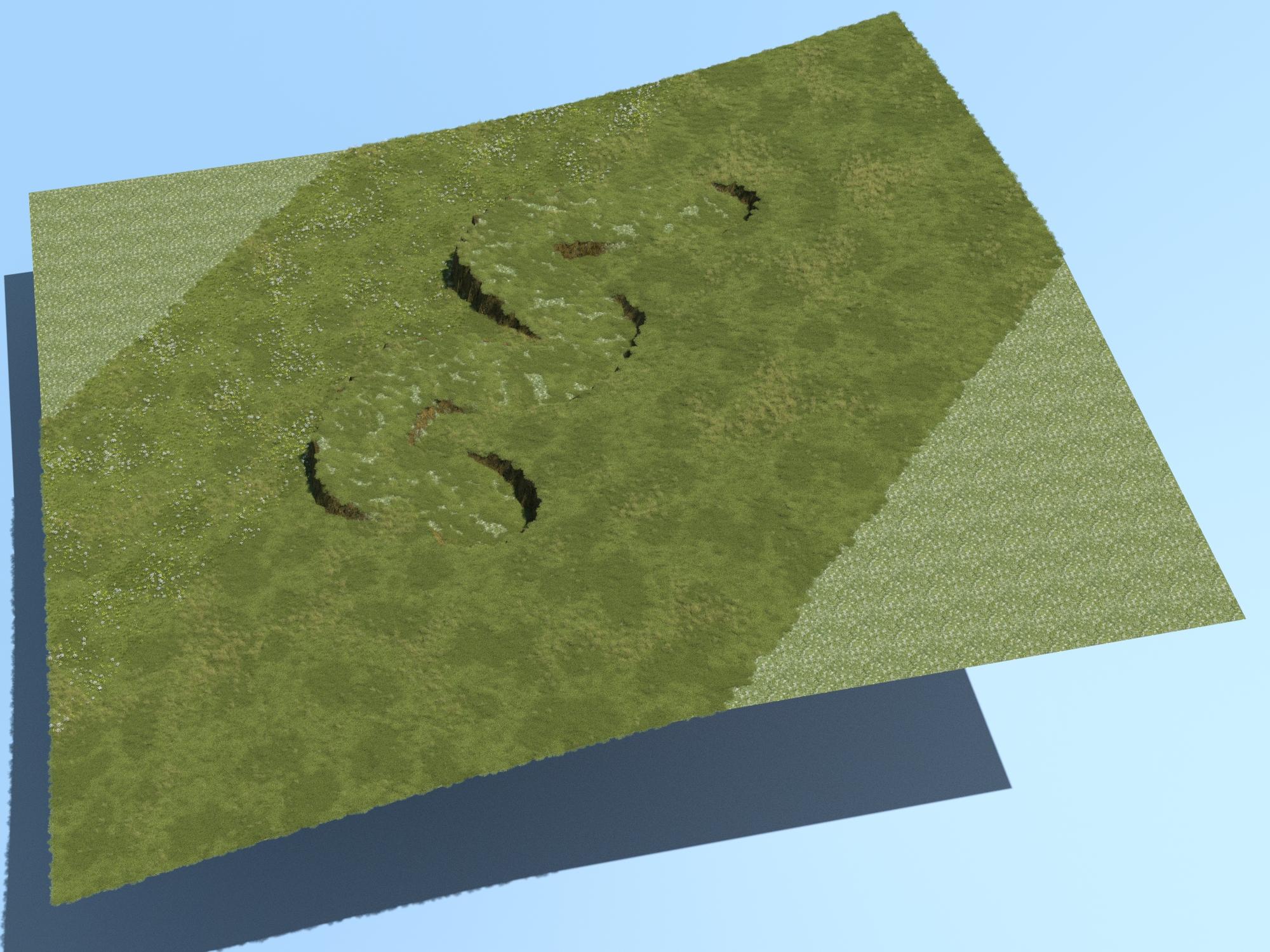

    2) Push contrast Noise Terrain settings to the max (no Height Map used)
    1.  Set the Terrain settings as shown in the image. Notice that there are black areas and white areas in the terrain with no gray in between. White is high, and black is low. Solid white would be a high flat area, like a mesa. Solid black wouid be low flat areas like the ground. In this test case, the maximun height is only 5, so the whole terrain is not very "high", but the exteme difference between black and white will be very visible.
    7. Observe that areas corresponding to the white areas on the Terrain Noise did not get any plant instances. Observe that areas corresponding to the black areas on the Terrain Noise did not get any plant instances.Bare terrain texture is vsisble almost everywhere. there are only a few grass instances on the slope between the low and the high areas.

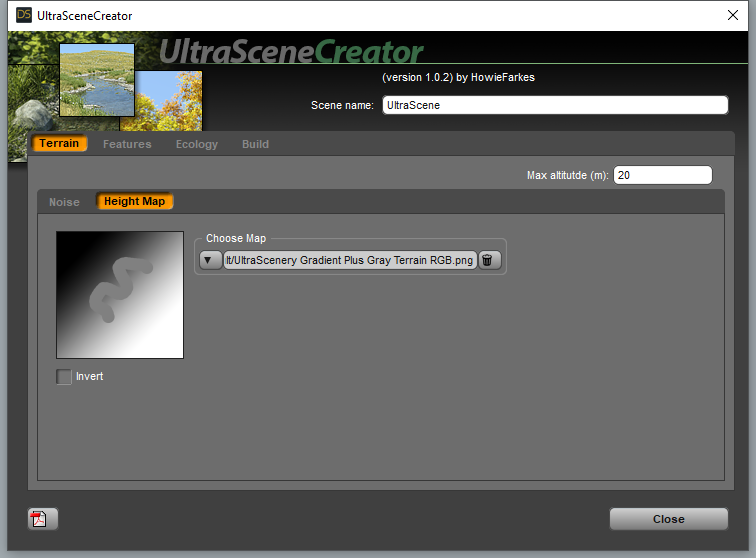

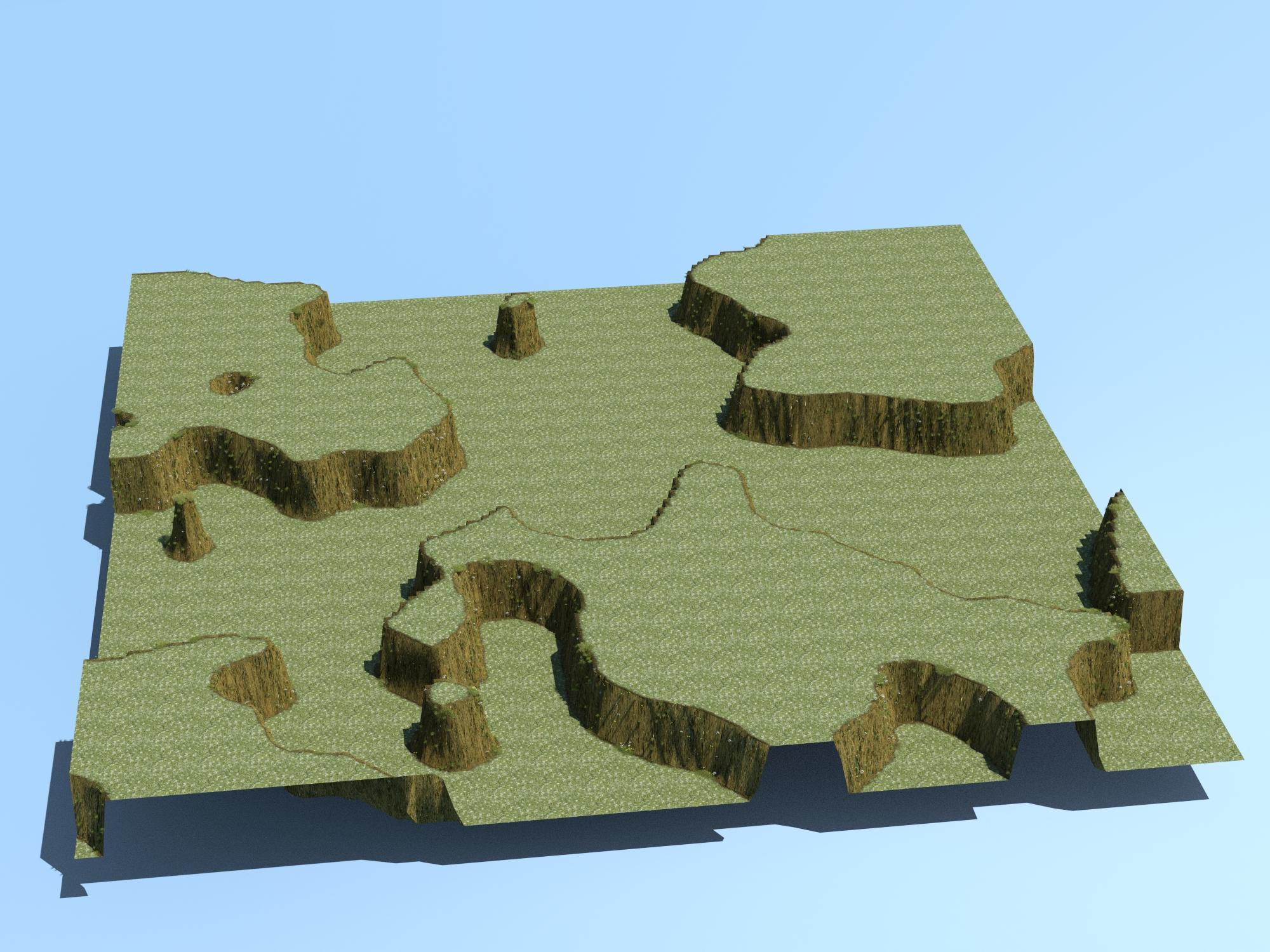

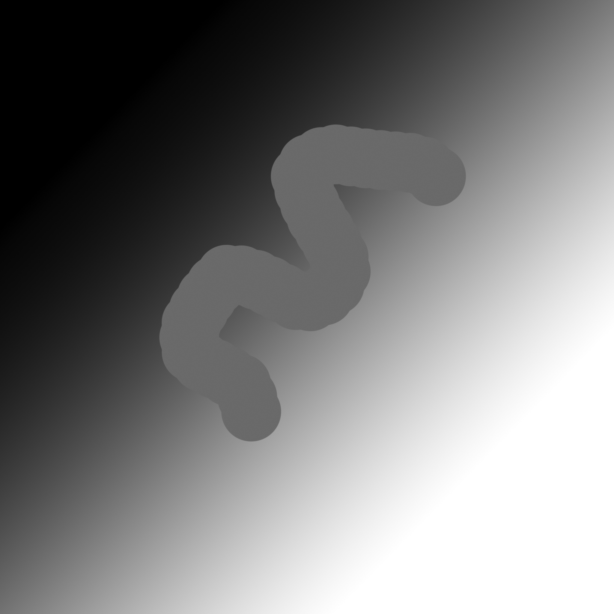

    3) Use high contrast Height Map file
    1. First, create a Height Map. I used Photoshop, but any image editing software will work. I created a gradient from black to white, with some all black area in one corner and an all white in the opposite corner. Then I set my brush to a mid gray value of 128 and drew a squiggle in the middle of the gradient. So now my Height Map has solid black, gray, and white and a gradient in between. I saved my image three different ways: RGB, grayscale, indexed color, because SURPRISE - the results differ depending on how you save the Height Map file. Read on...The grayscale version of my height map is attached.
    2. In UltraScenery, set the Terrain Noise settings as shown in the attached image. Contrast is set to the minimum value to make the noise a flat mid gray. (When defining the terrain for an UltraScene, the (optional) Height Map is combined with the Noise terrain settings. If you don't want the Noise setting to affect your Height Map, set the Noise contrast control to the minimum value (flat mid gray).) Height is set to 20 to make the terrain shape more pronounced.
    3. In UltraScenery, set the Height Map settings as shown in the attached image. Load the RGB version of the height map.
    4. Set the Features tab to No Feature.
    5. Set the Ecology tab to Grassland 1.
    6. Build the scenery.
    7. Render an angled view of the whole UltraScene to get an idea of the terrain contours.
    8. Observe that terrain corresponding to the black area on the height map got a few plant instances. The terrain area corresponding to the white area is completely bare. The flat mid gray squiggle area is also bare. The large area corresponding to the black to white gradient is covered with plant instances. This is puzzling. What do flat solid color areas of a height map result in bare or almost bare areas?
    9. In UltraScenery, set the Height Map settings as shown in the attached image above. Load the grayscale version of the height map.
    10. Set the Features tab to No Feature.
    11. Set the Ecology tab to Grassland 1.
    12. Build the scenery.
    13. Render an angled view of the whole UltraScene to get an idea of the terrain contours.
    14. Observe that terrain corresponding to the black area on the height map are now completely bare. The terrain area corresponding to the white area is also completely bare. The flat mid gray squiggle area is densly, but not completely, covered with plant instances this time. The large area corresponding to the black to white gradient is also covered with plant instances. This is puzzling. What do flat black and white color areas of a height map result in bare or almost bare areas? Why does a grayscale map behave differently than an RGB map?
    15. Repeat steps 9-13 but load the Indexed Color height map instead of the grayscale map. Observe that the results look similar to the grayscale height map results.

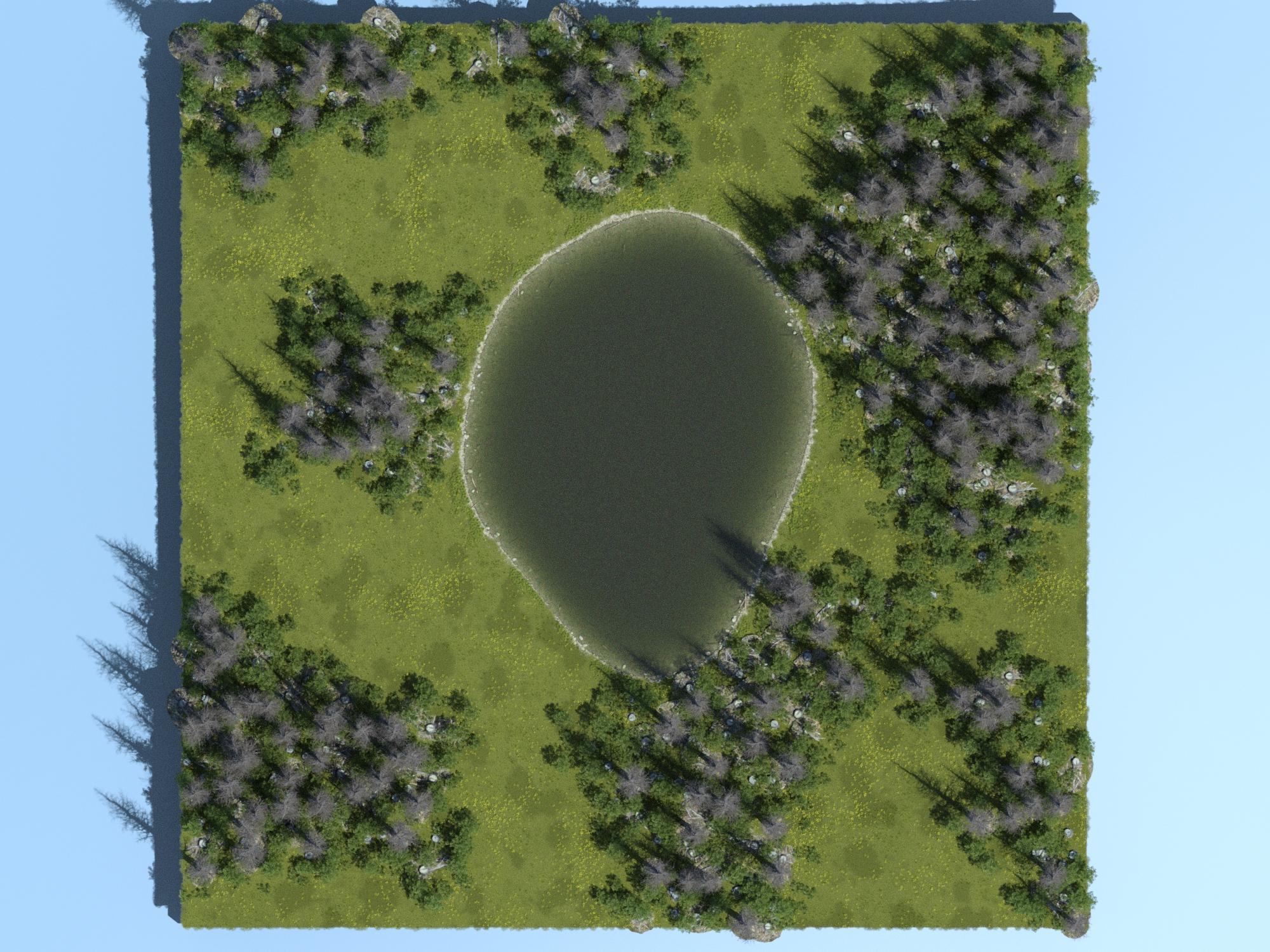

      • Click on the Features tab and select a Feature. I'm going to use Pond 1.
      • Click on the Ecology tab and select your new Ecology (Willow 01 BV for me)

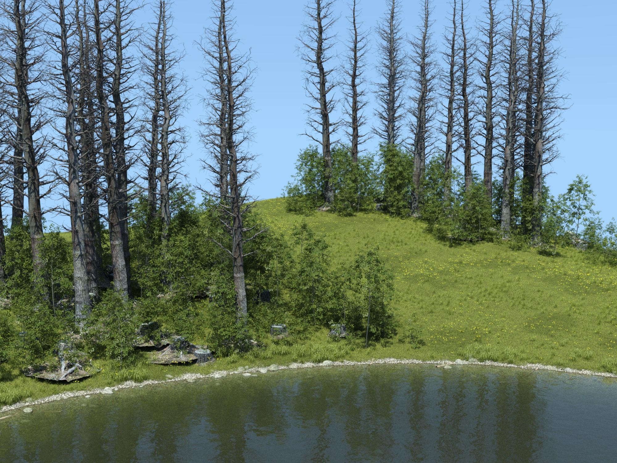

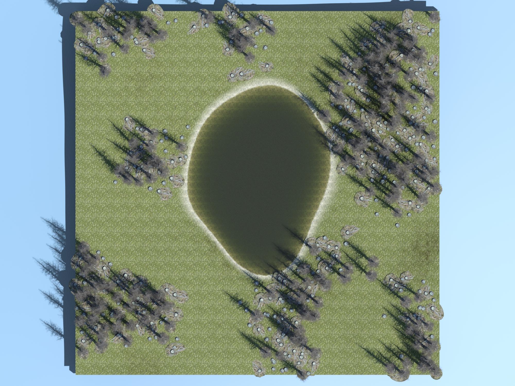

      • Click on the Build tab. You will see lot of layers. Most are left over from the original Ecology we copied, because we didn't change those layers. You will see that the "Aspens" layer is gone. (Aspens (seedlings) and Aspens (young) are still there). Scroll to the end of the list (alphabetical by default) and there is Willows!!!!!!
      • For now, to get a quick test, uncheck all of the layers except Willows (only Willows checked).
      • Click the Build Scene button
      • Apply the USC Late Morning.duf Render Settings Preset. This will give good default lighting and set the Instancing Optimization to Memory.
      • Adjust your camera in the viewport to see the terrain. You should see the same kind of tree proxies that the Aspens used to use, because we only changed the actual props. We did not change the proxy for those props.

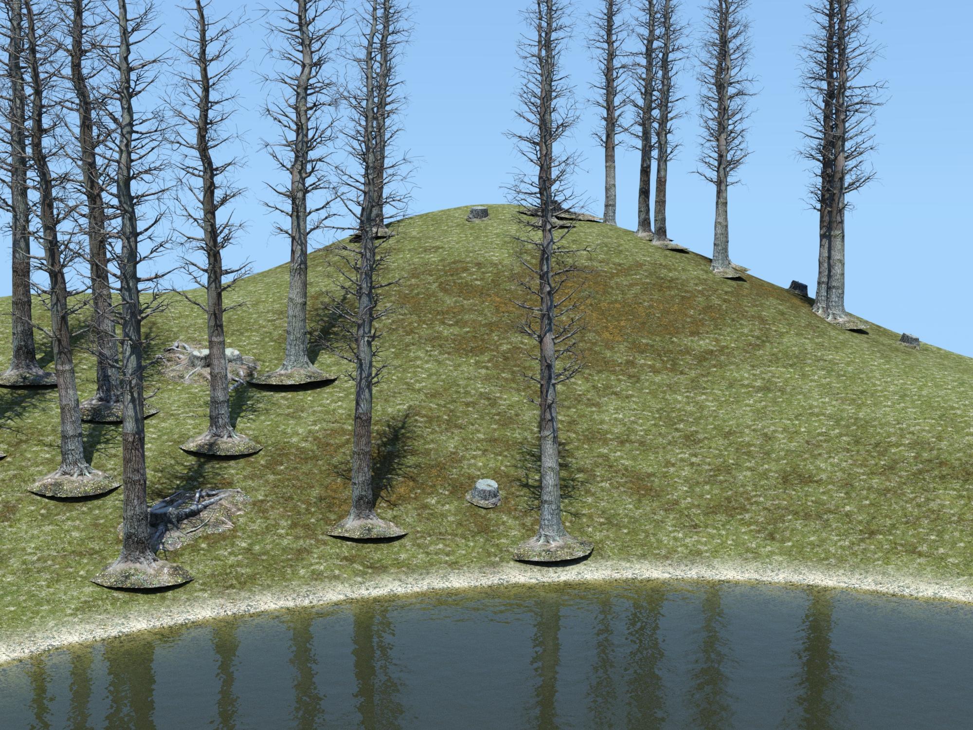

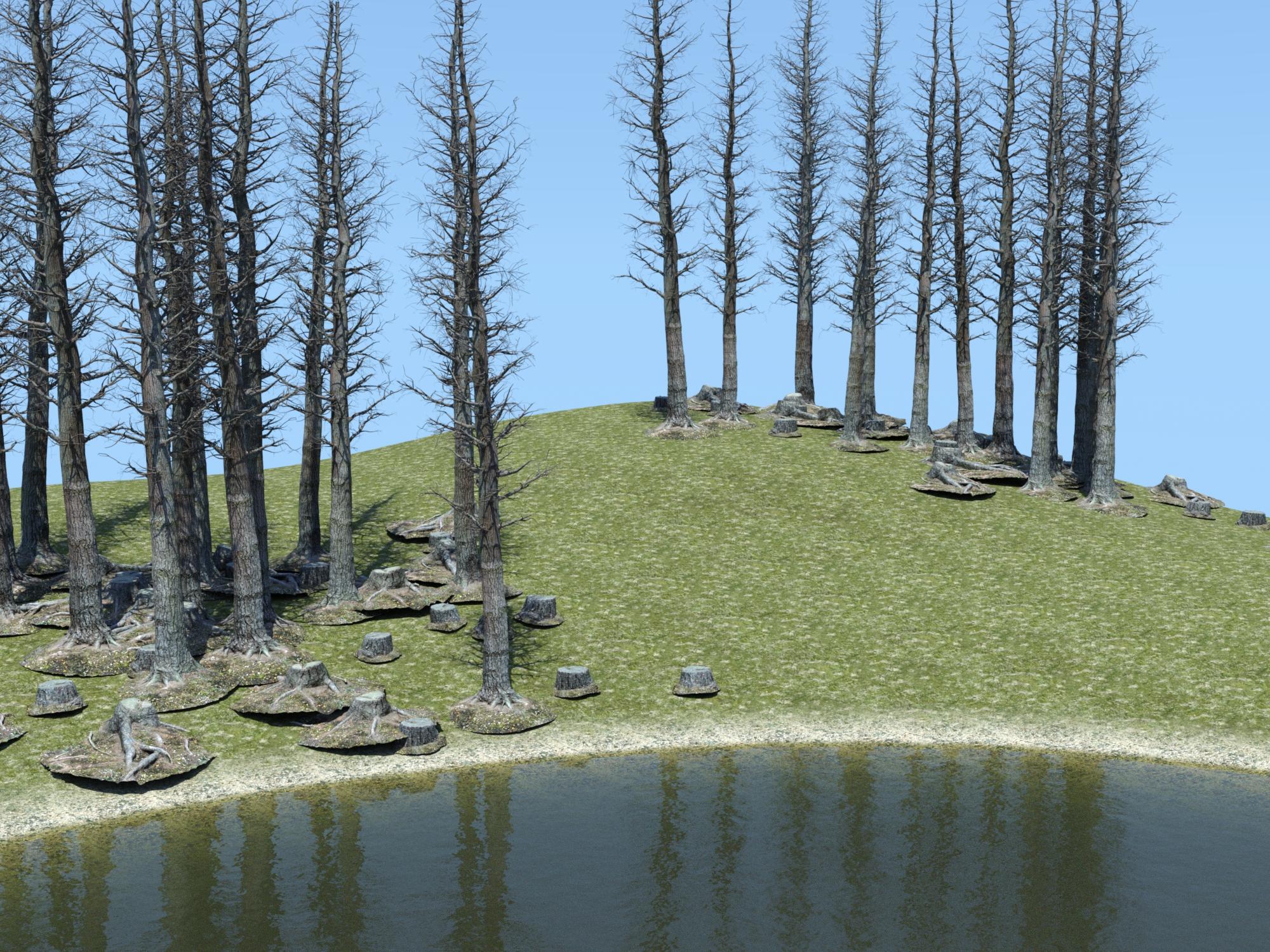

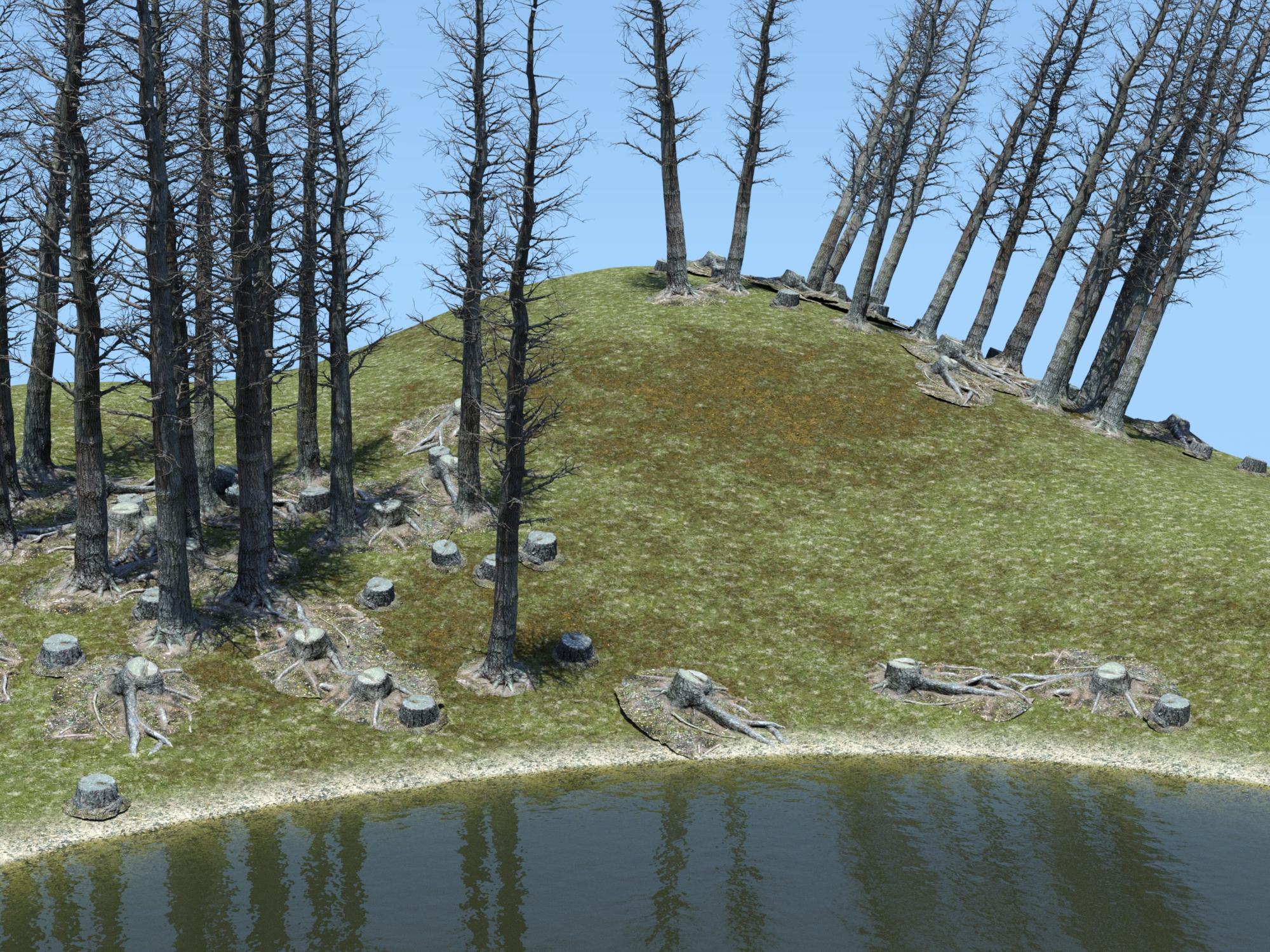

      • But, Oh Oh! What are those willow trees doing in the middle of the pond?! Why are there some lone tree props in the Scene pane? (tdfTree01_Prop (2) and tdfTree02_Prop (2) and they both expand to have children).
      • Zoom in on some the the tree proxies and render the scene.
      • Hmmmm.... It looks like we got willow tree leaves instances but not their trunks. I think I just learned a new lesson! There are problems with using a prop with children props in an UltraScenery Ecology. (This was not preplanned. This is something I just found out while trying this in realtime. I warned you. U-Turn ahead!)

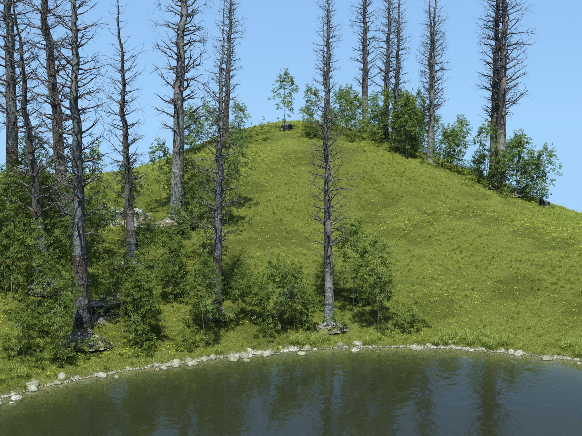

    Experiment: Create a "new" Ecology with other props I own (Continuation 2 - The U-Turn)
    6) Change the props used in the ecology to props that WORK with UltraScenery!
    1. Use simple props instead of complex parent/child props
      • ​​In step 5) 2. above, use the following simple Willow Creek props
        • Willow Creek Tree03 Iray.duf
        • Willow Creek Tree Stump01 Iray.duf
        • Willow Creek Tree Stump02 Iray.duf
    Continue with steps 5) 3. to build the corrected ecology. That works as expected! We get a scattering of dead trees and tree stumps. (Remember, at this stage we have only the Willows layer checked in the Build tab of UltraScenery.) Also as anticipated, the tree stumps are not sitting nicely on the sloped ground.
    Continued Below
    2000 x 1500 - 2M
    2000 x 1500 - 3M

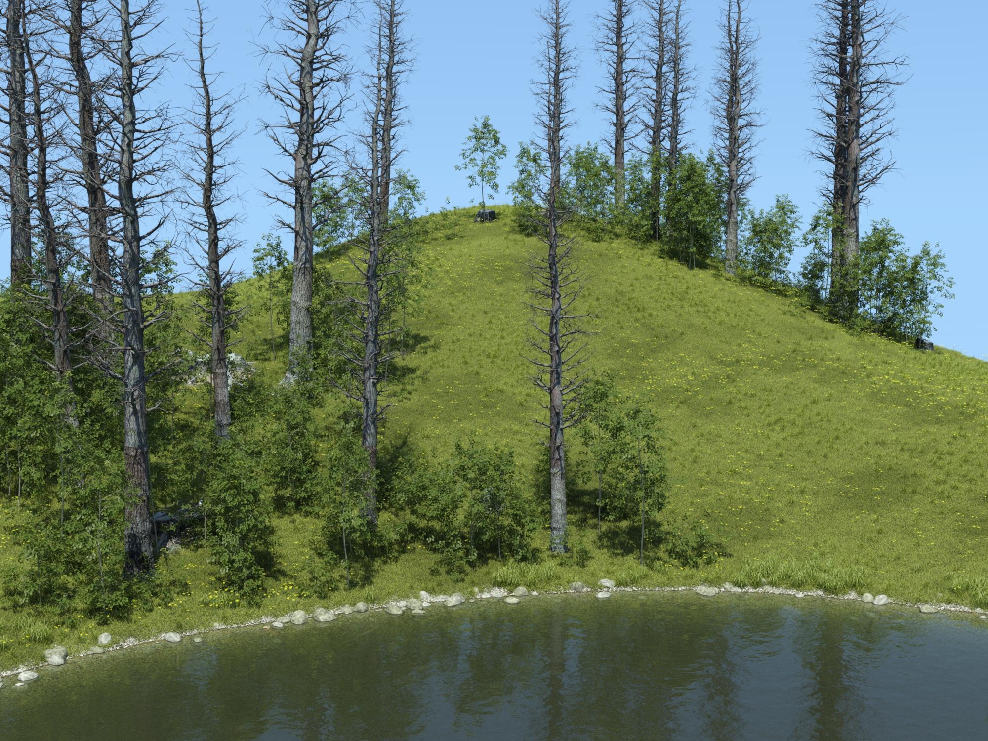

    Experiment: Create a "new" Ecology with other props I own (Continuation 3 - Fixing More Errors)
    6) Test the full Ecology
    1. Rebuild the UltraScene using all layers
      • ​​Select the UltraScene item in the Scene pane.
      • Run the UltraSceneryCreator script. Running it with the existing UltraScene selected will lets us tweak settings without starting over - a nice feature!
      • In the Build tab, check all of the layers.
      • Hm...... no tree proxies are visible. What happened?
      • Expand UltraScene in the Scene pane. We see that UltraScene Instances 1 group is empty. No instances were created. We have only Willows Objects and Aspens (seedlings) Objects, no other layer objects. Something failed.
      • Check the log file (Help/Troubleshooting/View Log File...)
      • Sure enough, there is an error reported there.
        • 2020-05-19 20:10:05.641 WARNING: Script Error: Line 1839
          2020-05-19 20:10:05.641 WARNING: TypeError: Result of expression 'oLayer' [null] is not an object.
      • We have no insight into what script line 1839 is, because the script is encrypted. This will take detective work!
      • We see that last thing that was processed was Aspens (seedlings) layer, because that is the last thing in the Objects list in the Scene pane.
      • Open the ecology JSON file in the text editor again.
      • Search for "Aspens (seedlings)".
      • Sroll through the "Aspens (seedlings)" section to look for anything that might be wrong. We didn't change anything in that layer. Something we did to the "Aspens" layer must have caused a ripple effect error. Remember, we renamed "Aspens" to "Willows".
      • Aha, when we come to the affinity section of "Aspens (seedlings), we see that it is referencing layer "Aspens", but we renamed that layer to "Willows". We need to fix that every place the layer "Aspens" is referenced in the JSON file! Lesson learned: When you rename a layer in an ecology JSON file, you need to find and rename all other references to that layer.
        • I found two places where "Aspens" needed to be changed to "Willows".
          • Change "Aspens" to "Willows" in the affinity section of "Aspens (seedlings)"
          • Change "Aspens" to "Willows" in the affinity section of "Aspens (young)"
      • Save the additional changes you just made to the ecology JSON file. (Validate first if you feel unsure of your editing.)
      • Delete the UltraScene (the one that failed) from the Scene pane. We'll start fresh after the error.
      • Run the UltraSceneCreator script, select the Pond 1 Feature and your new Ecology. Verify that all layers are selected in the Build tab and press the Build Scene button.
      • OK! That's better! Tree proxies are appearing on the terrain in the viewport. The objects for all layers and 138,265 instances are shown in the Scene pane. The log file doesn't report any errors.
      • Now our scene should have our "Willows" (which are just dead willow tree trunks and branches and tree stumps), instead of the large Aspens of the Woodland 2 ecology we started with. All other parts of the Woodland 2 ecology should appear just as in the original ecology.
    In retrospect, after learning that I cannot use the nice willow trees in Willow Creek with UltraSceneCreator and learning that TangoAlpha already has a Willows 01 ecology, I regret my ecology name choice. I could go back and rename everything again to something else, and that might be a good exercise for later. We have bigger fish to fry, as they say. What's in a name?
    Continued below
    2000 x 1500 - 2M
    2000 x 1500 - 3M
    Post edited by barbult on

    Experiment: Create a "new" Ecology with other props I own (Continuation 4 - Optimizing Instance Placement)
    This section will investigate the alignnormal setting of a layer.
    Because we changed the props that were used, some of the instance placement parameters in the ecology JSON file may not be optimum for our props. Let's take a critical look at our scene. I see these things I would like to improve"
    • The trees and stumps are not sitting flat on sloped ground. They seem to be partially floating
    • Stumps and trees are too close together and are overlapping at their base
    • The trees do not vary much in size
    7) Make things sit flatter on the ground.
    1. Make a backup copy of your new ecology file, before we change it again!
    2. Open the ecology JSON file in the text editor
    3. Find the "Willows" layer section. (It will say "name" : "Willows",)
    4. Look over the various settings for the layer. If you have used UltraScatter or UltraScatterPro a lot, you will recognize some parameters. Others you can guess at, and other remain a mystery for future experimentation.
    5. Down in the rotation section we see "alignnormal" : false. Let's change that to true so that the instances align with the normal vector of the ground they are sitting on instead of always pointing straight up. I anticipate that this is going to make the tall trees point off in unrealistic growth angles on very sloped ground.
    6. Save the JSON file. (Validate first if you feel unsure. This was a trivial change, but even that can result in failure if, for example, you delete the comma after the value)
    7. If you still have Daz Studio open and your UltraScene in the Scene pane, select the UltraScene so it can be modified. Otherwise start Daz Studio again.
    8. Run the UltraSceneCreator script.
    9. Verify that you have Pond 1 Feature selected and your new ecology selected.
    10. In the Build tab, uncheck everything but Willows again. It will be easier to see the changes if other layers are not in the way. With only one layer selected, it will build quickly.
    11. Press the Build Scene button
    12. Render the scene to evaluate the changes.
    13. The stumps look better overall. Some of the large stumps are still partially floating above the curved ground. (A flat thing does not conform to a curved surface.) The trees, as suspected, are going off at a rakish angle.
    14. Let's see how this looks with a steeper terrain. Rebuild the UltraScene with a Max Altitude of 10 meters instead of 5 meters (on the Terrain tab).
    15. Render the scene.
    16. The trees are really going at a bad angle now.
    17. Lesson Learned: "alignnormal" : true can help make short things hug the ground, but it is not good for tall things that should be growing straight up, unless they are on fairly flat ground.
    18. Lesson Learned: Big wide props are never going to sit properly on top of curved ground. They are not the best choice for use in UltraSceneCreator.
    Continued below
    2000 x 1500 - 3M
    2000 x 1500 - 3M

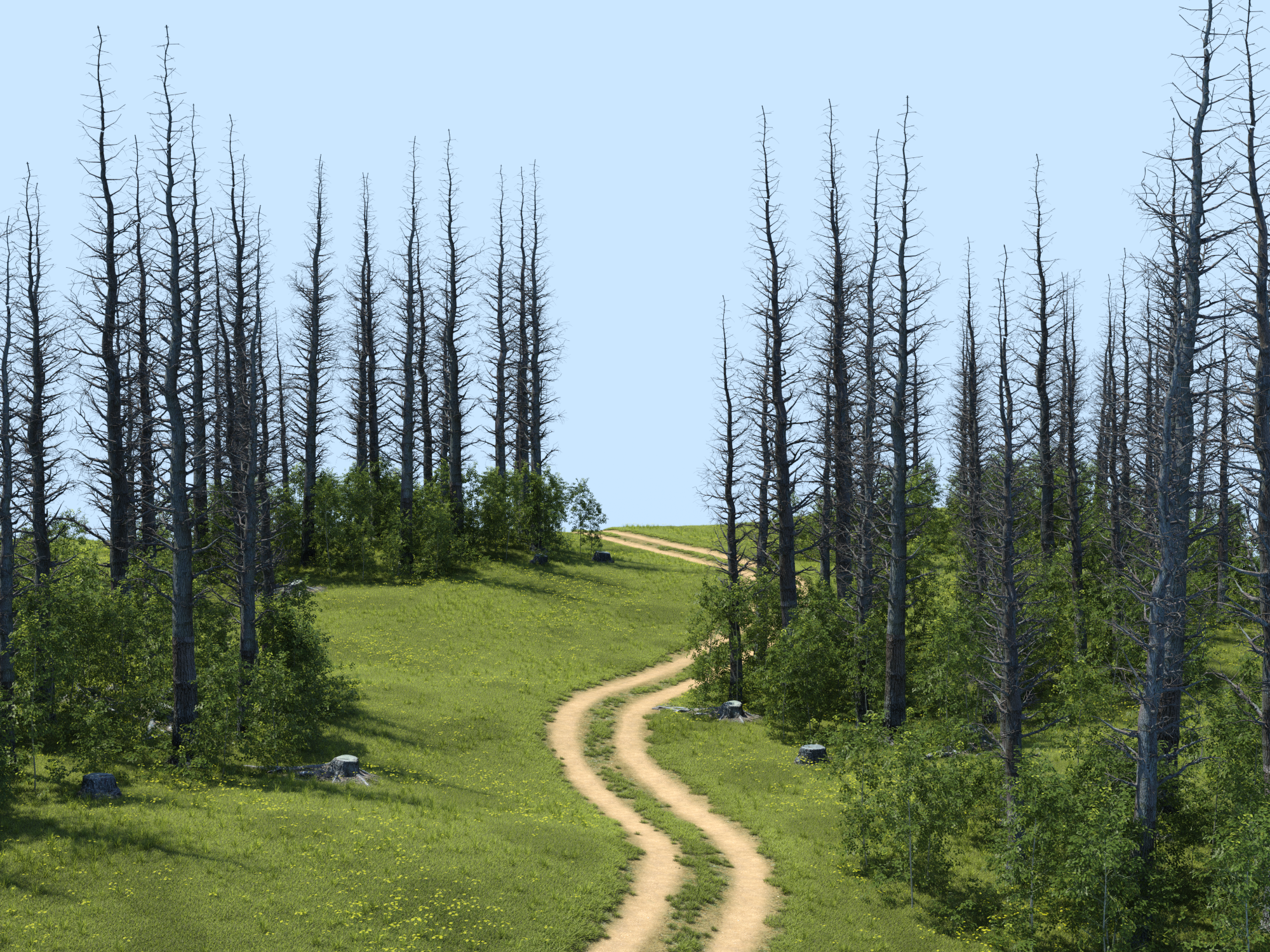

    22. But, my oh my, we have way too many trees and stumps crammed together and overlapping. It is worse than before, because we added a whole layer and didn't change any spacing yet.
    23. Trees are still floating too high above ground. We'll have to deal with that later. When we render all layers, some of the grass and fowers might hide some of that problem.
    Continued below

    Experiment: Create a "new" Ecology with other props I own (Continuation 6 - Optimizing Instance Placement - Part 3)
    We need to adjust the spacing and quantity of trees and stumps, because there are just too many and they are too close together. This section will investigate spacing, seed, affinity, and repel settings for layers.
    9) Adjust the spacing of the trees and stumps
    1. Make another backup copy of your new ecology JSON file, before we change it again!
    2. Open the ecology JSON file in the text editor.
    5. In the "distribution" section we see "spacing". I am guessing that this is like UltraScatterPro and will control the minimum distance between instance center points. Edit: I guessed wrong. HowieFarkes explains how spacing in UltraSceneryCreator differs from UltraScatterPro in this message. It is set to 175. Lets change it to 300 to space them much further apart. I'm assuming these are standard Daz Studio units of Centimeters.
    6. Make the same spacing change in the Stumps layer. (Change 175 to 300.)
    7. Save the JSON file. (Validate first if you feel unsure. This was a trivial change, but even that can result in failure if, for example, you delete the comma after the value).
    8. If you still have Daz Studio open and your UltraScene in the Scene pane, select the UltraScene so it can be modified. Otherwise start Daz Studio again.
    9. Run the UltraSceneCreator script.
    10. Verify that you have Pond 1 Feature selected and your new ecology selected.
    11. In the Build tab, uncheck everything but Stumps and Willows again.
    12. Press the Build Scene button.
    13. Render the scene to evaluate the new spacing.
    14. They are further apart now. Hence there are fewer of them.
    15. We still have trees overlapping with stumps. I think if we change the JSON file to use different random seeds for the two layers, that might help that. Let's give them different spacing, too.
    16. Change the spacing of Stumps from 300 to 350.
    17. Change the Stumps "seed" from 2000 to 2100.
    18. Validate if you are unsure and save the JSON file.
    19. Return to Daz Studio and run UltraSceneCreator to build the scene again (You know how to do this now; I'm not going to list all the individual steps.)
    20. Well, that helped, but it wasn't enough. We need to keep the stumps some distance away from the trees. That is where affinity and repel can help. Affinity is attraction; it will make instances tend to gather around the target. Repel will make instances stay away from the target.
    21. Scroll to the "Aspens (young)" layer to see an example of how affinity and repel are used. Affinity is at the very end of the layer settings. We see that affinity is set to a distance of 300 and repel is set to a distance of 30. That means that the young aspens instances will tend to be place within 300 units (centimeters?) from a Willow but not closer than 30 units. Let's copy this whole affinity block and paste it into the affinity for the Stumps layer. Be sure to copy everything between [ and ] in the affinity section. Paste that in to the Stumps layer affinity in place of the simple empty [].
    22. Stumps are a lot bigger in X and Z dimensions than young aspens, so I am going to change the Stumps affinity to 400 and the repel to 200. I want to keep them more than 30 units away from the trees, because some of those stumps are very large. We'll see how those values work and adjust if necessary.
    23. Validate the JSON and save the file when you have no errors.
    24. Return to Daz Studio and and run UltraSceneCreator to build the scene again.
    25. I don't see trees overlapping with stumps anymore. Affinity and repel helped.
    26. The trees still look very close together, though. I'm going to increase the "Willows" spacing to 400.
    27. Validate if you are unsure and save the JSON file.
    28. Return to Daz Studio and run the UltraSceneCreator to build the scene again.
    29. The spacing of trees and stumps is looking good to me. I'm satisfied with the changes we've made to spacing, seed, affinity and repel.
    Top down view
    Continued below
    Willow spacing 400 and Stumps spacing 350 different seeds affinity and repel.jpg
    2000 x 1500 - 3M
    Willow spacing 400 and Stumps spacing 350 different seeds affinity and repel Top view.jpg
    2000 x 1500 - 2M

     I chose tree props with wide bases, and I've learned that those just don't work well with UltraSceneCreator. This section will investigate the slope setting and other ways to work around the floating prop problem.
    11) Prevent the trees from being placed on steep terrain
    3. Scroll to the "Willows" layer and locate the  "distribution" section. That section contains a "slope" section. The min and max slope control the the steepness of the terrain that the instances will be placed on. Currently the Willows are set to a min slope angle of 0. That is flat horizontal ground. That is fine. The max slope angle is set to 90. That is 90 degree vertical straight up slope. It is pretty clear to see that these trees with their wide base are going to look ridiculous with the base sticking straight out of a vertical hillside. But we can see that even with a gentle slope (maybe 20 or 30 degrees), the tress still float some. If we constrain the max slope to a very small value that would not show much floating, we will get very few trees on a hilly terrain. Hmmm... we will need something more than just slope to deal with this problem. The only thing I have found so far is the workaround of translating all the tree instances (not tree objects) in the negative Y direction AFTER building the scene. Unfortunately, this has to be done after every build. It is cumbersome and error prone. I hope some future UltraSceneCreator version devises some way to deal with this problem, but for now, that is what we have. I would love to hear any better ideas you have!
    4. Change the slope max angle from 90 to 45, in an attempt to keep the floating tree base problem to a manageable state. This change will only affect very steep terrain, with an angle over 45 degrees.
    5. Validate if you are unsure and save the JSON file.
    6. Return to Daz Studio and run the UltraSceneCreator to build the scene again.
    12) Move the floating props down so the bases are below ground
    After you have built your UltraScene, it you still have floating prop bases try these steps.
    1. Open the Scene pane in Daz Studio
    2. In the search box in the Scene pane, type tree
    3. Expand UltraScene and UltraScene Instances below that.
    4. Select all Instance groups with the tdfTree03_Prop in the name. Don't select the USC Tree instances, those are the aspens.
    5. Open the Parameters pane.
    6. Set the Y translate value to a negative number. The required value will depend on the slope of the terrain. I am going to try -25 for my terrain.
    7. Render the scene. If the tree bases are still floating, modify the Y Translate value.
    8. If tree stumps are floating, select the tree stump instances in the Sene pane and adjust their Y Translate values to a negative value. They shouldn't need much if any adjustment, because they are already aligned to the ground normal.
    9. Render the scene. Continue adjusting the Y Translate of the floating instances until you are satisfied with their appearance in the render. Remember that you will have to do this again every time you rebuild the UltraScene.
    Continued below

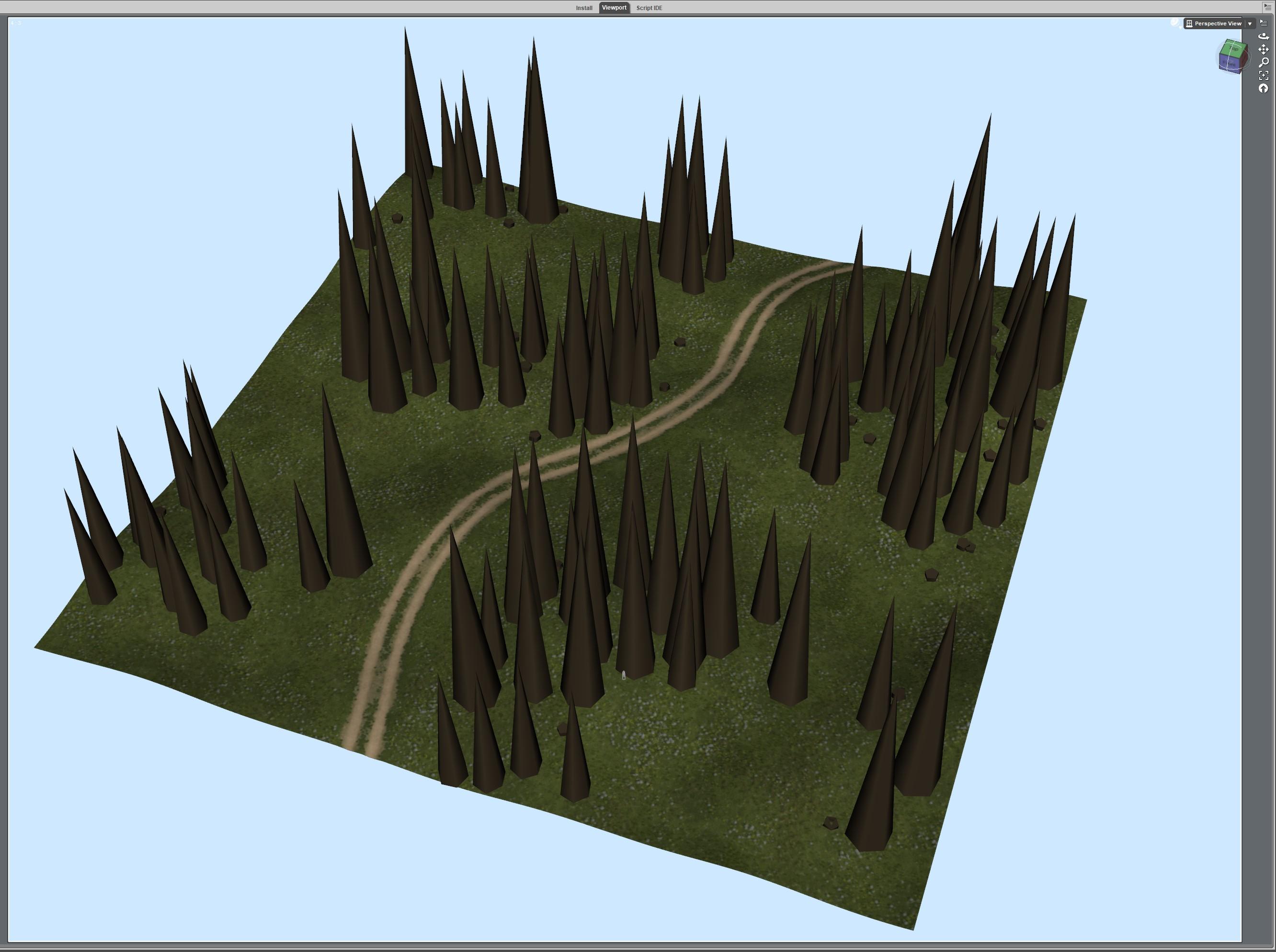

    Experiment: Create a "new" Ecology with other props I own (Continuation 10 - Creating Representative Proxies)
    Up to this point, we've been using the tree proxies that were part of the ecology we copied. They aren't very representative of the props we are using, especially the stumps! It has made visualizing the scene before render difficult. I should have made proxies early on. But better late than never. They will be useful in the future when the new ecology is used. Proxies are generally displayed only for large trees, as far as I can tell. I chose to also make proxies for the stumps.

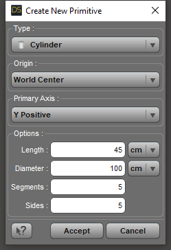

    14) Create simple low-poly props to represent the size and shape of the props added to the ecology; these will be our proxies
    1. In Daz Studio, start a new empty scene.
    2. Load the Willow Creek Tree03 Iray prop from the original Willow Creek product.
    3. Measure the size of the tree using whatever means you have available. I use a freebie script that is unfortunately no longer available. You can use Measure Metrics, or a measurement wall prop, or create a primitive object and scale it until it is the size of the tree and use that scale factor to determine the tree height. I determined that the tree is about 1500 CM tall and the wide base has a diameter around 285 CM.
    4. I will use a primitive cone as a proxy shape for this tree. In Daz Studio go to the Create menu and select New Primitive... When the dialog opens select Cone in the first drop down box and set the rest of the values as shown below. Click Accept. The cone will appear in the scene. Verify that it is about the size of the tree.
    5. Select the Cone in the scene pane. Click on the name Cone again to get it into edit mode so you can rename it. I'm going to change the name of my Cone to USC Dead Tree Proxy BV, following the naming convention of the other UltraSceneCreator proxy files and tacking my initials on. Hit the Enter key to confirm the name change.
    6. With the USC Dead Tree Proxy BV still selected in the Scene pane, open the Surfaces pane.
    7. Change the Base Color of the proxy to a brown, to represent the dead tree trunk.
    8. In the File menu. select Save As then Support Asset then Figure/Prop Assets.
      • When Filtered Save window pops open, select a place within your content library to save the tree proxy file. You can save it in the UltraScenery/Plants folder with other proxy props, or you can save it someplace else and leave the UltraScenery folder pristine for purchased items. Your content library probably already has a Props folder. You can create a subfolder with your name and save your new proxy there. The important things are that the location is within a Daz Studio content library and that you remember where you saved it! Give the file the same name as the name you used in the Scene pane. Click the Save button.
      • When the Figure/Prop Assets Save Options dialog opens, verify that the Asset Directory is set to your content library. Do NOT let it select Daz Connect. Your name should appear as the vendor and you can enter any product name you choose. The item name should be the same proxy name you used for the object in the Scene pane. Set Content Type to Prop. Optionally, also Set Category to Default/Props/landscape/Plants. Click the Accept button.
    9. Follow the steps above create a proxy for the tree stump. I used a cylinder instead of cone for the stump proxy. I made it about the size of the small stump. It doesn't have to match the exact dimensions of the object it represents, but it is nice for it to have the general shape and size. I chose to use the same proxy for both stumps, because I was feeling lazy. You can create a separate larger proxy for the large stump if you wish. You know how to do that now.
    15) Edit the ecology JSON file to use the new proxies

    16) Build an UltraScene with the new ecology and verify that the new proxies are displayed.
    I was bored with the pond, so I tried the new ecology with Dirt Track 1.
    A rendered view
    We are done! We have created an ecology that we can use with UltraSceneCreator. But it can be improved. See below.
    This was quite an effort. Now you can appreciate the value you receive when you buy a whole pack of ecologies from the Daz Store PAs for a few dollars!

    Experiment: Modify complex props with parent/child hierarchy so they can be used in UltraSceneCreator
    In suddenly hit me a couple days ago, that there is a way to modify those complex props, like the Stonemason Willow Creek willow trees with parent/child hierarchy, to work with UltraSceneCreator. It amounts to exporting the whole tree hierarchy as an OBJ and importing it back in to Daz Studio. I'll flesh out the details when I actually do it. I'm pretty sure that should work. We'll see...
    1. Start with an empty scene.
    2. Load the hierarchical prop, in this example, Willow Creek Tree01 Iray.duf from the Stonemason Willow Creek product.
    3. Export the tree to OBJ format. (In Daz Studio, File>Export then choose Wavefront OBJ as the exported file type). I'm calling my exported object Willow 1 All.OBJ.
    4. Import the exported OBJ file. (In Daz Studio, File>Import then select the file you exported.) Import with the same scale setting you used to export the original file.
    5. Select the imported object in the Scene pane.
    6. Save the imported object as a Prop: (In Daz Studio, File>Save As>Support Assed>Figure/Prop Assets... Select a place in your Content Library to save it and give it a name. Fill out the dialog and click Accept.)
    I performed this process on both Willow Creek Tree01 Iray and Willow Creek Tree02 Iray.
    That now creates a prop that you can use with UltraScenery in an ecology that you create. But, it can be improved.
    1. The OBJ import/export will not retain all of the material settings of the original prop. To restore those, copy the surface settings from the original prop to the corresponding surface of your newly created prop and resave the prop.
    2. If desired, modify the prop origin and shape of the wide base as I did for the dead tress example and resave the prop.
    3. Update the failed USC Willow 01 ecology we created and abandoned before, to use the newly saved Willow Tree prop(s).

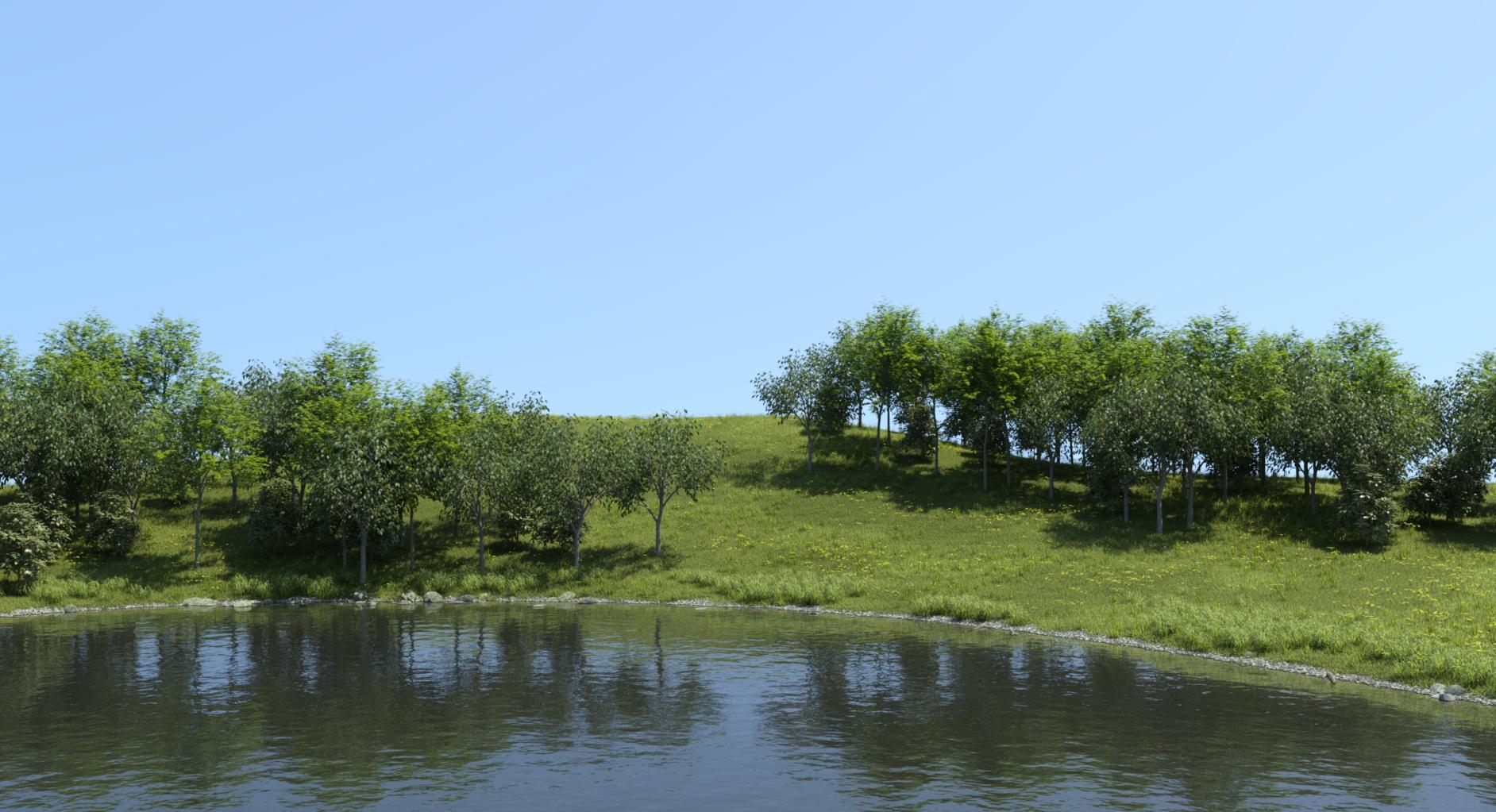

    This is a scene I created with my USC Willow 01 BV ecology.
    2560 x 1440 - 3M
