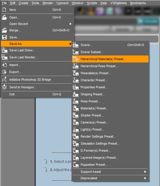

    Experiment: Modify Iray Surface Settings to Get More Color Variety in an UltraScene (Continuation 2)
    5) Save a Hierarchical Materials Preset
    1. After you have made all the surface settings changes to add variety to the color of your tree leaves and ground leaves, it is important to save a materials preset so you can apply the changes again to another UltraScene build of the same ecologies. In order to change the whole ecology at once, without individually applying materials presets to every object in the scene, we will create a Hierarchical Materials Preset.
    2. Select the composite UltraScene in the Scene pane. I think it is important to leave the name "UltraScene". If it is changed, I'm not sure the preset will apply properly to another UltraScene in the future. I've had problems with things like that in the past.
    3. In the Daz Studio menus, select File>Save As>Hierarchical Material(s) Preset...
    4. Select a location to save your new preset. I chose to create a "Materials BV" subfolder in the Environments/Landscapes/UltraScenery folder so it is easy to find. (BV are my initials, so I know this is something I created and it won't interfere if UltraScenery is updated to include a Materials folder some day.)
    5. Give the new preset a name. I chose "USC Harpwood Beach Mixed Color BV".
    6. Click the Save button.
    7. A Hierarchical Materials(s) Preset Save Options dialog will open. This lets us choose what objects to save materials for. Since we changed only trees and leaves on the ground, that is all we need to select in this dialog. Since we built only trees and leaves when creating out UltraScene, we don't have a lot that we need to filter out. Uncheck the UltraScene itself, so that when the preset is applied to another UltraScene, it doesn't overwrite the materials of the UltraScene itself. We only want to overwrite things we explicitly changed (the trees and leaves). I like to uncheck the proxies, if I didn't change them. To uncheck them, expand the UltraScene and click to remove the checkmark on the proxies. If you changed the material color of the proxies, leave them checked.
    8. Click Accept in the A Hierarchical Materials(s) Preset Save Options dialog.

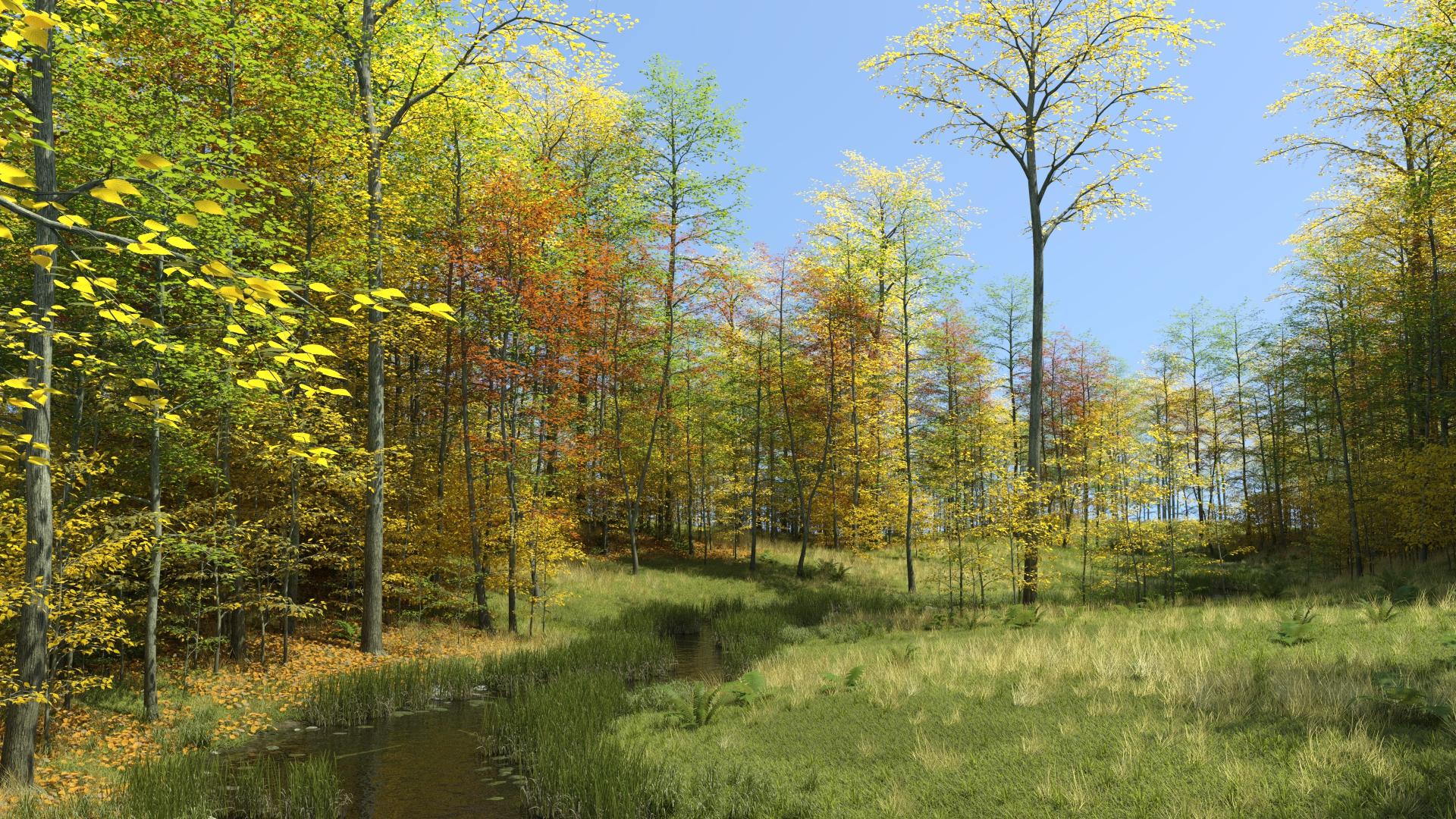

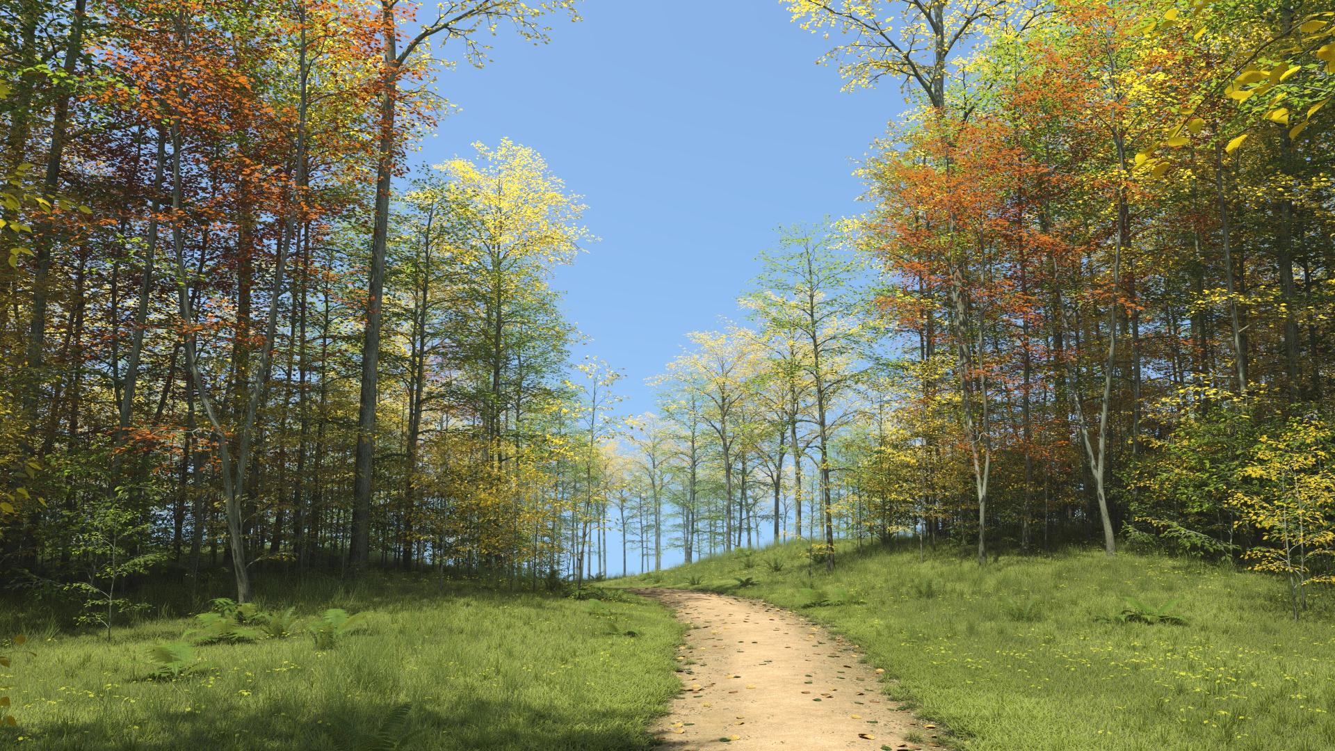

    Here's an image I made with Track 1 and the new Hierarchical Materials Preset
    And here's one with Track 2

  • richardandtracyrichardandtracy Posts: 7,957
    These views both look like late autumn between the start & end of leaf drop. They are stunning. Simply the only words for it.
    Regards,
    Richard
  • barbultbarbult Posts: 27,328
    Regards,
    Richard
    Thank you, Richard. It is nice to know someone is looking!

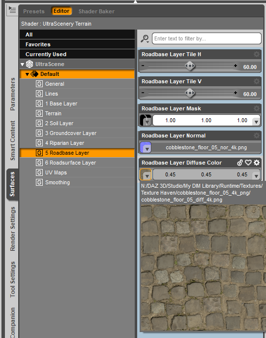

    Experiment: Create a Cobblestone Material for the UltraScenery Dirt Track Features
    Are you tired of all of your UltraScenery renders, that use one of the Dirt Track features, having the same dirt texture? It is pretty easy to modify the texture files used in the UltraScenery Terrain Shader to use different image files. After substituting different images, save a Materials Preset to use again later. The Materials Preset will be applied after building the UltraScene but before rendering the scene. Your runtime/textures folder is probably full of interesting textures to try. You can also download interesting textures online. If you want to download texture files, check the usage license before downloading, so you know whether you can use them for this purpose. One source of free, public domain, CC0 textures is texturehaven.com.
    This is the approach I am going to take:
    • Download cobblestone textures from the internet (making sure the license allows me to use the textures for this purpose)
    • Modify the settings of the UltraScenery Terrain surface to use the downloaded textures
    • Save a materials preset that I can later apply to any UltraScene using a Dirt Track feature.
    1) Download cobblestone texture files from texturehaven.com
    1. Open your web browser (I use Chrome).
    2. Navigate to https://texturehaven.com/tex/?c=floor&t=cobblestone_floor_05
    3. Where it says Download:, click the All Maps button. (We don't really need all of the maps for this exercise, but it is easy to get them all at once and the ones we don't need now may be useful for future projects.)
    4. Select one of the map resolutions (I used 4k PNG).
    5. Depending on how you have your browser configured, either the download will start and go to your previously specified download folder, or a window will pop up asking you where to save the file. In the latter case, select a location and save the file.
    6. Close the web browser; we are done with it now.
    7. Locate the zip file that was downloaded and uncompress it. I use 7Zip to do that. You can also use the features built into Windows or WinZip, etc.
    8. In the File Explorer built into your OS, open the Runtime/Textures folder of your content library.
    9. Create a new Texture Haven subfolder in runtime/textures.
    10. Copy the unzipped cobblestone texture files into Runtime/Textures/Texture Haven. I recommend copying them into a subfolder named the same as the zip file you downloaded. So, I have Runtime/Textures/Texture Haven/cobblestone_floor_05_4k_png with 7 PNG texture files in it when I am done.
    2) Build a simple UltraScene which we can use as a basis for changing textures
    1. In Daz Studio, create a new Scene.
    2. Run the UltraSceneCreator script.
    3. Select the default Terrain settings.
    4. Select Feature Dirt Track 2.
    5. Select Ecology Grassland 1.
    6. On the Build tab, hide (click the eyeball to close it) all of the layers, to make this a quick build. All we need is the UltraScene itself, none of the vegetation.
    7. On the Build tab, click the Build Scene button.
    3) Modify the texture settings of the UltraScene
    1. Select the UltraScene in the Scene pane.
    2. Open the Surfaces pane.
    3. In the Surfaces pane, select the Editor tab.
    4. Change the images and image tiling in the 5 Roadbase Layer
      • Select 5 Roadbase Layer.
      • Click on the small square image icon for the Roadbase Layer Normal.
      • In the pop up window, select Browse... (Browse is at the top.)
      • Navigate to the folder where you saved the cobblestone texture files in your content library (Runtime/Textures/Texture Haven/cobblestone_floor_05_4k_png)
      • Select the cobblestone_floor_05_nor_4k.png file and click the Open button.
      • Click on the small square image icon for the Roadbase Layer Diffuse Color.
      • Navigate to the folder where you saved the cobblestone texture files in your content library.
      • Select the cobblestone_floor_05_diff_4k.png file and click the Open button.
      • The cobblestones in the image texture file are larger than I want, so I am going to tile them more. Change the Roadbase Layer Tile H from 40 to 60.
      • Change the Roadbase Layer Tile V from 40 to 60.
    5. Change the images and image tiling in the 6 Roadsurface Layer
      • Select 6 Roadsurface Layer.
      • Click on the small square image icon for the Roadsurface Layer Normal.
      • Click on the small square image icon for the Roadsurface Layer Diffuse Color.
      • The cobblestones in the image texture file are larger than I want, so I am going to tile them more. Change the Roadsurface Layer Tile H from 40 to 60.
      • Change the Roadsurface Layer Tile V from 40 to 60.
    6. Change the diffuse color of the Roadbase and Roadsurface layers to make them different. The UltraScenery Terrain Shader blends these two layers together, so by making them slightly different colors, the surface will have more interesting tonal variation and look less tiled. It is a very clever shader! The cobblestones in these textures are a little brighter than I would like, so changing the diffuse color will also allow me to darken them.
      • Click on the color value bar, in the Roadbase Layer Diffuse Color.
      • When the Select Color dialog pops up, select a gray color to darken the image. I selected a gray value of 177, which is a mid gray.
      • Click the OK button in the Select Color dialog to apply the color change and close the dialog box.
      • Click on the color value bar, in the Roadsurface Layer Diffuse Color.
      • When the Select Color dialog pops up, select a gray color to darken the image. I selected a gray value of 205, which is a light gray.
    7. Render the scene to see your new cobblestone track.
      • In the Scene pane, position a camera where it can see the Dirt Track part of the UltraScene.
      • Render the scene. Remember that we hid all the vegetation layers when we built the UltraScene, so we will see only the bare terrain with the bare terrain UltraScenery Terrain shader.
      • In the rendered image, if everything was done correctly, your "Dirt Track" is now a cobblestone track!

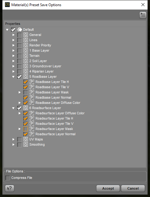

    4) Save a Materials preset for future use
    1. In the Scene pane, select the UltraScene.
    2. In the Surfaces pane, select the UltraScene.
    3. In the Daz Studio menu, select File>Save As>Material(s) Preset...
    4. When the save window pops open, select a location in your content library to save your new preset. I chose to create a "Materials BV" subfolder in the Environments/Landscapes/UltraScenery folder so it is easy to find. (BV are my initials, so I know this is something I created and it won't interfere if UltraScenery is updated to include a Materials folder some day.)
    5. Give the new preset a name. I chose "USC Track Cobblestone BV".
    7. A Material(s) Preset Save Options dialog box will open. Expand the Default list by clicking on the arrowhead to the left of it.
    8. Select only the portions of the material that we want to change. We want to change only parts of the 5 Roadbase Layer and parts of the 6 Roadsurface Layer. See the screenshot below. Here is how we accomplish that:
      • Click the checkbox next to Default to deselect everything.
      • Click the checkbox next to 5 Roadbase Layer to select it and all of its subitems.
      • Click the arrowhead next to 5 Roadbase Layer to expand it to see the subitems.
      • Click the checkbox next to Roadbase Layer Mask to deselect it. This is important. We don't want to include the mask, because we want to be able to use this Materials preset with all UltraScenery features that use Dirt Tracks. Each one may have a different mask.
      • Click the checkbox next to 6 Roadsurface Layer to select it and all of its subitems.
      • Click the arrowhead next to 6 Roadsurface Layer to expand it to see the subitems.
      • Click the checkbox next to Roadsurface Layer Mask to deselect it. This is important. We don't want to include the mask, because we want to be able to use this Materials preset with all UltraScenery features that use Dirt Tracks. Each one may have a different mask.

    Here is a screenshot of the 5 Roadbase Layer surface settings:
    Here is a screenshot of how the Materials Preset Options dialog should be filled out for this experiment:
      • Click the Accept button to accept the changes and close the dialog box.
    Here is the cobblestone path on the bare UltraScene terrain:
    Here is a final image with the saved cobblestone Materials preset applied to a render of the Tangy Apple Orchard using the Dirt Track 2 Hedgerow feature:

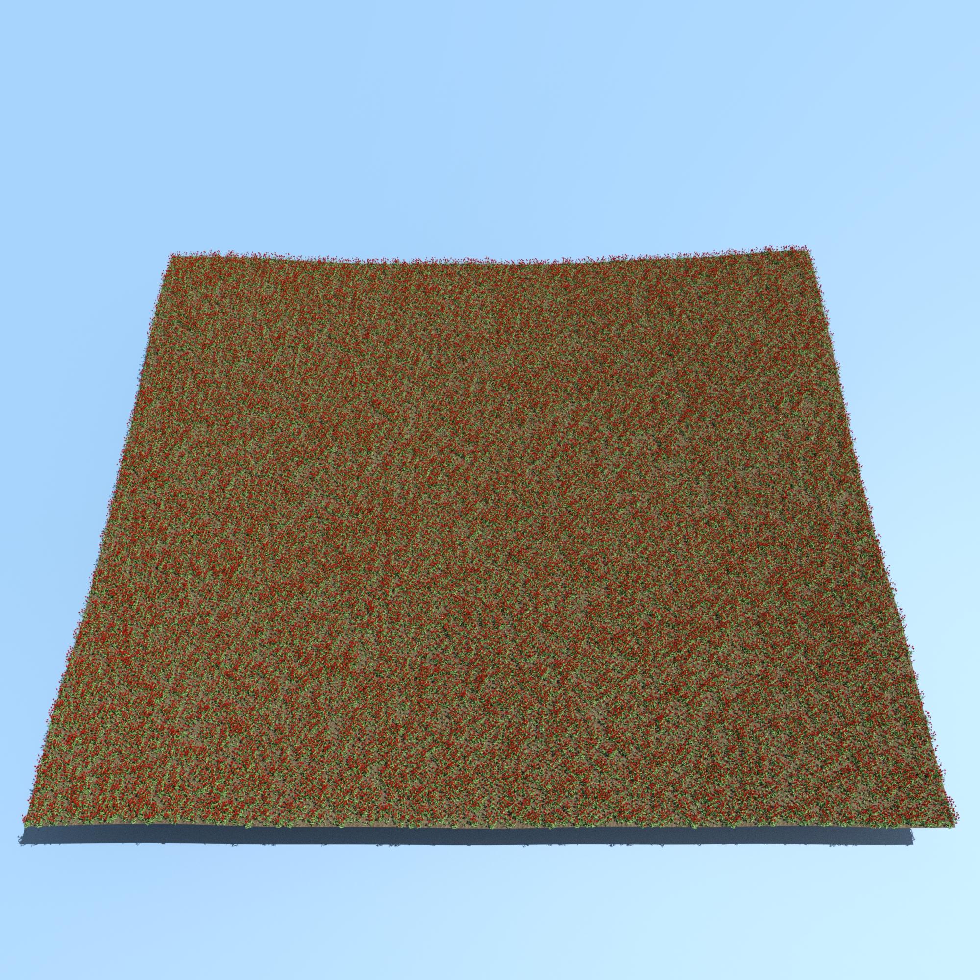

    3) Test the new ecology
    1. Run UltraSceneCreator script
    2. Select No Feature
    3. Select your new Flowers ecology
    4. In the Build tab select one of the flowers layers (uncheck all of the other layers)
    5. Build the scene
    6. Render the scene (Top view or 3DOutlaw's SkyCam views are good to evaluate the overall distribution of the flowers. A perspective view is good to evaluate the relative heights of flowers).
      • The flowers from Garden Flowers Vol 2. Tulip Plants worked well.

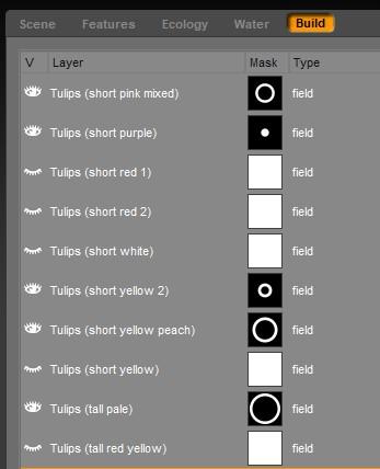

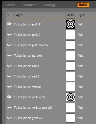

    4) Create some layer masks in an image editor, and use them to control placement of the flowers
    • I used Photoshop CS 6, because that is what I have. Any image editor will work.
    • I created a bullseye image (attached) with concentric rings. Using that layer mask on one layer and the invert of that layer mask on another layer will let me create rings of two separate flower types in one image.
    • I took the bullseye image and separated it into a series of individual rings. This lets me have more layers selected, each with a different ring mask.
    One layer of red tulips
    Two layers - pink and yellow tulips with bullseye mask
    Continued Below
    2000 x 2000 - 3M
    2000 x 2000 - 2M
    2000 x 2000 - 63K
    2000 x 2000 - 3M
    2000 x 2000 - 3M
    332 x 429 - 25K

      • Run UltraSceneCreator to create the flowers UltraScene. Choose the Terrain and Feature settings you want for your final image.
      • Select the UltraScene in the Scene pane.
      • Use Edit/Duplicate/Duplicate Node(s) to copy the flowers UltraScene and create the second UltraScene. This will ensure that they both use the same terrain and feature.
      • Select the second UltraScene in the Scene pane and run UltraSceneCreator on it to rebuild it.
      • Leave the terrain and Feature unchanged. Select a new ecology to get the grass, trees, and river items you want.
      • In the Build tab, select only the layers you want to add to your scene and add layer masks to control where they will be positioned.
      • Build the second UltraScene.
      • In the second UltraScene, hide the UltraScene terrain and water (we only need one terrain surface and one water).
    3. Render your final scene
