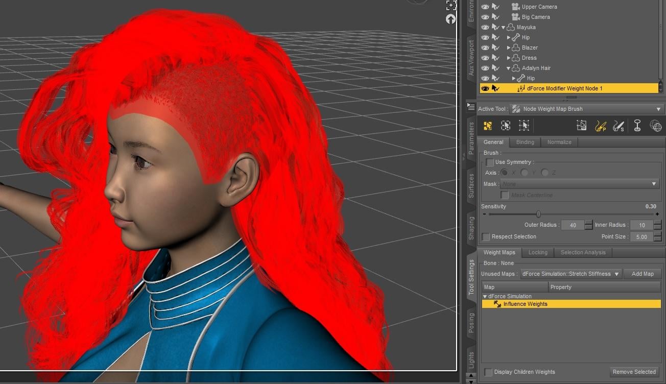

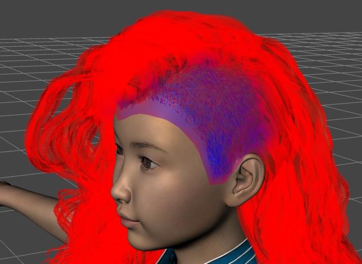

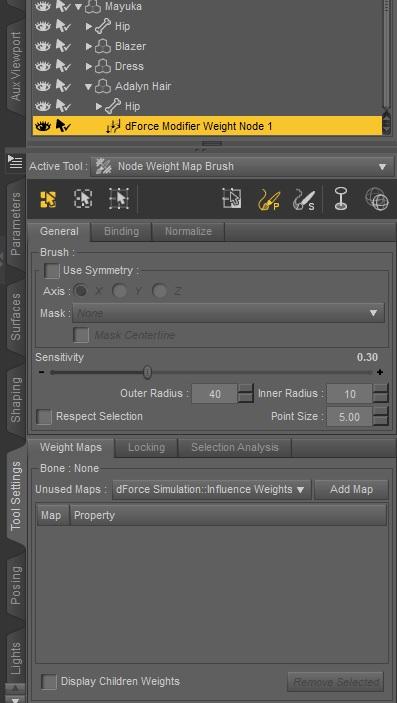

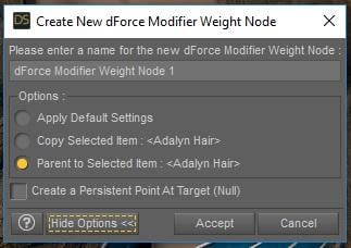

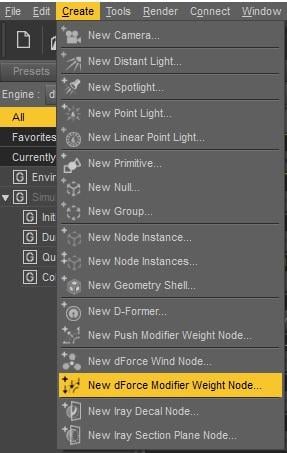

    Here it comes:
    After choosing the hair in Scene and in Surfaces tab
    click on "Add dForce Modifier: Dynamic Surface" from Simulation tab (you already know that)
    Keep the hair in Scene and in Surfaces tab choosen, then click on Create menu
    and pick up "New dForce Modifier Weight Node" from it.
    Please be sure, that "Parent to Selected item" is marked (expand Options if needed)
    Go to "Tool Settings" tab and make sure, that "dForce Modifier Weight Node" is selected
    Click on "Add Map" button (on the right side of "Unused Maps" row)
    to create "Influence Weights" map.
    After that, the hair should become red, and you can start painting map by keeping pressed Alt key
    and moving your mouse pointer with left mouse button pressed over red area of hair.

  • Artini said:
    Hi Petes images. As a matter of simulating stays at 50%, I have that too, but after stabilizing is done, the simulating goes forward.
    The time, when it happens for me, varies heavily on the hair being used. You should still see some advance in lower bar (stabilizing).
    I also experience some blackouts of the screen during simulations, and sometimes graphic card driver crash and Daz Studio stops responding.
    I will try to make screenshots of setting weight map painting and then I will post it here.
    The lower bar stabalizing reaches 100%, only crashed a few times generally that is ok. I can not add any weight mapping as screenshot simulation_2 shows, how do i get it to show the dforce in the tool seeings node weight map brush
    pete
    Worked ut how to add the weight maps, so now just a metter of practice, practice, and more practice
    thanks
    merry christmas to all
    Thanks for the very detailed tutorial! I'm gonna add a link to this at front (If I can that is lol) so everyone can see this! Thanks a lot!

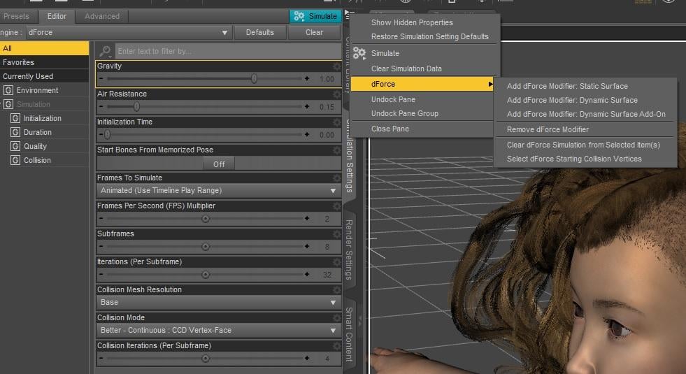

    Just another trial of animated line simulation done on CPU i7-2600 @ 3.4 GHz.
    Hair used: Adalyn Hair, character: Mayuka
    https://www.daz3d.com/adalyn-hair-for-genesis-3-female-s
    https://www.daz3d.com/mayuka-for-genesis-3-female
    HairForce preset used: Normal Difficult Hair 01, Dynamic Strength: 1.0
    Simulation Time: 3 hours 7 minutes 30.6 seconds
    Just stopped simulation after 4 frames - could not wait any longer.
    Hmm somehow this seems like the hair is stuck onto the hand at some frame of simulation which causes the hair to stretch with the hand movement...
    You could try to disable arm and hand in simulation by applying dynamic surface to the character, turn every single surface's dynamic strength to 0 and turn off "visible in simulation" for both arm and fingernail surface
    Or maybe you can send me the scene you want to do and I will see what I can change stuff to make it work?
    Post edited by EcVh0 on
