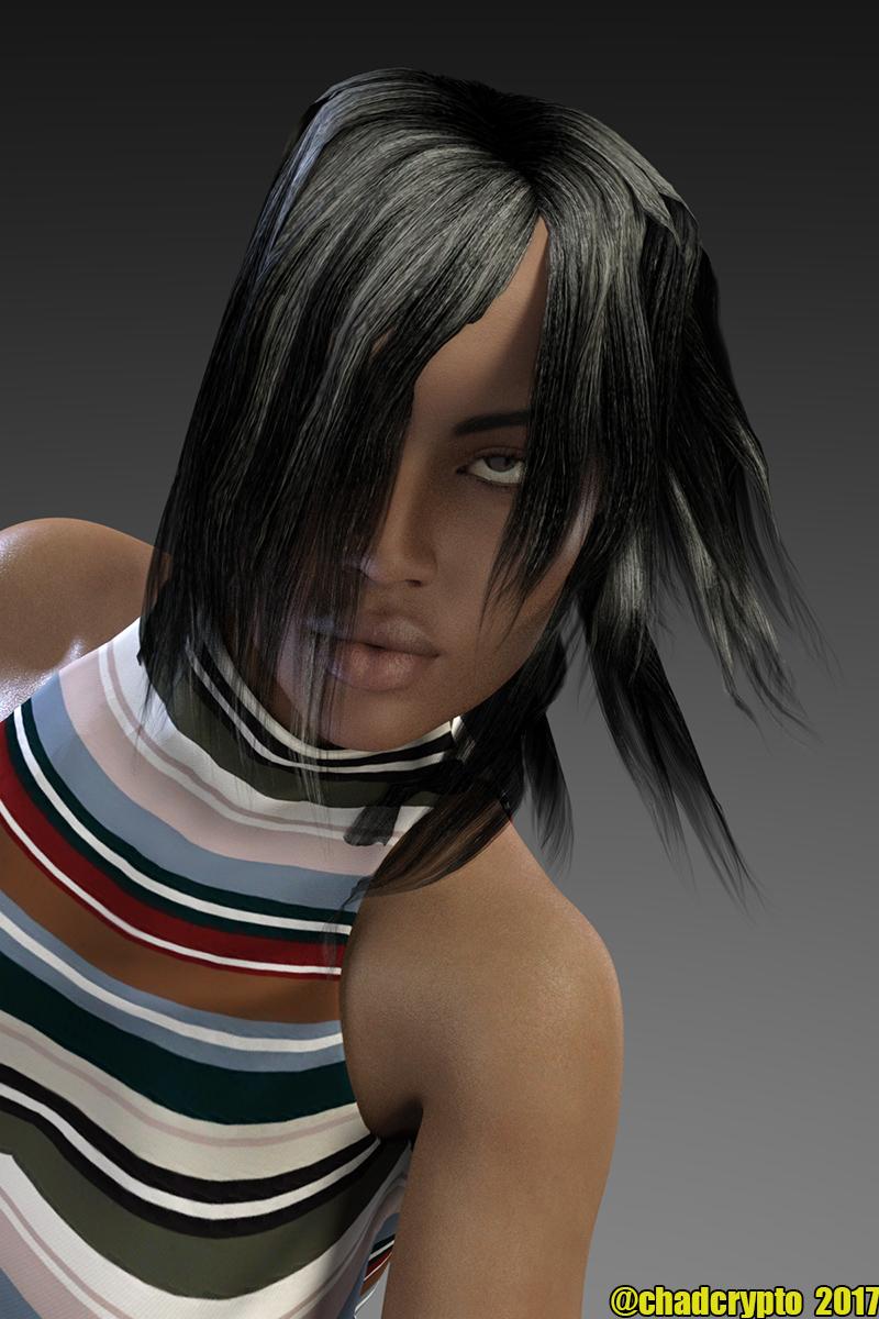

I've been having a play since I got this yesterday and as you can see at least Charlotte is impressed! (So am I ) I used the Miranda Hair that came in the Monique 8 Pro Bundle and used the Fluffy 01 setting. It's subtle but it gives the heir a realistic weight that I think looks really good. Keep up the good work mate, this is a great tool for us to use until Daz's own hair solution comes along (and considering 'Daz Time' we may using it a while!! LOL I kid, I kid!!).

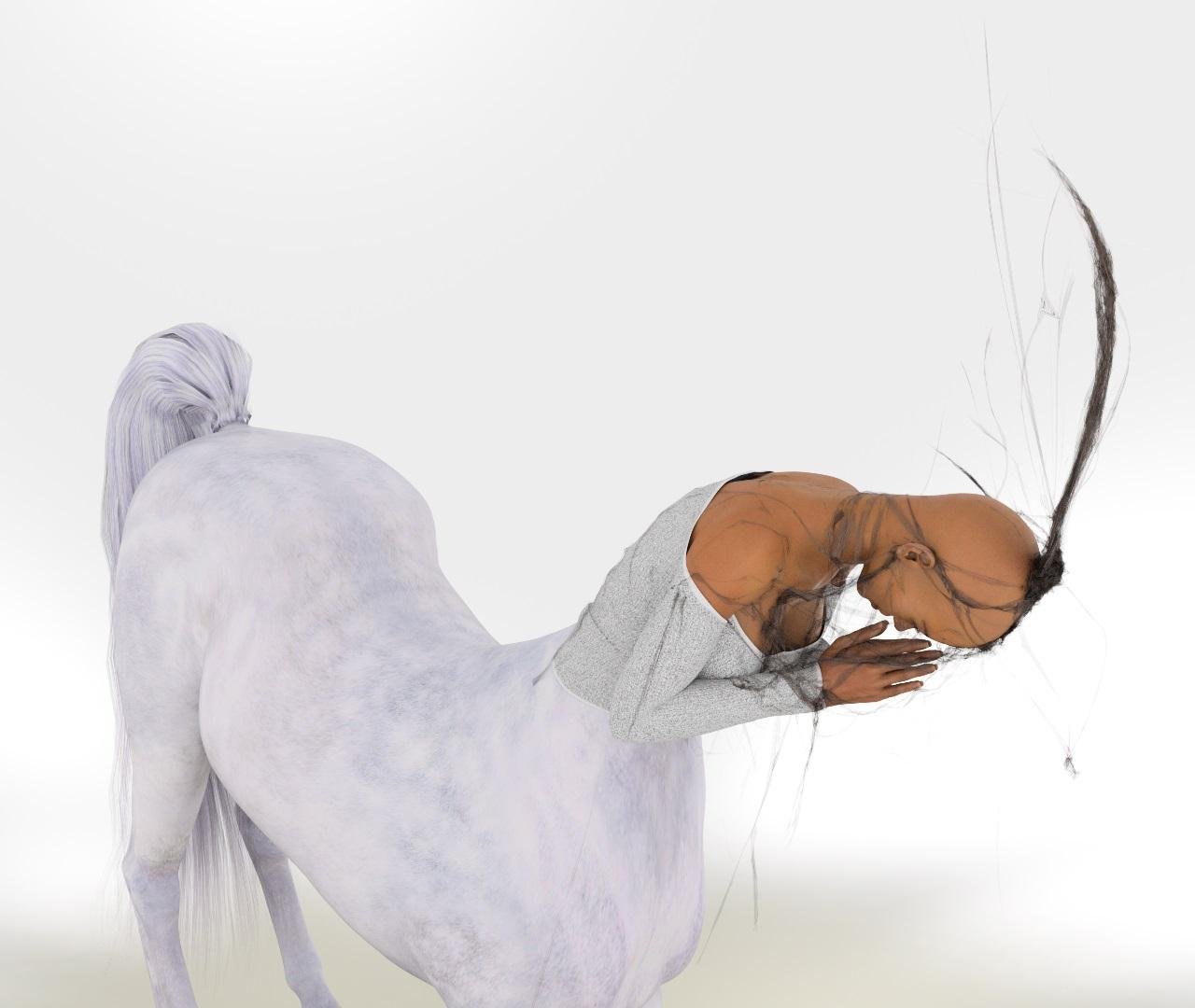

(Image removed for nudity. Please go over the guidelines. https://www.daz3d.com/forums/discussion/3279/acceptable-ways-of-handling-nudity#latest ~Mod)
I am doing something wrong. That was an animated simulation, but the hair moves very little.

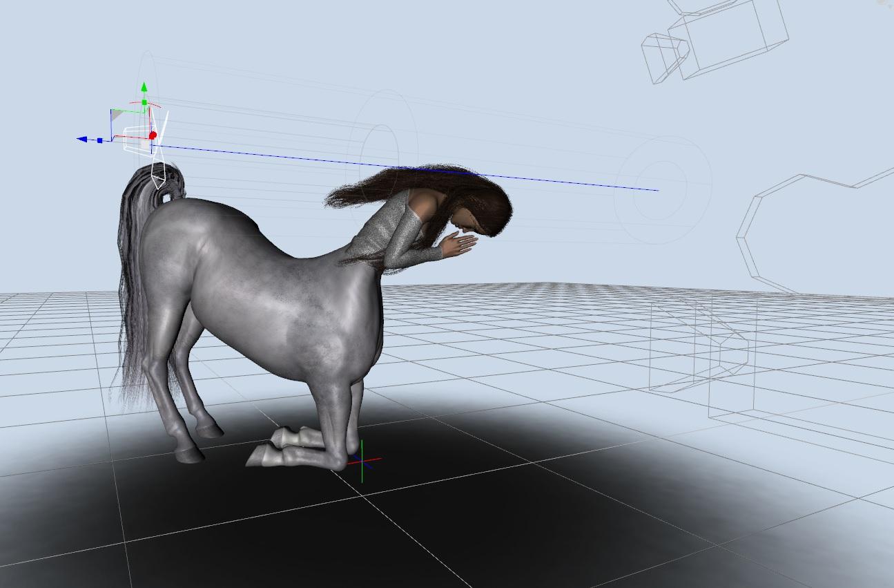

I have added wind force node. Below are the sceenshots.
This is, how it looks like with simulation cleared.
The hair used was Olenna hair https://www.daz3d.com/olenna-hair-for-genesis-3-female-s
It will be nice, if you could provide one working scene with your product.
In my attempts, the hair moves just a bit, if not at all.

Finally get some move on the hair ;-)
Used wet hair preset and wind 50 mph

And for the settings, I think I'm gonna put up a full description here so it can probably help you guys in finding the preset you want

I still do not know, how to make hair hanging down softly by gravity.
Don't worry about the tool setting part, that is only needed when your hair falls apart which I believe is not the case, right?
Try using soft hair set 08 and see if it helps moving the hair, if not, go to "surface tab" and move the dynamic strength up by 1.0 and it should move a lot more
Well it is getting there!
Did the hair happens to go to the hanging pose you want then moves up again to your current pose during simulation?

I was using Coleraine Hair on Aiko 7. I've followed the instructions and, 17 seconds into simulation, it crashed. Well, Daz crashed. In the end, I had to close Daz through Windows "program not responding" window.
I can't do any more right now.
In theory, if Daz can use dForce, then it can use HairForce? I'm using an AMD (Scrapper) graphics card with a 4GB Ram.
