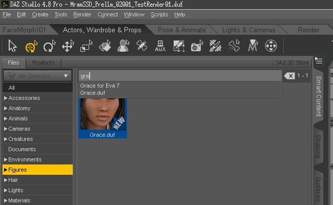

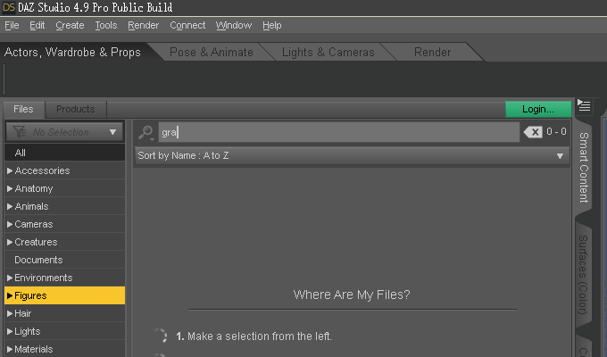

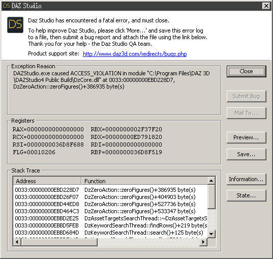

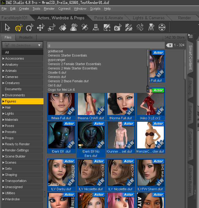

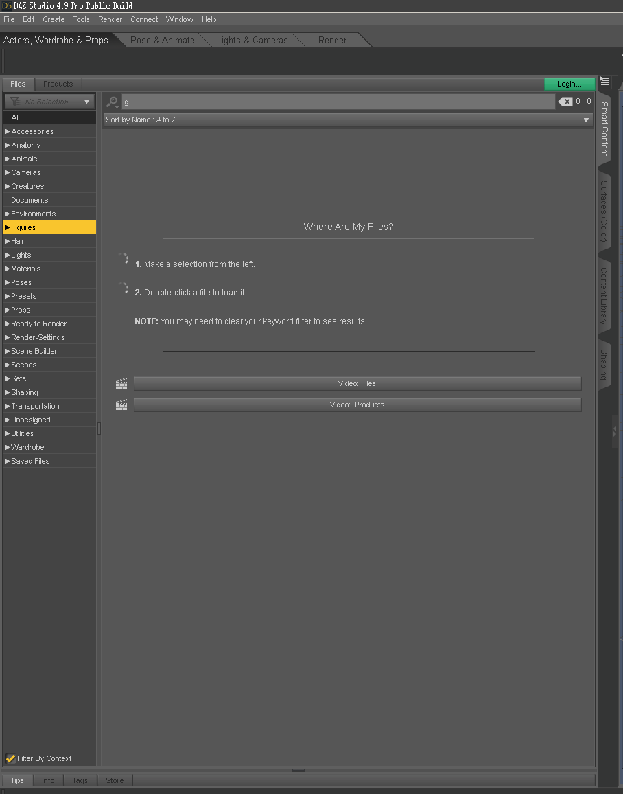

    Here's a good one I just came across looking at another 'difficulty'.  What happened to the smart tab search thing?
    I typed in the letter 'g' and I should have a lot more then nothing for that search.
    I tried to change the letter to 'v' and it crashed. What is going on with this?
    903 x 1142 - 628K
    908 x 1156 - 30K
    537 x 509 - 15K
  • Richard HaseltineRichard Haseltine Posts: 111,348
    The filter goes by whole words - to do a partial match you need to add colone-star at the end:
    g:*
    will find everything begining with g. I can't guess what caused the crash.
    edited May 2016
    g:*
    will find everything beginning with g. I can't guess what caused the crash.

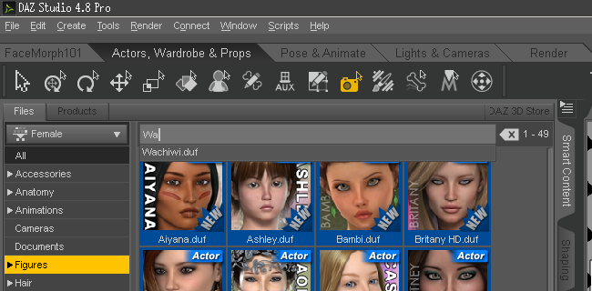

    That is very odd then. In 4.8 when I type 'g' there, the smart tab drops to just ones with 'g' in the name, and I get a drop-down list of suggestions just under the search-box.
    I will give the more complicated method a try in 4.9 after the current render in progress is finished.
    The crash is a tad odd as well, I have no clue what that is about and may be unrelated. I had just finished wiping and re-downloading two figures over in DIM, and DIM may not have finished closing down before I fired up studio, it's a remote possibility.
    (EDIT)
    No list of suggestions, etc. That is a few steps back from 4.8 if that is how it is 'intended' to work, lol.

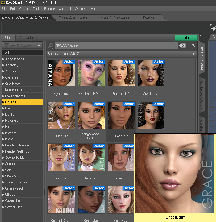

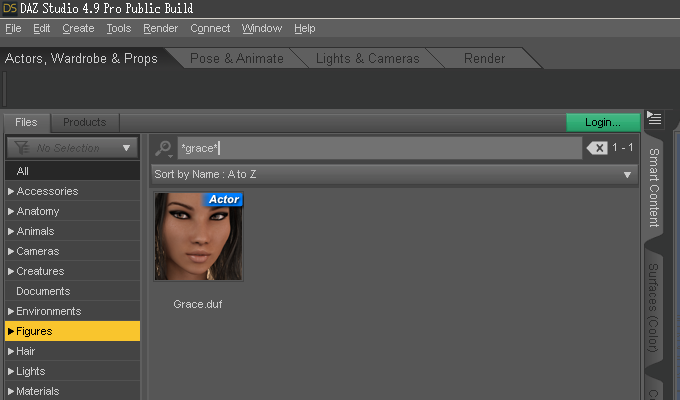

    Hmmm, I'm not sure what to make of that, lol.  Not the duplicate Grace's (there working on that), the rest of the list in the smart tab.

  • Cris PalominoCris Palomino Posts: 12,960
    'g' is not (typically) a keyword (unless you've added it yourself - i.e. a userword) or an "autoword" (a set of special keywords that we automatically assign from things like the file name). The Files page of the Smart Content pane uses keywords as the default "scope selector" (see http://docs.daz3d.com/doku.php/public/software/dazstudio/4/referenceguide/interface/panes/smart_content/advanced_filtering/start#keyword). If you expect that the assets you want to find have a keyword that starts with 'g' you can use the ':*' (colon, asterisk) suffix to indicate "the specified character(s), potentially followed by more characters." If you want to use the name of the asset explicitly, rather than the keywords assigned to it, use the 'name::' scope selector instead (see http://docs.daz3d.com/doku.php/public/software/dazstudio/4/referenceguide/interface/panes/smart_content/advanced_filtering/start#name). Be aware, however, that using "name::" for Files can take quite a bit longer to return results because its using the 'LIKE' operator instead of 'tsquery' (this speed difference was the motivating factor for the change in 4.9.x)
    edited June 2016

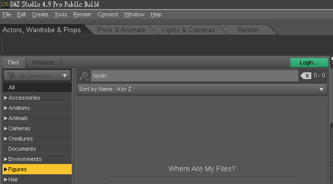

    Thanks Cris Palomino, and the use of just the letter 'g' was a pore example, tho the lack of the drop down list is quite missed. It was just nice to be able to just type in a few letters (say "wa" for example) to get to "Wachiwi" without needing to type out the full name.
    Especially with my difficulty remembering the exact spelling of some names. Without that drop-down list as the name is being typed, some names are going to be akin to cruel and unusual punishment to figure out how it's spelled.
    Yea, case and point, what did I spell wrong... Google, help!
    OK, Google is not being much help, I'm guessing I did spell that correctly 'Faylin'? There should be four of them for G2F, Spring, Summer, Autumn and Winter. They came with a bundle with a cool outfit with butterfly wings, I think possibly with a similar name.

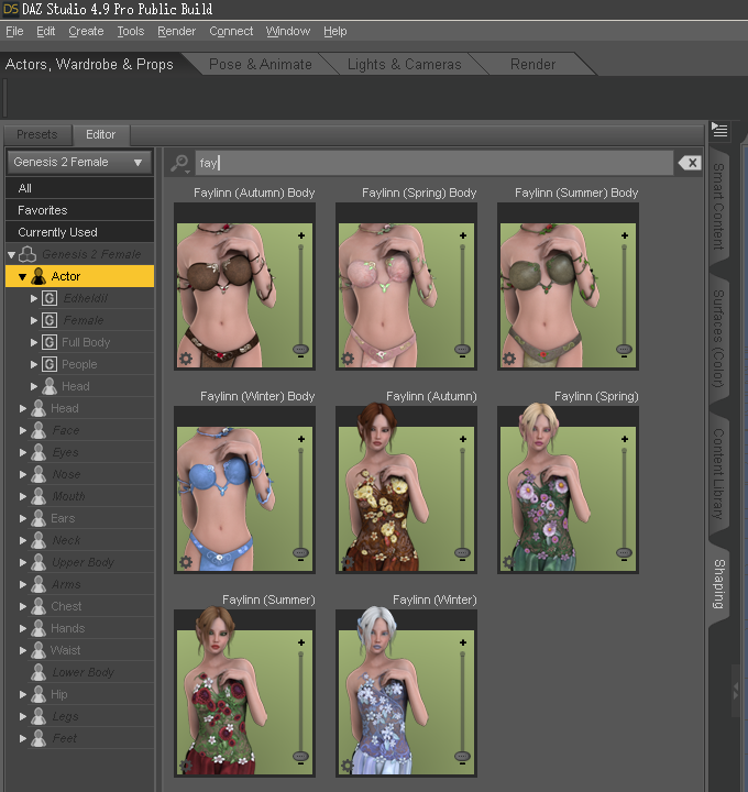

    OK, at least daz did not Nerf the search thing in the shaping tab (yet?). So provided the PA gave you an actual 'Dial' for the figure (not just an On/Off only duf thing), and you have the genesis for that generation already loaded into the scene, there is a way to figure out the spelling of some figures with tricky names.
    Not faelin, failin, faylin, etc. it just needed another 'n' to actual give me a hint that I had started to typed it correctly. The demand on the CPU is a good point Chris, so I'm not sure what a good solution is for the smart tab. Obviously it will require a new workflow in the end.

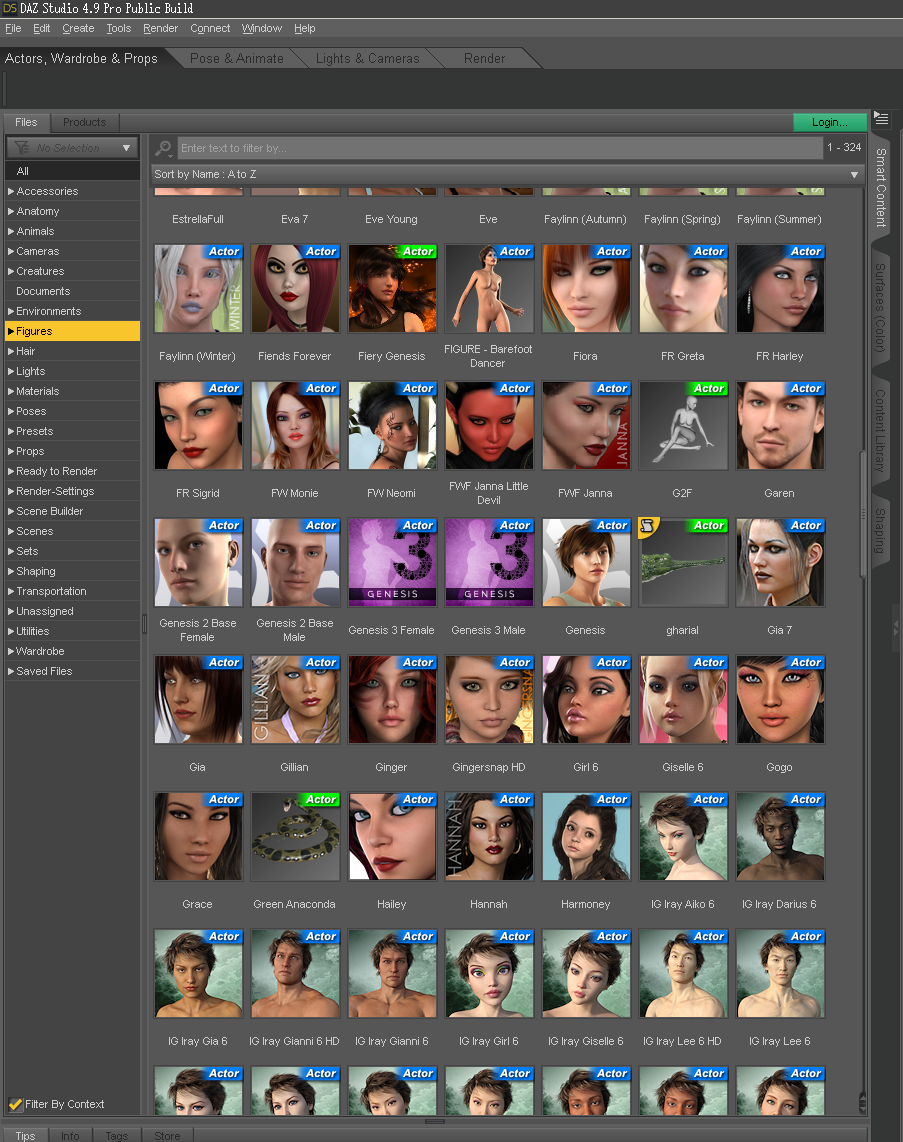

    I see the "filter by context" box is clicked at the bottom - do you think that may have made the difference? That you don't have any figures with 'g' for whatever it is you have selected in the scene?

    I really don't know. But if I check the 'filter by context' box, and I actually have nothing loaded, I notice that a few of the items in the list on the left disappear.  I just thought it worth mentioning in case that was causing your issue with no 'g' products appearing.
    There was nothing to the right worth screen-cap-ing, would it realy make that much of a differance?
  • No, they changed how the entire search  thing works for good reasons, so now you don't get any results till you have finished typing in the entire name (full, complete, and correctly spelled). So my habit of typing in a few letters for names I'm not sure of the exact spelling of the entire name, no longer works.
    It's good for keeping the smart tab from flickering when it is first opened (like it dose in 4.8), it's just not as friendly to use, lol.
