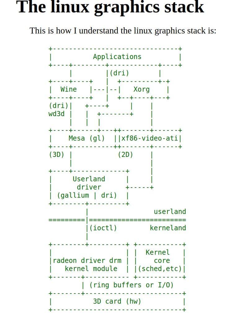

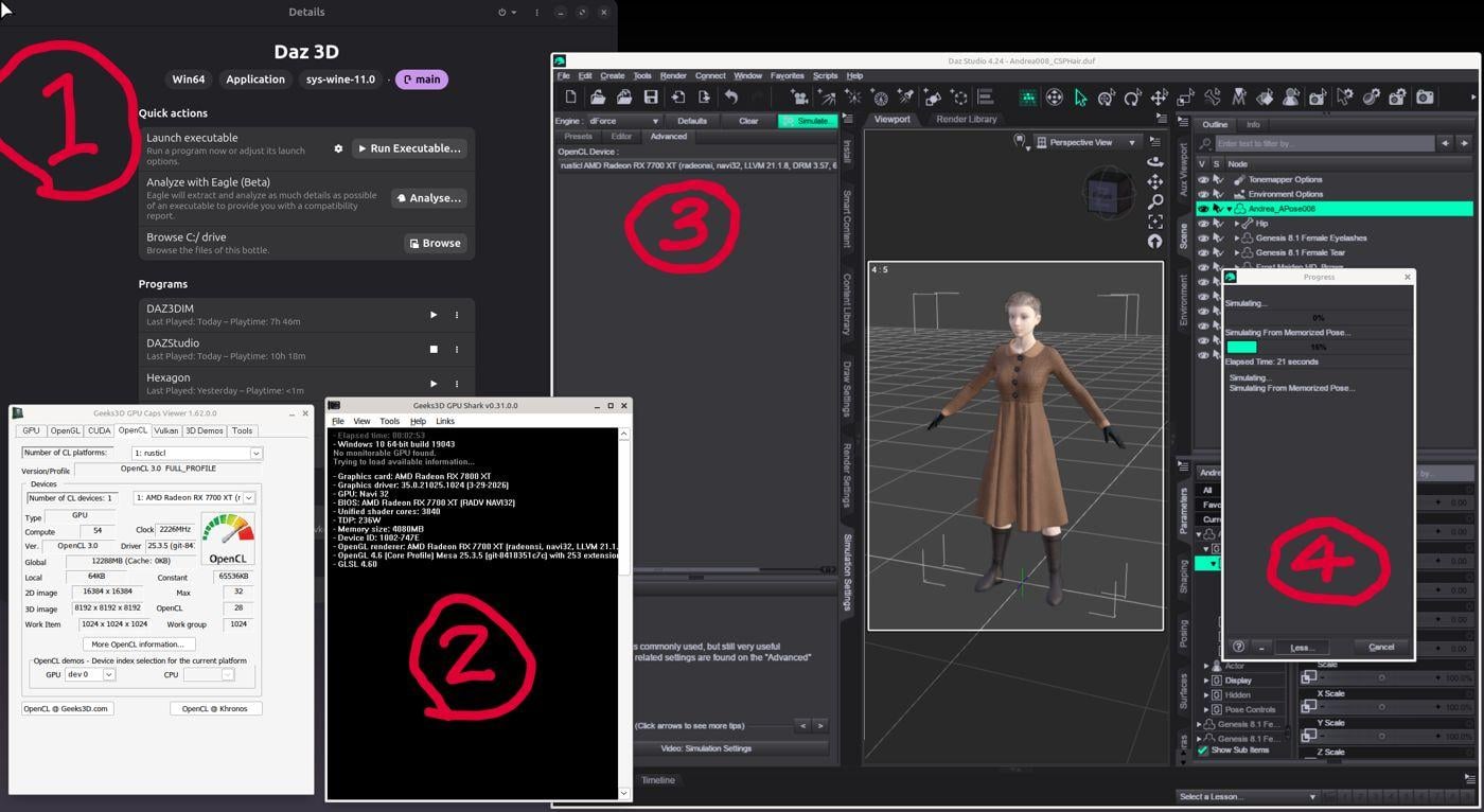

  • csaacsaa Posts: 1,052
    edited March 31
        TimberWolf said:
        The last possibility is to try Ubuntu which is directly supported by AMD for the ROCM stack but I wouldn't hold out much hope to be honest.
    TimberWolf, 3DIO:
    I may have something useful to contribute on that matter. Up until two weeks ago, I've been running Daz3D in Wine-Bottles on Ubuntu (Linux Mint 22) for over a year. Then I decided to replace my aging NVDIA 2070s with an AMD RX 7700 XT. After the swap, I got Daz Studio to render without iRay, but no dForce. Just this weekend, luckily, following a big Linux Mint update, I was able to get Daz Studio to recompile the dForce kernels using the OpenCL drivers for AMD.
    How did it all come together and work? Here's what I've managed to figure out.
    The diagram below explains the various software and hardware components that enables Daz3D in Wine (source). It may look like a lot of plumbing, but the key takeaway here is that MESA enables OpenGL rendering and OpenCL dForce simulations.
    Next, referring to the second screenshot above:
    [1] I use Wine (wth sys-wine runner) in Bottles installed and jailed via Flatpak.
    [2] GPU Cap Viewer is a free Windows app that inspects and runs tests on the GPU. It's a great diagnostic tool to examine the rendering and compute software stack visible to Windows ... which in turn is made visible by Wine-Bottles ... allowed by Flatpak (in my case) ... and runs natively Linux. As you can see GPU App Viewer "talks" OpenGL with the AMD GPU to render scenes. It does so by means of the MESA software stack, not ROCm. Same for compute jobs (such as dForce) by means of, rusticl, a MESA OpenCL runtime library.
    [3] In Daz Studio, the Simulations Settings tab confirms the availability of the AMD GPU. It identifies the MESA OpenCL system: rusticli.
    [4] dForce is running, simulating gravity on the dress the G8.1F figure is wearing.
    If you persevere and try to get OpenCL working to enable dForce, a reasonable goal would be getting Wine to leverage the MESA software stack. As I understand it, various Linux distros pre-bundle MESA according to varying degrees. For example, in my Linux Mint, Flatpak bundled rusticl as an extra component of Freedesktop.
    /var/lib/flatpak/runtime/org.freedesktop.Platform.GL.default/x86_64/24.08/4c37b3e42ec09de553a93fe22fa3079ef784beda91aea794563284a25f3f77e2/files/lib/libRusticlOpenCL.so.1 -> libRusticlOpenCL.so.1.0.0
    I never had to manually build and install MESA from source code. Later, when I installed Wine-Bottles via Flatpak, and Daz3D afterwards, Daz Studio picked up the OpenGL and OpenCL stacks automatically.
    Hope this helps.
    Cheers!
    edited March 31
    TimberWolf said:
    @TheMysteryIsThePoint
    Well, you've probably made @3DIO 's day. Great bit of detective work and makes life for AMD users with a Studio -> Blender workflow a lot easier. Trying to get Blender's cloth simulation to play nicely with Daz assets is not something I'd wish on anybody!
     TimberWolf,
    Yep, never doubt TheMysteryIsThePoint. Miracle maker! laugh
    With MESA-rusticl set up properly, AMD GPU owners can run dForce then export the Daz Studio scene as an obj to Blender. From there it takes just a bit of work to get the clothing object merged into the scene.
    Incidentally, deploying both MESA and ROCm in Linux doesn't cause too much problems. I believe the Linux display subsystem ignores ROCm and continues to use MESA. Thus isolated, and with the right shell environment variables configured, ROCm can be used for writing code and for runtime use by local LLMs (managed with Ollama, for example).
    Cheers!
    Post edited by csaa on
