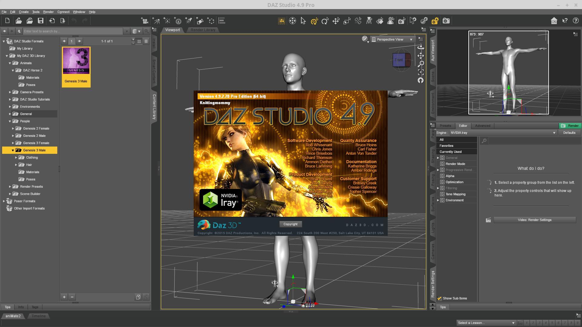

    Exactly, that's what I mean.  In my reply to TimberWolf some posts back, I was pointing out the runtimes, and that it's using "Steam Linux Runtime 4.0".
    This time I've attached the screenshot of both the page itself, and the actual compatibility setting I'm using.  I'm not so sure now after your post, but as far as I was concerned, it already was running natively on Linux  :-D
    Since CachyOS is Linux and I'm running a native Linux version of Steam on Linux, and the licence Steam is showing me is (as far as I'm aware) my perpetual "SteamOS" licence for Substance Painter.  I just assumed it must be running natively on Linux.  Also bear in mind that I'm not having crashes.  Perhaps this is why.  Perhaps you're running in a different mode to me.  But yup, as can be seen in the screenshots, it does state (even in brackets) that it's running on "Steam Linux Runtime Version 4.0" .
    1920 x 1080 - 419K
    842 x 601 - 36K
    Post edited by 3DIO on
  • bluejauntebluejaunte Posts: 2,218
    edited May 17
    Steam Linux Runtime 4.0 is not native. That's the whole Proton/Wine layer. You need to select "Legacy Runtime 1.0" to get the native Linux version.
    I think we can safely assume you were NOT running a native Linux version. Why do you think a Windows regedit change got rid of an error message in Substance Painter? wink

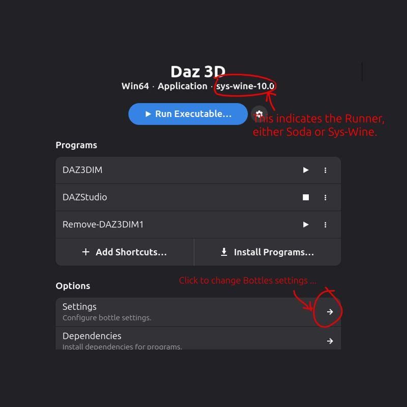

  • I ran into the same issue and got Daz Studio 6 Public Build working under Linux Mint with Bottles/Wine.
    The important part is that this is not primarily a Vulkan problem. In my case Studio 6 failed before the UI could start because its Qt6 runtime chain was incomplete or not being found correctly.
    The first visible symptom was a long list of errors such as:
    Qt6Core.dll not foundicuuc.dll not foundQt6Gui.dll not founddzcore.dll not found
    Those are mostly cascading errors. Qt6Core.dll itself may be present, but it cannot load if its ICU dependencies are missing.
    For a 64-bit Studio 6 installation, I would not use SysWOW64. The safest place is directly beside DAZStudio.exe in the Studio 6 program folder, for example:
    C:\Program Files\DAZ 3D\DAZStudio6 Public Build\
    In my case the following compatible 64-bit ICU files had to be present together, from the same legitimate Windows/DAZ source:
    icu.dllicuuc.dllicuin.dllicudt53.dll
    Do not mix random ICU versions from unrelated downloads. They need to match each other.
    After that, I still had a second startup blocker:
    msvcp140_2.dll.__std_smf_hypot3f
    The fix was to install the current Microsoft Visual C++ 2015-2022 x64 Redistributable in the Wine prefix and make Wine prefer the native VC++ DLLs for the Studio 6 launch:
    msvcp140msvcp140_1msvcp140_2vcruntime140vcruntime140_1concrt140
    with the override order set to:
    native, builtin
    The final detail was starting Studio 6 from its own program directory, rather than relying only on a generic desktop shortcut. A launcher/wrapper that sets the correct Wine prefix, changes into the Studio 6 directory, applies the VC++ overrides, and then starts DAZStudio.exe solved it for me.
    My working setup now has all three applications in the same Bottle/prefix:
    • Daz Studio 4.24
    • Daz Studio 6 Public Build
    • Daz Install Manager
    However, I use a separate launcher for Studio 6 because it has the Qt6/ICU requirements. Studio 4 should not inherit the Studio-6-specific Qt/ICU path settings.
    So, for the original Fedora/Wine issue, I would suggest this order:
    1. Start Studio 6 from a terminal and inspect the first DLL errors.
    2. Check whether icuuc.dll is missing.
    3. Place a matching 64-bit ICU set next to DAZStudio.exe, not in SysWOW64.
    4. Install the current VC++ 2015-2022 x64 redistributable in the prefix.
    5. Prefer native VC++ DLLs for the Studio 6 launch.
    6. Launch Studio 6 with its program folder as the working directory.
    That brought Studio 6 up normally for me, including the full Qt6 interface and normal scene loading.

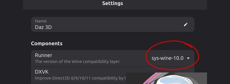

    edited June 25
    @mordeomortem
    The latest updates to the proton-cachyos runner are the problem. Switch your runner to System (should be 11.something) and you should find it magically springs to life. It works fine with the 610 drivers at my end.

  • TimberWolf said:
    @mordeomortem
    Thanks that actually did work! I actually installed Kubuntu which gave me full control over my gpu drivers. I downgraded to 580 which I learned was not the problem. I tried every runner on lutris except the system runner lol. Finally after AI took me down about 50 rabbit holes I tried the system runner. It took a few tries to get both the dforce and Iray stuff working but it's finally working! Now I can ditch Windows for good! I hope...
