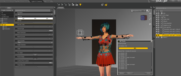

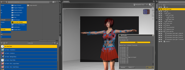

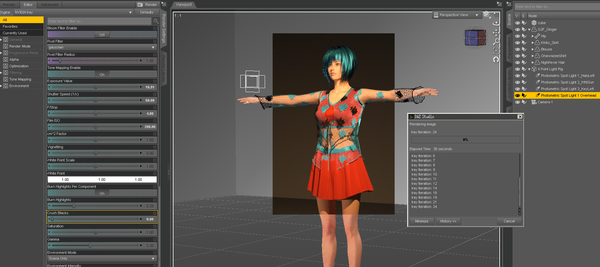

    I think I'm almost with you. First test render at ISO400, f/8, 1/128 shutter (I'll switch that out in a second). The hair is supposed to be burgundy, lol. I just ctrl-clicked the velvet or silk shaders for the hair and outfit. easy to fix.
    I think I got the "Fill" mixed up with the Key? The key is lower left, the 'WhtSun' us upper right. This is Design Anvol's light rig, toned way back, and inside a 'Primitive' cube about forty feet in size (set to 128 mid gray, mat plastic Iray).
    http://www.daz3d.com/forums/discussion/53797/
    Ginger is sporting her stock mats, Whatever the smart tab loads for her.
    (EDIT)
    Much better on the exposure.
    1820 x 809 - 497K
    1822 x 789 - 307K

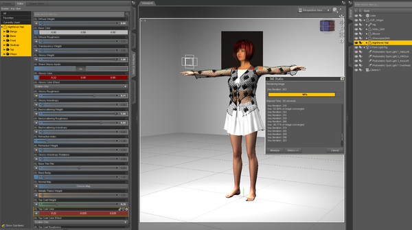

  • ZarconDeeGrissomZarconDeeGrissom Posts: 5,407
    edited March 2015
    Shutter Speed: 60 (1/60), F/stop: 4, Iso: 200
    Overhead 10,000
    WhtSun & Key 3,500
    Halo 2500
    I used 'Silk' preset on the hair Ctrl-click ignor maps. I can live with this, so what if the outfit is going threw it's self, lol.
    (EDIT, got the red back)
    Hair Backing colors.
    Glossy Color (128r 0g 0b)
    Top Coat Color (128r 48g 48b)
    1819 x 1017 - 360K
    1804 x 756 - 299K

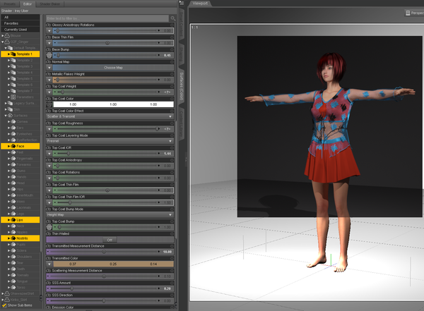

    edited March 2015
    Agreed, that and they started with color, I may have missed one (I missed two of the lights). "O" her skin is not Iray, yet.

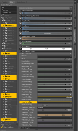

    Making life a tad easier with so many skin zones (bred crumb for self and others). G2F and G2M uses the same maps for many zones, so you don't need to mess with all of them individually, you can do this in groups. Select the first surface, then holding the Ctrl key, select the rest of the surfaces that use the same maps.
    For the most part, tho makeup and tattoo options may need specific attention to that zone independently.
    Torso, Ears, Head, Hips, Neck, Nipples, Torso.
    Face, Face, Lips, Nostrils.
    Limbs, Feet, Fingernails, Forearms,Hands, Legs, Shoulders, Toenails.
    Eyes, Cornea, Irises, Lacrimals, Pupils, Sclera.
    Mouth, Gums, InnerMouth, Teath, Tongue.
    This will be quite useful for making easier work of moving the maps in all the setings from color to strength for example.
    581 x 998 - 66K
  • evilded777evilded777 Posts: 2,404
    Or, Zarcon, one could just use Default Template 1 for the Face, Default Template 2 for the Torso and Default Template 3 for the Limbs.
    That's what they're there for... quickly selecting groups of surfaces.

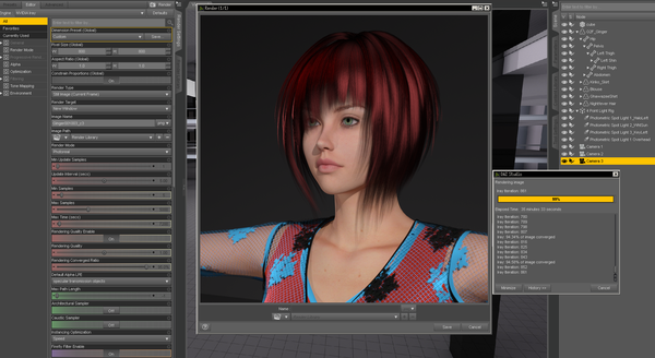

    edited March 2015
    OK, fixed the two lights, and did a Ctrl-Click to her skin, using the Iray Shader in the screen-cap. Or was that last bit a mistake? Do I want that one, or the one specifically for G2F?
    (EDIT)
    Good tip, I didn't know that. I thought that was for legacy or something else. I first looked at the outlined list on the first page, and thought I need to do all that to all 28 zones, this will take forever.
    1828 x 694 - 384K

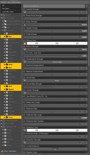

  • KhoryKhory Posts: 3,848
    Personally, I think the one for gf2 is crap. For one thing it is the metallicity base rather than the specular glossiness.

    Total Rendering Time: 38 minutes 21.36 seconds
    Completed by 95% convergence limit.
