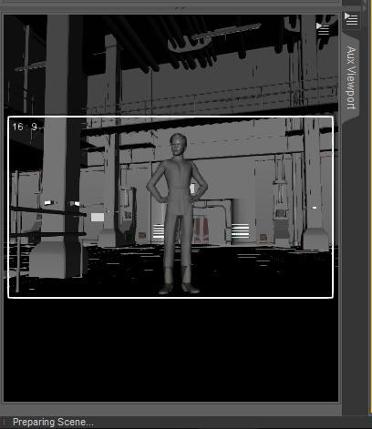

    Could use some help on several issues. I've been fiddling with a scene including one genesis figure, hair, three GIS clothing items, Level 19 and one camera, for several hours, while alternately reading this and other Iradium threads. As I read, I flip a switch or try a new number here and there. Things just aren't working well.
    As I nudge settings here and there, my aux Iray preview window, at best, shows the scene with most objects colored grey and no lighting or shadow effects, beyond basic shading, as if I'd set the window to Smooth Shaded.
    Meanwhile, as I type and while I read the last three pages of this thread since my last change to the camera or tone mapping, (I don't remember which,) my status bar has been stuck, "Preparing Scene..." with the progress bar cycling countless times, about every four seconds.
    I've attempted original and very high (kept pumping zeros after the 5, well into the billions) numbers for luminance on my emissive surfaces, to no effect that I can see in any window, since originally applying the shader and fixing the emission colors to look like the original default shaders did onscreen...again, it was so many tweaks ago that I don't remember if they used diffuse or ambient.
    I hit render once a couple hours ago and Studio simply stopped responding altogether. I'm not bothering with that again until I see something reasonable in the Iray preview.
    Ah, and it's warm in here today, lol. My comp just beeped once, the way it does when I set it to doing 3DL renders for more than five minutes or the outside temp is around 100F. Nice.
    Scene file and a screenshot linked below; perhaps one (more are welcome) of you may be able to debug some of the problems I'm having. Any help would be much appreciated.
    http://voltisart.com/downloads/PreparingScene....zip
    408 x 471 - 76K

  • Cris PalominoCris Palomino Posts: 12,839
    I would recommend watching this [url=http://www.deviantart.com/users/outgoing?https://www.youtube.com/watch?v=L5FZ5gS9v50]video by Sickle Yield as she is working with a figure in an enviroment that is similar.
    How did I miss this thread, thanks Szark. I spent the past week blindly clicking things, and making allot of assumptions that were way wrong. Mostly as I was working with lights made for 3delight, and trying to figure out a common ground in Iray.
    Turns out, with the Photometric lights, the Lumen value is ONLY for Iray, and dose nothing in 3delight. Given that I foolishly left the intensity at 100%, and the test chamber had UE2 going, it appeared way over exposed in 3delight, and the UE2 made it look like the Iray shader converted Omni Uber Area lights were doing something there.
    Yesterday, I set out with ALL the lights OFF except for the one I was trying to convert over, and discovered that the Iray shader emmitter dose NOTHING in 3delight, and the Lumen value on the Photometric lights. After twelve hours of plugging away ate single light test renders to attempt to compare light levels, and then that.. I threw in the towel.

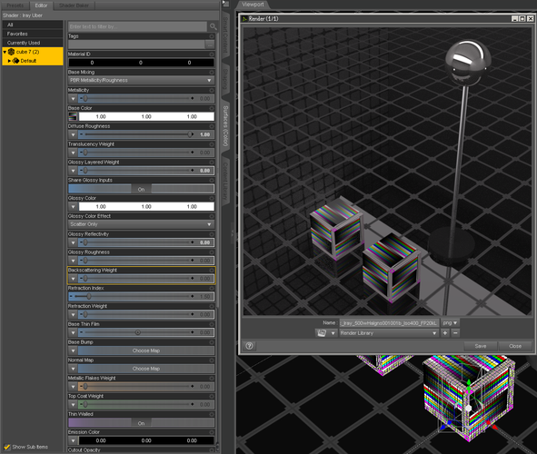

    Khory had asked me about some reflections in the color scale cube, and I was so far behind the ball, I hadn't a clue what was going on. I still don't, lol.
    As soon as I zoomed into the cube to try to calibrate some lights, I noticed it had gone reflective on me in Iray. Apparently when you have no reflection or gloss at all with the daz default shader, Iray still puts some reflection on the surface. I don't recall photographers color-scals ever being anything other then 'mat' finish.
    I'm, guessing, that these setting is what I'm looking for on this cube? :-/
    Test render Cube on the left is the Daz default shader one, the one on the right is the Iray one (settings shown in the tab).
    1192 x 1009 - 722K
  • VoltisArtVoltisArt Posts: 212
    edited March 2015
    Thanks, Cris. I did finally look at that last night and it was helpful. I'll scrap that scene as there's too many things to dig through and start a new one for experimenting, when I've the time.
    ZDG, in Iray, specular and reflectivity are the same thing, as it tends to be in real life. (Rough surfaces still reflect, they just scatter it away from your eyes, so you don't notice.) The Iray shader converts spec settings to reflection, so anything that had spec, now has reflection. Check out SY's video, linked in Cris' post above. Very good.
    Post edited by VoltisArt on
    I'm still confused, lol.
    Floor, DazDefaultSahder, 50% reflection, specular map, and diffuse. Looks perfect in Iray.
    Color cube, DazDefaultSahder, just diffuse. zero reflection, zero gloss (aka 100% on dial), zero specular. should appear like a mat surface (it dose in 3delight)? shouldn't it?
    As for the Iray settings? pure mat finish with diffuse color only? Are the settings in the screen-cap correct?
