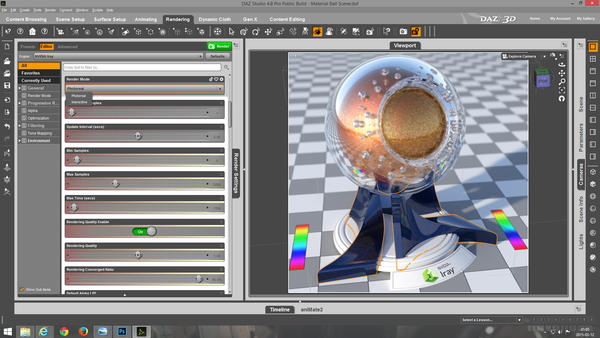

What is that DAZ Material Ball, and what does it do?
What is an Iray Section Plane Mode?

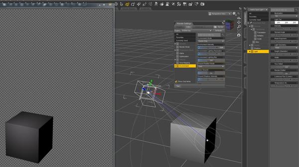

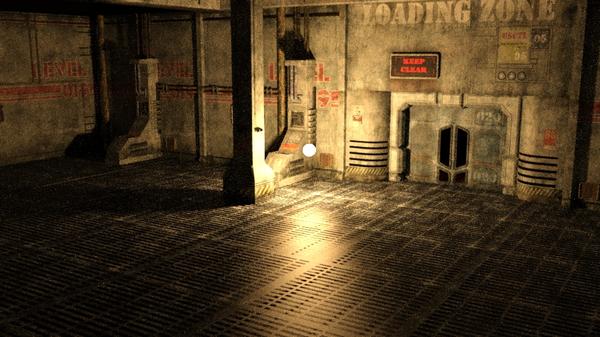

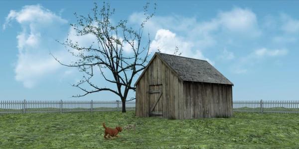

    Greetings,

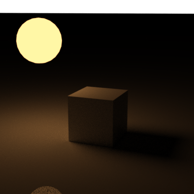

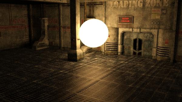

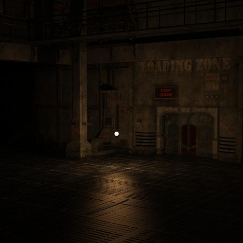

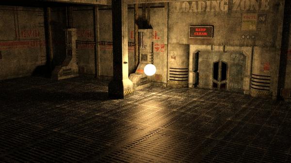

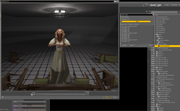

    I'm just as 'n00b' as you with it, but here's a fun trick I did. I pulled up a saved scene, with a distant light, and I deleted all the other lights (it's an outdoor shot) and went into the Render Settings, changed 'Engine' to 'NVIDIA Iray', selected Environment, Dome, Sun-Sky, Direction, and set the 'SS Sun Node' to 'Distant Light 1'. I hit render, and the sunlight was coming from the same place as the distant light had been. Neat trick; not sure if I should have done anything to the distant light (maybe I'm double-lighting?) but it was a really easy way of setting the direction of the sunlight.
    -- Morgan

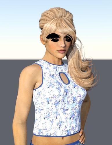

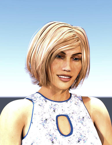

    I only have tested it a little but I think hair looks great using Translucency Weight to like 20% and a darker color as Translucency color.
    At least when I tested in the NVIDIA IRay preview mode.

    I'm still trying to figure out how this is all supposed to work. Is it biased? Unbiased? If it's the latter, why does it have a progress bar considering most unbiased engines go on forever?
    I found under Render Settings -> Progressive Rendering some settings, like Rendering Quality and Max Samples and Rendering Converged Ratio, they all seems to affect when a render is declared as Finished.
    I worked out that at the current rate my (rather small) render would take around 12 and a half hours to complete if left to its own devices. It seems incredibly slow, even when compared to engines like Luxrender. I've tried using optimized materials as well as playing around with the lighting, but nothing seems to change the slow render times. Annoyingly, cancelling the render seems to nuke the image as well, so I can't just get it to a 'good enough' state of affairs.
    Cancel the render not on the render view but on the render dialog/sheet, and the render view is still there. If you look in the DAZStudio log file it looks like you can see which devices are used in the render. IRay uses VRAM it says, and if your VRAM on your card cannot hold the scene for rendering, it will fallback to CPU.

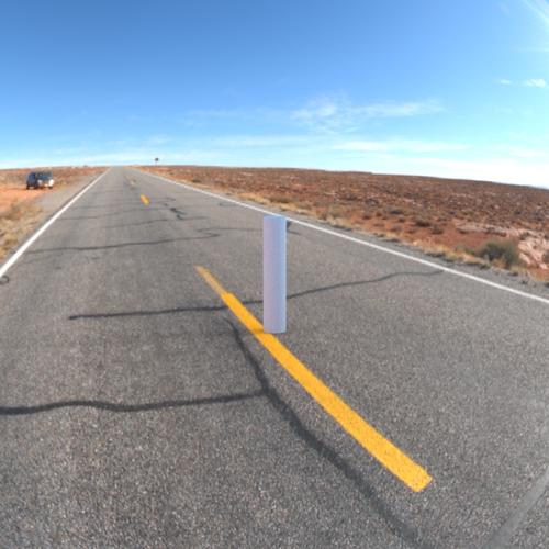

    That's difficult, but using HDR images (I downloaded a few free in the net and used the ones that comes with HDR Pro Sets by DT), seems to give a great illumination.
    HDR is fine, but knowing how to set it up is a different matter. In Daz Studio, the only method I know of is to use UberEnvironment which, for obvious reasons, is going to be incompatible with Iray. There's an 'environment' in the render settings, but no option to plug in a HDR for environmental lighting.
    Just plug an image to the image socket there. Then you can control how much light with the other sliders. Set environment mode to Dome and Scene.

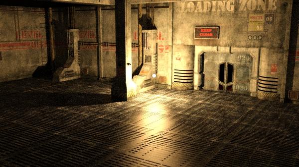

    Cypherfox said:
    Greetings,
    -- Morgan
    That is a fantastic tip, thank you!

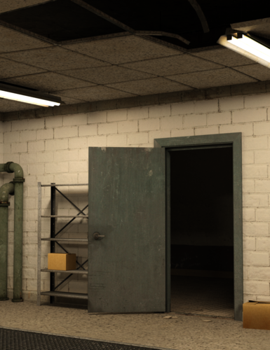

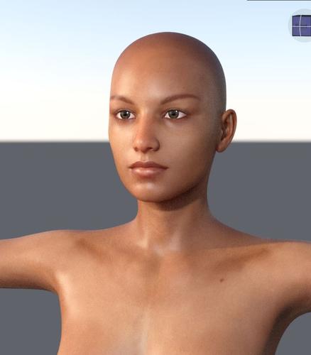

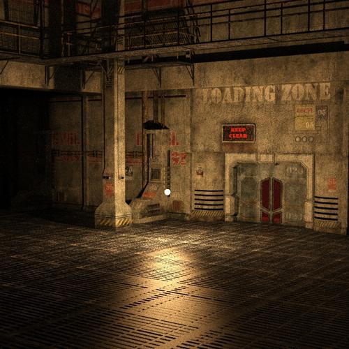

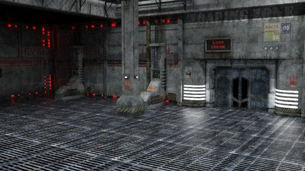

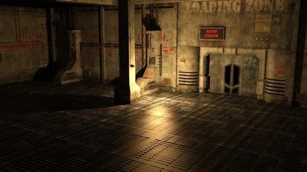

    This means I can create a single distant light in a scene, use the IPR Preview to help position it where I want, render a draft in 3Delight then switch to Iray and link the SS Sun Node to the Distant Light as you show above for the final image. Brilliant!
    For comparison (and to prove it works), here's the same scene rendered in both 3Delight and Iray using the same Distant Light in both, set up as above. The only difference is I applied the Iray Material Preset to G2F (CTRL-Click and Ignore). I think you can tell which render is which :)
    Thank you, Cypherfox!

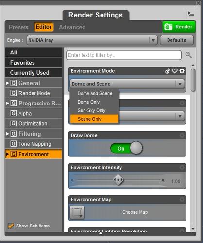

    edited March 2015
    In that very quote you'll note I mention there's no option to put in a HDR map. None of the controls under Environment have image maps so it's impossible to actually add any kind of environmental light, HDR or otherwise.
    If there's another way to access it, I'm all ears
    Edit: Never mind, found it. I had it set to scene only, so there was no option for HDR :D

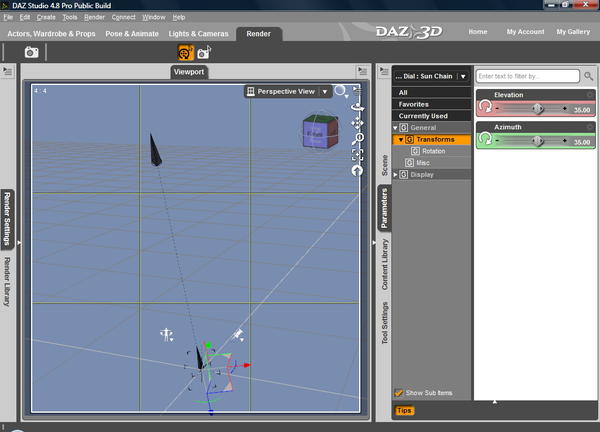

  • WilmapWilmap Posts: 2,917
    What exactly is the Sun Dial Set for and how do I use it?

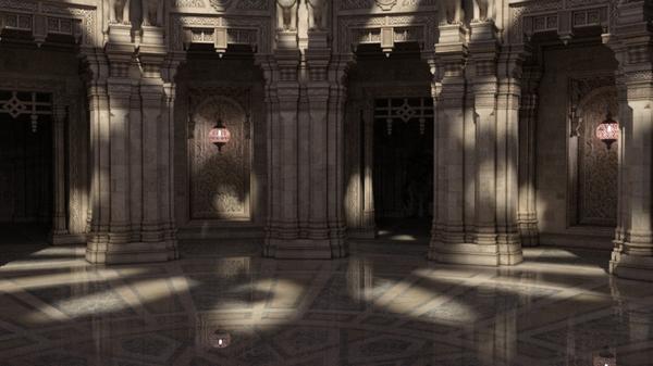

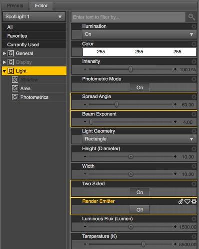

    The things that I've found that are not immediately obvious are:
    1. Turn off the head lamp in your camera settings so you can get real lights. You can create photometrics just as you would regular spots or points.
    2. Turn off your CPU in the render settings if you have one or more good graphics cards, the CPU will actually slow render down.
    3. More lights are faster, not slower, because this is an unbiased/physically based renderer.
    4. Light level in lumens is different from light intensity, and temperature of a light controls its color to a great degree, where lower equals more red and higher equals more blue and then more white (you CAN get green and purple but the light has to be a high enough temperature, say 7000K, that its own color won't overpower it).

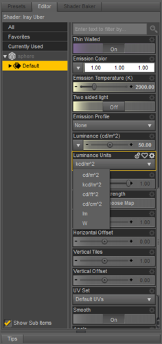

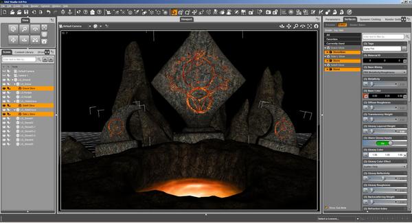

  • KatherineKatherine Posts: 334

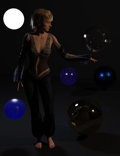

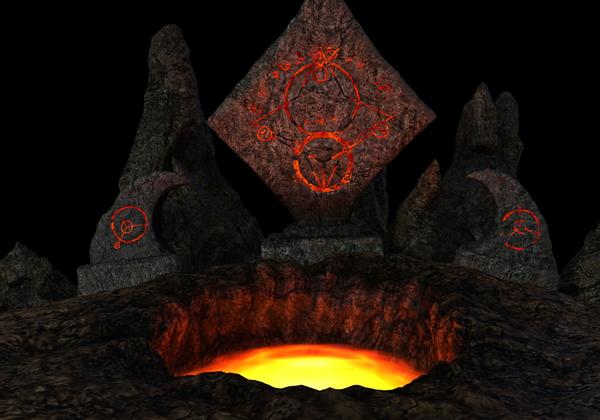

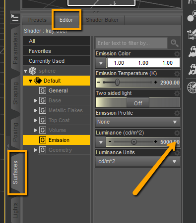

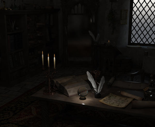

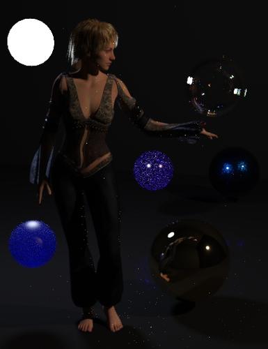

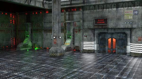

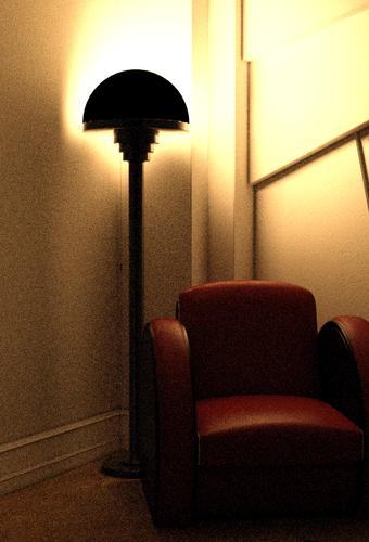

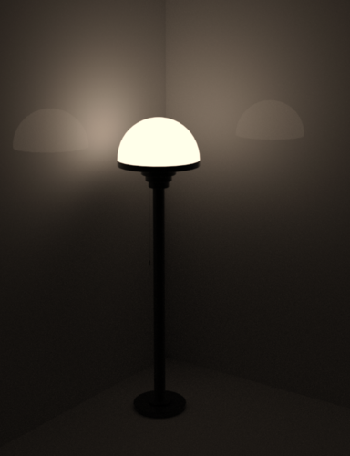

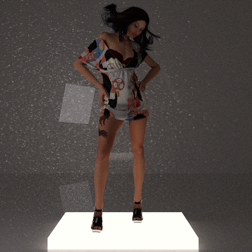

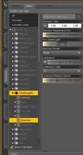

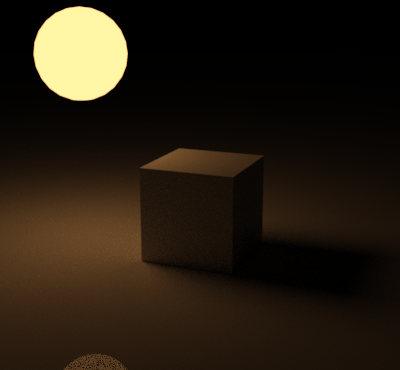

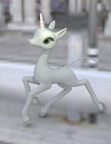

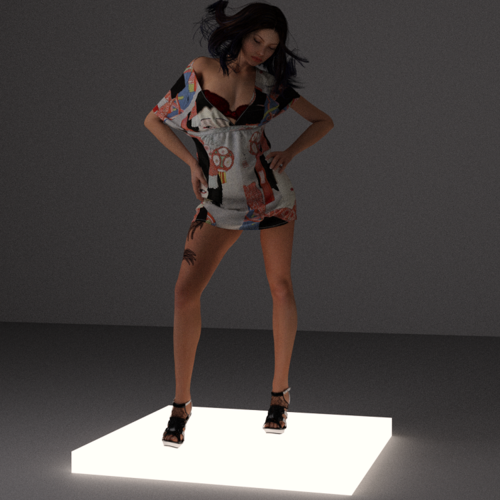

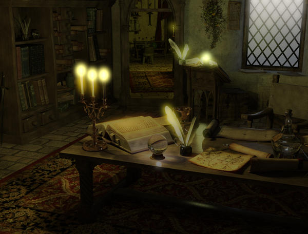

    Ok, here are a couple things you can do with lighting.
    1. Turn any surface into an Emitter. It will cast light. No more fake "ambient". So real light bulbs. :) Or take a plane/sphere/etc and turn it into an areal light....
    To do this, select the surface and apply the Emitter shader you got with the Iray content. (Hold the CTRL key if you want to keep any maps for the surface)
    2. You can use a skydome that ships with a product. I while it is "better" to use an environment HDRI, you can still find a use for the cool domes you may have laying around.
    Follow the steps above and turn it to an emitter. (use CTRL to keep the texture map) You will need to adjust the Luminance value way up....like 50K. (Shader pane > Emitter)
    This little unicorn's horn is glowing and emitting light. :) The horn in the dark is the render without an environment so you can see the result of the emission property.
    Kat
    1000 x 1300 - 443K
    1000 x 1300 - 38K
