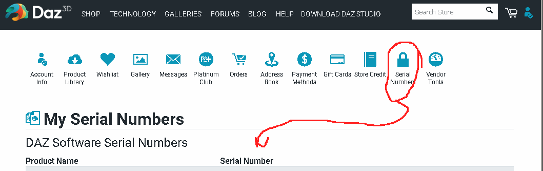

    LAMH was on sale, so I bought it, installed via DIM, followed the directions to register... it said to restart Daz to use it.
    I restart Daz and as soon as I try to create a new LAMH Object I get the screen saying I need to register again.
    I've gone through this 4 times, and I'm not going to keep doing the same thing and expecting different results.
    Running on MacOS 10.14.6
    DazStudio version 4.12.0.86 Pro Edition
    LAMH version 1.6
    No LAMH player installed (ever)
    Any hints? And why is there no support information on furrythings.com?

  • jpetersen1jpetersen1 Posts: 148
    Did you get the activation code from the LAMH page? This is separate from the serial number. Don't put the serial number into the software in DAZ until after you have put it into the LAMH site and gotten the activation code as well.
    edited April 2020
    yeah, sorry, I'll need to address my slacking on the 3rd, I only have the free player. Are the keys not on your key list page?
    Hexagon 2.5, Measure Metrics for Daz Studio, Pret-A-3D_Reality4DS, keyMate for Daz Studio, graphMate for Daz Studio... is on that list for me, as I purchased them. is LAMH not there?

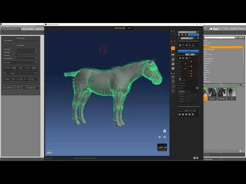

    This is the first time I've used LAMH. I edited my char to give it hair and exported to DS.
    In DS, I have a LAMH Group in my Scene tab attached to my character.
    The character in the viewport does not show the hair. I've tried watching some of the tutorials but whatever they are clicking to make the hair visible they are either not explaining or zooming past so fast I can't tell how they got from plain object to hair object after the LAMH group is attached.
    I'm probably missing a simple step, but how do you activate the hair so you can see it in the viewport?

  • This is the first time I've used LAMH. I edited my char to give it hair and exported to DS.
    Hello, see if this movie can help you to get started:

    I'm not seeing guide hairs and it's not rendering the hair. But the catalyzer attached itself correctly as far as I can tell. The settings look normal. Closing DS and re-opening the scene didn't seem to make a difference.
    I'll take a look at the video, thanks.
    edited April 2020
    Okay, that video shows how to use the editor and how to grow and groom the hair. I had no problem doing that part.
    It was after I exported it to DS and the catalyzer was automatically added in the Scenes Pane that the green guide hairs disappeared. They're not visible in the DS viewport (they are visible in the LAMH editor).
    When I look at the settings in the LAMH panel on the left in DS, they look normal in terms of color and settings, but I don't see any hair when I render.
    I'm wondering if I missed a step. After it adds the catalyzer group in the Scenes Pane, is there anything else that has to be clicked to activate the hair?
    Post edited by jpetersen1 on
  • Okay, that video shows how to use the editor and how to grow and groom the hair. I had no problem doing that part.
    I don't understand. Mind that LAMH is one plugin, Catalyzer is another. LAMH can be used to create your own preset and render them in 3DL, or Iray after exporting to OBJ (which can be done within the plugin itself).
    Catalyzer is a plugin that is capable of rendering directly to Iray only my own model library.
