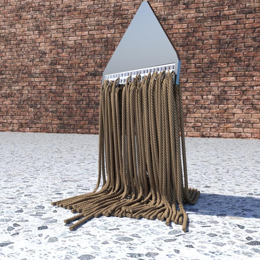

    @RGcincy I believe that did it! Not perfect. But with a little collision iteration and smoothing, I think that I am on my way!
    Thank you for your helpful suggestion.
    ^__^

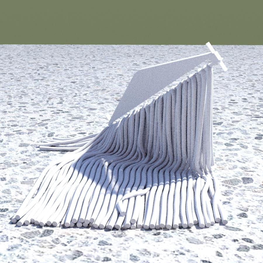

    Update:
    Thought I had it, but apparently, there is still an issue holding the head of the mop together and containing
    the strands. There probably has to be a physically weld of the strands to form a band along the root, or like you did with the weightmap on the hanging towel and the clothes pins.
    900 x 900 - 714K
    Post edited by Rakuda on
    Rakuda said:
    ... like you did with the weightmap on the hanging towel and the clothes pins.
    Weightmapping the part(s) of the strands that meet the head should resolve that problem.
  • RGcincyRGcincy Posts: 2,864
    @rakuda did the weight mapping at the head that maikdecker suggested help?
    Also, I saw your strands are staying round (which is good!). I've had circular meshes like that collapse into a flat ribbon. Are you changing any of the surface parameters or is it the design of the mesh that is keeping them round?

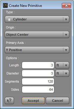

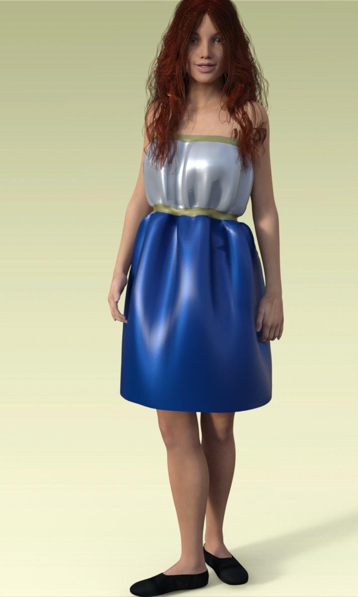

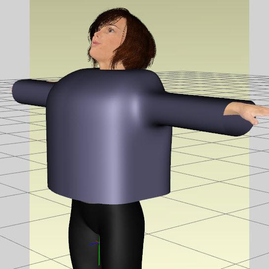

    40. Create a Dress with Gathered Waist.
    This is a bit more complex than the bandeau. It has a band at the top to hug the chest above the breasts and a band around the waist too. I used a cylinder but you could use a cone the same way. It took some time to find settings that worked. With default surface properties, the top would slide down and the skirt would rise up and gather around the waist. Feel free to experiment with different property settings.
    a. Create a primitive cylinder with the parameters shown in the image. Position the cylinder around a figure with the top just under the armpits (start with a T-pose or with the arms even higher). I also had a slight (-2 degrees) X-rotation to better fit the figure.
    b. Follow step 38 c to hide and delete the upper and lower cylinder faces.
    c. Follow step 38 e to create 3 additional surfaces: a Top Band using the upper 3-5 rows and a Waist Band of 3-5 rows about where the figure’s waist is located. Select the polygons between the two bands and assign it to a new surface called Top. The skirt portion will retain the name Default.
    d. Add a dForce dynamic modifier to the cylinder.
    e. We need the Top Band and Waist Band surfaces to cinch quickly to keep the cylinder from sliding down too far. For both of those, I set Contraction-Expansion Ratio to 50%. The Top will also be a bit baggy compared to the skirt, so I set its Contraction-Expansion Ratio to 90% while the Default surface remained at the default 100%.
    f. At default density, the bands tended to bunch up, so I set both the Top Band and Waist Band to 500 density. I set the Default (skirt) to 70 while the top remained at the default of 180. Density values below 70 and above 500 caused the mesh to blow up during simulation.
    g. Since they need to react quickly, I kept Dynamic Strength for the bands at the default of 1. The Top was set to 0.92 and the Default (skirt) was set to 0.75.
    h. Run the simulation using an animated timeline. The image below shows what you get. I could not get the skirt portion to drape down as much as I would like. The tucked waist causes it to go out further from the body and hang as if very stiff fabric. Using a cone instead of a cylinder might help.
    i. If you want a shorter dress, select some of the lower polygon rows and hide/delete them using the Geometry Editor. If you simply hide them with the Surfaces Opacity slider, they will still influence the behavior of the lower edge of the cylinder.

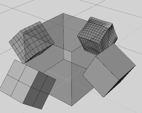

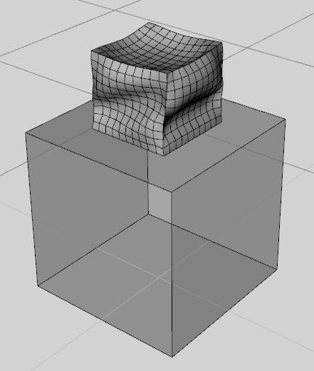

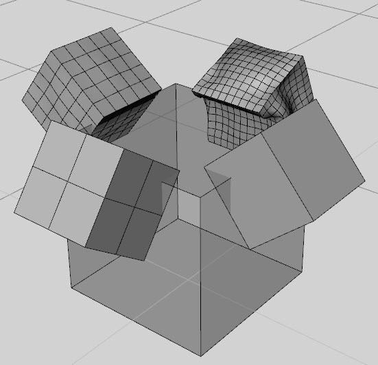

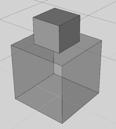

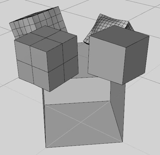

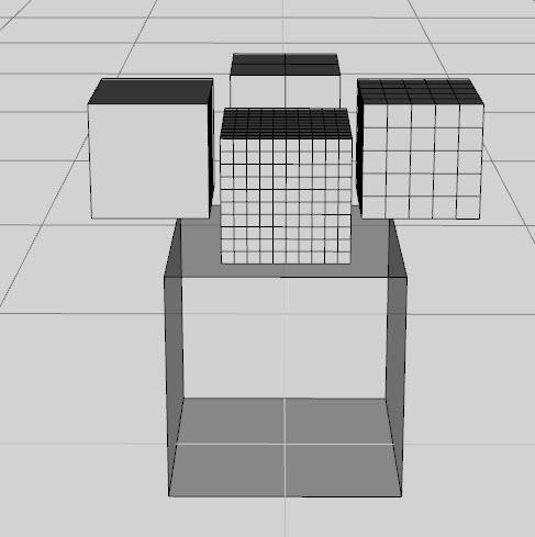

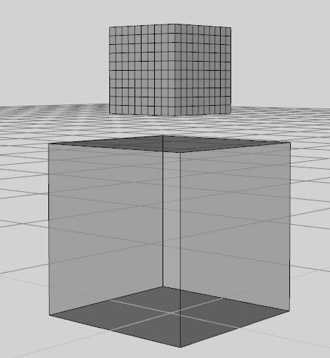

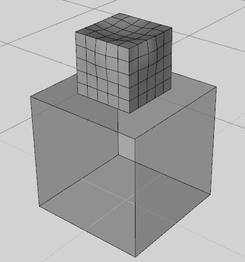

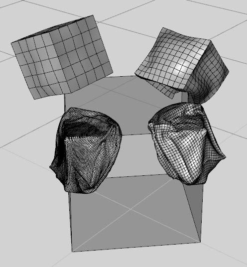

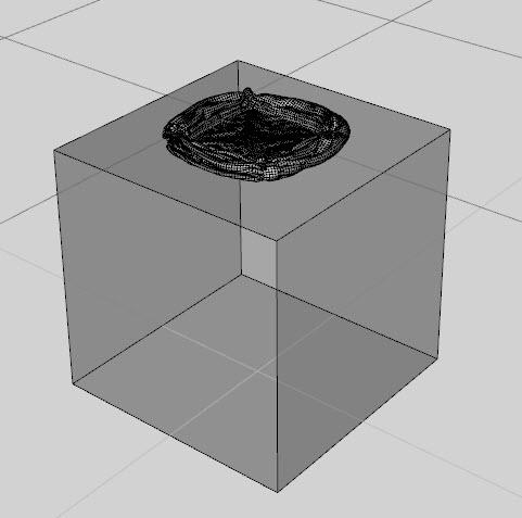

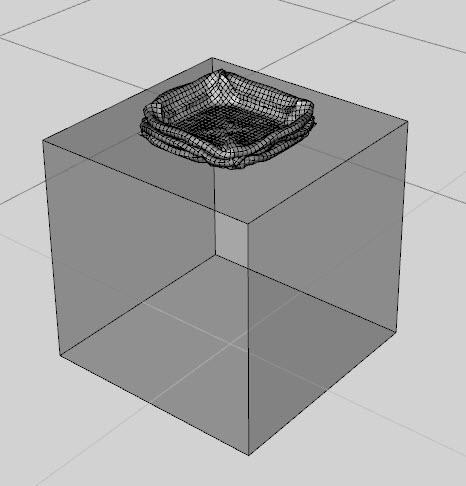

    41. How Resolution Affects Simulation Results. If you plan to design your own props or clothes to use with dForce, it’s important to understand how resolution can influence simulation results. In this section, I use primitive cubes of varying resolution to show what happens.
    a. Create a 2-foot cube with 1 division. Create a series of 1-foot cubes with 1, 2, 5, 10, 25, and 50 divisions. Center the smaller cubes slightly above the larger cube. Add a dForce dynamic modifier to all the 1-foot cubes.
    b. Hide all but one of the 1-foot cubes and run the simulation. Repeat for all the rest. As you can see in the images below, the more divisions in the cubes the more distortion that occurs under dForce. With 1 division, there is only very slight compression. It takes 5 divisions before you see the sides warping. With 25, the cube is mostly collapsed and with 50 it’s fully collapsed.
    1 Division:                                                          2 Divisions:
    5 Divisions:                                                       10 Divisions:
     25 Divisions:                                                    50 Divisions:

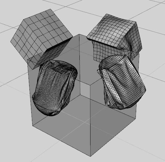

    c. Next position a 1-foot cube over each side of the larger base cube. Run the simulation. The lower resolution cubes distort little to none and fall completely off the base cube. Only the 25 and 50 division cubes remain attached as they distort and collapse.
    Divisions 1-2-5-10 at Frame 11:                       Divisions 5-10-25-50 at Frame 11:
    Divisions 1-2-5-10 at Frame 18:
    d. Now rotate the base cube so the smaller cubes are over a corner. Run the simulation. You get similar results, with divisions 1-2-5-10 falling off while 25 and 50 stick and collapse.
    Replacing the 1 division base cube with a 5 division base cube had no apparent effect:

  • 3dOutlaw3dOutlaw Posts: 2,481
    Thanks for that, very helpful!  Does the Daz SubD work for this, or is it only the original base object divisions. (i.e. can you subdivide a cloth using the slider in daz to make it more "flimsy")
    SubD doesn't impact the simulation results, only the base resolution matters (unfortunately). SubD will affect the shape of the object, rounding the edges of the cubes.
    OK, thanks, I was just setting it up to test, so I appreciate you clarifying that!  yes

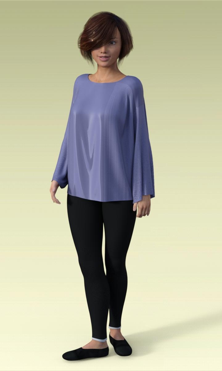

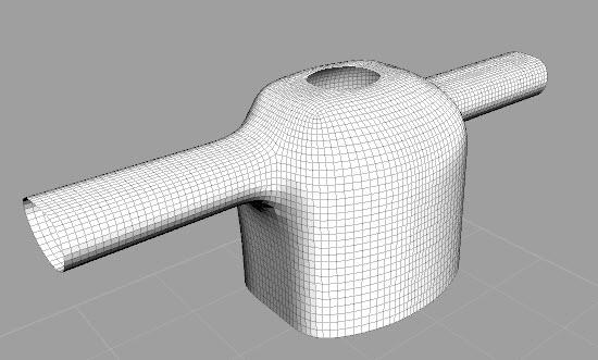

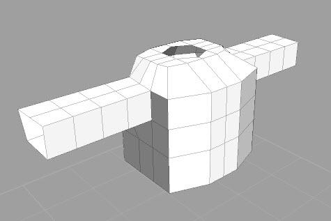

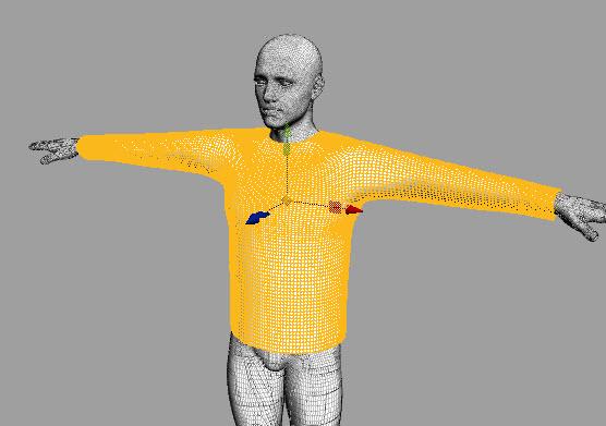

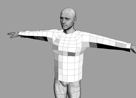

    42. Using Silo 2.5 to Create a Shirt.  With the success I had using primitive cylinders and cubes, I thought I’d give a try to making a shirt. Since the basic primitives in Daz Studio don’t have arm extensions, I used Silo 2.5 to create a model. I haven’t used Silo much so my attempt is crude (as you will see) but surprisingly it looks pretty good after applying dForce.
    a. This is the model made in Silo. I started with a 9-division per side cube and did some loop splitting, arm extrusion, vertex moving, and face deletion.  Not much to look at.
    b. One attractive feature of Silo is its subdivision abilities. This is the same crude model after multiple applications of subD. You can see how the square openings have become rounded without any work on my part.  I made this more detailed mesh into the control mesh (so it will be preserved upon export) and created an .obj file.
    c. Here’s the model after importing the .obj file into DS and placing it around a G3F figure. As you can see, it has poor fit and I had to tilt the head to avoid polygon clinging during the simulation. That wasn’t a problem as I did an animated simulation and moved the head later.
    d. Here’s after dForce simulation. Looks good I think!

  • sapatsapat Posts: 1,735
    edited May 2018
    Hey, this is great to know.  I also have Silo 2.5 and I don't really use it because I find the interface is not intuitive.  People may dog Hexagon, but it has a simple straight forward UI and is easy to use.  I also used to like C4D for the same nice UL.
    Thank you so much for sharing your work on this.  Much appreciated, and the shirt is just as good as stuff you buy.  Nice draping.

  • MelanieLMelanieL Posts: 7,878
    That blouse drape (from what is basically a box) is amazing! Lovely job.

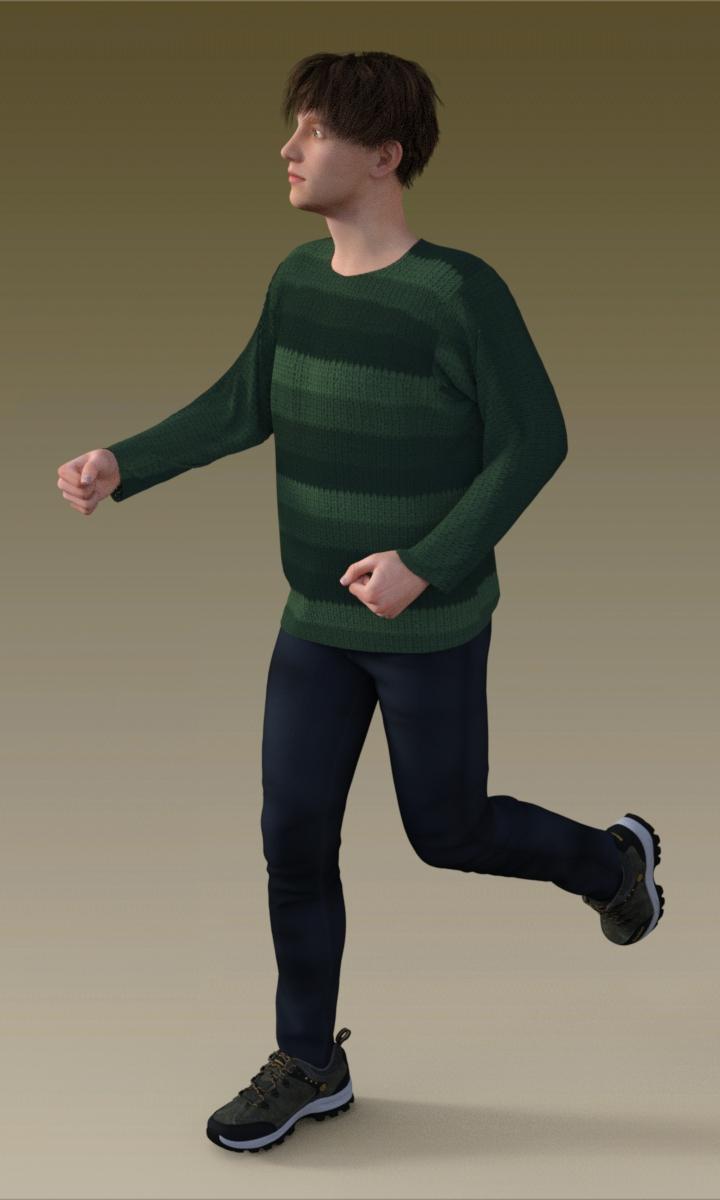

    43. Another Shirt Made with Silo. Since my first attempt was a reasonable success, I tried a second. Instead of using Silo’s built in female figure as a model, I exported a G3M figure as an .obj and imported that into Silo to build the shirt around. I started with the same basic model I did in section 42, but added more polygons and moved a lot of vertices around to better follow the shoulders and arms of the male. I also learned how to rearrange the UV so the texture would follow the shape. Below is the base model, the sub divided model, the shirt before simulation, and the resulting render.
    Base Model in Silo:
    SubD Model in Silo:
    Model Imported into Daz Studio:
    Final Render After Simulation:
    If it is of sufficient interest, I could put together a tutorial on how to use Silo to create a shirt like this.
    EDIT: I've also attached the shirt .obj file. Import it onto a G3M in default pose. You may need to expand the shirt slightly (I used 104% scale, 106.5% z-scale, and 0.87 z-translate) to better overlap the pants. Add the dForce dynamic modifier, add a new pose at frame 15, and run an animated dForce simulation.

  • OdaaOdaa Posts: 1,548
    I don't own Silo, but all tutorials for modeling clothing are welcome.
    ( easy to understand explanation cut out so the  post stays short )
    Thanks a lot. You really are the DAZ Guru *bows*
    edited May 2018
    @Odaa, glad you gave it a try. The issue about UV's didn't show up for me as Silo must automatically create a UV map, even though it's totally distorted until you remap it yourself. Still have to figure our how to adjust the front and back UV's of the shirt so the stripes match up.
    Does Hexagon do subdivision? On Silo, you have to bake the subdivsion before exporting otherwise the saved. obj reverts to the base model.
    I also tested a different pose by starting with the default T-pose, moving to the running pose, then lifting the left arm onto the back of the head. The shirt followed along. It is not conformed and has no bones.
    A squatting pose did cause the shirt to separate under the left arm and have some polygon distortion on a lower fold. I guess I made it a size too small! So dForce can't overcome everything. I'll have to learn how to rig clothing to see if that helps (barbult posted a link a week or so ago).
