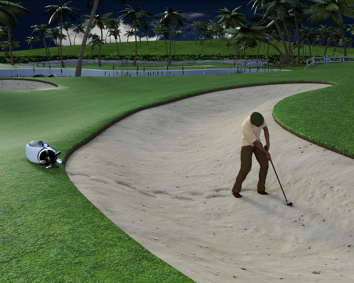

    32. Footsteps in the Snow, Sand or Mud - Part 1
    When a person walks along a beach or through the snow or mud, they leave footprints. Most 3D scenes do not show them as they are hard to build into a mesh, especially considering they could go just about anywhere. Here I show how to use dForce to create them in place. This approach uses a primitive plane, the animated timeline, a large setting on the Collision Offset surface property, and a push modifier.
    a. Create a primitive plane of size 20 feet and 100 divisions. The more divisions the better to capture the shape of a footprint, but too many slows simulation time.
    b. Add a dForce dynamic modifier to the plane. Select the plane’s surface, and in the Surfaces pane, set Simulation/Collision Offset to 6 (default is 0.2). This will keep the plane hovering over the ground when the dForce simulation is completed.
    c. Position the plane above a suitable landscape. I used the ground from Forest Winter which has a snowy texture and slightly rolling surface. Be sure the entire plane is above the surface of the ground.
    d. Add in a figure with a walking pose. You can use any figure but I used Lorenzo LoRez as it is low-poly and you need multiple copies, then replaced him at the end with a G3M figure.
    e. Set the first figure at the end of the path you want to create. Go to the main menu and choose Edit/Duplicate/Duplicate Node Hierarchies. Do this 4 times so you end up with a total of 5 figures. DO NOT CREATE INSTANCES – dForce ignores them during simulation.
    f. Position the 5 figures in a line at an appropriate spacing for the pace. Turn off the plane and set each figure at ground level or slightly above. Make a group of the figures for easier manipulation later.
    With the plane turned back on:
    g. Go to your Timeline pane. Set the counter at Frame 30. Select the group of figures and click on the Create Keyframe icon. Go to Frame 15. Raise the group so all figures are above the plane you positioned in step c. This will also set the group’s Frame 0 height. Be sure there is no timeline movements for the plane – dForce will bring it to the ground. As the simulation runs, the plane will fall first, then at frame 15 the figures will start to fall. This is important as you want the plane to conform to the shape of the ground before the figures push down to create the footprints.
    Frame 0: figures and plane above the ground
    Frame 15: plane draped on ground, figures still above
    Frame 28: figures just making impressions
    Frame 30: figures on ground forrming footsteps
    h. After the simulation, hide the 2nd through 5th figures, leaving only the first one in line. If you used a low resolution figure for the simulation, you can now load a G3M with a similar walking pose and position it in place of the low resolution figure. Be sure to adjust the legs so the feet match the position of the original figure.
    i. For some camera angles, this is sufficient. But if you can see the edge of the plane, it will be hovering above the ground and can cast a shadow or show items poking through.
    To correct this, we will add a push modifier and use a weight map to blend the edges of the plane into the ground.
    This section continues in next post

    Footsteps in the Snow, Sand or Mud - Part 2
    j. Select the plane and from the main menu choose Create/New Push Modifier Weight Node…
    k. Select the push modifier in the Scene pane, then go to the Tool Settings pane and select the Node Weight Map Brush. Halfway down the tool pane click on Add Map button next to the box that will show <New Push Modifier>. Set the value of the new push modifier to -6 (to compensate for the +6 Collision Offset we used earlier).
    l. Go to the top view. Click on the Geometry Selection Mode (the first of the far right icons at the top of the pane). Right click in the viewport and choose Geometry Selection/All. Next choose Weight Editing/Fill Selected… and enter a value of 0%.
    m. For the following steps, access the pop up menu by right clicking in the viewport and then selecting the appropriate command.
    n. Set Selection Mode to Marquee Selection. Hold down the left mouse button and select the central 75% of the plane. Choose Geometry Selection/Invert Selection so now the outside perimeter is selected.
    o. Click on the Paint Brush mode (the second of the far right icons at the top of the pane). Set the sensitivity to 0.6 and paint a red edge along the outside of the plane.
    p. Choose Weight Editing/Smooth Selected… and enter a value of 50%. This will smooth your painting from the edge into the middle of the selection.
    q. Go to Perspective view and look at the edges of the plane. Use the weight brush to touch up edges so they disappear beneath the surface. You may have to adjust the weight map value from -6 to -6.2 or more.
    A spot render showing the plane blended into the ground:
    A spot render showing what it would be like without the push modifier:
    r. Copy the ground texture to your plane. You may have to adjust tiling and other surface parameters to get it to match. If all is done right, you’ll have a final result that looks something like this.
    Areas for improvement:
    1. Some of the steps are smaller than the others. I would rotate the figure or change the right leg position on those.
    2. The footsteps don’t have enough of a foot shape (more important if bare feet in sand). Start with a higher resolution plane.
    Since weight maps can be a bit tricky to paint, I've attached a .duf file with a 100 division plane with the weight map I used to make this scene. [EDIT: I updated 3/19 as the original did not include the dForce modifer. Now when loaded you'll have the plane, dForce modifier, andpush modifier with weight map all ready to go.]

    34. Sand Trap. The golfer’s nightmare, landing in the sand trap. The sand is soft and the ball and the golfer sink in – except in Daz Studio. There the sand is stiff and hard, even if the shader gives the look of soft sand. This section uses the Golf Course Bundle: the course itself, the props (club, ball and bag), and the poses for G3M. It also uses the plane with weight map I used in sections 32 and 33.
    a. This terrain is a little trickier to add footsteps to, as there’s a sharp division between the fairway’s grass and the sand sloping down into a pit. I also found if I embedded the plane into one edge of the sand trap, it shriveled up and moved away. Not sure why that is, and there may be some surface settings to prevent that, but in the meantime I used an alternate approach.
    b. Follow the steps from section 32. For the most part, you do the same setup and simulation.
    c. I used the Lorenzo Lorez figures, positioning them from the edge of the sand to the lowest point. I then added in a G3M figure overlapping the last figure (as if you walked down, then turned in place, disturbing the sand in a larger area). The image to the right shows the Frame 0 setup. Note that the plane is above the grass and sand.
    d. Run the animated simulation. You’ll end up with something like this. There is no weight map activated yet, so the plane hovers slightly above the grass and sand.
    e. The part of the plane above the grass can be hidden by using the Geometry Editor. Use the Lasso selection method to choose polygons and then Geometry Visibility to hide the selection. You can do this in pieces, which is a good idea when you are working near the junction of grass and sand. In the image, the part I hid is shown in red.
    f. I started with the same weight map as I did for section 32 with a push modifier displacement value of -10 to merge the sides of the map into the sand. But since I hid the area over the grass, the adjacent part of the plane did not have any weights to smooth it into the sand, so I used the Node Weight Map Brush to add some weight along that edge.
    g. I found that I could not fully depress the edge with the brush, and if I set the push modifier displacement value lower than -10, the footprints started to disappear. So I added a SECOND push modifier to the plane, this time with a displacement value of -15. I only had to paint a small amount of the edge with the paint and smoothing brushes. This allowed me to depress the plane enough so a jagged saw tooth edge caused by the hidden square polygons was gone.
    h. Hide all the extra figures and render.
    With footprints:
    With no footprints: He must have flown or jumped to avoid disturbing the sand!
