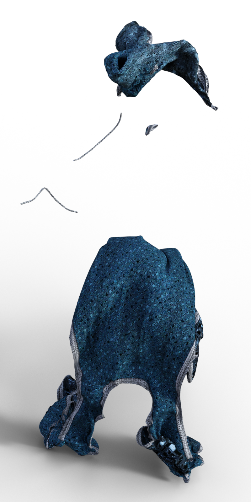

    Has anyone succeeded in getting Merimay for Genesis 2 females to work with dForce? It explodes when I use it. My Gravity in set to 0.5 and Self collide is off on the skirts
  • Aave NainenAave Nainen Posts: 1,108
    First thing I would suggest is turn Bending Stiffness way down, to .15 or even lower.  There really shouldn't be a need to turn self collision off at all, nor should you need to mess with gravity settings.  Load your figure, add the dress, add dForce modifier to the dress.  Use surface settings to reduce or turn off simulation strength on upper garment.  I use timeline simulation on all my sims and start from memorized pose.  Other than setting simulation to timeline versus Current frame you really shouldn't need to touch any other simulation settings, use the simulation surfaces instead to adjust how the skirt behaves.

    I'm sorry it's taken so long to get back to you @sueya. I've been testing the Merimay dress for you, although I used G3F.
    First, I'd like to thank Aave Nainen for stopping by and sharing the best settings to use with the dress. I can attest to the fact leaving Bend Stiffness in the default position will result in an explosion every time!
    Turning Self Collide to Off was pretty much a given when dForce was first released. If even one vertex intersected the mesh, either from itself or another object, the darn thing would explode. From what I've seen, that was one of the first bugs Daz fixed. Anyway, I've been able to successfully run simulations with it on, and sometimes find the results preferrable.
    The skirt of the Merimay dress does not conform to the pose. For this reason, it is actually necessary to have the figure in the default T-Pose, (or A-Pose for G8,) or the sim will begin with the legs outside of the skirt, and it will not properly drape. You can do this using Current Frame and Start from Memorized Pose, but like Aave, I use the timeline, and I recommend it for a number of reasons.
    I seldom use fewer than 46 frames, with the default pose at Frame 0 and the target pose usually at Frame 30. The time between Frame 30 and the end of the animation allows the drape to settle, and you can choose to use the drape anywhere along the timeline. Using Current Frame, you are "stuck" with the drape when the simulation ended. And if something doesn't quite fall right, you can alter the pose as needed between Frame 0 and Frame 30, (or wherever you put the target pose,) to improve the drape.
    Also, it isn't necessary to Start from Memorized Pose when using the Animated Timeline. I still start with the figure in the T or A pose most of the time, but occasionally, it comes in handy to move a body part out of the way. For example, I used Draupadi for my tests, and her feet are apparently larger than G3F, and got caught in the skirt. I was able to prevent that by bending her feet in Frame 0.
    It's important to note, the best feature of the Merimay Dress, using transmaps to dictate the style, is also an impediment to using dForce. Up to a point. The dress itself has a high necked collar, long sleeves and a floor length skirt. Add some shaders and you've got a very elegant dress. But… dForce isn't going to respect that transmap, from what I've been able to see while testing the Merimay Dress. I have some closeups to show you what the straps do in the back, with the Daring 02 style applied from the Christmas freebie, Double Dare for Merimay Dress. Although I did use an extreme, dance pose. Here are the images. clicking on the image, or the forum generated link below it, will open the image full-size in a new window.
    Specifics: Draupadi; Classical Dance Pose 03; Messy Bun Hair; Merimay Dress for G3F; Slippers from Fayre for G3F; Shimmer Iray Shaders.
    Image 01
    Image 01: The full dress. This pose stretched the skirt, not draping it as you see here. To achieve the drape, the figure was rotated to her side during the animation, so the skirt was able to ride up her legs.
    Image 02
    Image 02: This is the same simulation as Image 01. All I've done is hide the Sleeves and the Lower section of the skirt from Surfaces->Editor.
    Image 03
    Image 03: A new simulation, same animation, with the Sleeves hidden during the simulation. It wasn't possible to hide the lower section of the skirt, via the Surfaces->Editor or the Geometry Editor Tool. The hidden surface doesn't simulate and the connecting polygons get stretched.
    Image 04
    Image 04: A new file, same animation, with Sleeves and the Lower section of the skirt deleted via the Geometry Editor Tool, and the Daring 02 style applied prior to the simulation.
    Image 05Image 06
    Images 05 and 06: You can really see the how the "straps" of the dress have moved up and away from the body. As far as I can tell, it's because dForce "sees" the complete material zone.
    Image 07
    Image 07: The back of the dress without the transmap. The folds on the back are actually very nice, but you can see why the "straps" aren't lying against the skin.
    The drape of the skirt, in my opinion, is not as flattering in the second series. I used the same animation, which compensated for the longer skirt.
    I like the dress and how it drapes, but it does give mixed results. As long as you're not trying for an extreme pose like the one I chose, you should get decent results and still be able to use the Designer Packs. Just do the drape first, and then apply the Style/Design.

  • sueyasueya Posts: 873
    Thanks for your advice Here is my first attempt with the Meri May dress

  • L'AdairL'Adair Posts: 9,479
    Looking good!
    Was it easier or harder than you expected, after lowering the Bend Stiffness? And did you use the Animated Timeline?
    L'Adair said:
    Looking good!
    It was quite easy after lowering the bend stiffness. My PC crashed when I tried using the timeline so I had to do the single frame instead.

    Well , I'm draping the V4 Fitted tank and jeans on G8f using the timeline, and well this is what happens.
    I've also been having this weird problem with capes in dforce that try to wrap around themselves in the front all the time. I even tried putting a cylinder under the cape to keep the two sides away from each other and the cape just wraps around the cylinder. I'm using the free ods long cape from rendiosity by the way.
