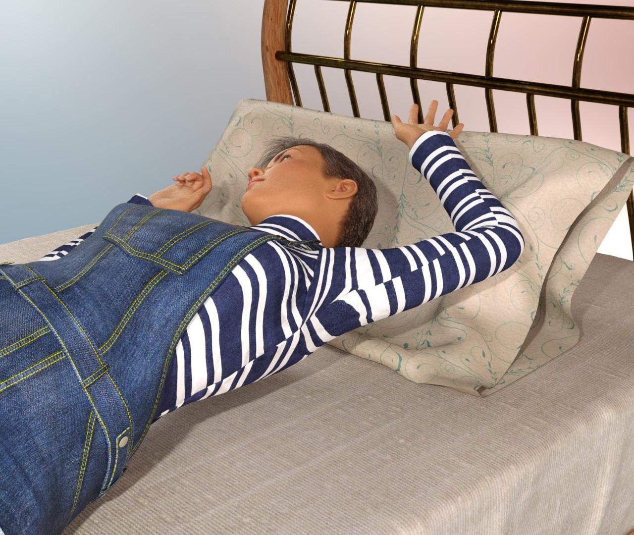

  • ArtiniArtini Posts: 10,507
    edited November 2017
    Another experiment with dForce and the pillow.
    Will need to further refine that scene.
    1280 x 1080 - 456K
    Post edited by Artini on

  • sapatsapat Posts: 1,735
    Looks really good and the pillowcase edges are nice the way they are falling.
    Thanks, Sapat. I am trying to create a weight map for the pillow,
    that allows the character volume to interact with the pillow during simulation.

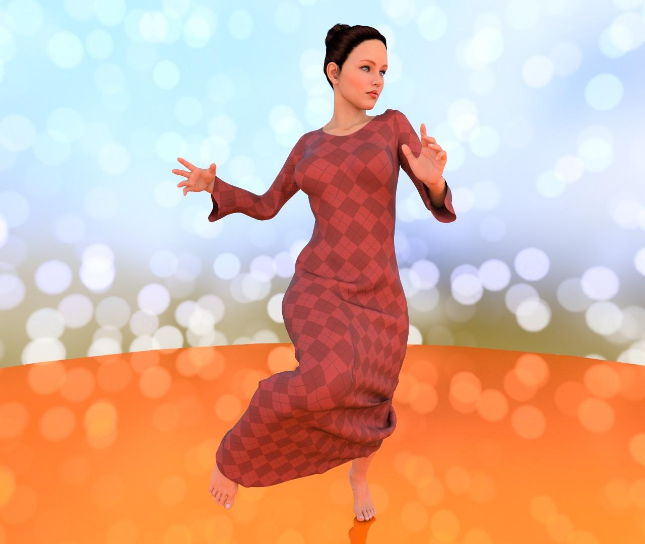

    Coven gown simulated with dForce on Olympia 6. Changed to iray shaders, because the original material was too dark.
    https://www.daz3d.com/coven
    https://www.daz3d.com/olympia-for-genesis-2-female
    1280 x 1080 - 208K
    1280 x 1080 - 192K

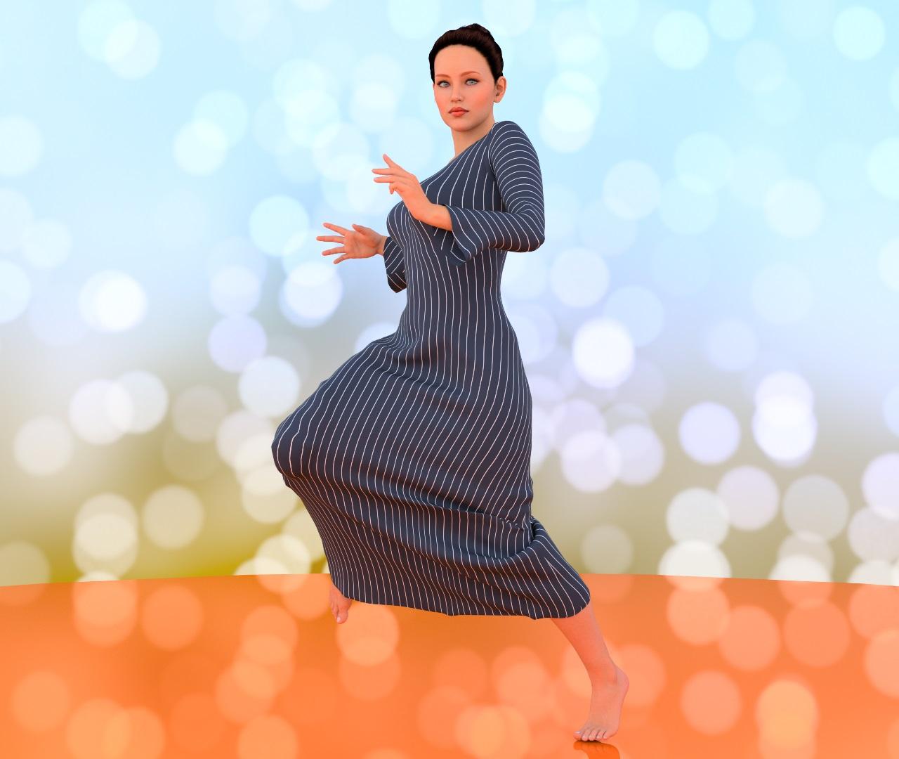

    With more extreme pose, the gown begins to look no so good (on the lower part of it).
    1280 x 1080 - 226K
    Agreed it starts to lose integrity, but with the other poses it seems to hold up.
  • barbultbarbult Posts: 26,461
    Real fabric wouldn't stretch that far either.
