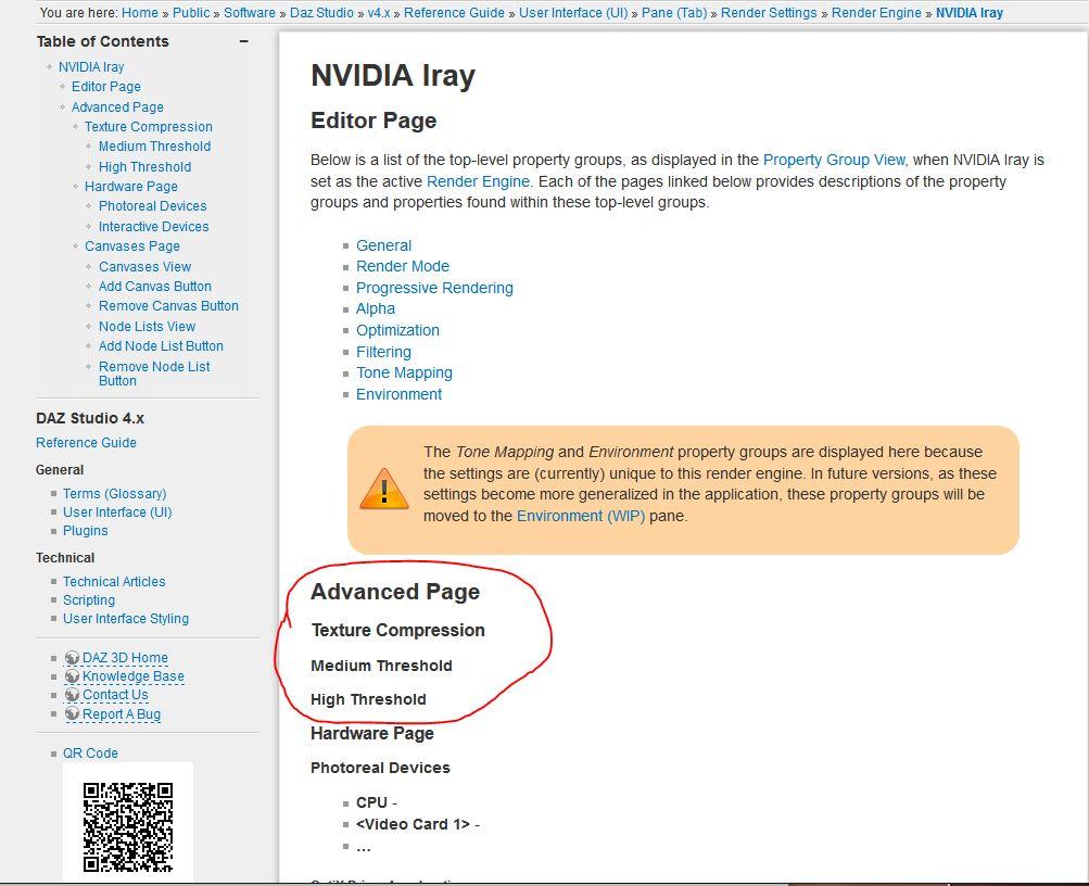

  • Richard HaseltineRichard Haseltine Posts: 111,101
    barbult said:
    OK, I rendered with Texture Compression on 512 for Medium and High and then on 4096 for Medium and High. (Is there any documentation on how to use there settings? Should the numbers for Medium and High be different? What do they mean?????)
    They are thresholds - anything above the threshold is compressed using the named algorithm (so in your case anything 512 pixels or above is subject to medium compression and anything 4,096 pixels or above iss ubject to high compression). I think this is in the docs.

    This is the sad state of the documentation (that I could find) on Iray texture compression.
    1003 x 816 - 118K
    Post edited by barbult on

    Ok thanks, the compression working in the beta build as well .. but I am using the general release build , anyway thanks
    I see no difference in the renders, but GPU-Z did show a difference in the amount of memory used. I will edit this message to attach screenshots showing the settings, render results, and statistics.
    Compression 512, Memory Used 3899
    Compression 4096, Memory Used 4608
    (Post edited, because I named my image attachements incorrectly. I fixed them)
    EDIT: Wait a minute - I did these tests in the beta 4.9.3.37, not the released version that Mec4D asked about. I wonder if that makes a difference?
  • MEC4DMEC4D Posts: 5,249
    OK false alarm , I reinstalled DS again and now it is working again cutting the memory in half no matter the iray viewport is on or off as the moment you change the threshold it update the viewport as well ( no before )
  • barbultbarbult Posts: 27,343
    Oh, good. I was going to go retest in the released version, but I guess I won't need to.
    No thanks , I just want to be sure if it was on my side only but after your tests with beta I was just talking the chance as nobody mentioned any fixes in this area and glad I  reinstalled  also other things got fixed like black eyes n the viewport sometimes , or other stuff that did not render proper in viewport , definitelly my instalation was some  way corrupted as before .
    barbult said:
