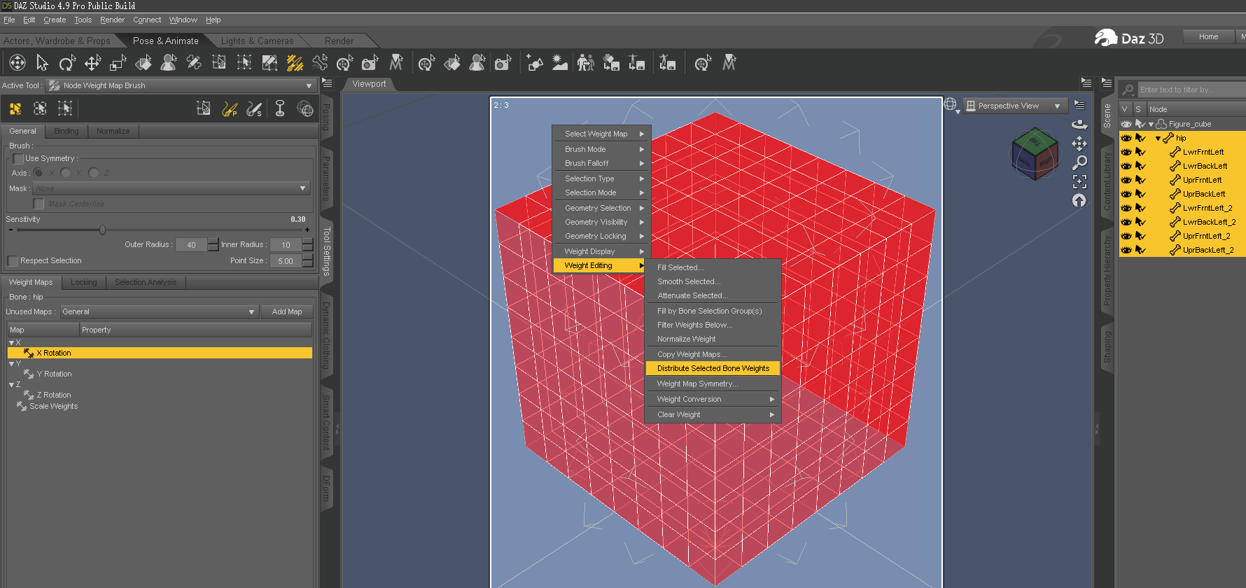

    "Distribute Selected Bone Weights" Are you sure, I keep getting one of the same two errors no mater what I try.
    or
    I've been fussing with this for a few hours now. What exactly was that "distributes the weights from the selected geometry of the primary selected bone among the other selected bones" supposed to do?

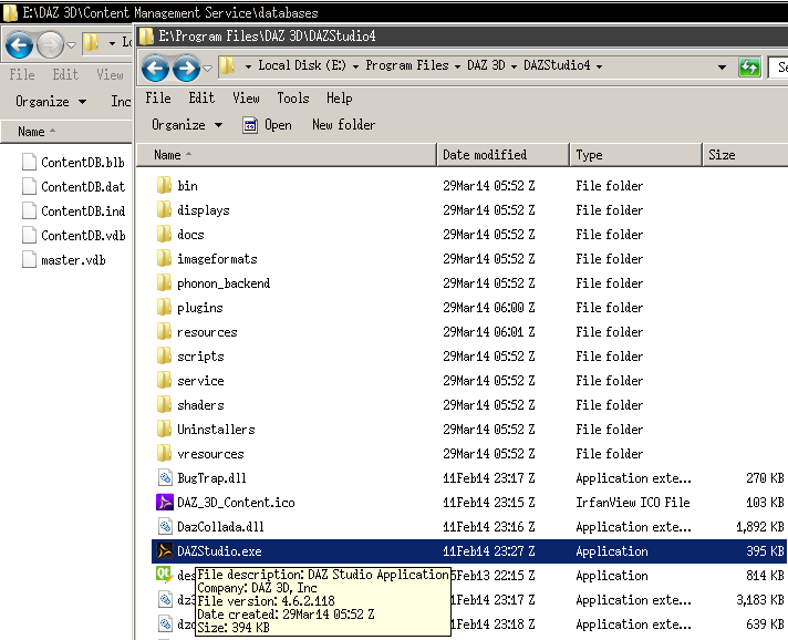

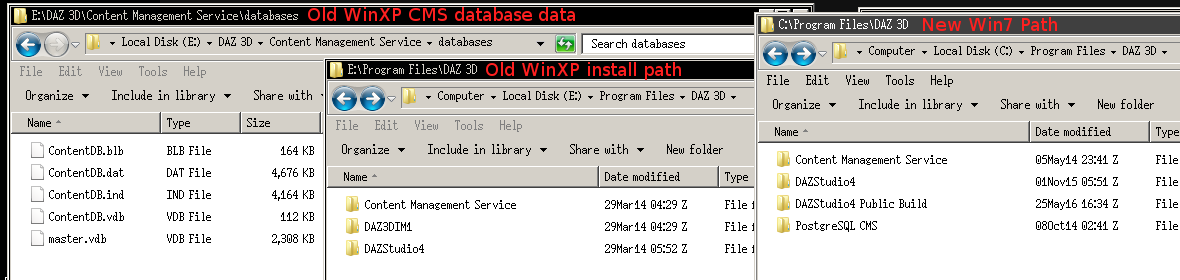

    That is a distinct possibility. Way back in the mists of time, I think it was Studio 4.7 or 4.8, there was a run once thing that happened threw DIM that swapped it all over to Postgres for me when I updated Studio. At the time there was a major push to get people off of Valentina for a few good reasons, It was many cups of coffee ago. So this is what the task manager may look like if your running Postgres instead of Valentina. The amount of ram used may very depending on how much stuff is in your content library, and I'm not sure about the number of them, I never really worried about how many instances of it there is.
    (EDIT) Here is the rest of it, ContentManagmentService, and possibly Studio if that is running. Sorry for any confusion from the lack of that in the other screen-cap. I was looking for a screen-cap of Valentina, and I think I switched over back in Studio 4.6 days from the looks of what I can find. (Fixmypcmike posted as I was typing this).

    You may be correct, all I know is that Valentena stopped running all the time and consuming vast amounts of my ram, way way way back, on win XP 32bit, lol.
    http://helpdaz.zendesk.com/hc/en-us/articles/207530503-PostgreSQL-FAQ#q2
    That may be of some remote help, tho some of the over simplified bullet-points may need to be further explained. I see a hint at Studio 4.6.3.50 as a possible switchover, so I may not have a copy of Valentina lingering here (if it was on the old 36GB raptor drive).
    It may be the "What is PostgreSQL Conversion from Valentina CMS?" that I'm thinking of in error. If I understand that correctly, you don't need to uninstall Valentina to switch to using PostgreSQL?
  • fixmypcmikefixmypcmike Posts: 19,730
    The switch to PostgreSQL did not uninstall the Valentina CMS.
    Correct, you don't need to uninstall Valentina to switch to PostgreSQL.  Remember that when PostgreSQL was introduced Carrara was still using Valentina.
    edited May 2016
    All right, going on the last note that you may not need to uninstall Valentina, and it appears there is no stand alone uninstaller exe for it. I found nothing, except my old Starcraft maps.
    Comparing install paths, I did note a few interesting things. That old drive has a version of studio that predates the minimum version needed for Postgre.
    And there dose not appear to be a independent Postgre folder in the old drive.
    However I was not able to locate anything specifically for 'MySQL' or Valentina.  I would need to swap out the CPU, RAM, and Graphics card if I was to try to boot off of the 32bit XP SSD, that just is not going to happen. I concede defeat, I have no idea where the uninstall would be hiding if it is not already where everyone else suggested as possibilities.
    (EDIT, good point about Carrara Fixmypcmike, I had forgotten about that note from back then)
