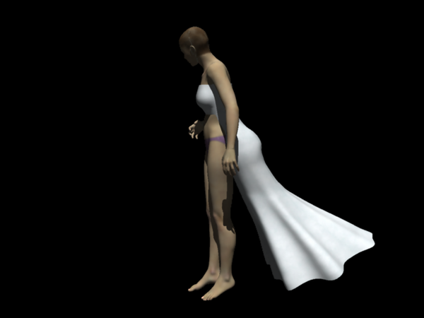

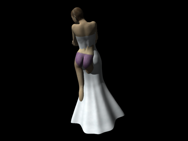

  • BrianP21361BrianP21361 Posts: 817
    I've got one.
    Trousseau from Frances Coffill
    http://www.daz3d.com/shop/trousseau
    It says it just works in Poser and not Daz Studio, but I bought it and tried it in Carrara. It loads and renders OK. You just can't pose V4 with it. I understand that if the legs move too much they'd come through the dress, but a simple bend at the waist causes the dress to pop out of the back. I haven't found a work around. Any ideas?

  • Frank__Frank__ Posts: 302
    I've got one.
    It's Poser dynamics and not a conforming figure as stated on the "Features"-page.

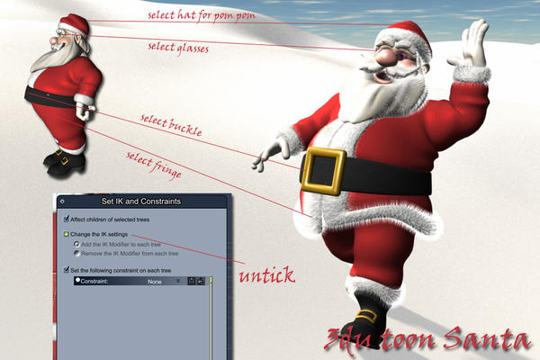

  • StezzaStezza Posts: 9,266
    3Duniverse toon Cow, not at all
    funny one this one as I had the toon cow and bull working fine in the previous 8.5 build but they now don't work in the current build.. I think they broke something!
    I could never get 3DU Toon Santa to work in 8.1 or earlier but so far in 8.5 it is working with this simple workaround.. This didn't work for me in all previous public releases so something has changed in the 8.5B
    When loaded Santa is missing several objects..
    1. his pom pom
    2. his glasses
    3. his belt buckle
    4. the fringe of his coat.
    Select each item and then Animation---> Set IK & Constraints then untick Change the IK setting.
    900 x 600 - 368K
    wow Stezza, how did you ever discover that?
    seems to be a common problem with 3DU stuff.. the same applies to Toon Gramps lab coat..
    Can't remember how I came across the fix.... I think it was posted a few years ago for the lab coat so I just kept trying the same on other 3DU items.. First time it has worked on Santa though :)
  • WendyLuvsCatzWendyLuvsCatz Posts: 41,689
    Brian, you can do static poses in that dress using Carrara softbody bullet physics (animated cloth in Carrara with keyframed vertex figures not good)
    also you can use attach skeleton and weightpaint it, unless it was made by Optitex, it would not work in studio either.
