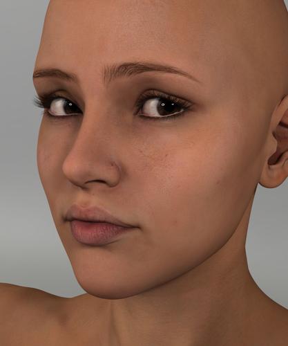

    I didn't realize gamma correction was such a controversial topic :) Anyways, it looks like from my last tests that the effects of either gamma setting can be approximated with the other one by adjusting exposure value/saturation/etc., so I'll just leave it on 2.2 and not worry about it.
    DS used to use gamma 1. Then we gained the ability to set the render gamma, but not to set the input gamma for textures in the standard shaders (so that in effect most colour maps, which had an effective gamma of 2.2, were double corrected). Finally we have both the ability to set render gamma and to set the input gamma for maps - in 3delight turning gamma correction on enables that, as far as I am aware the gamma value of a map is always used in Iray. Gamma sets the mapping used on creating the rendered image, for 3Delight gamma correction on tells the renderer to anti-correct any maps marked as other than gamma 1.
    Is it possible that some skin textures had extra (anti-)correction applied to them to make up for 3Delight's old behavior? I think there was mention on the Iray hair thread that opacity maps aren't working well for some hairs because of this.

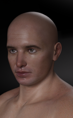

    This old fellow doesn't look so bad for his age.
    494 x 800 - 478K
    494 x 800 - 417K
    NICE! I'm envious, Why can't I have a build like that, lol.

  • evilded777evilded777 Posts: 2,516
    (6ft 2in, 185lbs soaking wet, lol)
    I was more referring to the fact that its Michael 4, but... most of his textures, when rendered in a PBR, do tend to make him look OLD. The wrinkles, the crows feet... my god, you'd think the guy was in his 60's.
    I shall keep my musings about your personal physique, or lack thereof as you are seeming to suggest, to myself. :)

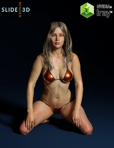

    Olympia HD
    1000 x 1300 - 484K
    Slide3D said:
    Olympia HD
    is that? Pleas don't take this the wrong way, I thought she was much darker toned then that.
    1000 x 1300 - 134K
    Slide3D said:
    Olympia HD
    3Delight SSS can make people very tan.
    To the poster who asked earlier, your G2M should already be able to use V5 UVs. He will pick up any UV that is in your G2F folders because their meshes have the same vertex order. I use old fantasy V4 skins on males all the time. ;)

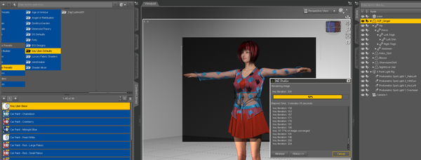

  • Dark MatterDark Matter Posts: 78
    Where is this mysterious IRay uber shader everyone talks about? All I see in my content directory is the standard IRay Optimized material and I cannot get it anywhere nearly what Slide3D and MBusch have gotten.
  • RiggswolfeRiggswolfe Posts: 914
    Look in your content library under shader presets or in smart content under materials.

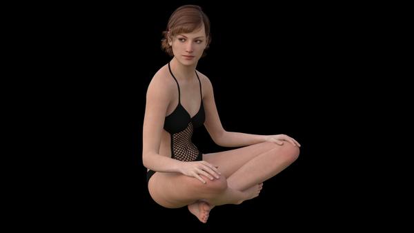

  • Arnold CArnold C Posts: 740
    edited April 2015
    Based on the information given in this thread I did my own attempt to build up a skin setup for the Iray render engine.
    Instead of applying the "Iray Uber Base" I tried to refine the "Iray Optimized Genesis 2 Female MAT" for retaining Bump strength, Tranlucency and Transmitted Color settings already been defined by someone anonymus at DAZ's.
    At first I moved the Specular Maps from "Glossy Color" to "Glossy Reflectivity" (like Khory suggested) and from "Top Coat Color" to "Top Coat Weight".
    IMHO, placing them in "Glossy Reflectvity" instead of "Glossy Layered Weight" (or just simply removing them) smoothens the highlights more up and you get a less plastic-like-glossiness you'll get by just tuning the Weight/Reflectivity/Roughness channels without any spec map.
    Just found recently out that this isn't quite correct. Could be dependent on the light, but the G2F spec map has some strange behaviour using bright lights.
    I changed "Glossy Layered Weight" to 0.333333, "Glossy Reflectvity" to the default 0.50 (like suggested in the Iray Shader documentation) and "Refraction Index" to 1.45 (which would be, according to Wikipedia, an IOR value for the human epidermis.
    After trying around a bit I finally left "Glossy Roughness" at 0.40, "Top Coat Weight" at 0.35 and "Top Coat Roughness" at 0.70 as already been defined.
    Then I changed "Top Coat Layering Mode" to Fresnel and "Top Coat IOR" to 1.45 (in lack of a definitive value for the sweat/oils mix I guess just as good as anything else), applied the respective specular map to "Top Coat Bump".
    At last I applied "Water - Thin” shader to "Cornea", "EyeReflection" and "Tear", changed the "Refraction Index" for the cornea to 1.38 and as 8eos8 suggests the "Eyes Cornea Bulge" morph to 1.0.
    Grabbed some hair against baldness... and a nice swimsuit to prevent getting bashed. :-)
    After working mostly with the build-in basic Sun-Sky light setup I did my final testrender with HDR Sky Cloudy (free)
    from HDRI-Hub, at default Tone Mapping and rotated 180°.
    So far I'm quite satisfied with the result.
    A big "Thank You" to you all for sharing your experiences.
    ADDENDUM 1.00A (28.04.2015):
    When setting up skin or any other non-metal, one should better use the "PBR Specular/Glossiness" workflow than the "PBR Metal/Roughness".
    As long as you have accurate real-world data available, it's much easier to work with, less hard guessing and also the more accurate your results are.
    1920 x 1080 - 266K

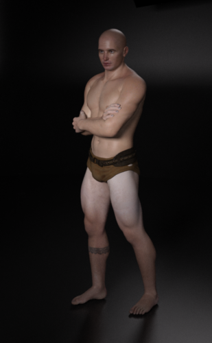

    Hmmmm....I don't see much difference between the default bump value of 0.45 (1st render) and increasing it to 2 and adding the bump maps to top coat bump (2nd render). If I go up to 5 (3rd render) then I think I'm starting to see a little more detail, but it's pretty subtle. I also tried 10 but it looked pretty strange, like her head was made out of concrete.
    1000 x 1200 - 624K
    1000 x 1200 - 609K
    1000 x 1200 - 609K

    With your figure lit from the front like that, its going to be hard to notice changes in the bump. bumps create shadows, if the light is coming head on there's nothing to cast shadow, if you move the light to the side it should be easier to notice the differences.
