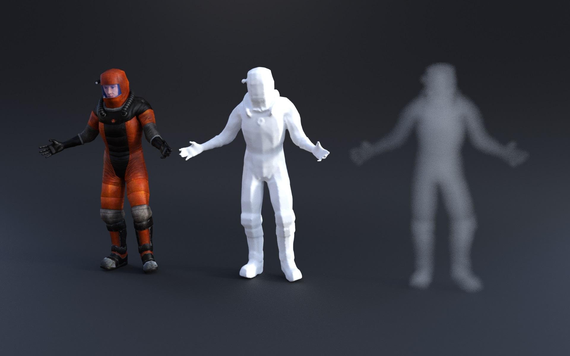

  • ArtiniArtini Posts: 10,754
    edited May 2022
    Thanks for the update - it works very well.
    I have converted:
    https://www.daz3d.com/lorez-14-mu-worker
    Does anybody know, how to made the resulted volume more pronounced (visible).
    Are there any ready made materials to use with such volumes?
    I have converted:
    crank up the density multiplier, say at 100 and you'll see...

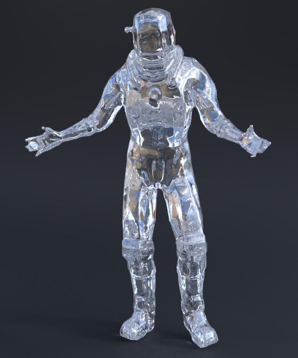

    edited May 2022
    Thanks for the answer - I will test it soon.
    My favorite part is to render the Volume to Mesh objects with different materials.
    Below is the previous mesh rendered with Diamond material from DAZ Uber set.
    1000 x 1200 - 200K
    Post edited by Artini on

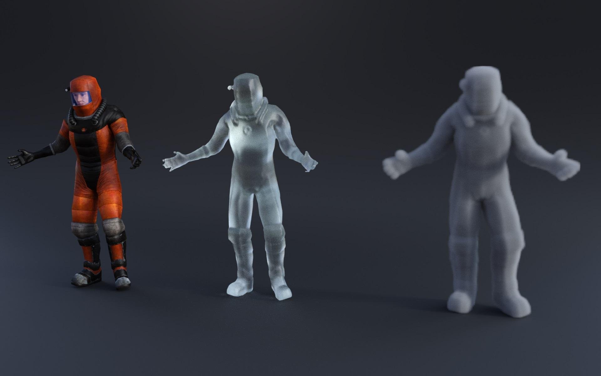

    edited May 2022
    Thanks again for the tip - that is what I want.
    Below is a render of Volume with density multiplier set to 100.
    1920 x 1200 - 214K
    That's a cool feature, isn't?
    You are welcome, and if you play with the Scattering and Absorption colors you can achieve lot of nice effects.

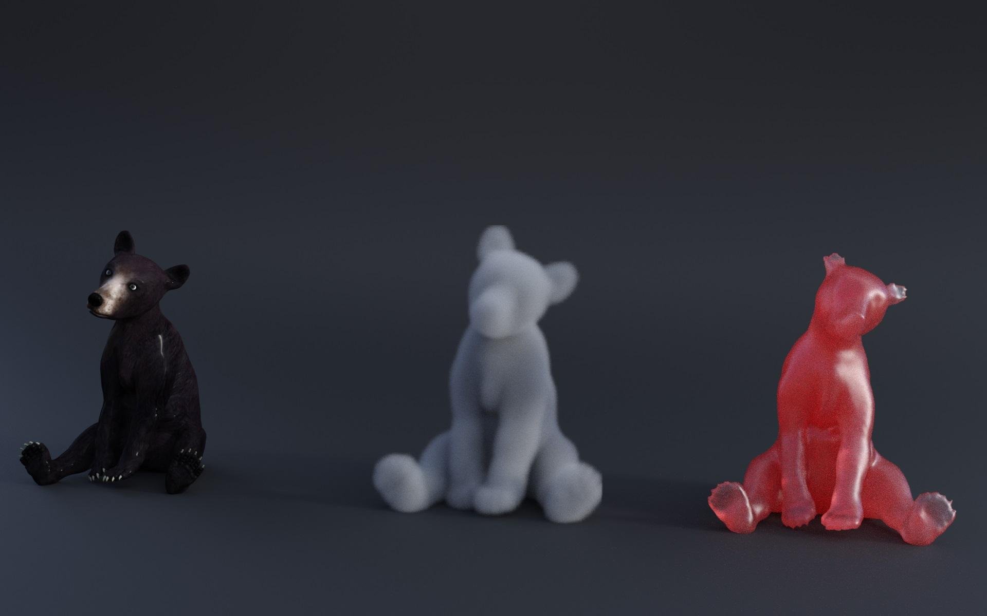

    edited May 2022
    Another example render of
    https://www.daz3d.com/black-bear-cub-by-am
    1920 x 1200 - 202K
    Well the red one looks like a very yummy gummie wink
  • barbultbarbult Posts: 27,042
    Alessandro Mastronardi said:
    It looks like someone already nibbled on his ears.

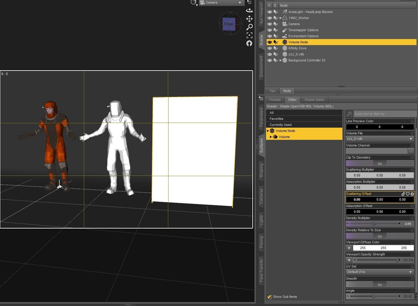

  • Alessandro MastronardiAlessandro Mastronardi Posts: 2,658
    edited May 2022
    Added tutorial for making fog volumes quickly and painlessly:
    Full Playlist here: https://youtube.com/playlist?list=PLzUOVK5mlH3oJA1TbeNPkIlOG1M_8n4YY
    1226 x 992 - 481K
    Post edited by Alessandro Mastronardi on
