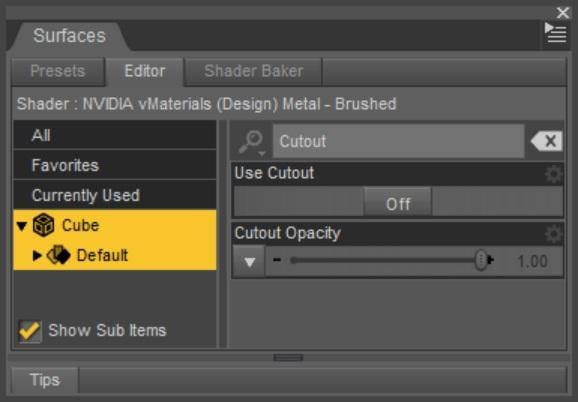

I have added support for adding a user specified cutout (recommended by @Catherine3678ab), but adding a cutout forces the material to be "Thin Walled" and so does not work as expected with all materials. I have not found a way to determine if a material is thin walled while generating the presets (other than if it already uses a cutout), so for some materials you must enable cutouts via an additional option.
Cutout Option

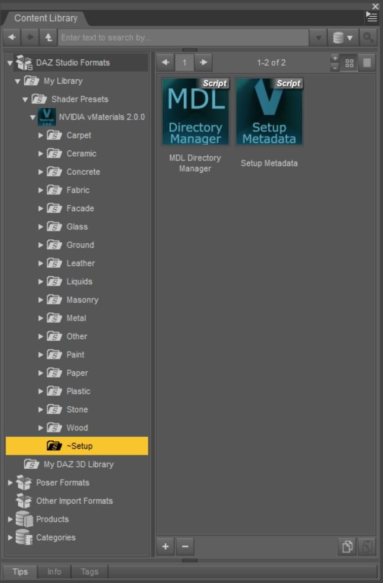

  4. Navigate to "/Shader Presets/NVIDIA vMaterials 2.0.0/~Setup"
    Setup Folder

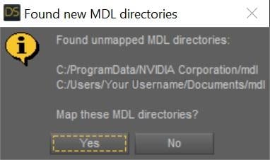

    1. If the new MDL directories were automatically found, click "Yes" to map them
      Map MDL directories prompt

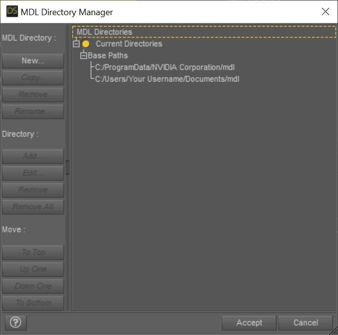

    2. If the new MDL directories were not automatically found, map them manually
      MDL Directory Manager
  6. Click Accept
  7. Run the "Setup Metadata" script

    You've added it as a new directory set, it needs to be added as a new base path in the current directory set instead.
    Look at the first post in this thread for what it should look like.
