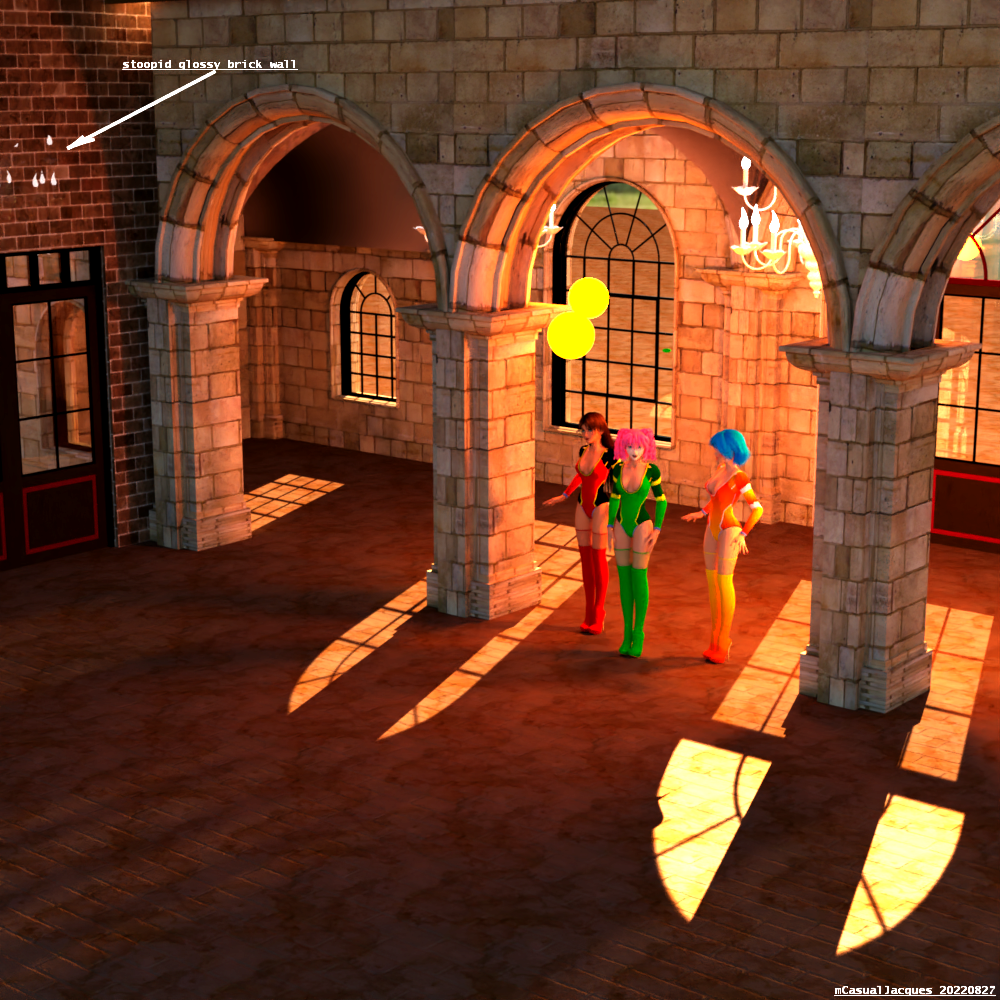

    thanks i needed a stone-tiles floor for this floor which has visible tiling-patterns
    1000 x 1000 - 1M

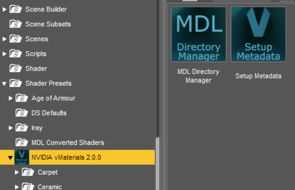

    I am trying to get this working at the moment.
    Note about one issue:
    The mega.nz download has the two scripts in a subfolder not in the root.The install screenshot on the first page shows:
    But the files in the zip are in:
    I copied them manually into the root and it is working.
