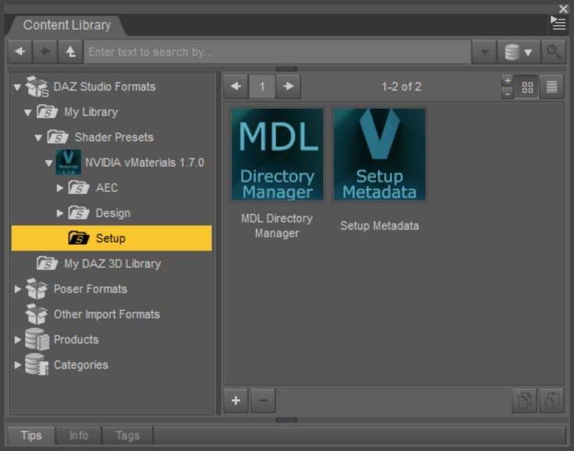

  4. Navigate to "/Shader Presets/NVIDIA vMaterials 1.7.0/Setup"
    Setup Folder
  5. Run the "MDL Directory Manager" script

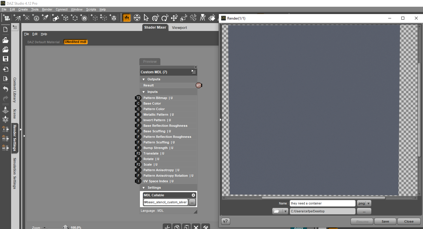

    I understand that they work fine in the other programs although I don't have the other programs to test that myself. I do know that in Daz Studio they "need" what I call a "container" to enable D/S to read them. Some raw materials with which to work ;-)
    Here's an example for those that are interested, without any helps what the unedited sans container .mdl files would otherwise produce.
    1448 x 784 - 547K
