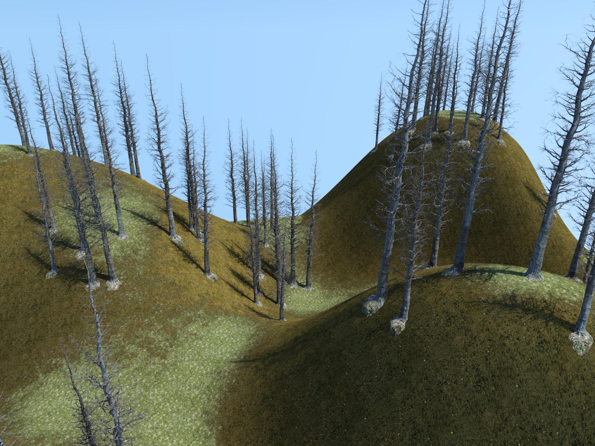

    Experiment: Change origin of a prop to control its height on the UltraScenery terrain
    Updated to move the tree to center trunk on X and Z axes.
    chris-2599934 suggested here, that the height of a prop on the UltraScenery terrain might be controlled by the origin of the prop, and that by modifying the origin, we may be able to prevent those dead tree bases from sticking out of the ground. I think this is a great idea and very promising! It gave me the additional idea of modifying the shape of the base of that tree, too. At first I thought of just deleting some polygons. After some thought, I decided maybe I could just reshape the base to drag some of the roots "underground". I am going to use Mesh Grabber (Wow, half price today May 23, 2020) to do these tasks, but you could export to an external modeling tool and reimport instead, I guess. Mesh Grabber lets you do it all inside Daz Studio.

    3. Create a steep terrain so we can evaluate the performance of the new dead tree on the steep slope.
    4. Select No Feature. (We don't want Features changing the slope of our terrain for this test.)
    5. Select the Dead Trees Ecology.
    6. Build only the Dead Trees layer so we can clearly see the bottom of the trees against the bare terrain.
    7. Apply the USC Late Morning Render Settings preset.
    8. Render the scene.

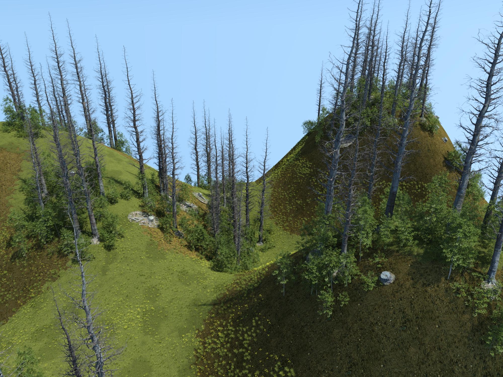

    9. Well, well, well, Chris is a hero! I'm no t sure my"root ball" idea was the best approach, but it looks much better than the flat base poking out. The orign modification Chris suggested is definitly worth while.
    10. Build the UltraScene again with all layers selected.
    11. It looks pretty good. Now those stumps look like they could use a similar treatment, especially those very large stumps. They won't need much modification, though, because they are aligned to the ground normal.

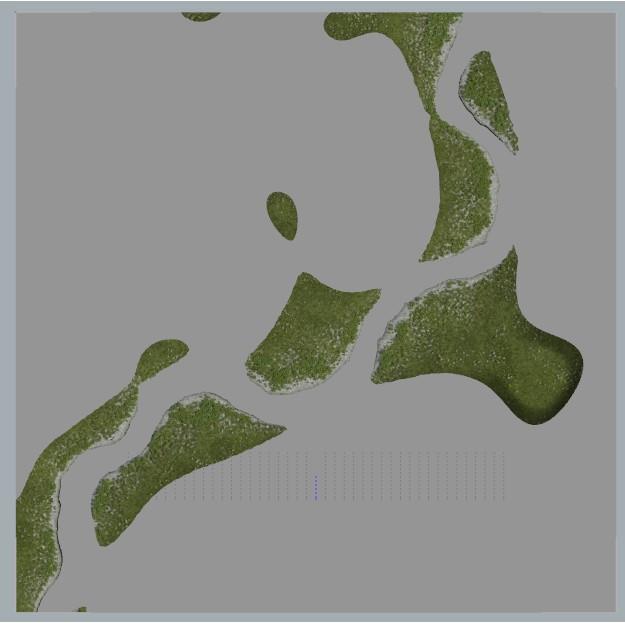

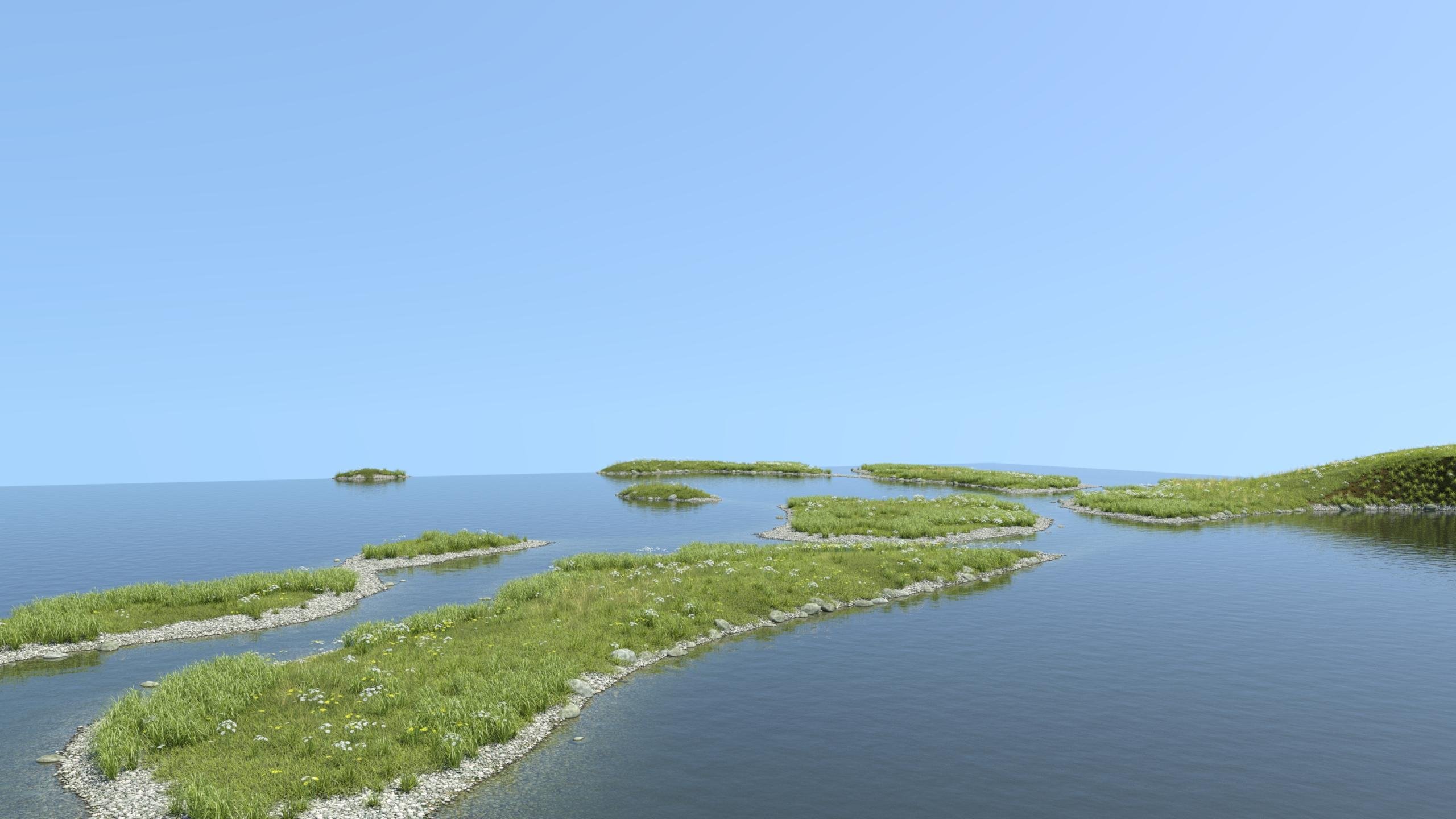

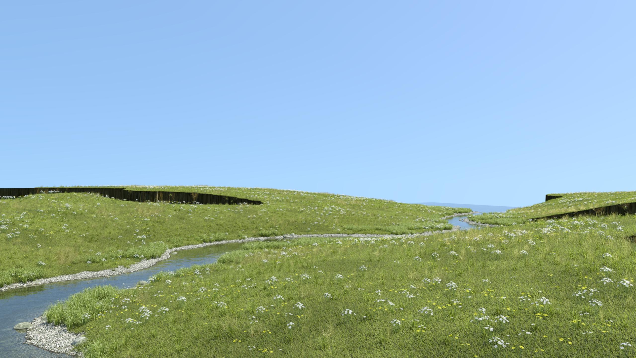

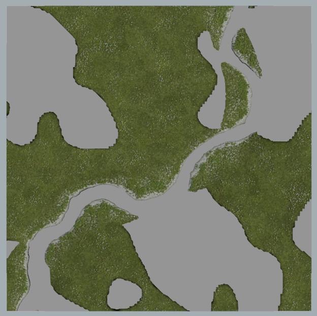

    Experiment: Use Negative Altitude to Create Interesting Terrains
    I learned from HowieFarkes that max altitude in the UltraSceneCreator dialog can be a negative value. Let's see what happens when we do that.
    1) Try the default noise terrain settings with a negative max altitude
    1. Open Daz Studio
    2. Run the UltraSceneCreator script
    3. Scene tab: Let's just use the default noise settings for the first attempt, but change the default Max altitude from 5 to -5.
    4. Features tab: I think negative altitude will be interesting with water features, because the top of the water is always forced to be at altitude 0. So, I am going to select River 2 for the Feature.
    5. Ecology Tab: I think any ecology will work. I'll start simply and select Grassland 1.
    6. Build tab: I'm going to uncheck all vegetation layers and build just the terrain, until I see if I get an interesting terrain. I won't check Extend forest, since Grassland 1 doesn't have trees anyway. I won't restrict the instances to a camera, because I want to explore this whole scene to find interesting views.
    7. Click the Build Scene button.

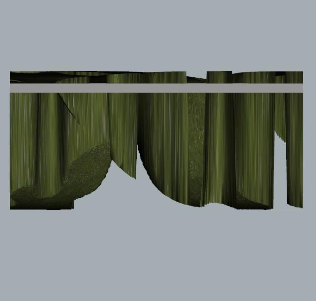

    8. Looking at a top view of the whole UltraScene in the viewport, I see that I got a bunch of small islands in a big area of water. Using a negative max altitude completely changed what the River 2 feature looks like. It is like I have a whole new feature to play with.
    9. Looking at the front view of the whole UltraScene in the viewport, I see that there is a lot of terrain deep under water. That is kind of interesting.
    10. Select the UltraScene in the Scene pane and run the UltraSceneCreator script, to build again with all of the ecology vegetation layers checked in the Build tab.
    11. Move the camera to an interesting angle and render.
    2) See what changing the contrast of the noise does to the terrain generated with negative max altitude
    1. Select the previously generated UltraScene in the Scene pane and run the UltraSceneCreator script again.
    2. Scene tab: Drag the Contrast slider all the way to 100. The noise preview is just black and white blobs now.
    3. Features tab and Ecology tab, leave the previous settings of River 2 and Grassland 1.
    4. Build tab: Uncheck all of the vegetation layers to quickly build just the terrain.
    5. Click the Build Scene button.
    6. Looking at the top view of the whole UltraScene in the viewport shows much more land area now. Run the UltraSceneCreator script again, to compare the noise preview with the top view of the UltraScene in the viewport. Observe that dark areas of the noise preview become raised land areas and light areas of the noise preview become water areas. The River 2 area is water and cuts through the land like normal.
    7. Looking at the front view of the whole UltraScene in the viewport, we see that the land sticks up much higher above the water now. It looks like very steep cliffs off the edge of the land.
    8. Select the UltraScene in the Scene pane and run the UltraSceneCreator script, to build again with all of the ecology vegetation layers checked in the Build tab.
    9. Move the camera to an interesting angle and render.
    10. I don't like those sharp steep cliffs. I'm going to try contrast 25 instead of contrast 100. That will avoid the abrupt transition from black to white.
    11. Yes, that looks better. It is similar to the default noise with contrast 0, but adds a bit more land mass to the scene.
    Contrast 100
    Contrast 25
    Same terrain with Mossy Hollow ecology
    842 x 837 - 46K
    2560 x 1440 - 1M
    657 x 552 - 56K
    624 x 621 - 87K
    647 x 615 - 39K
    2560 x 1440 - 2M
    625 x 623 - 46K
    671 x 599 - 35K
    2560 x 1440 - 1M
    UltraScenery Negative Max Altitude -5 Contrast 25 River 2 Mossy Hollow 2.jpg
    2560 x 1440 - 3M
    Post edited by barbult on

    Oooh!  I need some tropical plants....  nice work, Barbult.  How did you get the ocean in the back?  Is that just the US water plane extending out?
    Post edited by sandmanmax on
    Yes, with the negative max altitude and a feature containing water, like the River 2 that I used, the majority of the UltraScene is water. All the water you see in the negative max altitude images above is just the standard USC water. I didn't add any water or extend or scale anything to get that.

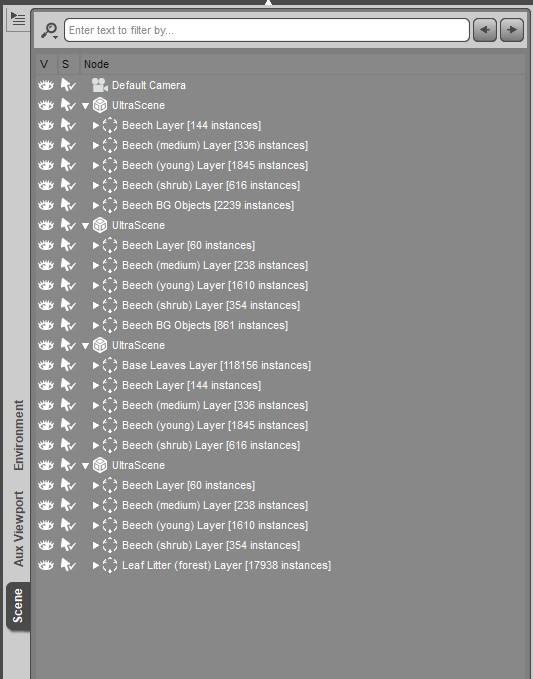

    2) Create a composite UltraScene that contains all of the tree and leaf objects available for the selected tree type. I want to do this so I can eventually create a single hierarchical materials preset that will cover any of the ecology selections for that tree type. For Harpwood Trail, I have 4 ecology options available. To save build time, and since I am limiting my experiment to trees and leaves, I will build only those layers. Warning - U-Turn ahead. I discovered an oversight described here.
    1. Run the UltraSceneCreator script and select the default terrain, _NoFeatures, and Harpwood 1.  On the Build tab, turn off visibility to Base Violets and Ferns, to build only layers with Beech in the name. Check the box for Extend Forest, because the extended forest is made up of trees. Don't restrict the build to a camera (leave it none). Click the Build Scene button.
    2. Unselect UltraScene in the Scene pane. We want to build a second UltraScene, not rebuild the current one. Run the UltraSceneCreator script and select the default terrain, _NoFeatures, and Harpwood 2.  On the Build tab, turn off visibility to all layers that don't have Beech in the name. Check the box for Extend Forest. Don't restrict the build to a camera (leave it none). Click the Build Scene button.
    3. Unselect UltraScene in the Scene pane. Run the UltraSceneCreator script and select the default terrain, _NoFeatures, and Harpwood 3.  On the Build tab, turn off visibility to the Ferns layer. Base leaves layer and all layers that have Beech in the name should still be visible. Check the box for Extend Forest. Don't restrict the build to a camera (leave it none).Click the Build Scene button.
    4. Unselect UltraScene in the Scene pane. Run the UltraSceneCreator script and select the default terrain, _NoFeatures, and Harpwood 4.  On the Build tab, turn off visibility to the Base Grass, Ferns, Grass Tufts, and Long Grass layers. Keep visibility on for the Leaf litter layer and all layers that have Beech in the name. Check the box for Extend Forest. Don't restrict the build to a camera (leave it none). Click the Build Scene button.

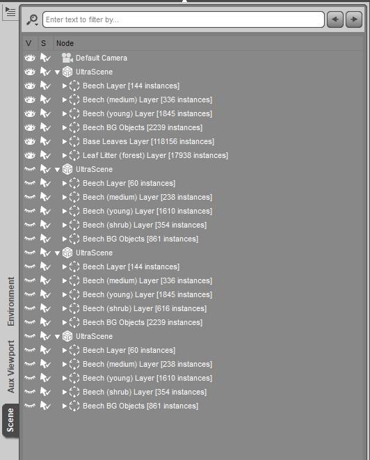

    5. Select the first UltraScene in the Scene pane. Right click and select Expand>Expand All. Now we can see all of the objects and instances in all 4 UltraScenes. (See screenshot below)
    6. Compare the second expanded UltraScene with the first expanded UltraScene, to see if there are any object in the second one that aren't in the first. I don't see any differences in the included objects.
    7. Compare the third expanded UltraScene with the first expanded UltraScene, to see if there are any object in the third one that aren't in the first. Right away I see the the Base Leaves Layer group that has three Fallen Leaves objects in it. Change the parent of the Base Leaves Layer group from the third UltraScene to the first UltraScene, either by drag and drop or by right click Change Parent. Continue to compare the third and first UltraScenes. I don't see any other differences.
    8. Compare the fourth expanded UltraScene with the first expanded UltraScene, to see if there are any object in the fourth one that aren't in the first. I see the the Leaf Litter (forest) Layer group that has one Fallen Leaves objects in it. Change the parent of the Leaf Litter (forest) Layer group from the fourth UltraScene to the first UltraScene.
    9. The first UltraScene now has all of the unique objects. This is the UltraScene that I will make a hierarchical materials preset from later. The other UltraScenes still have trees with materials different than UltraScene 1, and those will probably be useful, so I will not delete them yet.
    10. In the Scene pane, hide the second, third and fourth UltraScenes. (Hold the Ctrl key while clicking the eye icon next to the UltraScene name to hide the entire UltraScene tree. Do this for each of the three UltraScenes to be hidden.) We only want to see and render the first (our composite) UltraScene. (See screenshot below)
    11. Save the scene so you have a scene with all of the Harpwood Trail objects in it. I'll name my scene UltraScenery Harpwood Composite Step 1.
    12. Render the scene to get an idea of what it looks like now. I'm using the UltraScenery USC Morning Light render settings preset and 3DOutlaw's SkyCam Angled S camera (get it here). My render shows a very dense green forest with yellow/orange leaves on the ground. (See attached render below)
    All four Harpwood Trail Ecologies
    Composite UltraScene created by reparenting Base Leaves Layer and Leaf Litter (forest) Layer to the first UltraScene. Other UltraScenes have visibility turned off.

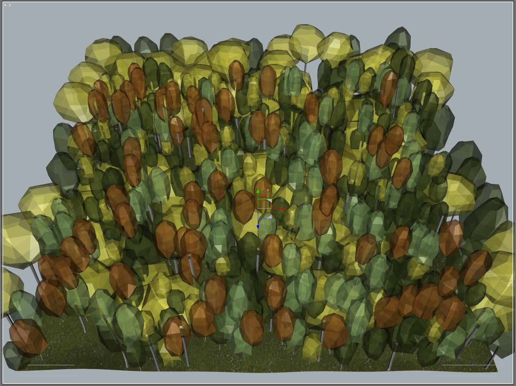

    3) Modify the trees to include both green and yellow trees. This part will be pretty easy. I'll just copy the surface settings from a yellow tree and past it to the surface settings of a green tree to make it yellow.
    1. In the Scene pane, expand the third UltraScene (one of the yellow ones). In the Beech Layer and select the Beech Large 02. (Be sure the select the tree object and not the proxy.)
    2. In the Surfaces pane, expand the Beech Large 02 to show the surfaces.
    3. Select the Leaf surface.
    4. Right click and select Copy Selected Surface(s).
    5. In the Scene pane, expand the first UltraScene (our composite) and select Beech Large 02.
    6. In the Surfaces pane, expand Beech Large 02 to show the surfaces.
    7. Select the Leaf surface.
    8. Right click and select Paste to Selected Surface(s). We can see the green tree image maps change to yellow and other surface settings, such as Translucency Weight change, too.
    9. In the other Beech tree layers of the first UltraScene, select a tree or two and paste the yellow leaf surface material to the leaf surface of those trees. Be sure to include the Beech BG objects in this process. Those are the extended forest. I chose to paste the yellow leaf surface to Beech Medium 01 (2), Beech Medium 02 (2), Beech Small 02, and Beech Large 02. It doesn't matter exactly which trees you select to change to yellow. The important part is to leave some green and change some to yellow in each layer. Don't do anything to the Base Leaves Layer or the Leaf Litter (forest) Layer.
    10. Save the scene so you have a scene with all of the Harpwood Trail objects in it. I'll name my scene UltraScenery Harpwood Composite Step 2.
    11. Render the scene to get an idea of what it looks like now. It is a very dense forest with some green tres and some yellow trees. There are yellow/orange leaves on the ground. (See attached render below)
    12. Once I've confirmed that I have both green and yellow trees in my composite UltraScene, I no longer need the other UltraScenes. To simplify things, I am going to delete the other three UltraScenes (the ones that I previously hid).
    13. Save the scene again with only the composite UltraScene in it.
    Render of composite Harpwood Trail UltraScene with some green and some yellow trees
    533 x 679 - 73K
    532 x 661 - 72K
