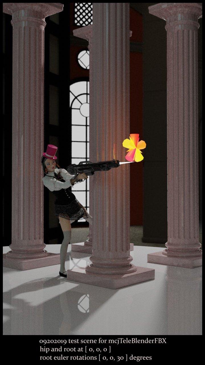

    La dame de pique VS The mean unascertained bad guys
    720 x 1280 - 127K

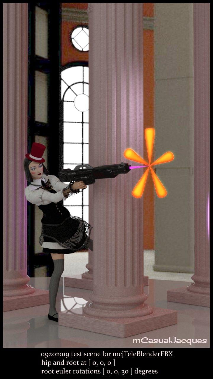

  • mCasualmCasual Posts: 4,607
    September 2019 edited September 2019
    la dame de pique test results
    the rotated root node position = ok
    hip position position = ok
    rotated orange cones parented to a rotated null node ... problem
    dress morphs or bone-rotations ...problem
    720 x 1280 - 170K
    Post edited by mCasual on September 2019
    progress ! https://www.daz3d.com/forums/uploads/FileUpload/8b/8122e1bf28693f61a786c018d71635.jpg
    720 x 1165 - 64K
    who knows ( nobody knows ) maybe i'll roll out a beta Sunday )
    running tests on the daz studio to blender via FBX scripts I'm quite happy the animated cone chain worked perfectly
    unfortunately the clothes and hair morphs or bones have issues
    but that will be fixed later ( if it's not too complicated )

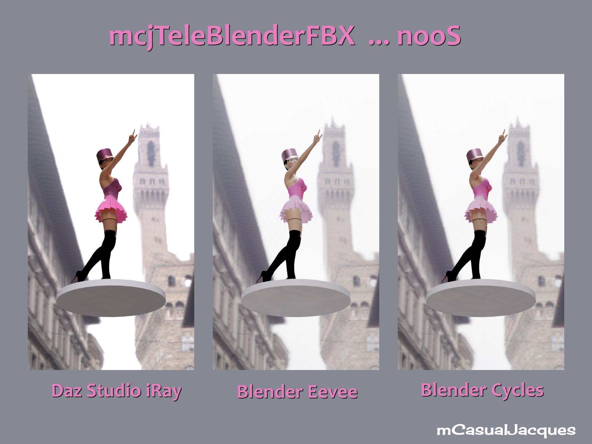

    October 2019 edited October 2019
    Silver Dolphin said:
    Ooooh, nice
    At Long Last
    A First Version of mcjTeleBlenderFBX which lets you import rigged and animated scenes from Daz Studio
    https://sites.google.com/site/mcasualsdazscripts9/mcjteleblenderfbx
    800 x 570 - 59K

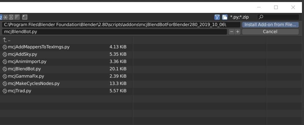

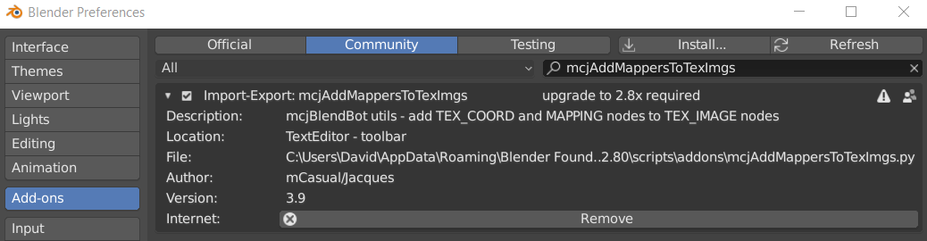

    I downloaded the scripts and tried to install them. DAZ side was simple enough but I hit a snag on the Blender 2.8 install. I have to say that I'm not very experienced with Blender but I assumed that I needed to enable the addons in the script so I selected all the .py files in the folder you supplied and tried to enable them in User Preferences but I ended up with an error complaining that a script needed to be updated to version 2.8. Here is the error.
    1038 x 270 - 53K
    Post edited by marble on October 2019

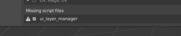

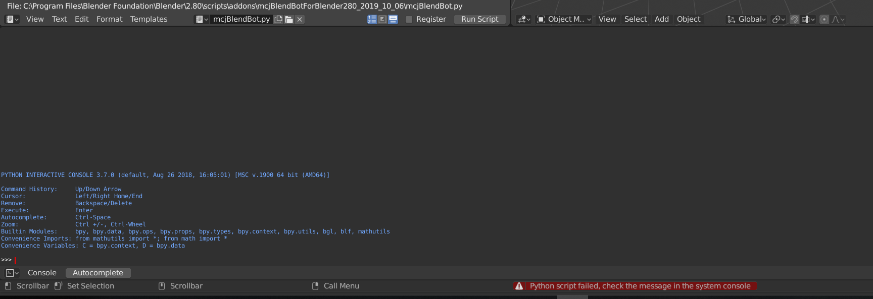

  • marblemarble Posts: 7,500
    Following on from the above post, I returned to your web page and continued reading the help guide but it only deals with the DAZ Studio script. There is nothing to say what to do in Blender, so Blender opens automatically but comes up with the splash screen and nothing else. Is there another page somewhere that describes the Blender side?
    I guessed that I had to run the mcjBlendBot.py script but again I got an error (again, I am working in the dark here because I know nothing about running scripts in Blender).
    1728 x 593 - 107K
  • HibernatusHibernatus Posts: 19
    October 2019
    The  Blender portion of this system mcjBlendBotForBlender280....zip  can be found at the bottom of this page
    You must unzip it in the Blender 2.80  scripts\addons folder
    typically : C:\Program Files\Blender Foundation\Blender\2.80\scripts\addons
    I guess that's all you need to do. BlenderBot will be accessed by DAZ Studio, you don't need to mess with it. In my (very old) system, I never had any problem. In Studio, I just click the export/open button in TeleBlender. Magically, Blender is launched and, in an instant, my scene is there.

    Okay, non-native English spéaker here. I tried my best, anyway. What I tried to say was"put the script in the right place, that's all you need to do". That's what I did.

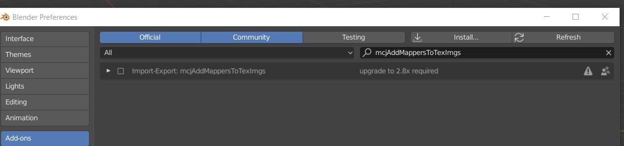

    Just to add a couple more screenshots to show what I am trying to do here. I attempted to install the new teleblender scripts into Blender 2.8 using the Preferences > Addons > Install function. The scripts are in a folder and my post above showed the first script in that folder because I tried to select all and install. I've also tried individual scripts and had errors too. The "Missing Script File" Error below came up when I tried to install just the mcjBlendBot.py script.
    1038 x 427 - 60K
    615 x 125 - 9K
    sorry if i dont respond more often but i dont seem to get notification-emails from this forum thread
    in my Blender installs, "ui_layer_manager" is not mentionned by any script, not even 2.7x
    maybe ( just maybe ) your default .blend scene file contains old scripts or scripts i dont know about
    maybe you installed an addon that gets called each time Blender runs and that add-on is not in your Blender 2.8 addon foilder
    ui_layer manager seems to be old , 2012, in the blender 2.63 days http://blender-addon.blogspot.com/2012/05/layer-manager-14-for-blender-263a.html
    note that blendbot only contains functions which are only called by the scripts that mcjTeleBlenderFBX produces
    for example when you use mcjTeleBlenderFBX it produces
    domo.bat          10/17/2019 6:45 PM
    domo.fbx          10/17/2019 6:43 PM
    domo.py            10/17/2019 6:55 PM
    domo_fixFbxAnim.py 10/17/2019 6:43 PM
    domo_fixFbxMats.py 10/17/2019 6:43 PM
    the 3 .py files are Blender Scripts that use the services of mcjBlendBot
    domo.fbx, sets up the scene, adjusts the renderer, then it loads domo.fbx,
    then it adjusts cameras, then it runs the 2 other scripts
    those scripts repair the materials and animations that were mishandled by Blender's FBX importer
    So I uninstalled Blender - completely wiped all traces of older versions. Then I downloaded Blender 2.8 and installed the fresh version. Then I downloaded the BlendBot zip file and, in my new Blender 2.8, installed the zip file using the Addon Install method from zip under Preferences. Here's what happened after the install ...
    1262 x 295 - 39K
    1275 x 382 - 69K

    marble said:
    marble said:
    Right, so the .py files should not be installed. I wasn't sure how to install addons so I read the instructions from various Blender tutorials and they all described the method I used, not just copying the files into the add-on folder. However, that's what seems to work and the install method does not.
    Thanks for your reply. Just one further question - have you tried a G8 figure? Mine seems to come into Blender with a very bumpy skin.
    October 2019
    personally i use a Window's unzip utility
    and i copy/paste the .py files in the addons folder
    i dont know if it helps or not to install them using Blender
  • jorge dorlandojorge dorlando Posts: 1,159
    October 2019
    you need to check this :
    1274 x 783 - 134K
    October 2019
    in my case the auto-run-scripts option is always off
