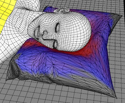

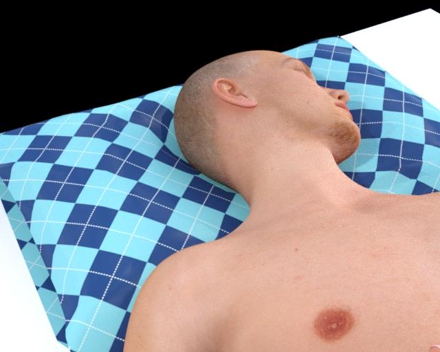

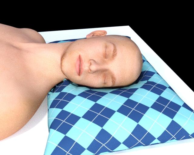

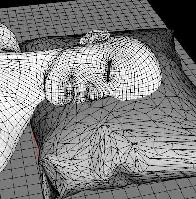

    b. A second pillow is from The Breakfast Nook. Like many others, it has triangular faces which causes issue with dForce. It has also been somewhat deformed by the vendor who wanted them to look like they had been “in use”. Here’s what to do to use it with dForce:
    i. Create a plane or cube to serve as a mattress. Load the pillow onto it and lower it so it penetrates into the plane or cube. Add a dForce dynamic modifier to the pillow.
    ii. Next load and position a figure. You will see the pillow cuts right into the face. On the animation timeline, set the figure so the upper body is raised at frame 0. At frame 8, have the body lowered and turn the head to the side as shown.

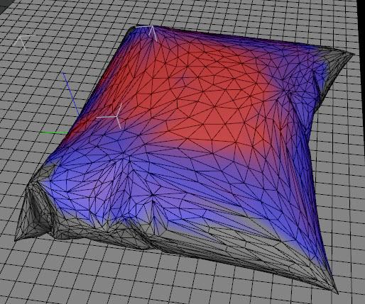

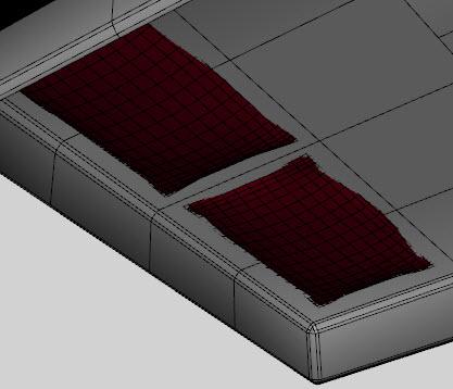

    iii. Add a dForce weight node to the pillow: choose Create/New dForce Modifier Weight Node. A new child weight node will appear in the Scene pane under the selected object. Select the new weight node object, and from the Tool Settings pane, select Node Weight Map Brush in the Active Tool drop-down box. In the lower section of the pane, choose dForce Simulation::Influence Weights in the unused Maps drop-down box then click on the Add Map button.

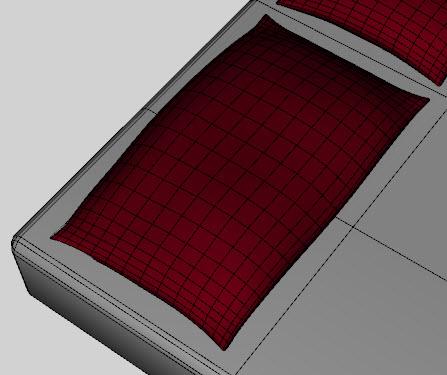

    iv. The object will be red showing that the weights on the map are at the full strength of 1. Right click in the viewport and choose Geometry Selection/Select All. Then right click in the viewport and choose Weight Editing/Fill Selected and enter 0% to clear the weight.
    v. Choose the paint brush mode (4th icon from right at the top of the pane, has a small P in lower right corner). Start to paint around the head until it becomes red again. Paint less on the surrounding area so it is blue. Use the smooth brush mode (3rd icon from right at the top of the pane, has a small S) along the colored edges to make the transitions smoother.
    vi. The triangular faces will cause the mesh to explode. In the Surfaces pane, set Bend or Stretch Stiffness to 0.3. In the Simulation Settings pane set gravity to -0.1 then run the simulation.
    vii. The head will have depressed the center of the pillow where the red was painted. There will be less deformation as you move towards the gray areas.

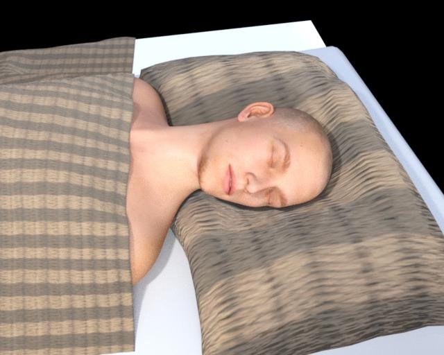

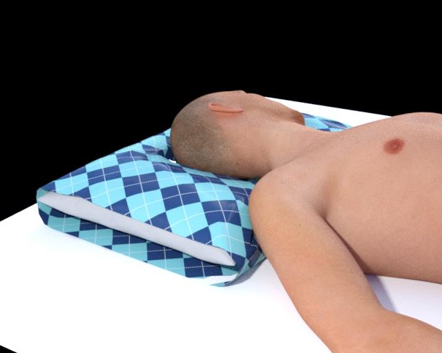

       A finished render:

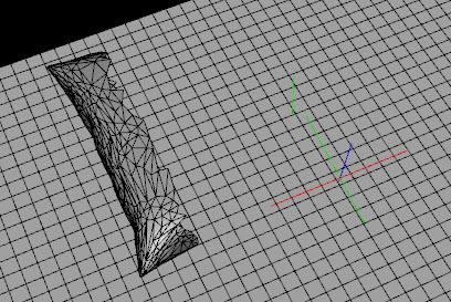

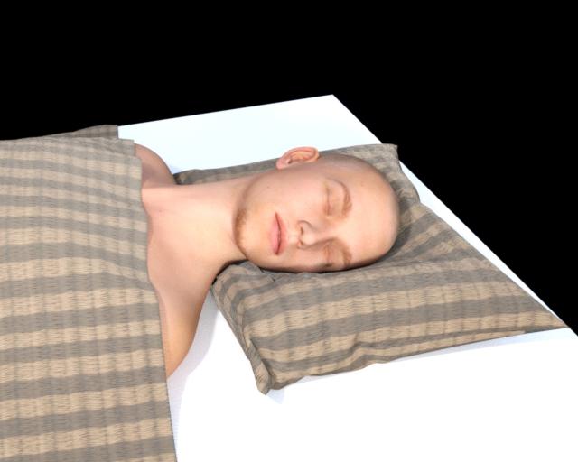

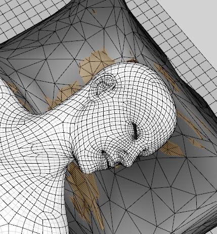

    c. A third pillow is from Day in Bed. This one is tricky because although it is one object, it has a pillowcase around the pillow. There’s a mesh within the mesh that will create issues. It also has the triangular faces that cause problems with dForce.
    i. Repeat all the steps in section b for this new pillow.

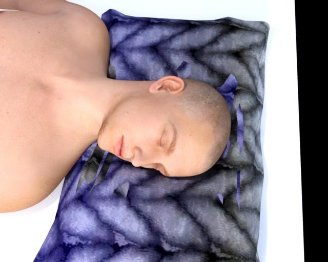

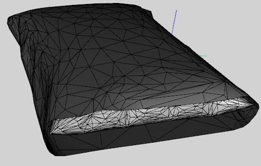

    ii. After simulation, you will find that the interior part of the mesh (orange) has protruded through the exterior mesh. The interior has a different mesh design, in particular, smaller faces. Because the meshes have different size faces they behave differently. Plus when painting the weight map, it was applied to both interior and exterior as there is just one surface.
    You may get away with this behavior if you have a single-color shader or material, but for most shaders you’ll see the interference as in this image.
    iii. To correct this, we’ll first create a second surface:
    1. Select the pillow in the Scene pane.
    2. From the Tool Settings pane, select Geometry Editor in the Active Tool drop-down box. Right click in the viewport and choose the Selection Type/Polygon Selection and drag Selection Mode.
    3. Click one face of the interior pillow (you can access it from the side). Right click in the viewport and choose Geometry Selection and click on Select Connected.
    4. Right click in the viewport again and choose Geometry Assignment/Create Surface from Selected and give the new surface the name pillow.
    5. The new surface won’t show the Simulation property group in the Surfaces pane until you re-add the dForce dynamic modifier to the pillow.
    iv. We could stop here if you set the camera so you don’t see into the gap on the left side.
    1. Right click in the viewport and choose Geometry Selection/Select By/Surfaces/ Pillow.
    2. Right click in the viewport again and choose Geometry Visibility/Hide Selected Polygon(s).
    3. Now that the pillow is hidden, leaving only the pillowcase, you can do a simulation and get good results.

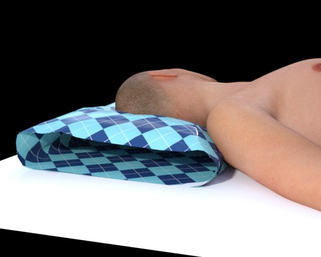

    v. If your camera does need to include the left side, you’ll see that the pillow is missing.
    You can change this by hiding most of the interior:
    1. Right click in the viewport and choose Geometry Selection/Select By/Surfaces/Sheet then Geometry Visibility/Hide Selected Polygon(s). This hides the pillowcase so you can do the next step.
    2. Next use the Marquee selection tool to select the left hand portion of the interior mesh then Geometry Visibility/Hide Un-Selected Polygon(s) to hide the rest.
    In the Geometry Editor click on the eye icon for the Sheet surface to turn it back on. Run the dForce simulation and render the results.

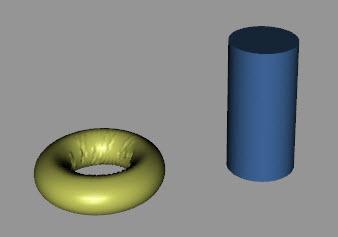

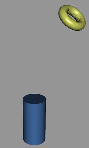

    63. Momentum Transfer
    Some have asked if dForce can be used to cause a ball to bounce. It can’t (at least so far) but it can transfer momentum and cause an object to fly away. I first saw hints of this while testing a particular scene and then I changed Simulation settings and surface settings to enhance it. The animated gif shows what happens.
    a. Create a torus of 1.5 inch major diameter and 1 inch minor diameter, Y-positive, 100 segments and 32 sides. Add a dForce dynamic modifier to it.
    b. Create a cylinder 4 inches high, 2 inch diameter, 20 segments and 32 sides.
    c. Set up a 60-frame animation so at frame 0 the cylinder is about a torus diameter away.
    d. At frame 10, have the cylinder move forward and collide with the torus off-center.
    e. Set gravity to 0. This means the torus will neither rise nor fall or move unless it undergoes a collision.
    f. Set air resistance to 0. This removes drag and allows the torus after the collision to move farther and faster.
    g. Set Buckling Stiffness to 100% and Buckling Ratio to 0. This will mostly keep the torus from collapsing in on itself when hit.
    h. Set density to 10. This will make the torus surface stiffer.
    i. Run the simulation. You will see the torus partially collapse when struck by the cylinder. Momentum is transferred to the torus, the torus’s surface will rebound, and it will fly away.
    Frame 10:                                                        Frame 16:                                                      Frame 30:
    Frame 60:
    j. What is this good for? I don’t know but it suggests there may be a way to get dForce objects to bounce off surfaces.

    Bouncing_Ball_02.duf
    1M
    Post edited by Praxis on
  • RGcincyRGcincy Posts: 2,864
    With the added momentum, you're getting a good amount of bouncing. Definitely has the right look. Good job figuring this out. I'll add links to these posts to the index on the first page.
