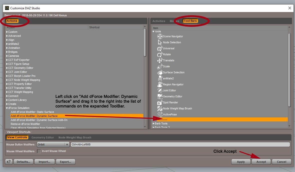

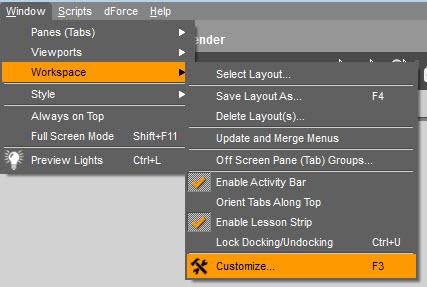

    Here is a different way to make "Add dForce Modifier: Dynamic Surface" easily accessible. This doesn't require the Script IDE or any script editing.
    1. Go to Menu Window/Workspace/Customize, or just hit the shortcut key F3.
    2. A dialog window will open. In the Actions pane on the left, scroll to dForce Simulation and expand it with the arrow. In the expanded list of commands, you will see "Add dForce Modifier: Dynamic Surface".
    3. In the pane on the right, click on the ToolBars tab and expand one of the toolbars that you want to add the "Add dForce Modifier: Dynamic Surface" to (for example, the Tools menu). When deciding what ToolBar to use, select one of the ToolBars that you have enabled and visible in your  workspace.
    4. Back in the left pane, left click on "Add dForce Modifier: Dynamic Surface" and drag it to the right pane, into the list of commands in the expanded ToolBar.
    5. Click the Accept button.
    6. At this point, you can close and reopen Daz Studio as Rich described or save a new Workspace that you can reload later at any time (Window/Workspace/Save Layout As... or shortcut key F4).
    Now "Add dForce Modifier: Dynamic Surface" will appear in your toolbar and you can click on it like any other tool.

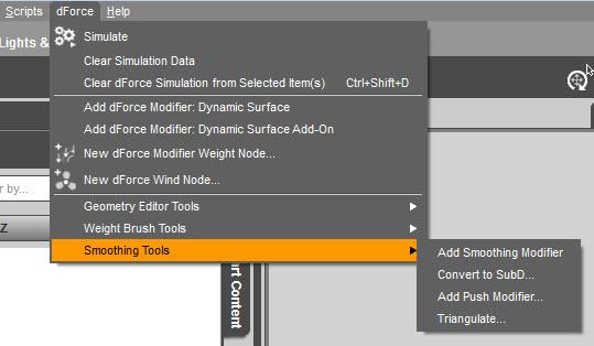

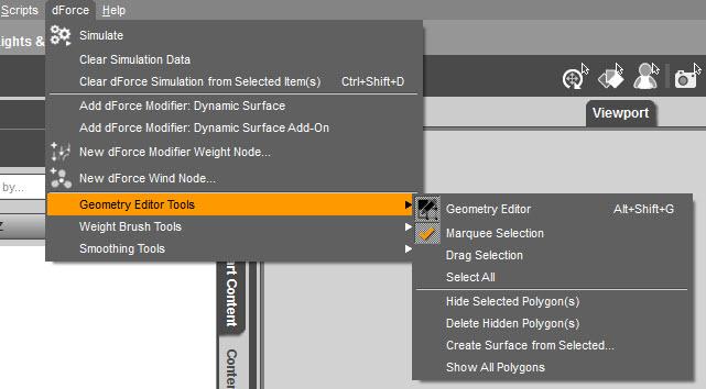

    61. dForce Menu Addition. Building upon the comment made by barbult above, I modified the main Daz Studio menu to include a personalized dForce menu. Instead of remembering the many locations and menu/submenu combinations needed for various actions, I have those I use most often in one easy to access spot.
    a. Below shows the modified main menu. The dForce choice is second from the right.
    b. This is the structure I set up. The first three items are so I don’t have to open the Simulation Settings pane so often, the next four consolidate several Edit and Create Menu actions, then the last three are submenus for tools I frequently use together with dForce.
    EDITED 10/2019: I have a new menu structure which is shown here. The details for creating are the same as shared in this post.
    The image above also shows my most often used Geometry Editor actions. The image below shows the same for the Weight Brush tool. Although I can call the Weight Brush tool from this menu, I still have to go to the Tool Settings pane once to create the map.
    This last image shows the Smoothing tools. This allows quicker access then using the typical menu/submenu navigation.

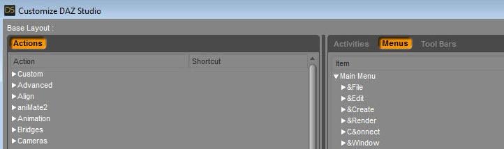

    c. To create a similar menu for yourself, you have to first open the Customize tool. From the main menu, choose Window/Workspace/Customize.
    d. You’ll see a pop-up that looks similar to below. In the right pane at the top, click on the Word Menus.
    e. Right click on Main Menu in the right hand pane and Select Add Submenu. Type dForce.
    f. Drag the word dForce down to your preferred location in the main menu.
    g. To populate your menu, select actions in the Left Hand Actions pane and drag and drop them onto the dForce menu item in the right pane. The most recent added action will be at the top. You can later drag it down into position. You can also add a separator or sub-menu by right-clicking on the word dForce and selecting the desired action.
    h. The hardest part in constructing the menu is finding the Actions in the left hand pane. The ones I used were found in:

    i. After adding and moving the actions into position, accept the result. The new menu structure will now be in effect. You will lose this new menu if Daz Studio were to crash, so close DS and reopen before proceeding. Alternatively, you can save your layout by choosing from the main menu Window/Workspace/Save Layout As...
