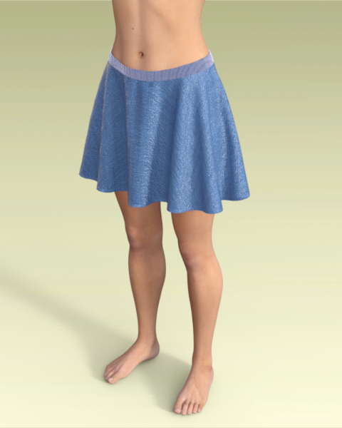

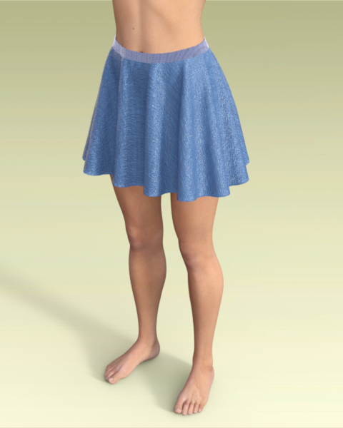

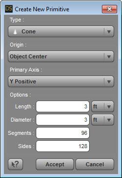

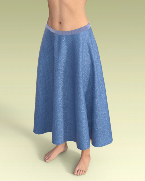

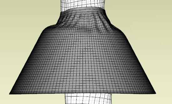

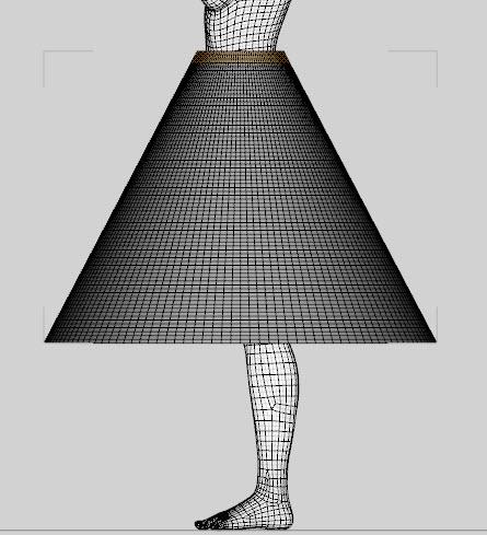

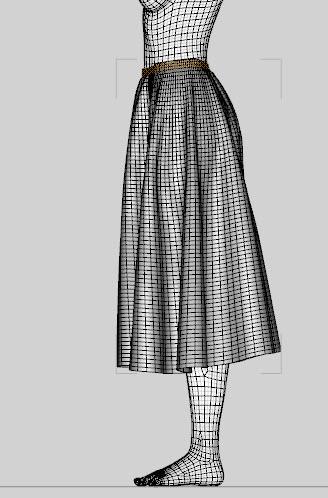

    38. Create a Skirt from a Cone. One of the simplest clothing items you can make from a primitive object.
    a. Create a primitive plane using the following parameters. Adjust X-scale to 132% and Z-scale to 105%.

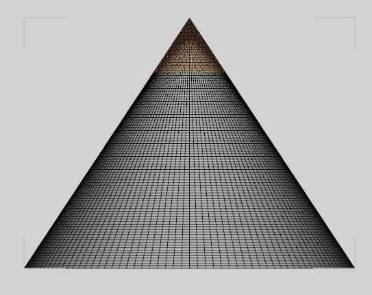

    b. Using the Geometry Editor tool and the Marquee selection method, select the top 20 rows or so of the cone. Right click in the viewport and choose Geometry Visibility/Hide Selected Polygon(s).
    c. Using the Geometry Editor tool and the Marquee selection method, select the bottom edge of the cone. Right click in the viewport and choose Geometry Visibility/Hide Selected Polygon(s). This hides the bottom surface.
    d. Right click in the viewport and choose Geometry Editing/Delete Hidden Polygon(s).
    e. Using the Geometry Editor tool and the Marquee selection method, select the top 3 rows of the truncated cone. Right click in the viewport and choose Geometry Assignment/Create Surface from Selected and label the surface Belt.

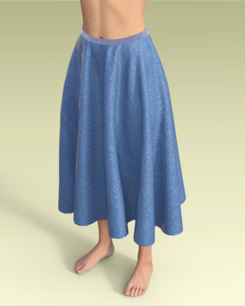

    f. Apply a dForce dynamic modifier to the cone.
    g. Select the Belt surface and set Contraction-Expansion Ratio to 62%.
    h. Load a figure (I used Genesis 3 female). Position the top opening of the cone around the figure’s waist. Adjust X- and Z-translate parameters so the cone is clear of all skin.
    i. Run the simulation and you get this result. The belt cinches in first.
    Then the simulation completes.
    j. If you want the skirt to be more hip hugging (down lower) set Contraction-Expansion Ratio to 75%.
    k. If you want a shorter skirt you might think all you have to do is adjust the Y-scale, but that does not change the slant length of the cone’s outside edge so you will get the same skirt length after simulation. Instead, use the geometry editor to choose some of the lower polygons and hide them (same process as step b).
    With the shorter skirt, it does not pull down as much on the belt. To get a hip hugging effect, you need to increase Contraction-Expansion Ratio to 85%.
    This is also another example that shows it can be hard to predict dForce behavior, as length of skirt (or perhaps it’s the number of polygons) influences what the surface property settings need to be.

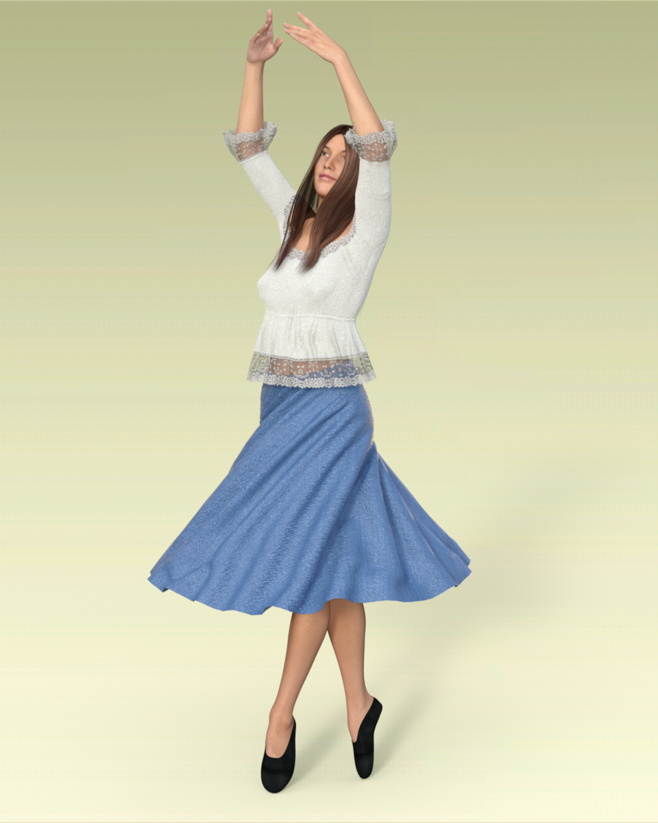

    l. I added a series of dance moves so the figure rotated along the Y axis. I had to reduce the density of the skirt surface to 70 to keep it from riding up too high. The result is a nice swirl and uplifting of the skirt. Gravity and air resistance are at default, so the movement  of the skirt is all from rotation. This render is frame 10 in the middle of the animation. If you let the rotation stop and have any relaxation time, the dress will settle back into a typical drape.

    Just to note I added an extra render at the end of the skirt section above to show it swirling under the influence of an animation with rotation.

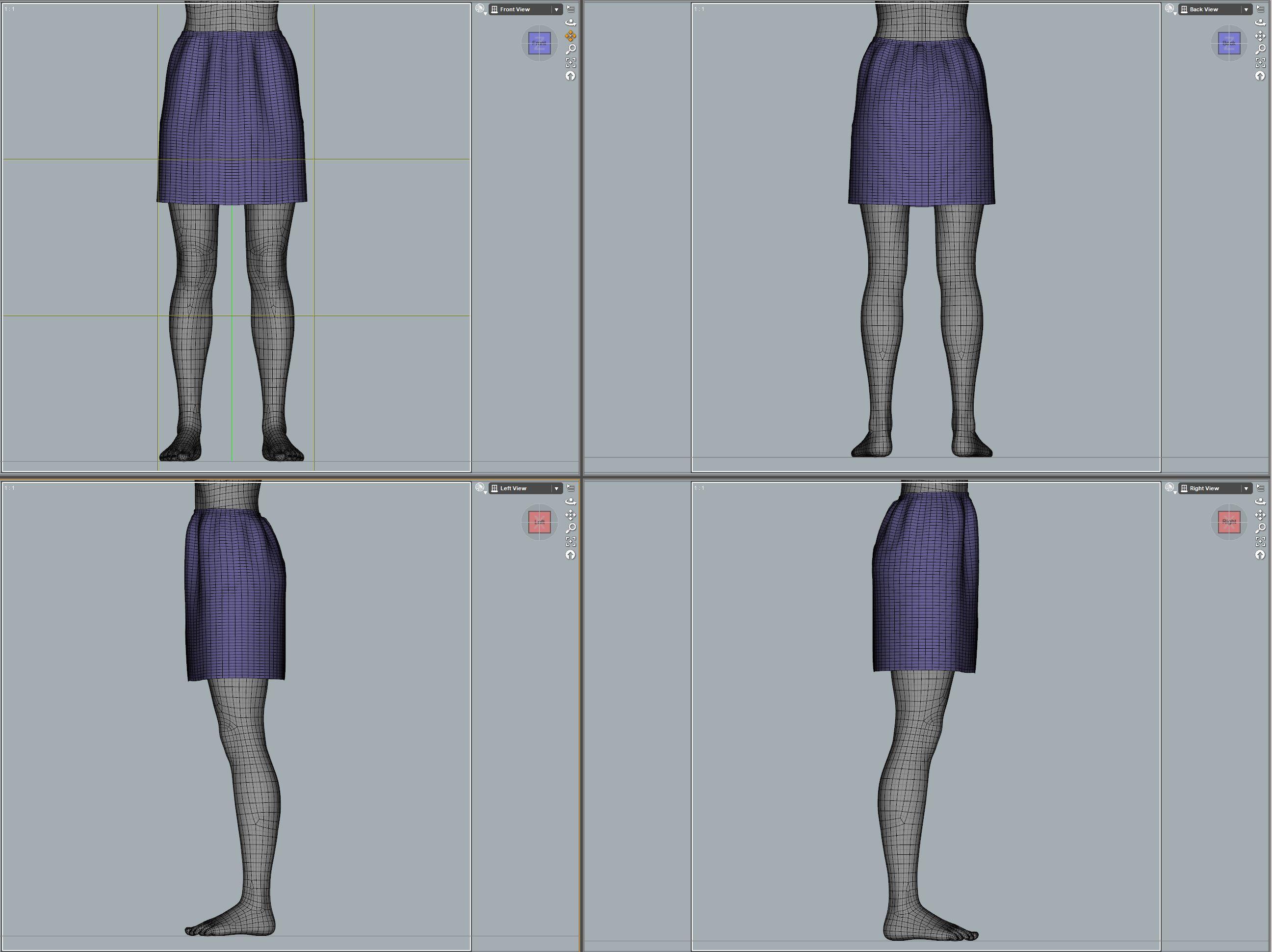

    Look! I followed your cone skirt guidance and made a cylindar skirt. I think it looks nice. Thanks for the inspiration.

  • barbultbarbult Posts: 27,508
    I exported my Cylindar Skirt as OBJ, rigged it with the transfer utility, applied dForce Modifier again and tweaked the settings, applied a simple texture, saved as figure/prop asset, and now I have a cute new skirt. Amazing!
    1600 x 2000 - 1M
  • RGcincyRGcincy Posts: 2,864
    That turned out really good! How do you rig it with the transfer utility?
    RGcincy said:
    Just the same way you would rig any modeled clothing. In the transfer utility, you select G3F (in this case) as the source and the skirt OBJ as the target. There are tutorials around, but I don't have a handy link to one right now. I bet SickleYield has made one. I'll see if I can find a link.

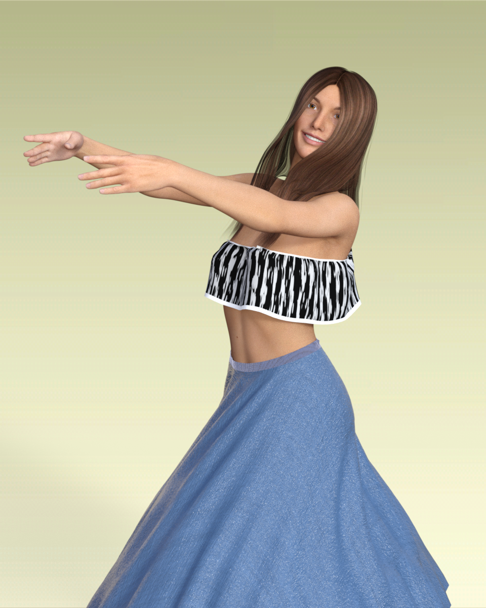

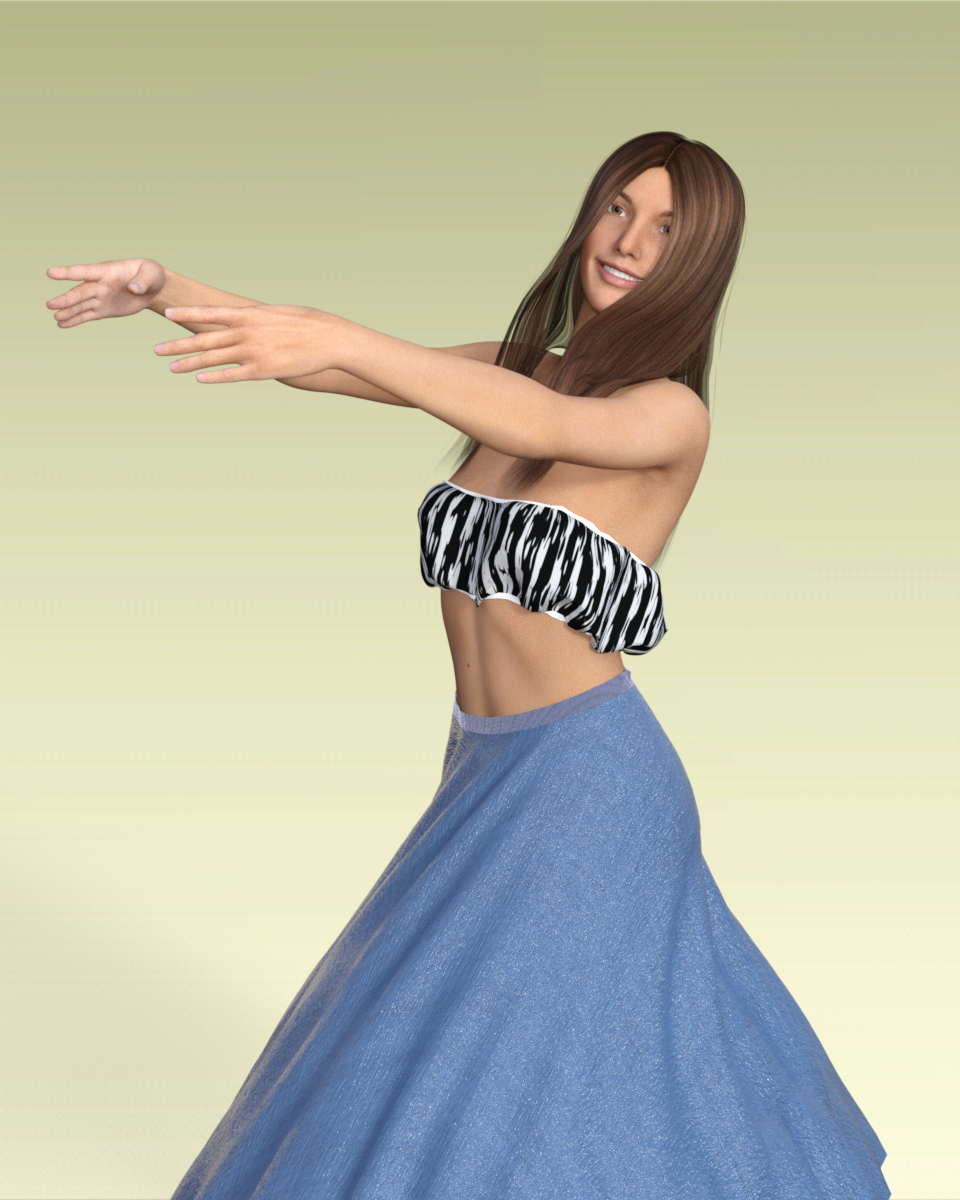

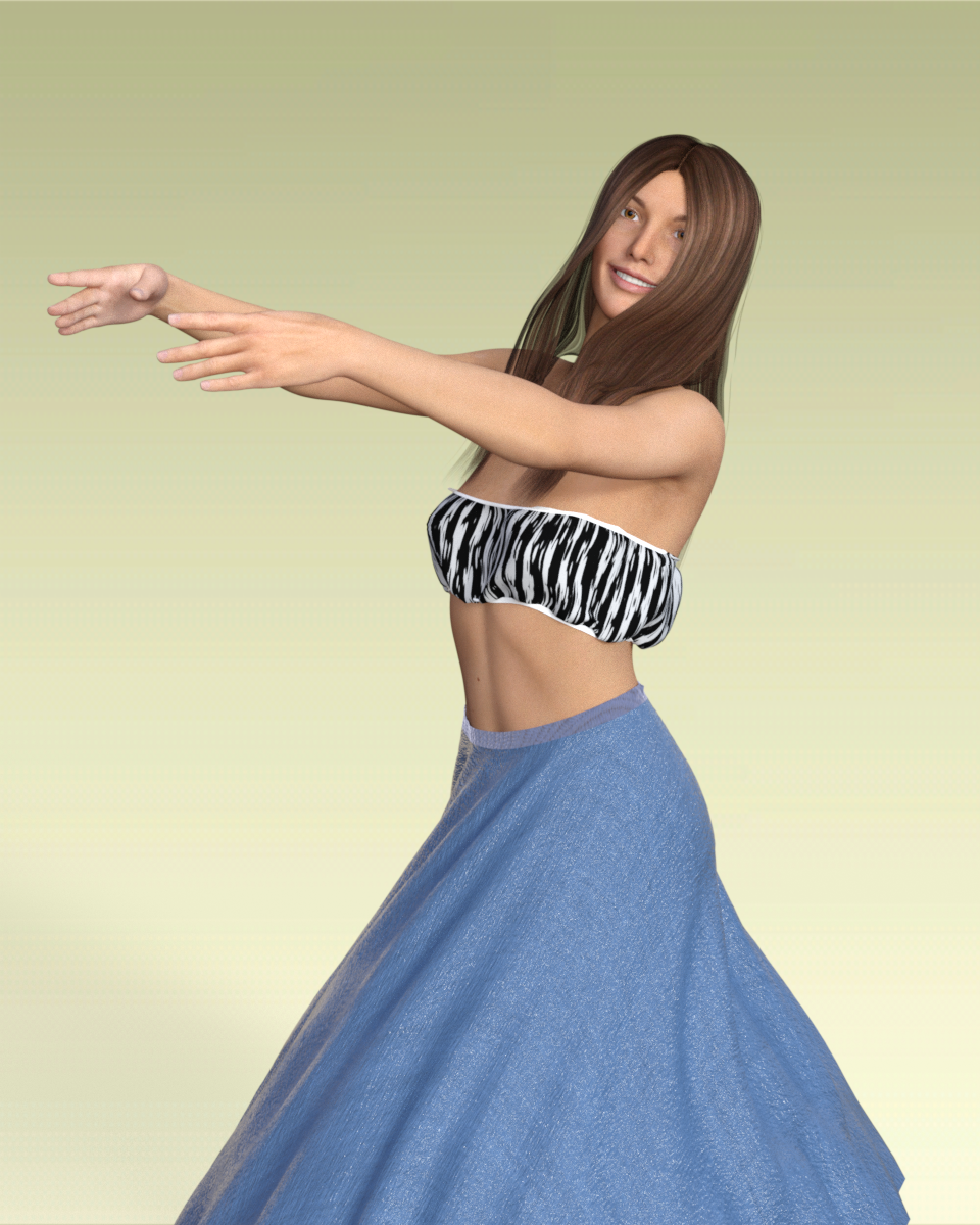

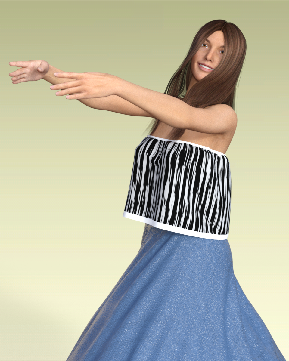

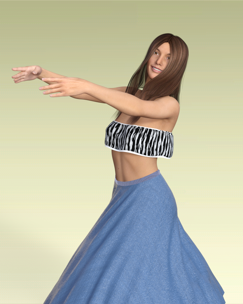

    39. Create a Bandeau from a Cylinder. Another simple clothing item that can be made from a primitive. This is based on combining what I did to make a skirt from a cone and what barbult did to make a skirt from a cylinder.
    a. Create a primitive cylinder of 3 feet diameter, 1 foot height with 50 segments and 64 sides. Position it around a figure and adjust the scale as needed.
    b. Similar to step 38 c, select the top and bottom surfaces of the cylinder, hide them, then delete them.
    c. Similar to step 38 e, create a new surface from the top few rows and call it Top Band. Do the same for the bottom few rows and call it Bottom Band.
    d. Add a dForce dynamic modifier to the cylinder.
    e. Change the Contraction-Expansion Ratio of the top band to 65%. Run the simulation. You will get a tight fit of the top elastic band and a very loose fit of the cloth and the lower band.
    f. Keeping the previous change, now change the Contraction-Expansion Ratio of the bottom band to 65%. Run the simulation. You will get a tight fit of the top and bottom elastic bands and a loose fit of the cloth. Note the droop in the back.
    g. Keeping the previous changes, now change the Contraction-Expansion Ratio of the default surface band to 90%. Run the simulation. You will get a tighter fit of the cloth. If you go much lower on the C-E Ratio, the cloth will start to distort.
    h. Set the Contraction-Expansion Ratio of the top band to 65%, the cloth to 90%, and the bottom band to 85%. Run the simulation. This will give you a tighter fit than “e” and a looser fit than “g”.
    i. You can also make it into a longer top by scaling on the Y axis.

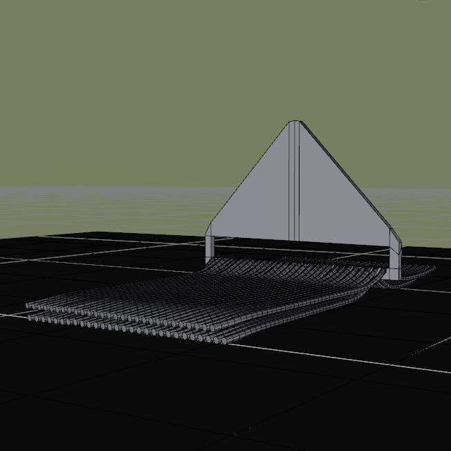

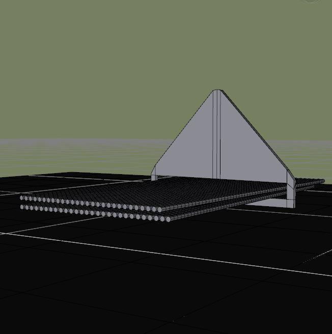

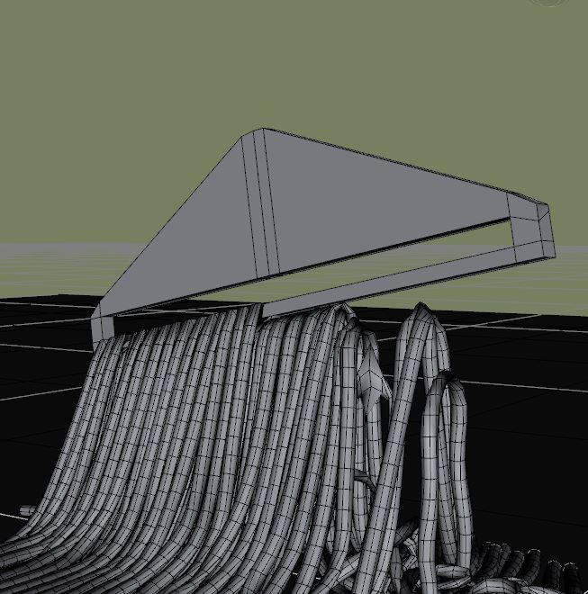

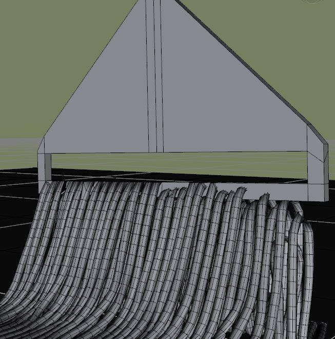

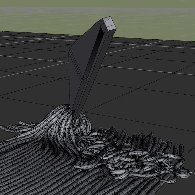

    Hi again. Back playing with DForce and trying to simulate a mop. It is in two parts with a clasp and the strings.
    The mop strings have a preset that is similar to a sweatshirt fabric from dForce Master - Cloth Simulation Presets.
    While simulating, as can be seen, the strings go right through the clasp as if it doesn't exist. I am trying to remedy
    this behavior. By the end of the simulation, the mop strings are all on the ground and have escaped the clasp completely!
    Clever idea! The bottom bracket of the mop may have too few polygons. Try to hide a primitie cube with 50 divisions within the bracket and see if that helps. Do not apply any dForce modifier to the cube.
