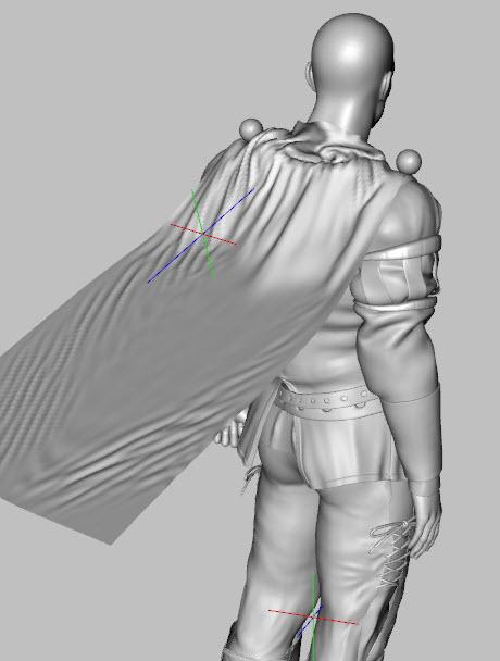

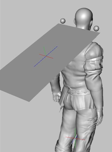

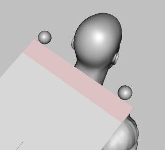

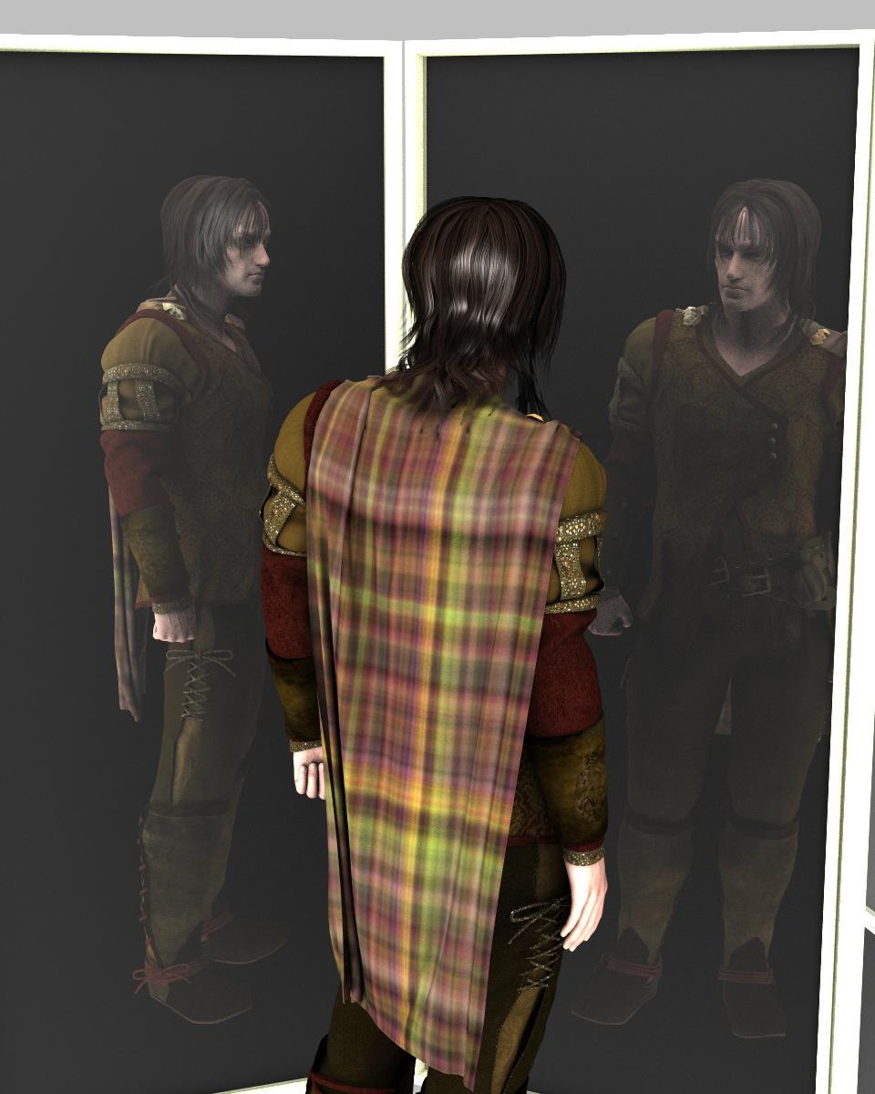

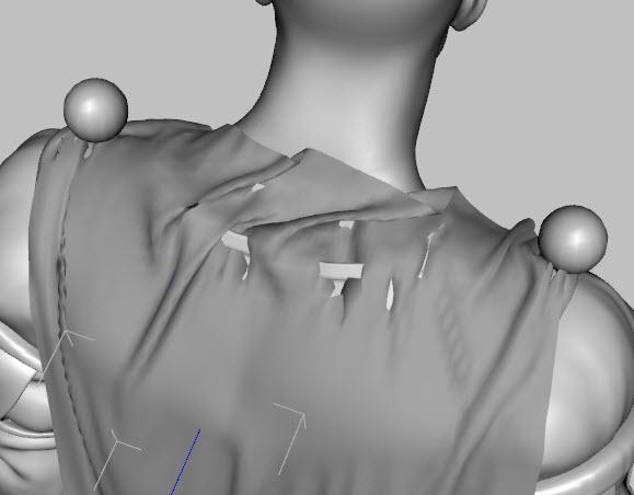

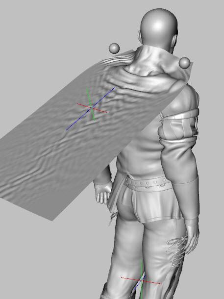

    36. Creating a Cape. I don’t know how to make clothes so there’s most likely a better approach than what I show here.
    a. Create a primitive plane of size 2 feet and 100 divisions. This will be the cape. Stretch it in the Z-direction and narrow it along the X. Add a dForce dynamic modifier to it.
    b. Create two primitive spheres of size 2 inches and 16 segments and sizes. These do not need a modifier as they will only be used to lock the cape to the shoulders. During renders, they will be hidden.

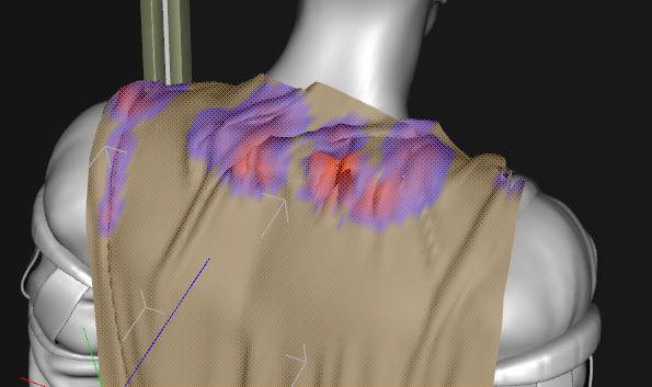

    c. We want to add a new surface to the cape so it can have a lower dForce Dynamic Strength to slow its movement. Select the plane, go to the Geometry Editor, and using the Marquee Selection Mode, select a small strip at the front edge of the cape. Give it the name Shoulders. See image below.
    Because we created the surface after adding the dForce modifier to the plane, you won’t see the Simulation settings in the Surface Pane hierarchy for the new surface. Just add the modifier again and it will appear.
    For the Shoulder surface, set Simulation Dynamics Strength to 0.9. For the Default surface, set Contraction-Expansion Ratio to 110%.

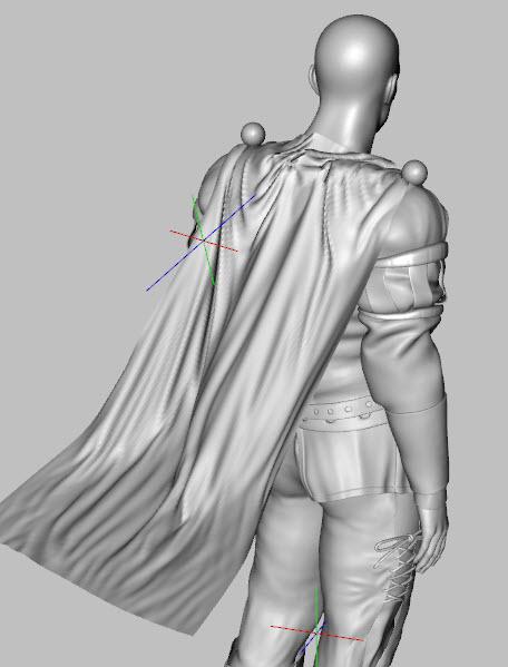

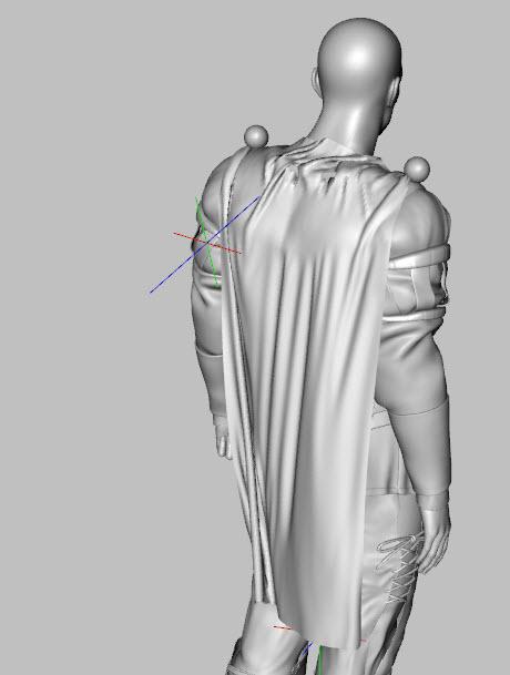

    d. Load a figure and wardrobe. I used Dmitri G3M and the Bard Outfit for G3M. Add a pose.
    e. Position the plane so it is square to the shoulders and above them a few inches, almost touching the neck. Adjust the rotations so it is parallel to the slope of the shoulders. Set the two spheres near the outer edges of the plane, above the plane, and above the midline of the shoulders. This is frame 0.
    f. On the animation timeline, at frame 3, move the figure back into the plane’s mesh. Before simulation, it will look like it penetrates the neck, but during the simulation, it will actually wrap around it.
    g. At frame 6, move the sphere’s down so they just touch the shoulders. By this time, during the simulation the plane will have settled down along the neck and the front edge will have slid back to the midpoint of the shoulders where they will be caught by the descending spheres and held in place. You may have to adjust which frame this occurs in as if the movement is too late, the cape will slide partially off the shoulders and down the back.
    h. Run the simulation. Afterwards, hide the spheres. With this wardrobe, there was some poke-through on the back of the plane. Add a Smoothing modifier and fill it with a weight of 0. Then with the brush, paint some weight in over the spots.
    Frame 12:                                                      Frame 30:
    Renders:
    i. I have the plane and spheres parented to the figure’s neck, but if you change poses, you will have to reset the position and rotations of the plane and spheres. A little clumsy but doable. Here’s a jumping pose render:

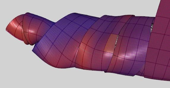

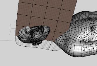

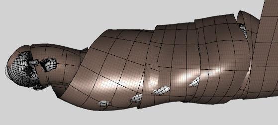

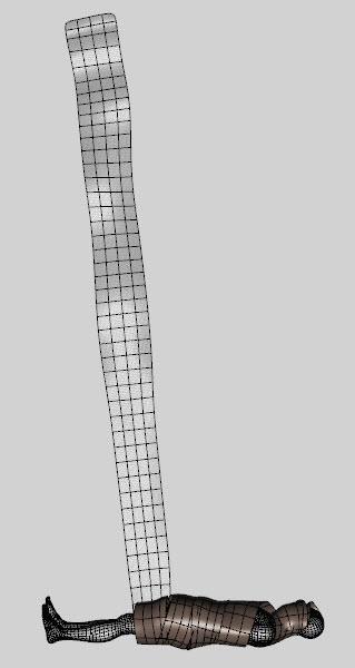

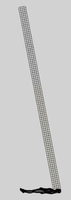

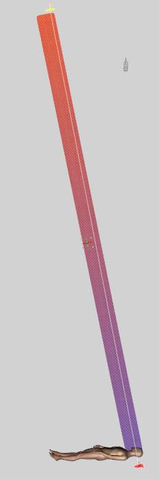

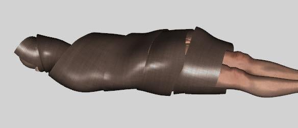

    37. Mummy Wrappings! I’ve posted a number of items made or modified using dForce. In addition to those, I’ve run a lot of experiments that have not worked out. This is one that mostly works, although it could be improved upon. It took dozens and dozens of simulations before I got what I thought was an acceptable outcome.
     a. Load a figure. I used G3M Abel. Add a laying pose and adjust the limbs as needed.
    b. Create a primitive plane of 10 yards, 100 divisions, with a Z-positive axis.
    c. Use the geometry editor to select all the polygons except for a vertical strip of 4 polygons. Hide the selected polygons then delete them.
    d. Select the four bottom polygons and assign them to a new surface called Tip.
    e. Move the plane so its Tip (the white part of the strip in image below) is embedded in the figure’s head.
    Tilt the plane so it angles towards the feet. By varying this angle, you will change how the plane wraps around the figure and how much overlap there is between layers.
    f. Add a dForce dynamic modifier to the plane.
    g. For the default surface, set Bend and Stretch Stiffness to 0.01. Set Buckling Ratio to 0.1%, Contraction-Expansion Ratio to 99%, and Dynamic Strength to 0.92. I found that a 0.95 and a 1.0 Dynamic Strength allowed the wrap to partially unwrap as the figure rotates; you may have to adjust this depending upon your setup.
    h. For the Tip surface, set Dynamic Strength to 0.9 and Contraction-Expansion Ratio to 87%.
    i. Set the Simulation Settings Gravity to 0.5 and Air Resistance to 0.1. Turn Start Pose from Memorized Pose to Off, use Animated Timeline for Duration, and increase Frames Per Second Multiplier to 3.
    j. I used a 30 second timeline, which ended up using about half the plane and wrapped half the figure. Double this to 60 seconds if you want to wrap the entire figure. I added a keyframe every 2 seconds, with the figure rotating 180 degrees in the same direction at each keyframe. That resulted in 7 full rotations.
    k. Run the simulation.
    l. You can see there’s a long unused strip of the plane (see image below). I used the geometry editor to select the unused polygons and assigned them to a new surface and set opacity to 0 to hide it..
    m. To smooth out the wrapped mesh, I added sub-D and set it to 3.
    n. I found the wrap did not fully respect the figure’s surface nor the underlying wrapped plane and so there was poke-through both of the figure and underlying fabric (see image below).
    o. To correct this, I added a Push Modifier and use the spherical gradient tool to add an inverse gradient to the plane - more blue at the lowest part of the plane and red at the top. This means later wrappings have more push and that will help them sit higher than lower wrappings (see image at right). I found I had to set the displacement level to 8.5 to hide the tip of the nose.
    p. I used the geometry tool on the Node Weight Map Brush tool to choose polygons on the wrapping that were out of place - either above or below the previous wrappings. I then used the painting brush on the tool to move those out or in to hide poke through. Be sure to check the box “Respect Selection” so you paint only the polygons you choose.
    q. Here’s a finished render:
