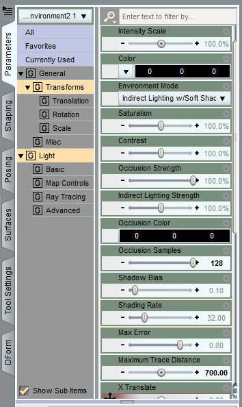

    You can set up your UE like this:
    The intensities on top that didn't fit in the screenshot are the default. The important bits are:
    • The mode is IDL with soft shadows. I'm not using an HDR map to light the scene, so using "IDL with directional shadows" makes no sense.
    • IDL colour = black because I am not using a map here to light the scene, it's enclosed in a sphere that has ambient active (with GI, ambient-based materials will emit light).
    • Occlusion samples: it's a quality control. Technically we shouldn't be raytracing anything, but this value may be used for interpolation. Hard to say without source code. Either way, this is what to increase if you get blotches.
    • Maximum trace distance: set to the distance you want one object to bounce light on other objects. My scene is inside a 10 m diameter sphere, so I used 700 cm = 7 meters to make sure the walls bounce onto the center and a bit beyond.
