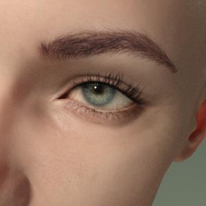

    Still very stuck ... right now I'm just annoyed with the Sclera settings.  I've tried them all from all the notes I've taken.  I thought it was the lighting but when I just turned it all all off and used just a Eye Accent light and the HDR to light the scene and her eyes, same issue.  Just this very flat look to the Sclera with a strong shadowy look around the outer edges.  This setting is just using the Water setting with the maps put back in and the Refraction Weight turned off.  Not going to pull my hair out over this but I'm just very technical and I really need some advice as to what to try.  All the notes I got from Cath's thread looked very good but nada with the results.  Here they are:
    Rendered using MEC4D's lighting rig
    I've been working on eye settings and i think I've hit on some that look nice. Here they are for whoever is interested:
    Eye Reflection: default Glass-Thin-Clear shader
    Cornea: Glass - Solid - Clear - Dispersive (rainbow) shader, cut-out opacity set to .25
    Sclera:
    Base color - White + Diffuse Map
    Translucency weight: 0.25
    Base color effect - scatter and transmit
    Translucency Color: 212-61-215 + Diffuse Map
    SSS Reflectance Tint - white
    BaseBump : 0.35 + Diffuse Map
    Thin Walled: off
    Transmitted measurement distance: 2.5
    Transmitted Color: 204-24-255
    scattered measurement distance: 0.1
    SSS Amount: 1.0
    SSS Direction: -0.5
    Iris & Pupil
    Diffuse Roughness: .5
    Glossy Layer weight: 0.5
    Share glossy inputs - off
    Glossy Color: White + Diffuse Map
    Glossy color effect: scatter only
    BaseBump : 1.0 + Diffuse Map
    Top Coat Weight: 0.5
    Top Coat Color: White + Diffuse Map
    Top Coat Color Effect: Scatter and Transmit
    Thin Walled: off
    scattered measurement distance: 1.0
    SSS Amount: 1.0
    SSS Direction: -.5
    Another bit of Eye Info:
    Several people have asked about working with eyes and I've seen various advice so I'd thought I do a quick example and see how it turns out.
    To try this out I decide to go find a reference eye to check against. A simple image search yielded several. I decided to compare against this photo of an eye. I knew I wouldn't be able to match it exactly but I wanted to see real reflections on a real eye. I also referred to these diagrams to make sure I had the right anatomical concepts.
    The attached image is what I came up with. I did not do anything with skin, lashes, lacrimals, etc, they are just the standard conversion. I was focused on the direct eye materials only. I used the Genesis 2 Female with it default loads and converts except as noted below.
    Here was my approach:
    Tear/Eye Surface: Apply "Glass - Thin.duf" and change the index of refraction to 1.336 to match tears.
    Sclera: Changed the base color texture from the default to number 5 from Awesome Eyes cause I liked the way they looked. I then turned the base color down to .74,.74,.74 because the texture was a bit too bright. I then reverted all other settings to their defaults except Glossy Roughness which I set at 0.25. This was the roughness I arrived at through empirical observation so it may depend on eye set up. I increased the bump to 1.0.
    Irises: Setup just like the Scelera except the base color was standard white (1.0,1.0,1.0) and glossy roughness was set to 0.5.
    Pupils: Pupils where setup like Sclera/Irises except the glossy layer was shut off by setting "Glossy Layered Weight" to 0. I did this because the Genesis 2 pupils are not physically modeled. So I need them to act like a hole even though it is not. The map sets them black for me, but I don't want them to reflect so I removed the glossy reflection as noted above.
    Cornea: The Cornea turned out to be the most complicated to set up as it ends up doing multiple jobs at once. I first applied "Glass - Thin.duf" and changed the index of refraction to 1.3360 to simulate the "aqueous humour". I then turned the "Top Coat Weight" to 1.0 and turned the "Top Coat Layering Mode" to Frensel with a "Top Coar IOR" set to 1.376 to model the surface of the cornea. This was giving me good results but I found the line between Irises and Sclera too pronounced. This turns out to be an old issue with the Genesis 2 models and luckily many of the major DAZ Characters come with maps to address it. This map is found in "[Content Directory]/Runtime/Textures/DAZ/Characters/Genesis2/Victoria6V6AnnaEyeTr.jpg" for Victoria6. For 3Delight these maps go in the opacity channel but working from a tip I received at the DAZ office I instead put it in the "Refraction Weight" channel, then opened the "Image Editor..." and set "Invert" to On. If you don't want to use the "Image Editor.." method you can also invert the map in your favorite image editing program. I also added this map to the "Top Coat Weight" and again used the "Image Editor..." option to invert it. To finish the blend I then added the same "Base Color" map that I used on the other surfaces to the cornea. Finally I changed the "Glossy Reflectivity" to 0.4.
    To finish the image I added the an hdri from HDRI Archives called "Old Industrial Hall" because it had dominate windows in it. Then adjusted tone mapping to match the hdri.
    When none of this worked out for me on the Sclera (the Iris and pupil and Cornea look OK for my needs so that's OK I guess)  I tried the iRAY Water shader and just put back the maps in and as mentioned turned the Refraction Weight back to zero.
    HELP?

    @RAMWolff, does your sclera UV match the Bree texture you are using?
  • RAMWolffRAMWolff Posts: 10,404
    Bree?  This is Dawn from Hivewire.  This is my skin that I'm working on for her, hence the endless questions about finding a way to get nice effects.  I got the nails figured out, the skin looks good and the inner mouth.  The teeth are almost there but the eyes... those darned eyes!  lol
    The list in your post says V5BreeEyesM and V5BreeEyesB textures on the sclera. Did I misunderstand?
    I just switched those out for my own maps.... sorry forgot about those side notes there.

    So been having more issues with this set up.  The Glass - Thin - Clear shader works pretty well but the eyes look like they are under a dark glass.  I've double checked all my settings to see if I had any of the diffuse channels set to anything other than pure white, and that's a no.  Only thing set darker is the Cornea but it's really not dark.  I was trying to take Andy's advice and keep the settings for the Cornea and the Sclera the same (except for the maps on the Sclera)
    I've also noticed a very much unwanted effect on the Sclera ... I'm getting a very grainy firefly effect that doesn't clear up after the render is done.  I remember running into this a long long ways back and can't remember the fix for that.
    My lights in the scene are supplied by one distant light and one point light for extra flashes of light on the eyes and then the HDR supplies the over all rest of the lighting in the scene.  The fireflies were much worse before adding in the Distant light and the Point light.
    Thanks for the help!  :-)

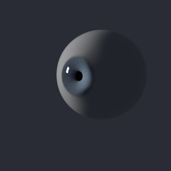

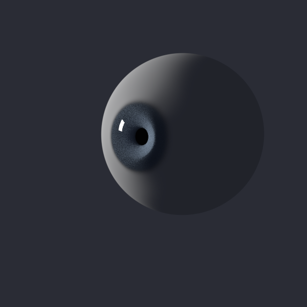

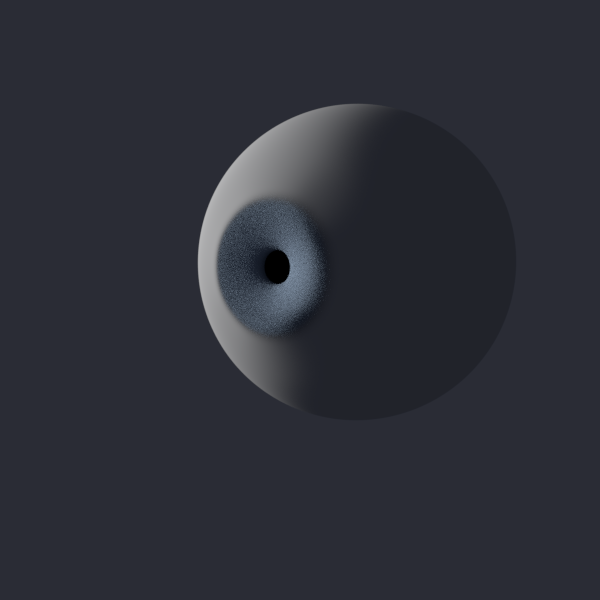

    Plenty of eye experts here. I'm messing around with eyes currently and getting some odd shadows on the iris when lit at an angle. Front looks alright?
    1980 x 1024 - 791K
    1980 x 1024 - 343K
    1980 x 1024 - 647K

    Did you read my entry on the previous page (Jan 24th) related to the refraction problems of iray renders?
    btw: Your eye is a really good prop with nice texture maps. Where is it from?
    Post edited by AndyS on
  • bluejauntebluejaunte Posts: 2,294
    edited February 2017
    Ah yeah rings a bell. So it is simply a bug and unavoidable? The eyes use Eva 7 textures and my custom shader settings, also 100% cornea buldge, 50% Iris Realism Buldge and 10% Iris Realism Depth (j.cade freebies).
    AndyS said:
    Hi Cade,
    very interesting informations.
    And I hope, "same unit" only for the glossy aspect.  wink
    Although I'm not sure that my sclera is glossy reflecting like the cornea.
    But btw, what texture did you use? The G1 texture is way too coarse. It creates the typical artefact crossed patterns and don't show these sharp details of your picture.
    That "Thin Walled = off" looks darker is the fault of the still unsolved refraction bug of iRay. If the light enters the refractive surface below a specific angle, it is not present below that surface anymore.
    See 2. picture, where I only used one spotlight from ca. 45° incident angle.
    Post edited by bluejaunte on
    So what would be the correct behavior,  no shadows on the iris at all?
  • AndySAndyS Posts: 1,449
    If possible, have the light entering the eye in a steep angle.
    Or better: Set "Thin Walled = ON". So the refraction isn't working. OK - it is a little loss of "real" eye, but better anyhow...

    first @ramwolff don't use any translucency on the iris, that will darken it right up.
    I now have some documented evidence that the refraction "bug" is indeed probably not a refraction bug. If you render in blender's cycles you get a similar shadowing effect. Testing in blender is particularly helpful since  it is much easier to break a material into separate parts (i even looked in studio's shader mixer, but could find no way to separate refraction from reflection)
    image 1 The genesis eye in blender's cycles with a simple material mixing a diffuse node and glass node via an image texture to get the smooth transition. You will notice that it has a similar error to the problem we see in Iray
    image 2 rather than mixing diffuse and glass node I mix diffuse and just refraction. There is no reflection component, but the weird shadow is gone, the problem isn't the refraction, but how the glossy is added
    image 3 the goal, the glossy has returned but without creating the weird shadows. This is simple in blender, you can simply make the glossy not cast shadows this cannot be done in studio currently and is unlikely added let alone easily done any time soon
    So what can you so in studio? Well, if at all possible change your lighting, provided you are using hdrs and/or photometric lights with relatively large geometries, you should never notice weird shadowing. If you absolutely love your lighting other wise but are getting the ugly shadowing on you eyes, rather than switching to thinwalled off, I would suggest setting your glossy roughness to something like .04 it won't look quite as nice as a roughness of 0 (and will take even longer to render), but it still looks imo much better than thinwalled off, which continues to look miserable soulless and dead.
    600 x 600 - 66K
    600 x 600 - 67K
    600 x 600 - 71K
    Post edited by j cade on

    Aaand a comparison of: Thinwalled on (0 roughness),  Thinwalled on (.04 roughness), Thinwalled off. and all of these a quick renders that needed to cook more because I dont like spending 10 minutes on a tiny test render
    The best option IMO. Has depth, looks the most real, I spent a lot of time staring at my own eyes in a mirror while piffling with settings and this is the closest its the only one that gets the nifty inter cornea caustic effect (bottom right of the eye) that I can personally state my own eye definitely gets as well.
    Takes forever to render and is flatter looking than with 0 roughness. But will get rid of weird shadowing without resorting to thinwalled on. Also a bit more even than 0 roughness if that's what your after. Probably the closest to the actual iris texture in terms of overall value.
    Thinwalled off
    The worst. Flat, soulless, blown out color, and messes up the sss in the sclera. Its the fastest to render though
    also for all that talk of thinwalled off making the iris unnaturally dark, in these examples the thinwalled off versions are much truer to the texture maps of the iris. Believe it or not this is pretty neutral lighting (If I sample the skin from the image where it isn't in shadow its pretty and sample the texture in the same location the colors are nigh identical, likewise if I sample the eyes from my image and compare them to the texture I'm using they are also pretty close, significantly closer than the completely blown out thinwalled on version at any rate.)
