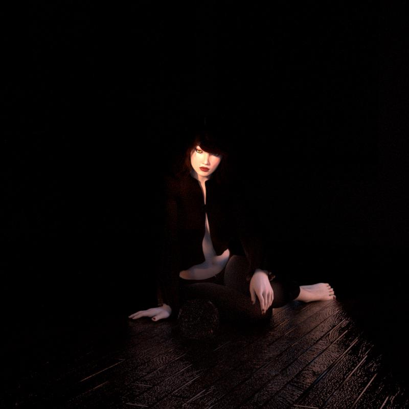

    Let's revisit that PointLight layer.  Make a duplicate in case things go wrong, and set it to not be visible.  Use the visible layer, and apply a Gaussian Blur of about 1.5 pixels to it.

    Now for some more advanced stuff.  Light Path Expressions.
    Basically, you get to specify exactly which light paths get rendered....the grammar is kind of odd, but basically is defined by three things:
    The Camera (or Eye)  ("E"), a set of things that the light bounces off of, and one or more light sources ("L").
    The standard Beauty canvas is described as E .* L.    where the . symbol denotes any object, and the * denotes 0 or more of them.
    L 'Chair' E would match all light paths that hit the object named 'Chair' and then the camera.
    L 'Chair' .* E matchs all light that goes from a light, hits the chair, may or may not hit something else and then hits the camera.  This would capture not only the chair, but any reflections of the chair off the floor or other surface.
    L .* 'Chair' .* E would capture all light rays that hit the chair, whether or not they hit something else before (indirect lighting) and whether or not they hit anything else after the chair (reflections, etc)
    So, in my example, I set up a light path expression (L 'Destiny' .* E) for all direct light that hit the Genesis 2 figure as well as any object afterwards.  Just the figure, not the clothes or the hair.
    If I bring that layer in using Linear Dodge (Add), it brightens the figure and its corresponding reflection providing additional contrast.
    That said, there's also some significant weirdness to the UI around LPEs.  If you try typing the expression into the window, the cursor never advances.  New characters that you type show up at the beginning of the line, not the end.  Either learn to type backwards, or type the expression in Notepad and use cut and paste to put it into the LPE window (for some reason that works).  Be prepared for a lot of trial and error around this.

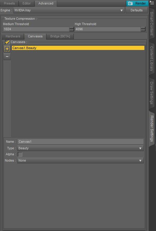

    Where do I find the tab to set up the canvasses?  I thought it was under the iray render advanced tab, but its not there and I can't find it anywhere.
  • IceDragonArtIceDragonArt Posts: 12,548
    Never mind it is there but you have to click on the blank place where its supposed to be.  No wonder no one knows about canvasses. Its completely hidden unless you know where to look.
  • TabascoJackTabascoJack Posts: 865
    edited January 2017
    On my screen, there are three tabs in the Advanced pane:  Hardware, Canvases, and Bridge [BETA].  If you click on the Canvases tab, and then click on the Canvases checkbox, you'll be able to add them.

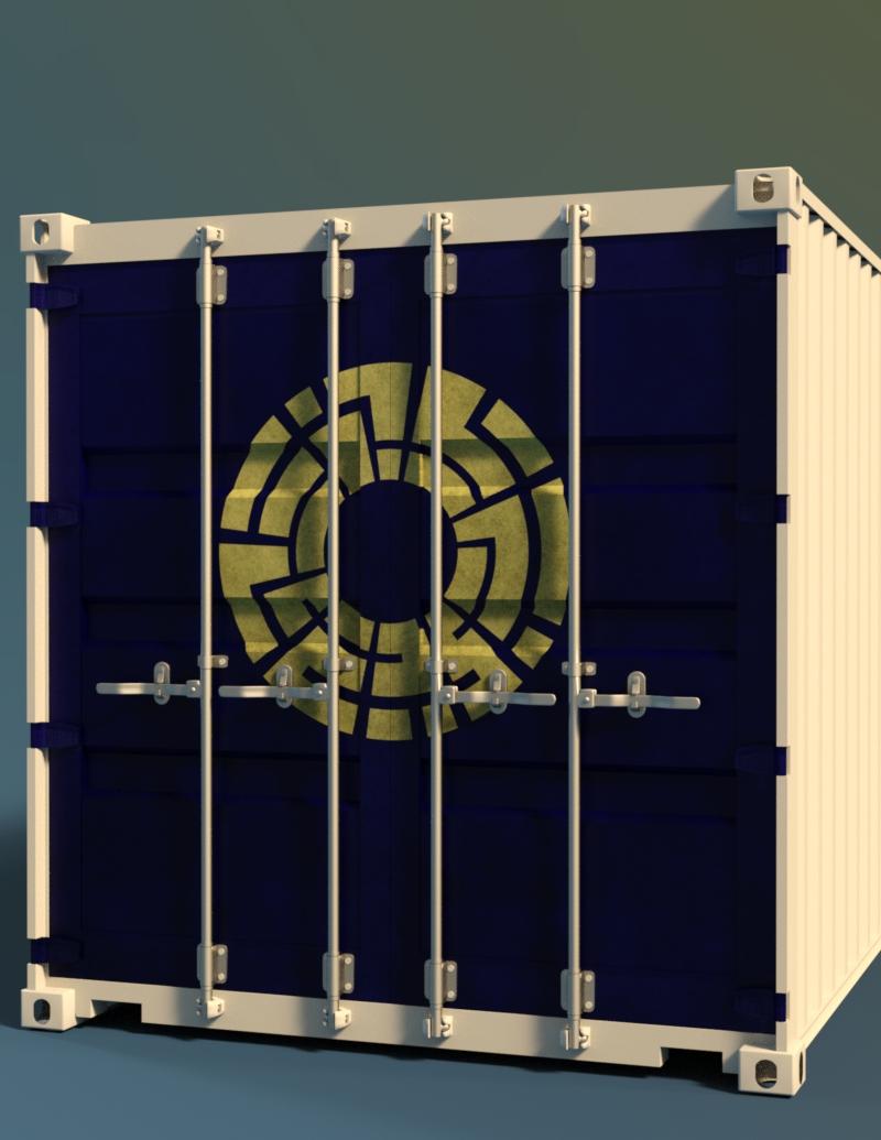

    Today's experiment is with UV Mapping and Texturing...
    UV Mapping, I'm finding, is most certainly an art.
    I also picked up Dreamlight's Texture Master tutorials a while back when it was on sale.  Got some good ideas out of that on how to effectively use layers in photoshop for various maps.

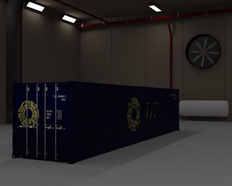

    Well, I think I'm done with the shipping container....at least this version of it.  I think it's time to take what I've learned from it and try to apply it to the next thing.
    Here it is in a work in progress hangar / warehouse / industrial interior I've been working on (which is badly in need of texturing).
    And it again in a neutral setting:
    What this exercise has shown me is a) the difference in scope between just building a geometry and creating a full-blown model, b) I need to practice my UV mapping and texturing skills, and c) I need to figure out a modeling workflow that fits my style.

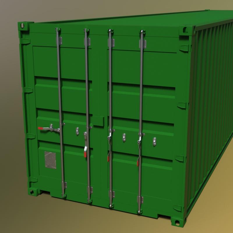

    Shipping Container 2.0 (Beta)
    Modeled, mapped and rigged.  Still need to do textures.
    Locking handles and shafts rotate, doors open.
