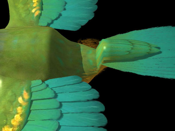

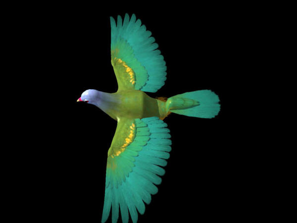

    I have a problem with the Australian Songbird collection which I would love to be solved
    http://www.daz3d.com/shop/songbird-remix-australia-complete
    When I inject the poses into the base model for most birds (all?) I end up with a terrible concave in the birds lower back.
    See pictures.
    The birds work perfectly in Poser so it is only a Carrara thing.

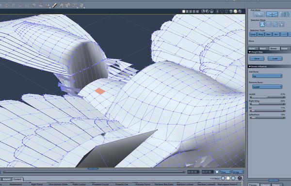

    When I take it into the vertex room adding or subtracting bone influences makes no difference.
    Zeroing the figure removes the concave but also removes the injection pose of course
    Any help greatly appreciated!!

    YES, I get this on the rosella, the night parrot, the king parrot, cockatiel, diamond dove, fairy wren to name a few
    never noticed as I used the birds that were ok!
    it is ok in C6pro!! just tried it
    have C6 installed as the hair sometimes better.
    and yes pz3 files do it in 8 too, I prob last used the other birds in C7pro which is only on my laptop, so Carrara 8 broke it by looks
    the C6 .car file opened in 8 ok, so prob MY workaround, the other morphs work ok on it too!
    no help to anyone else though!!!

    Hey Wendy, thanks so much for your help.
    I found a FAQ page on Ken's site. He tells you to export from daz studio via collada and not load it up the poser way :( GAH
    But the work around is buried at the bottom of the page
    http://www.empken.com/wiki/index.php5?title=FAQ:_Frequently_Asked_Questions#Weird_Hip_bumps_and_messed_up_feet
    for some reason the z scale of the thighs (ken calls it y) comes in at 75 percent instead of100 percent like the x and y.
    So setting both thigh z scales to 100 percent appears to fix it
    yaaaaaaaaaaaaaaah y :)

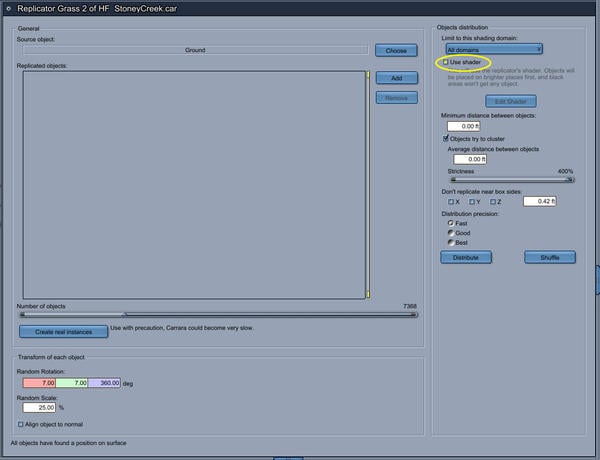

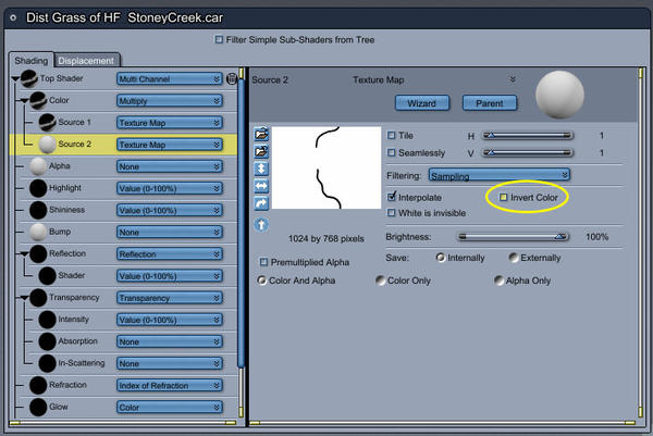

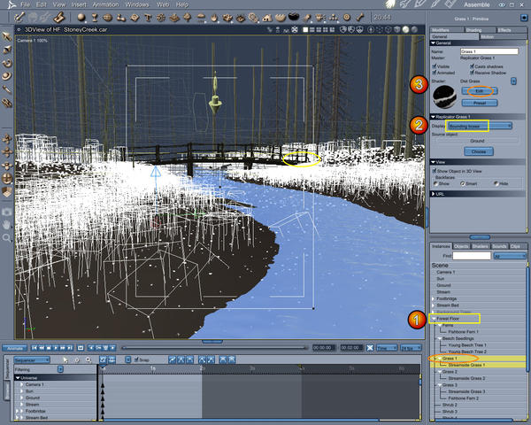

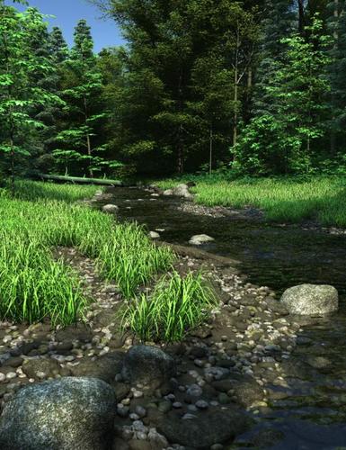

    I've got a problem with Stoney Creek by HowieFarkes, which works fine under my Carrara 7 Pro, but doesn't render any grass in Carrara 8.5 (please have a look on attached pictures). Does anyone know how to fix that?
    600 x 780 - 114K
    600 x 780 - 120K
  • 3DAGE3DAGE Posts: 3,321
    Hi Adon :)
    it looks like there's possibly an issue with the distribution maps,..
    Carrara's default mapping type for images is now different,. but that shouldn't effect how the distribution maps are working.
    but off the top of my head, that's the only thing I can imagine that could change how the maps are working.
    I'll try to take a look at it tonight, and see if I get the same results.
  • edited December 1969
    Thanks in advance, 3DAGE, I'm the Carrara beginner so all the help will be appreciated (I'll probably have a couple of more questions later ;)).
    To the above question I have to add that renders have been done in both Carrara's with the same basic settings.
    HI :)
    This was a puzzle to figure out, and I still don't know why it's happening.. but I know how to fix it.
    The problem is somewhere between the distribution maps, and the surface replicators.
    To get the grass to show up as intended,.. (See pics)
    You need to select, and expand the (forest floor) group,.
    then select the (Grass 1) replicator.
    In the "Display" section, change it to show the "Bounding box" view,.. so that you can see what's happening.
    Then, in the top section,. you need to "Edit" the distribution shader settings.
    In the shader editor,. select the second texture map in the Diffuse channel, and switch off (invert)
    next, you need to edit the surface replicator,.
    In the top right section of the replicator panel, there's an option to "Use Shader" ..Switch this Off,.. then, wait a second or two,. and switch it back on again.
    Follow the same process for the other grass replicator (Grass 2)
    you should be good to go.
    After you render to make sure it's working, you can save that file back into the folder, as a new scene file.
    1001 x 767 - 91K
    716 x 478 - 86K
    1280 x 1024 - 422K
