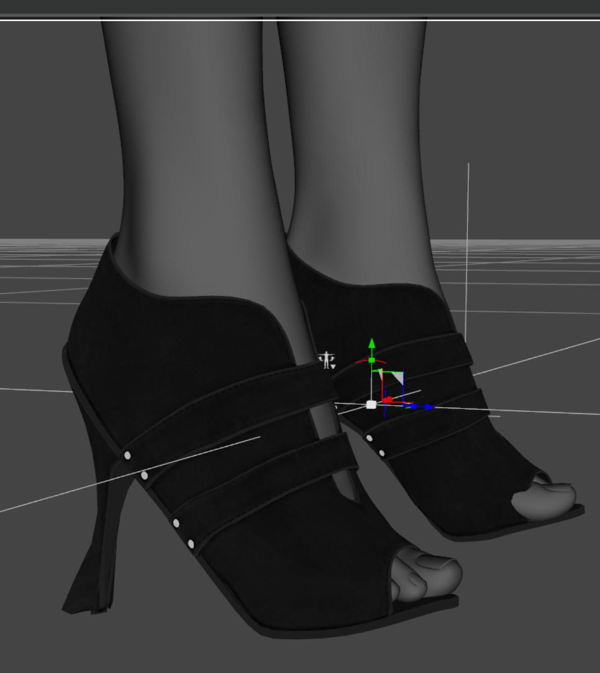

    I have recently started to use this converter to convert some of my favourite G8 Male outfits to fit G9
    As you can see from the below image of the High necked sweatshirt the cuffs partially cover the hands. The only way I can get round this problem is to hide the cuffs. Is there another solution that you know of?
    569 x 922 - 457K
    Post edited by sueya on
  • RiverSoft ArtRiverSoft Art Posts: 6,975
    What conformer did you pick for this item? Perhaps the loose body conformer will give better results.
