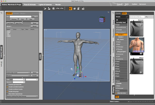

  • drinkingbuddydrinkingbuddy Posts: 350
    Hmmm, I've been reading the most recent posts in this thread and I'm realizing many folks are using Gen X differently than me.
    I'll go through how I use it. It might not be the best way, but it seems to work. Hopefully this might help cridgit and vienastoks with their issues.
    1) Make sure you have M4/V4 Shapes for Genesis in addition to Gen X (or S4, A3, V3 - whatever is relevant to your character).
    2) Start DAZ Studio.
    3) Go to Window -> Tabs -> Gen X. Click on the top bar and attach it to the opposite side of your Content Library (for me, the CL is on the right side, so I'll attach Gen X to the left).
    4) We'll do a Michael 4 character. In the Content Manager, go to your Gen 4 stuff (e.g., your Poser library).
    a) Go to Figures -> DAZ People and drag Michael 4 to the center of the Gen X window.
    b) Go to Pose -> DAZ's Michael 4 -> Morph Injections and drag INJ Morphs++ M4 to the Gen X window.
    c) Repeat step (b) for Elite, Ethnic, or whatever if they're needed.
    d) Go to your desired character (in my case, I'll use Donovan for M4). Drag the body, then head morphs to the Gen X window (or just the body if you prefer).
    5) With the Gen X window staged, below the center panel, select "Create a single morph" then "Transfer On: for all non-zero values"
    6) Right below that, Michael 4 should be already selected. Click on Transfer. I'll just use "Donovan" for both the Identifier and Name.
    7) Load a Genesis figure into the scene.
    8) In the Shaping tab, for Actor -> Male, crank up Michael 4 to 1.0
    9) In the Shaping tab, for Actor -> Gen X, crank up Donovan to 1.0
    10) In the Shaping tab, for Torso, crank up Navel to 1.0
    For V4 characters, it's pretty much the same thing. Hope this helps.
    800 x 544 - 144K
  • vienastoksvienastoks Posts: 0
    Thank you, Spiderland, for nice and concise description. It works for some characters for me - mainly those, that use ++ morphs to shape the features of the face or body. But it doesn't work for custom morphs - they just don't register on Gen X tab at all - even with zero values. They do not appear when I switch on to show hidden/all morphs. My guess is that Gen X fails to parse the PZ2 file. In my case the "inj head" file calls for several other PZ2s. I'll try to drag those files directly into Gen X tab, but I'm worrying that the main one passes some parameter to them maybe... Well, only way to learn. :)
