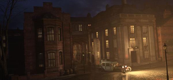

  • CrescentCrescent Posts: 335
    The Monitor shader works nicely to have a set's sky dome illuminate the scene. I used it on the sky dome in Stonemason's The Streets of Old London, turning down the Luminance by a factor of 10 (from 900 to 90) and got great results with no other lights in the scene.
