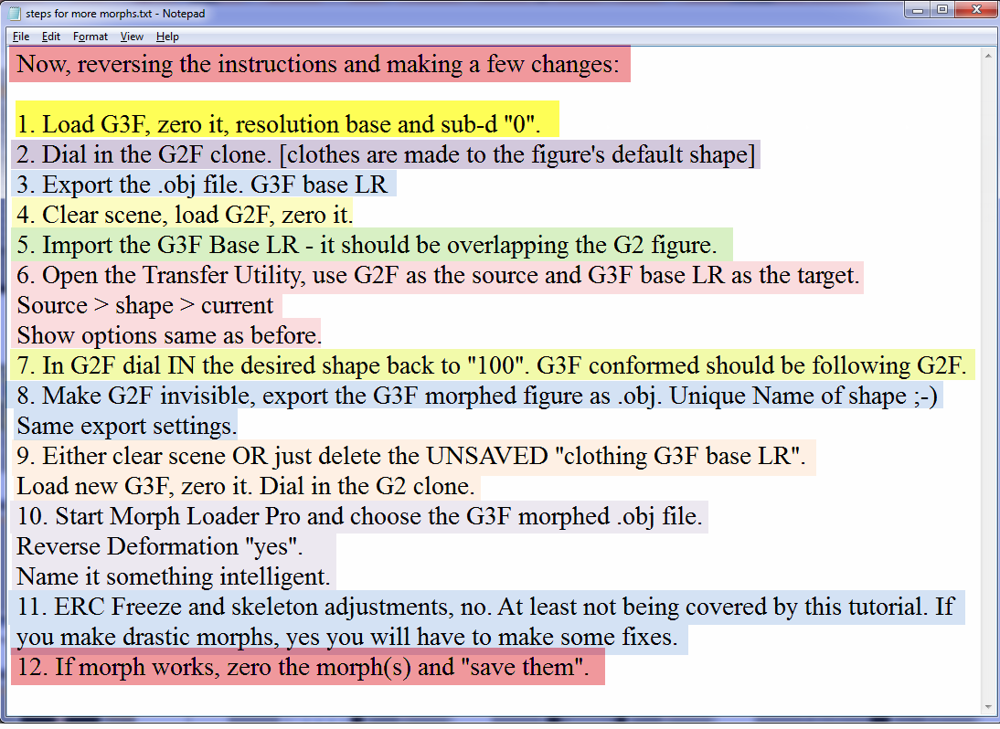

Post 629: Resummed version of morph transfer tutorial for G2F->G3F transfer

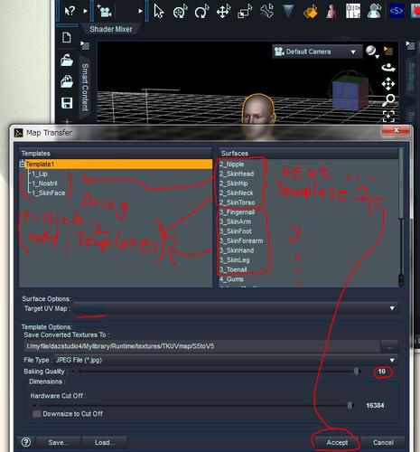

Steps to Get projection templates to work for your Custom Genesis 2 Figure by larsmidnatt

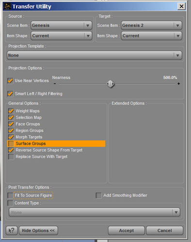

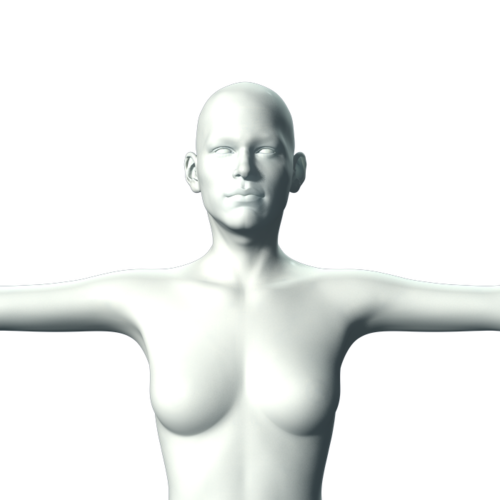

For this I need Genesis 2Female Essential (free), DS 4.5 (free and probably the process will work in DS 4.6 too), My Genesis (i.e. Genesis 1, with those many morphs I have). I use a temporary intermediate figure to transfer morphs so I won't screw anything up in figures.
1. Load G2F, set it to Base Resolution and 0 Subdivision. Export as Obj (only Ignore Invisible Nodes are checked, everything else is unchecked). I used Hexagon scale (1 unit = 1 cm), on 100% scale. Scale of import and export should be consistent from now on, but I suspect it can be any scale.
I exported it as G2F Base LR.obj
2. Load My Genesis into DS 4.5. Dial Basic Female Morph 100% and several adjustment morphs to get the shape as close to G2F as you can (I used only Arms Length around -0.0026, Hands Propagation Scale L/R around -20% but it can be done better with hips and breast morphs). I did nothing with pose, leaving hands curled as they are.
My Genesis is then set to Base Resolution and 0 Subdivision.
Delete G2F figure.
3. Load G2F Base LR.obj with a proper scale.

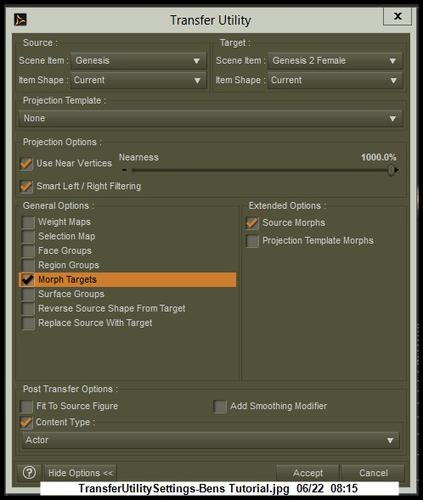

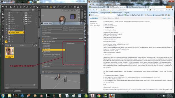

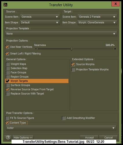

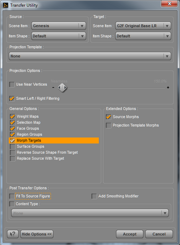

4. Open Transfer Utility. Select My Genesis as a Source and Shape as 'Current' (it is important). Select G2F Base LR.obj as a target and Shape as 'Current' (don't know if it is important or not)
a) Projection Template None
b) Show Option: Leave everything checked as it is (don't know if it is important), but select Morph Targets.
c) Check Source Morphs (it is important) and uncheck Projection Template Morphs (don't know if it is important).
I also used Use Near Vertices about 500% but again, don't know if it is important.
d) Select Reverse Source Shape from Target (it is important)
Uncheck Fit to Source Figure for your comfort. Don't add smoothing modifier yet.
Click accept.
5. Wait until it is done. It might be a lengthy process, depending on how many morphs My Genesis has.

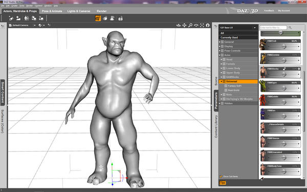

6. After it is done you should have a a lot of morphs in your newly made G2F Base LR figure. They are usually messy, with no proper Shape categories, so I used search selector to find Stocky morph and dial it 100%
Delete My Genesis from the scene or make it invisible so the only visible figure on your scene is G2F Base LR. Make sure it is Base Resolution and Subdivision 0, with no smoothing modifier.
7. Export Stocky shape as obj, on the same scale as it was comfortable for you before. I got G2F Stocky LR.obj

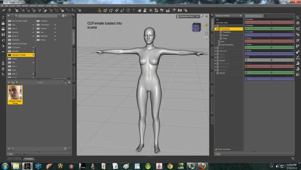

8. Load G2F back on scene.

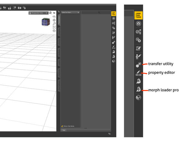

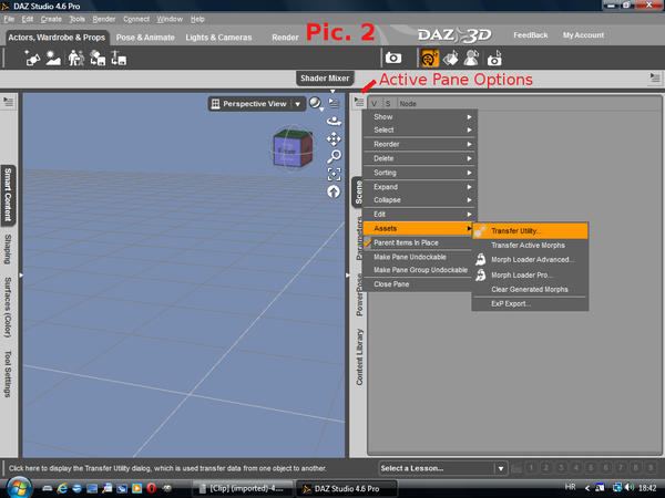

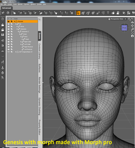

9. Open Morph Loader Pro (in my DarkSide layout it and Morph Loader Advanced have the same icon, MLP located below MLA). Select G2F Stocky LR.obj as a loaded morph. The scale of import should be consistent with a scale of export before.
Name the morph as something nice, say G1 Stocky.
Under Property Group right click and Create new property group. Select Actor and in a line under type Actor/Gen 1 Universal/Real World. Later you can just select it as a already existing Property.
Make sure that Reverse Deformation is checked as 'yes'.
Leave everything else like it is.
Press ok.
10. Now you have a morph :) You can make it more organized with Property Editor but I'm yet to figure how to create groups in it.

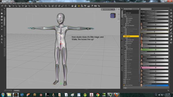

Again, for drastic morphs you'll need to follow Bone Adjustment and ERC freeze tutorial (starting from step 9).
11. Repeat steps 6 to 10 for any morph you wish to transfer.

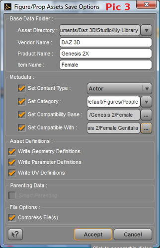

12. When you happy with organizing, Save new morphs as Morph assets and save modified G2F with all new fancy groups as Support Assets/Save Modified Assets (or as a separate figure through Figure/Prop Assets)
Some notes.
I have no DS 4.6 installed so I might not catch the subtle rigging differences between G2F in DS 4.5 and 4.6. Can anybody with DS 4.6 try that process and say if anything is messed up? I'm also not sure about fingers. They seem to curl and pose ok for me in DS 4.5 but I don't know how they supposed to be posed in DS 4.6.
With more additional steps and loops it might be possible to eliminate of Genesis 1 full body morphs influence on G2F face altogether in case if there is any.
For subtler morphs, like Finesse Details you might want to set morph value for export in step 6 as 150% of more to boost up the details a a bit, depending on what you want.
Expressions, pose controls and everything that affects inner mouth might not work properly.
This method works best for gender neutral morphs. For Gender specific morphs (like Victoria 4) the process will have to be modified a bit because otherwise you'd get a boobs too huge and waist too slim. I'm trying to figure the process but if anybody has any ideas, you are welcome to share. Male morphs, obviously, don't work as well at all for now but I think it is possible to make Genesis 2 Base morph because there is a Genesis autofit clone for G2F already, as I think.

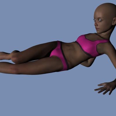

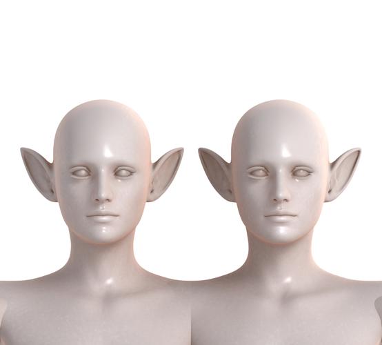

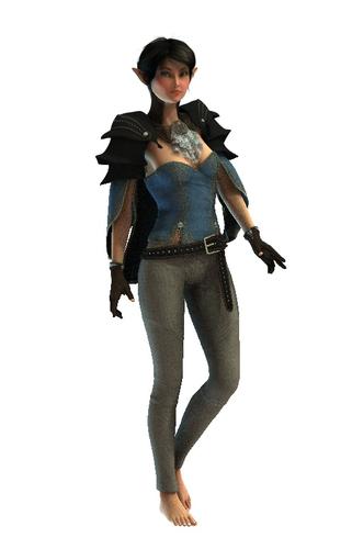

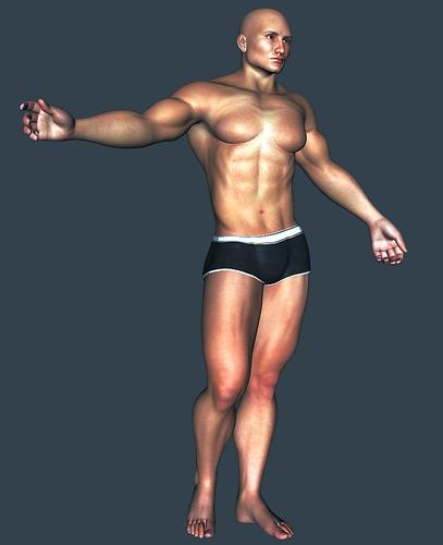

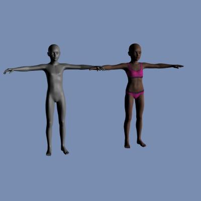

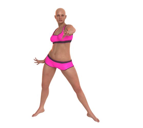

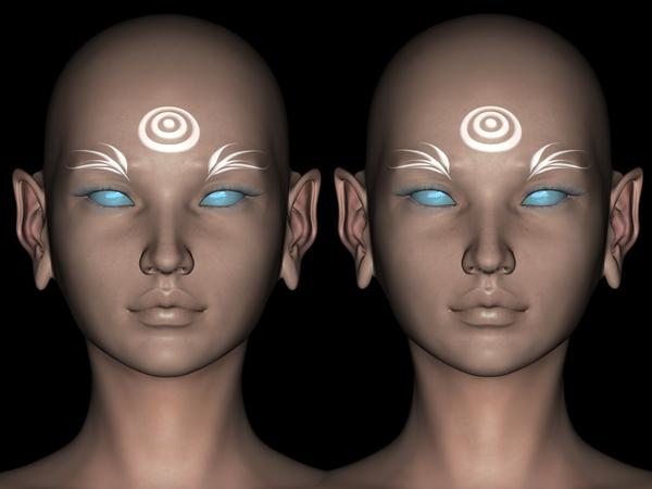

Pictured is Genesis 2 Female with Finesse Details 100% (boosted as 150% from Genesis 1) and G1 Pear 75%.
1036 x 928 - 107K
Post edited by Cris Palomino on

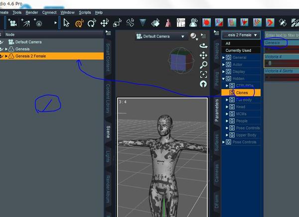

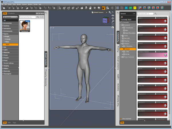

    G2F with original Genesis shape (and fingers).
    Requires some meddling with text editor. It should be a sort of plain text editor that allows easy formatting of big files and doesn't add any junk from itself, so I think Notepad should be ok (I personally used small text editor called Bred3).
    It is not as scary as it might look

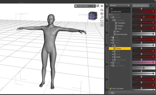

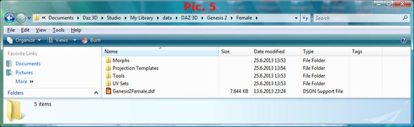

    1) Go to the data directory where you installed G2F
    Should be something like
    \data\DAZ 3D\Genesis 2\Female\Morphs\DAZ 3D\Base
    Find there a file called CloneGenesis.dsf, it should be around 1 MB size.
    2) In the folder \data\DAZ 3D\Genesis 2\Female\Morphs\ make your own folder, say, "Additional Morphs"
    Copy CloneGenesis.dsf into that folder and rename it into OriginalGenesisTemp.dsf
    This file is essential for next steps but you will delete it later.
    3) Now the editing part.
    Open OriginalGenesisTemp.dsf file in your text editor of choice.
    Line 20: change "type" : "Modifier/Clone",
    to "type" : "Modifier/Shape",
    there and everywhere - mind the commas at the end of the line, they are important
    Line 31 change "visible" : false,
    to
    "visible" : true,
    Line 40: change
    "group" : "/Hidden/Clones",
    to
    "region" : "Actor",
    "group" : "/Universal/Real World",
    it will add an extra line
    instead of /Universal/Real World you can use your own hierarchy, say "group" : "/Legacy/Original Genesis",
    Save your file.
    You probably can clean it up further, modifying "asset_info" and such, but so far it worked pretty well for me.
    Addition from larsmidnatt: I originally changed all the id’s and names in the DSF, but at the bottom of the file, line 21611 I had originally named the id GenesisOriginal, just like I did at the top of the file. This caused a duplicate ID error. So I looked at the unedited DSF file and noticed DAZ Studio gave it the ID CloneGenesis-1. So i have copied that logic and gave mine the ID of GenesisOriginal-1. I no longer get duplicate id’s anymore, and i can see both the genesis morphs in the parameters (one is hidden and one is my new copy)
    Simply put. If your copied clone does not show up, change the ID’s and names throughout the file to say something other than CloneGenesis, maybe change it to GenesisOriginal. But on line 21611 give it the id of GenesisOriginal-1

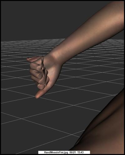

    4) Fixing crumpled fingers.
    This method initially gives strange crumpled fingers when you pose your G2F.

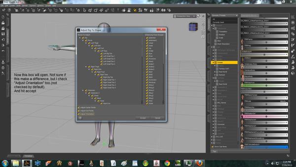

    Bone Adjustment and ERC Freeze as explained here, steps 9 to 18, will help with it. Follow it as written (only name your morph as something new, say, just OriginalGenesis instead of OriginalGenesisTemp).
    The only thing to mind - when you do step 11 of this tutorial, select 'Adjust Orientation' too (it is unchecked by default).
    Also, because I didn't clean all supportive Clone information out of my OriginalGenesisTemp.dsf you might see your morph as CloneGenesis instead of OriginalGenesisTemp.
    After you done, rename it with Parameters settings for the morph, and save your new morph as OriginalGenesis. In your G2F it should be located in the group that you put it in on step 3 (in my case Universal/Real World). On your hard drive it should be OriginalGenesis.dsf in \data\DAZ 3D\Genesis 2\Female\Morphs\AdditionalMorphs folder.
    Go back to folder \data\DAZ 3D\Genesis 2\Female\Morphs\DAZ 3D\Additional morph and delete OriginalGenesisTemp.dsf (the initial file), you don't need it anymore.

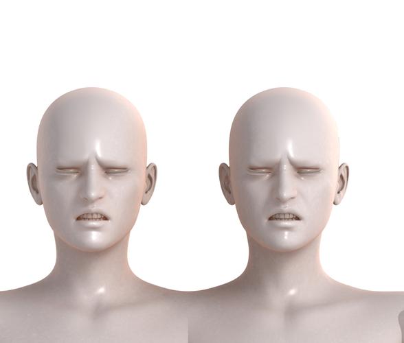

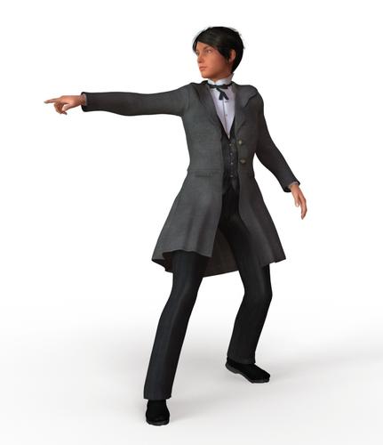

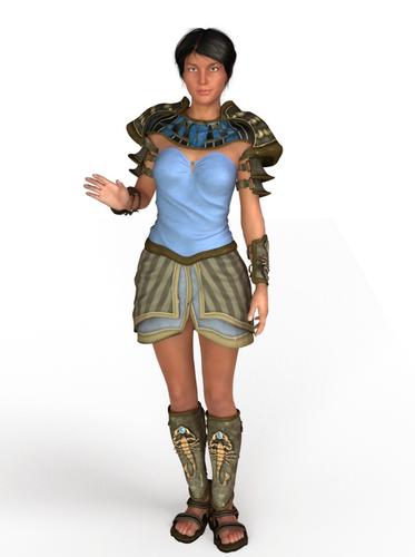

    Here is a result. G2F in G2F clothes with G2F unmodified pose, with Genesis original morph and adjusted rigging.
    Again, I have no idea if it works in DS 4.6 or does it look the same as in DS 4.6 or if it will have any problems with autofitted clothes or smart content. But it should make all morph transfer from Genesis to G2F much easier.
    Again, any testing/questions/comments/new ideas are welcome.
    1036 x 928 - 115K
    Post edited by Kattey on
  • KatteyKattey Posts: 2,899
    edited June 2013
    Transferring Genesis Morphs to G2F (including gender-specific).
    This is an updated version of the first tutorial. This tutorial presumes that you already have OriginalGenesis shape and adjusted rigging as explained in tutorial above (post #7 of this thread).
    For this I need Genesis 2Female Essential (free), DS 4.5 (free and probably the process will work in DS 4.6 too), My Genesis (Genesis 1, with those many morphs I have).
    I will be transferring Michael 4 morph which I got from Iconic Generation 4 shapes from Genesis.

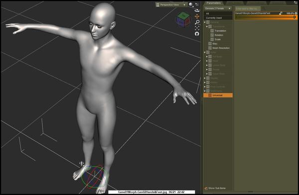

    Dial Original Genesis morph (that you made before) 100%.
    I exported it as G2F Original Base LR.obj
    2. Load My Genesis into DS 4.5. Don't adjust anything.
    Delete G2F figure.
    3. Load G2F Original Base LR.obj with a proper scale.

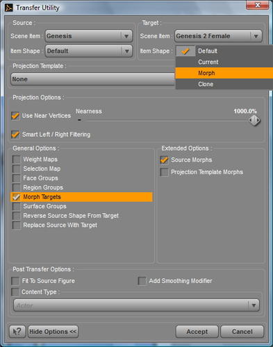

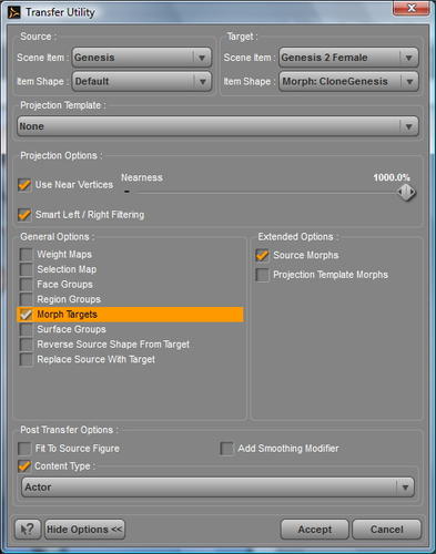

    4. Open Transfer Utility. Select My Genesis as a Source. You can leave Shape as Default or set it to Current.
    Select G2F Original Base LR.obj as a target. You can leave Shape as Default or set it to Current.
    b) Show Option: Leave everything checked as it is (don’t know if it is important), but select Morph Targets.
    c) With Morph Targets Selected, check Source Morphs (it is important) and uncheck Projection Template Morphs (don’t know if it is important).
    This time I didn't use Use Near Vertices method. You can try with it.
    d) You don't need to select 'Reverse Source Shape from Target' this time.
    Uncheck Fit to Source Figure for your comfort. Don’t add smoothing modifier yet.
    Click Accept.
    6. After it is done you should have a a lot of morphs in your newly made G2F Original Base LR figure.
    They are may be messy, with no proper Shape categories, so I used search selector to find Michael 4 morph and dial it 100%
    Delete My Genesis from the scene or make it invisible so the only visible figure on your scene is G2F Original Base LR figure.
    7. Export M4 adjustment shape as obj, on the same scale as it was comfortable for you before. I got G2F Original M4 LR. obj
    Dial OriginalGenesis morph to 100% (it is important)
    Select G2F Original M4 LR.obj as a loaded morph.
    Name the morph as something nice, say G1 M4
    Under Property Group right click and Create new property group. Select Actor and in a line under type Actor/Male (or any other hierarchy you'd like). Later you can just select it as a already existing Property for all your male characters.
    Make sure that Reverse Deformation is checked as ‘yes’.
    Press ok.

    To make Bone Rigging adjustment and ERC Freeze do the following:
    (thank you very much, niccipb, for making initial tutorial)

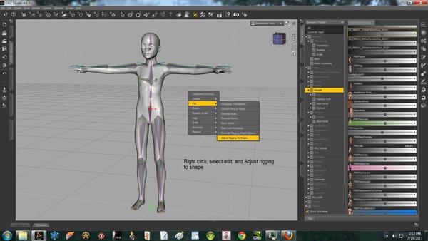

    a) Dial down to 0% Original Genesis morph, so you'd have a very muscular G2F with G1 M4 morph set to 100%.
    b) Select G2F in your Scene lab and right-click on the tab header 'Scene'. It should open an useful menu where you click
    Edit -> Rigging -> Adjust Rigging to the Shape.
    (For better visualization you can have Joint Editor selected to see bones in the figure).
    After Adjust Rigging to Shape panel opens, you usually don't need to do anything but can click Accept (but sometimes you may use Adjust Orientation in case of some other morphs).
    [For very drastic shapes (Brute, Infernal Behemoth) some manual bone adjustment via Joint Editor might be needed as well.]
    c) Open Property Editor tab with your G2F still selected.
    - In this tab find and select your G1 M4 morph (it is important)
    - Right-click on Property Editor tab header, it should open a menu.
    - Select ERC Freeze.
    - Figure and Node are Genesis 2 Female (your figure)
    - Property in our case G1 M4 (our adjusted morph)
    Everything else should be already selected but you need to uncheck Restore Figure Rigging (it is important) and click Accept.
    Now the bones should follow G1 M4 shape and don't mess with OriginalGenesis morph.
    d) Dial down G1 M4 morph or Zero Figure, so you are back to initial G2F base shape and rigging.

    Pictured is Genesis with M4 Iconic Shape (left) and Genesis 2 Female with Original Genesis 100% and G1 M4 100%, scaled 103.1% (right). Same G2F pose and same Genesis gray preset applied to both although they rendered differently due to different default shaders.

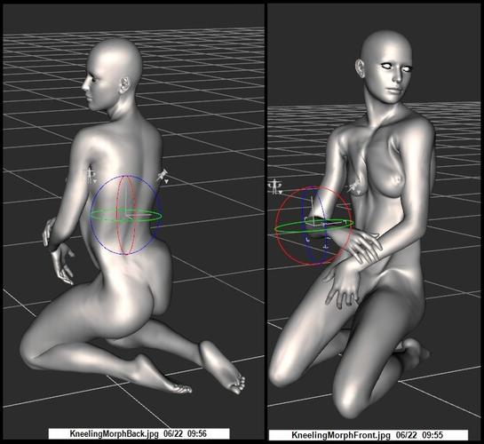

  • BejaymacBejaymac Posts: 2,003
    *Evil Grin* I went the opposite way and made a G2 morph for Genesis, *points at pic* which one is which ? ROFL
    still got a bit of rig fixing to do as the bones don't quite match up.
    713 x 647 - 56K
    Hehe, Bejaymac, I was about to do the same :)
    G2F on the left?
  • TheKDTheKD Posts: 2,711
    edited June 2013
    The one on the left looks better to my eye, the way the hips and legs bend mostly. I hope the left is the new figure lol. Thanks BTW for sharing the process, will be trying it out after supper if all goes to plan :D
    Post edited by TheKD on
    Yep the one on the left is G2F, in the T pose the two overlap each other perfectly, once I manually adjusted the joints and then ERC freeze them then the two will pose the same.

    First picture is G2F with OriginalGenesis morph + LoveHandles
    Second morph is default G2F with LoveHandles.
    Finger poses change because OriginalGenesis has (unsurprisingly) curled original Genesis fingers.
    1029 x 928 - 83K
    1029 x 928 - 87K

    Hmmm, looks more like my "Hip Wide" morph as it's not up as high as it should be. I'll take a look when I get home. I'm curious. I'll be over the moon if my Bruno morphs make it over.
    edited June 2013
    It could happened I transferred some other Love Handles morph. I have two, it turned to be ^^" Let me try it again.
    edited June 2013
    Hm, it was your morph.
    This is how it looked on original Genesis for me (dialed 100%)
    Maybe I should've made a neutral pose ^^" Here hips are sort of angled.
    1023 x 928 - 97K
