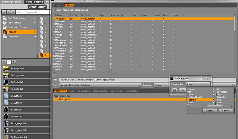

    In 4.9.4.117, why is there no way of adding materials -> 3delight when adding a root category to an item in the Content DB Editor?  See screenshot
    I can add materials ->iray, but there's ..->3delight (or does 3delight have some mystery name?)
    and why is it so SMALL with no way of enlarging it?
    800 x 470 - 187K
  • MBuschMBusch Posts: 547
    3Delight is the default category. It means by example, a clothing 3Delight material will go in /Default/Materials/Wardrobe while the Iray counterpart will be set at /Default/Materials/Iray/Wardrobe
    I asked about this combo box being to small and unresizable. It was followed to the developers as feature request (not kidding).
    Ah! thanks Mario, I should have just asked you in the first place LOL!
    Was confused, cos right clicking and categorizing I get materials -> 3delight, which means in Smart Content, I get the nice list on the left - Materials and it breaks down into 3delight and iray.
    And yeah, that smallness is weird. Who on earth could look at that and think "yeah, that's alright, everyone can see that 1 inch box..." angry
    There is no default 3Delight catgeory under Materials, I created my own and forced all the old 3Delight sub-categories into it. Now when new products come out, I manually move the materials to the 3Delight > XXXX category I want them in and delete the sub-cateories in the root of the Materials catoegory. It is a pain, but at least all of my materials are organised when I go to use them.
    WARNING: Make sure you export the meta data after your are done so your changes don't get overwritten by the next update.
    ​I don't use the same workspace that you are, so I can't comment on why you are unable to resize the Category selection dialog. I use the Dark Side and I can resize to full screen if desired.
