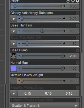

  • TottallouTottallou Posts: 555
    edited August 2016
    To use the shader - I just load the model then apply one of the presets eg NGS00 Custom Skin A - For me it applies in the usual way - (Select G3 & click the preset)
    Then I look at the surfaces and they are the same as shown in the PDF and most if not all the maps are applied to the correct boxes already
    If you want to add a bump map to improve results then rather than add the characters skin map choose the bump version which is there for all the purchased G3 Models I have tried - Most bump maps seem to be labeled TorsoB etc or similar but in anycase its the same map as you can see under base bump.
    Let us know how you get on
