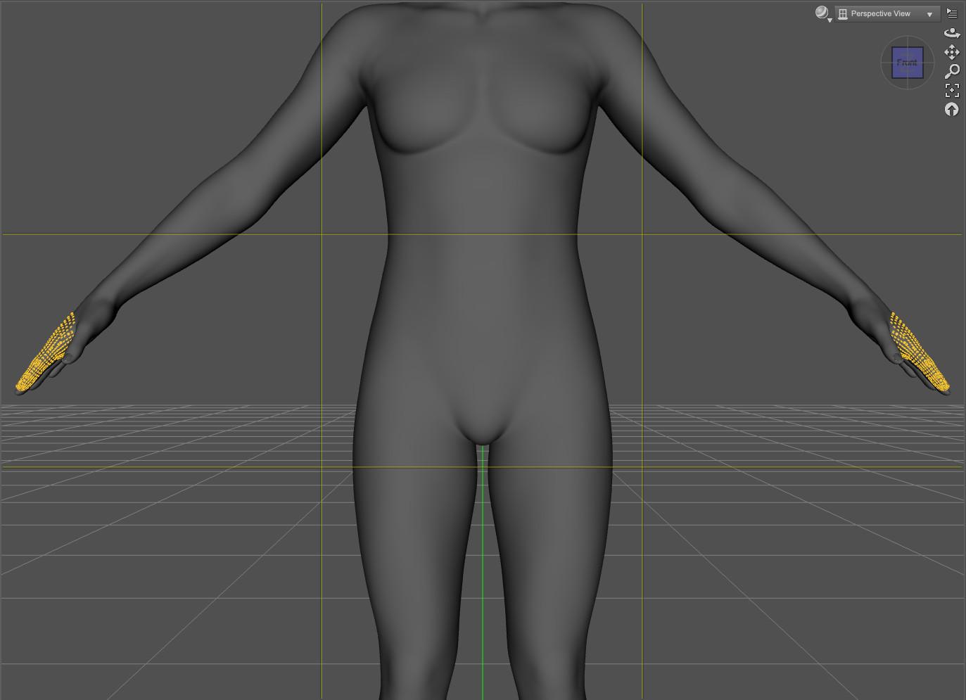

    @mrpenguin76 The Finger Focus problem appears to be actually worse that just missing 1st and/or 2nd stage controllers. The keyed attributes are missing, at least on some. Here is a comparison of you the left and right Index1Bend95 are set up. The right morph doesn't seem to be setup at all as delivered in the product. I think this is getting beyond what I know how to fix myself.
    533 x 657 - 38K
    Post edited by barbult on
    edited June 10
    Some of the right side Finger Focus correction morphs also affect vertices on the left side. Using 3DU's own Scene Tools 4 morph utilities shows this clearly. I don't know if this is related to the other errors about the right index1 bend morph not having it 1st and 2nd stage controllers and keyed attributes set, or whether this is just another error in the same morph. It is as though the development of these right side morphs was started and not finished before release.
    I'm thinking about returning this. It is just too frustratingly broken. I've never had much luck getting 3DU product errors fixed in any reasonable (or ever) timeframe.

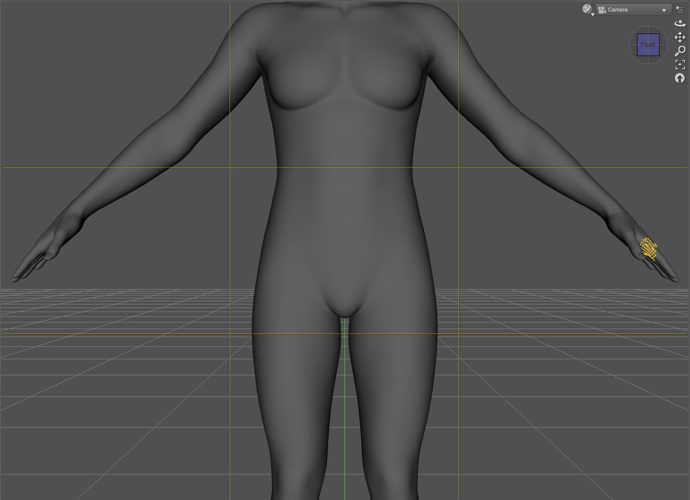

    There appear to be more problems with morphs from one side modifying vertices on the opposite side,  This time I noticed that a LEFT side morph 3duJCMFF_Index1Bendn60_l modifies vertices on the RIGHT side also. And the vertices on the right side aren't even a mirror of the vertices that are modified on the left side. Earlier, we found problems with the morphs for the right side, but now the left side also has problems.
    EDIT: And correspondingly, 3duJCMFF_Index1Bendp60_r modifies vertices on the LEFT side also. (Hmm I can't reproduce this error now.Anyone else see this problem with the 3duJCMFF_Index1Bendp60_r?)
    I don't know any reason that bending a finger on one hand should affect the opposite hand. These morphs must both be wrong.
