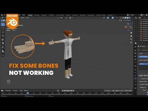

    All I need to know is how to merge the skeleton & OBJ!?
    I followed alone with this simple video, but as usual; something went wrong! I got this error message on the very last step!
    Bone Heat Weighting: Failed to find solution for 1 or more bones
    Post edited by Yui on February 28
