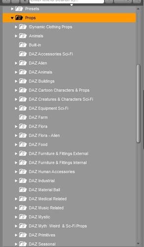

    Download Manager is a real pain for me. When I tried it - it does not see my existing content but......for a very good reason!
    Apart from having multiple Runtimes on different drives, I take the time to categorise my props into created and ''Relevant' folders. If I had left my Runtimes in the state that Daz would have it they would be a real mess..and one library folder alone would probably require an immense amount of scrolling from top to bottom!. Notwithstanding that, many vendors give their containing folders obscure and/or abbreviated names not to say often cryptic.
    One of the biggest issues I have with many software vendors is that many always seem to assume that Valhalla is always 'C' Drive. I for one deliberately keep my 'C' drive free of all my heavy and important software because apart from the fact that it can slow the OS down, if the machine goes pear shaped then I've lost nothing important as it's on other Drives.
    I sincerely hope that Daz does not make Download manager the only way to install props and such as I'm sure that will put a lot of people off.

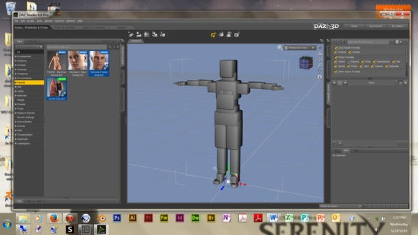

    1. I've used DIM for several years, for Poser (PP2014) and just downloaded the latest version.
    2. I've struggled with DS for a while ... gave up and have just now downloaded the newest version as of today ... and it works perfectly on it's own. I look forward to learning it.
    3. Now is the problem. The content all downloaded to "my DAZ 3d content" ... but for Poser. I redirected, but know I've made some errors in the process because ...

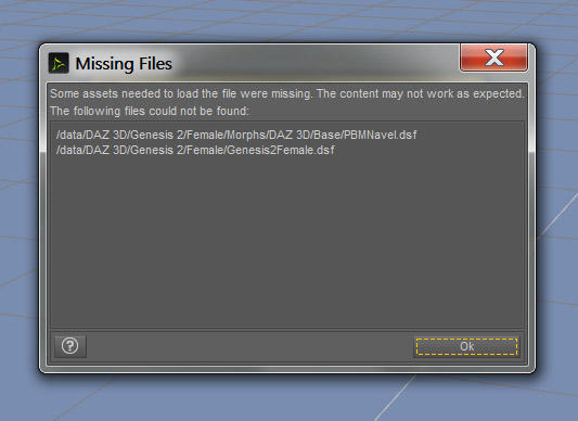

    4. The Genesis2 figures all say there are one or two "dsf" files are missing.
    I hope I've given you enough information for this ... Plus.
    How do I redirect future DIM downloads to DS (or Poser as I need them)?
    Thank you for your help.
    Boni
    P.S. If this has been answered I'm sorry, I've had a difficult time wading through the thread.

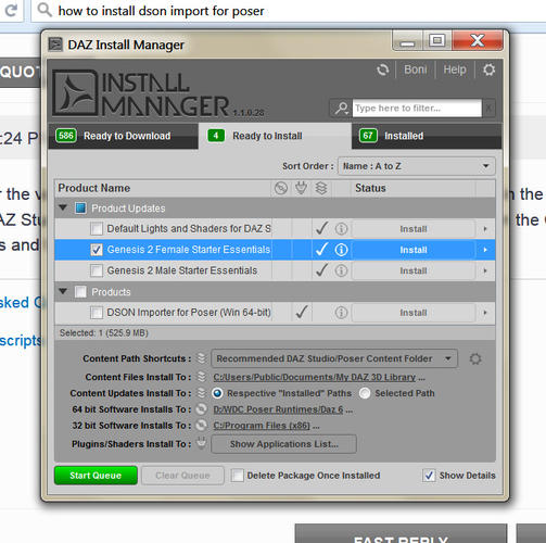

    Here is the pop up before the blocky figure comes in. I don't know how to change this to the figure I want.
    I found the proper files ... but not in the path indicated. I don't want to screw something up ... advice please.
    533 x 388 - 38K
    Post edited by boni_m_ab7b32f625 on
  • BeeMKayBeeMKay Posts: 7,019
    edited May 2015
    In DIM, is there still something called "Genesis 2 Female Starter Pack" available?
    If yes, you need to install that, or G2 Female will not work.

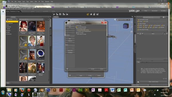

    It is possibvle that, as you re-direct Poser content to another directory, the files that are needed for Genesis 2 Female were also directed there.
    DS just knows the default directories. Any other directories, you have to make known to DS.
    Here's how:
    In Edit, go to "Preferences"--> Content Library--> Content Directory Manager.
    There, click on "Poser Formats" and add the Poser directory to DS.
    Hopefully, that will bring back the missing files (and allows you to access all Poser content in DS, too).

    Sadly, I've already done that. The path shown in the second screen-capture seems to be the culprit, I would copy the .dsf files to where DAZ needs them to be if I knew where that is.
    Ah, I have not installed the DSON core files, as I thought I could install the figures directly into DS and avoid the Poser side step. Off to learn now to do this. Thank you! Silly me.

    I hate to be a pill, but I've installed 4 or 5 times, different ways ... and still I come up with yellow triangled exclamation marks and missing .dfs files on a path that doesn't make sense. The images of other assets show up in the smart content ... but doesn't load into the scene. The primary Genesis 2 figures no longer have a thumbnail and only the head shows up in the scene as a series of blocks as before.
    I may be beating the proverbial dead horse here ... but I keep thinking there must be a way to install into DS without Poser! I have lights, and other things that I know belong in a different file set. I am just so confused that I keep thinking I'm missing something obvious ... about the content vs. runtime folder or something ... or I need a dual location for DIM ... I'm use to figuring this out and I'm baffled.

    Did you install all files for the various Starter Essentials? Please click the Show Details box in the Install Manager on the ready to Install tab and take a screen shot, then in DAZ Studio go to Edit>Preferences, click the Content Library tab, then the Content Directory Manager button, expand Current, then DAZ Studio Formats and take a screen shot of that.
  • boni_m_ab7b32f625boni_m_ab7b32f625 Posts: 113
    edited May 2015
    Thank you so very much. Here are the two sceen shots. I have a feeling I need to move some files. :)
    I need to shut down my computer, but will check in on my tablet this evening for an answer. If you would be so kind as to put a step-by-step I'd appreciate it as I work best that way. If I need a second location for my DIM to install to or just redirect to the "content" folder within the Poser runtime fold I have ... whatever needs to be done, I will do this tomorrow morning. But I will study your instructions if you so choose to post that tonight. I appreciate all the help I can get.
    Boni
    1920 x 1080 - 405K
    678 x 674 - 131K
  • Richard HaseltineRichard Haseltine Posts: 111,459
    OK, there are two fixes, depending on where you want your content and where the files already used in Poser are.
    If you don't mind using your C: drive for content - in the Content Directory Manager you need to click on DAZ Studio Formats so it's fully highlighted (instead of the dotted outline around one of your folders as in the screen shot). That should enable the Add button on the left, click it and select the C:/Users/Public/Documents/My DAZ 3D Library folder.
    If you prefer to use the folders you have set up in DS, not the default My DAZ 3D Library folder on the C: drive - in the Install Manger click the gear icon at top-right to open preferences, then click the Installation tab.Click the + button at the bottom-left and select D:/DAZ/Studio/My Library and/or D:/WDC Poser Runtimes/Daz 6. Click Accept. Now in the main Install Manager interface go to the Installed tab and paste this into the filter box, the text box at top-right
    path::C:/Users/Public/Documents/My DAZ 3D Library
    That should limit the display to things that have been installed to the unmapped location. Click the master check box, in the bar that says "Products", which should select all of them and click Start Queue. Now the items should appear in the Ready to Install tab if you go there. With the Details box still checked if the button next to Content Path Shortcuts doesn't show the folder on D that you want to use click the button and pick the path, then select some or all of the items and click Start Queue to install them.
