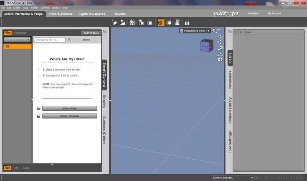

    - I can’t find my content.
    You should be able to load content from two different panes in DAZ Studio: Smart Content and the Content Library. Everything that's properly installed should appear in the Content Library.
    Within the Content Library should be sections for "DAZ Studio Formats" and "Poser Formats." The general rule is that Genesis content (and DAZ Studio materials presets for some other items) will appear under "DAZ Studio Formats" and most other items can be found under "Poser Formats," but there are exceptions to this, so it may help to check the readme file for the product(s) you are using if you are having trouble finding them.
    If you can't find any content in the Content Library, it's likely that DAZ Studio is not looking in the correct location where the files are installed (or perhaps the content was not installed correctly). Either right-click on the tab of the Content Library, or left-click the option menu icon on the Content Library pane and go to the Content Directory Manager. You'll need to add the folder containing your content to DAZ Studio Formats and to Poser Formats.
    See here for more information.

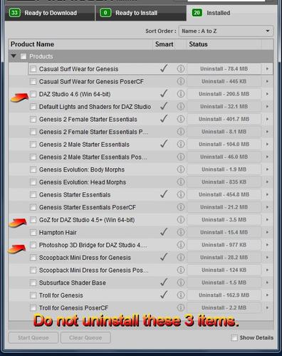

    One other thing I would like to mention. On one my platforms, I first used DAZ 3D Install Manager to install Genesis Starter Essentials and Genesis Starter Essentials PoserCF before installing the core product DAZ 3D Studio 4.5 Pro which successfully installed them, but when launching DAZ 3D Studio 4.5 Pro, nothing appears under Actors, Wardrobe and Props | Smart Content | Files.
    To resolve this, I used the DAZ 3D Install Manager to uninstall the two Genesis Starter Essentials products and re-install them and now I can see the expected menu under Files w/Accessories, Cameras, Environments, Figures, Hair, Lights, Materials, Props, etc.
    This is just to clarify that the core product DAZ 3D Studio 4.5 Pro installation needs to be completed first before using DAZ 3D Install Manager to install the Genesis Starter Essentials products.

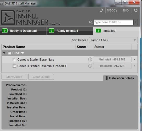

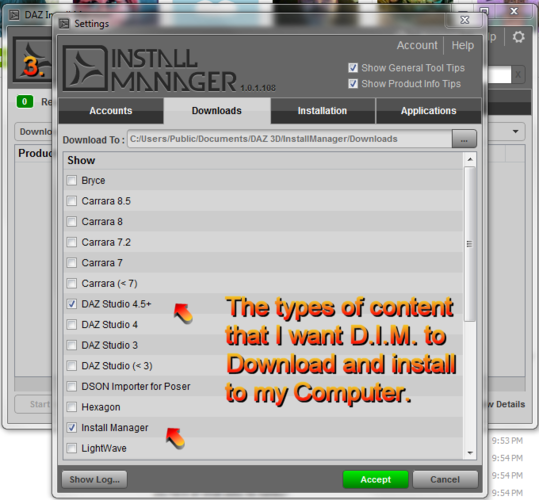

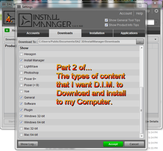

  • freddy.stynen1freddy.stynen1 Posts: 2
    hey ,

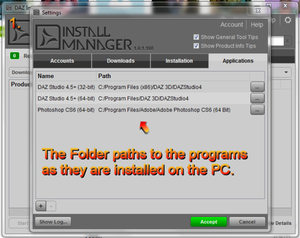

    i installed the file manager and everthing els i think , so why can't or see the Free downmoad DAZ Studio .
    already rmoved all and started to download it again , still the same .
    freddy
    572 x 527 - 69K
    851 x 612 - 160K
  • SzarkSzark Posts: 10,634
    edited April 2013
    You can't use DIM to install Software i.e.: Daz Studio and associated plug-ins only Content can be downloaded and installed by DIM.
    If you read the instructions above carefully it does imply that you need to install the program manually. ;)
    Sorry I was wrong it doesn't imply (sorry Scott) is states second post down at the top

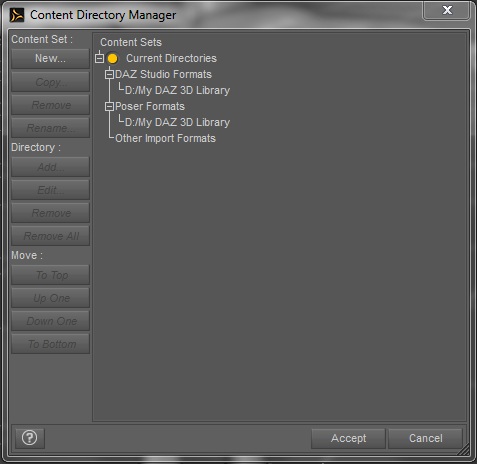

  • borgtrekkerborgtrekker Posts: 112

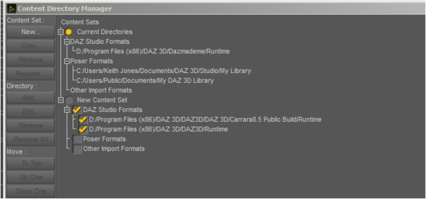

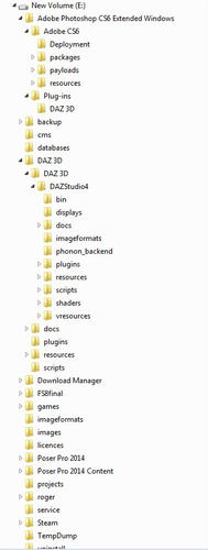

    Ok, I have got one for someone to figure out...
    After having followed your instructions for downloading and install of the program, download manager, & purchased content i have a bunch of Yellow Triangles with ! in much of my Smart Content Manger and when I click on the Yellow Triangle item it states that DAZ is unable to locate the item even though it shows as being fully installed in the download manager... I am using Win7-64 and because there are multiple users I have all of my content installed and mapped to to C:/Users/My DAZ 3D in both the program and the download manager program. any ideas what the problem could be with the missing content?
    Thanks.
    edited April 2013

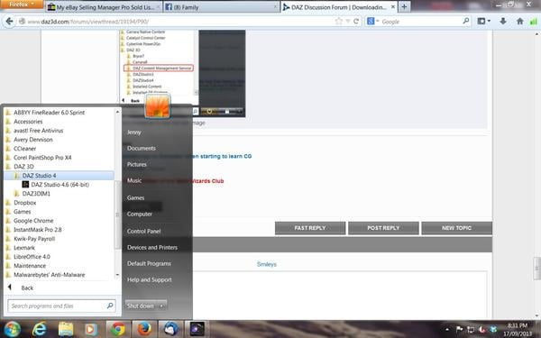

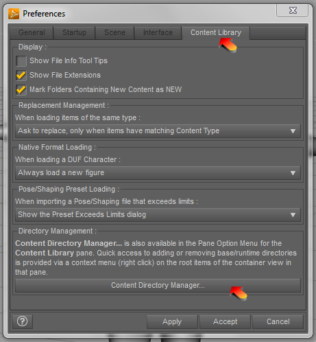

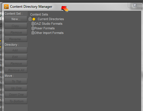

    1: exactly where is all your conetnt installed to and
    2: can you post a screenshot of you content Directory Manager.
    or 3 go to the Options box of the SMart Content or Content Library pane and choose Contnet DB maintenance and start with refer to image below doing one at a time restarting Daz Studio each time.
    Sounds to me you either made a mistake or you had Daz Studio open when you installed the content?
    1029 x 694 - 230K
    Post edited by Szark on
  • JaderailJaderail Posts: 0
    Also note the TIP that was sort of covered. Never install content with Daz Studio open and running. The Content database is OPEN and called by DS as the new Metadata is installed if you do this. Some times nothing happens and your Metadata will show on the Next Open of DS but it can/will Corrupt the Database if/when an error happens. Your Much better off not having DS open for any install.
    edited April 2013
    Thanks for your help. Just to let you know that no DAZ was not opened when I ran the Download Manager and installed the content, however there were some orphan files - must have been from a previous install...
    I went through the process of opening DAZ, going to the content database and went through each step 3-5 restarting after completion of each step. now after step 5 - resetting the database - I restarted DAz and now nothing is listed under my Smart Content under Products and Files is greyed out. Therefore what is the process to get the Smart Content back or am I missing something here?
    Content is installed to C:\The Master\My DAZ 3D
    Post edited by borgtrekker on
  • fixmypcmikefixmypcmike Posts: 19,730
    Content Library > options menu > Content DB Maintenance > Re-Import Metadata

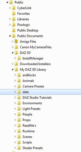

  • p05p05 Posts: 25
    Hi, i´ve bougth time ago M3, M4, V4, etc but i don´t know how or where install this in DAZ Studio 4.5 pro.
    Please can you help to me?
    thanks
  • Scott LivingstonScott Livingston Posts: 4,352
    thanks
    I assume you wish to install them manually, not with the DAZ Install Manager? Is your computer a Mac or a PC? And where is the rest of your content installed, if you have any?

    Different people have different preferences about where to install, but you'll probably want to put stuff somewhere in "Documents" (do not put content within "Program Files"). Decide where you want to put things, and be consistent. Before I started using the DAZ Install Manager, my content was installed to: C:/Users/***/Documents/DAZ 3D/Studio/My Library
    The asterisks (***) should be one of the existing user accounts for your computer, or else Public.
    Within the "My Library" folder you can find folders like "People," "Hair," "Lights," and "Runtime." But "My Library" should be the install destination.

    Hi, i just used the same route suggested by you...C:/..............My Library to install Victoria 4 . Then i press start in Daz Studio 4.5 executable, and when finish loading i look in figures and in all files and NO traces of Victoria 4. I don´t know what im doing wrong...and i need this tool for work :(

    You should find V4 in the Content Library tab, under: Poser Formats>My Library>Figures>DAZ People
    If you don't see her there, let me know and I'll help you tell DAZ Studio where to find your "My Library" folder.
