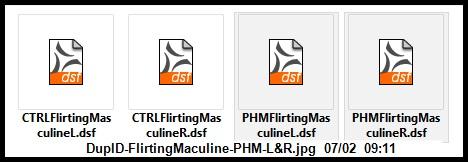

    Seems I've run into two Dup ID's, probably this past update (DIM yesterday had about 30 Genesis products that had updates available.
    The two that are giving me grief are high lighted in the image below....

  • Richard HaseltineRichard Haseltine Posts: 111,677
    Those will give you duplicate formula errors, but they should have been doing so all along in 4.5 (and later 4.1, as I recall). They are the old files from the Genesis Evolution Expressions, which won't be overwritten by the new versions. If you had an update for that set and it reintroduced the bad files then that needs reporting.
  • RAMWolffRAMWolff Posts: 10,393
    Hi Richard.
    Thanks for the reply.
    So then all 4 of those files as well as the Feminine files can be deleted or just the PHM's and leave the CTRL's intact??
    I'm at work right now so can't send in a report at this time...
    I'm pretty sure you can remove the whole folder, the updated Genesis Evolution Expressions are elsewhere.
    Hmm, OK... I'll have a looksee when I get home tonight
    Thanks Richard! :-)
    The script usually, but not always, fixes issues with figures - clothes or hair, or new base figures. If you are getting the error with Genesis or another base figure, and if your content is up to date, then it's likely to be one of a few third-party morphs that need updating; the script won't help with morphs (which weren't causing the issue at the time). It's also worth being sure the error is Duplicate IDs - for content that hasn't been updated for a long time in may be Duplicate Values, which is a totally different thing (fixed by updating the content).

  • peter_2762644peter_2762644 Posts: 53
    Hey there,
    I'm new into DAZ3D (and generally 3D-Modelling and so on...).
    But it makes a lot of fun.
    I found a SIMPY SOLUTION for me to fix this Problem (very helpful was this tip: https://helpdaz.zendesk.com/entries/20651678-how-to-fix-the-duplicate-formula-message).
    I noticed, that this error occours after I installed the GENESIS EVOLUTION MORPHS.
    So by the method "Try and Win or Loose" ;-) I figured out, the Genesis Evolution EXPRESSION Morphs causes the Problem.
    I have simply waived and good is!
    That was the Solution in my Case. Please don't ask me for Details. As I said - I'm a completely nebie :-)
    Greets from Vienna...
