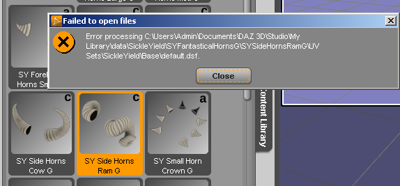

  • SaitoChikaraSaitoChikara Posts: 0
    So what do I do now?
    574 x 267 - 29K
  • Richard HaseltineRichard Haseltine Posts: 111,219
    It shouldn't be touching the UV maps, it should be looking only for the item .dsf file (which would be in \data\SickleYield\SYFantasticHorns\SYSdieHornsRamG). Unfortunately I don't have that set to look at it.

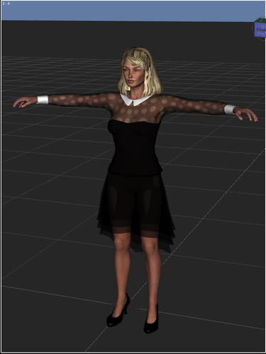

    While the script works well on a lot of content, there are still items for which it doesn't seem to work. For example, eblank's excellent J_Dress still generates an error even after I've run the script. I noticed when I run the script on the item, I don't get the "watch" icon that usually indicates the script is working. Here is the log:
    Loaded file: J_Dress.dsf
    Duplicate id "J_Dress" found in file "/data/Author/Product/J_Dress/J_Dress.dsf"
    WARNING: /src/sdksource/fileinput/dzassetdaz.cpp(4957): Could not find target property for formula: Genesis:/data/DAZ 3D/Genesis/Base/Genesis.dsf#Genesis?scale/general in file : /data/Author/Product/J_Dress/J_Dress.dsf#J_Dress
    WARNING: /src/sdksource/fileinput/dzassetdaz.cpp(4957): Could not find target property for formula: Genesis:/data/DAZ 3D/Genesis/Base/Genesis.dsf#Genesis?scale/x in file : /data/Author/Product/J_Dress/J_Dress.dsf#J_Dress
    WARNING: /src/sdksource/fileinput/dzassetdaz.cpp(4957): Could not find target property for formula: Genesis:/data/DAZ 3D/Genesis/Base/Genesis.dsf#Genesis?scale/y in file : /data/Author/Product/J_Dress/J_Dress.dsf#J_Dress
    WARNING: /src/sdksource/fileinput/dzassetdaz.cpp(4957): Could not find target property for formula: Genesis:/data/DAZ 3D/Genesis/Base/Genesis.dsf#Genesis?scale/z in file : /data/Author/Product/J_Dress/J_Dress.dsf#J_Dress
    File loaded in 0 min 8.6 sec.
    The dress seems to work perfectly otherwise. Do you have any suggestions for removing the Duplicate ID error?
    There are two or three items that I had to fix manually for one reason or another - one of which was very strange (it had two dsf files in the data folder, both of which seemed to be used). I don't have that dress - if it's a freebie, do you have a link so I can look at it?

    Richard Haseltine found the solution to this problem. The solution to the problem was to use the Batch Convert feature (menu Windows -> Panes -> Batch Convert) to decompress the .dsf files in both the Content Directory (e.g., /My Library/People/Genesis/Clothing/J_Shirt) and the corresponding file in the /data folder (e.g., /My Library/data/Author/Product/J_Shirt). Then I ran the Fix Duplicate IDs script, and the file now loads fine without an error.
    Many, many thanks to Richard Haseltine at DAZ for working on this over his Christmas holiday.
